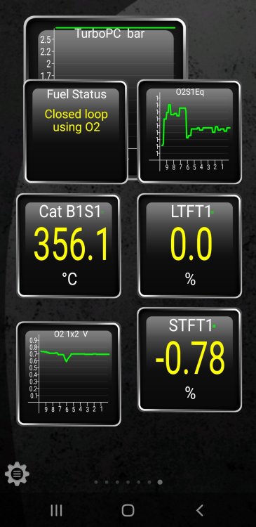

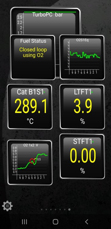

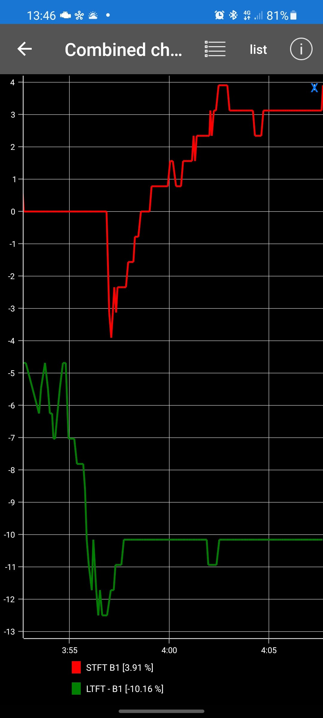

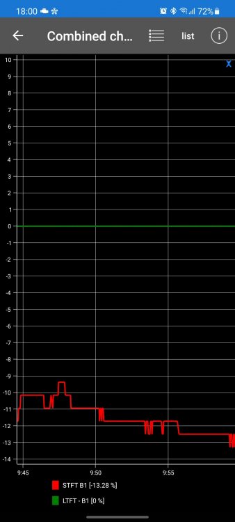

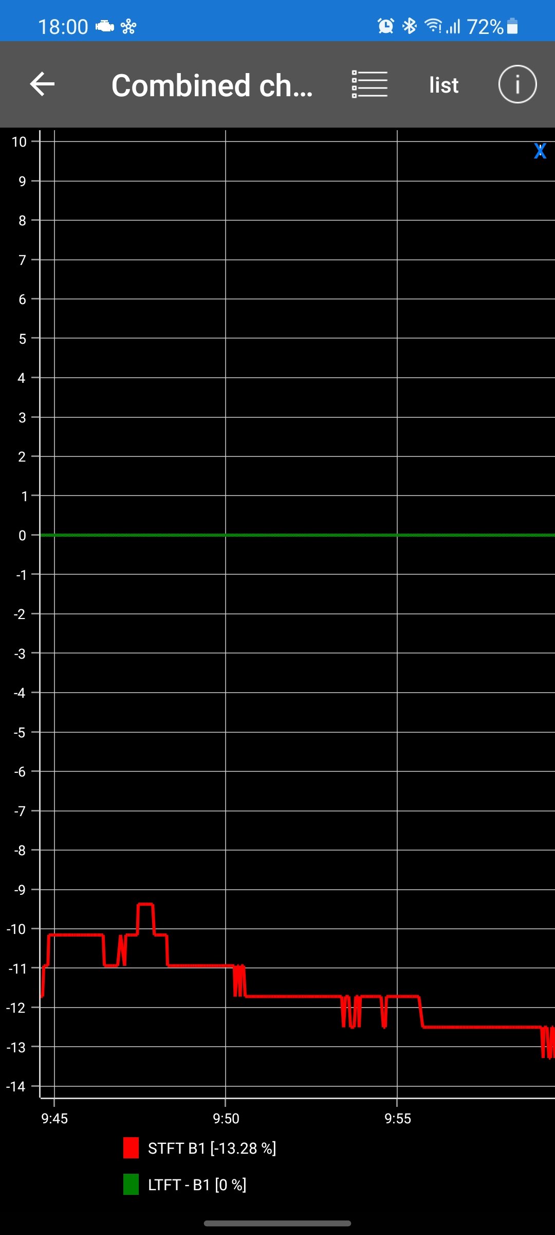

I've attached two images, one before resetting the ECU (To clear LTFT behaviour) and one after a reset. As you can see, my trim is running rich. I believe VW's limit before it will throw a fault is 10% and my car is constantly bouncing from 8-13% negative trim.
The specialist thinks this could be carbon build up preventing proper seating of the valves. Although I'm not sure that would the engine to run rich?
Does anyone have any suggestions before I spend even more money just to be told "I've never seen this issue before" 😕

I'm still puzzled as to why the car is running rich though? I don't get why carbon build up would cause that?
Apologies I think you misunderstood me. This is issues that are electrical. The negative earth from the coil pack to the engine....
On 17/10/2021 at 11:02, the_slug said:
Thanks anyway mate.
If your car is running rich I would check lambda (oxygen) sensor values. If they are reading low then the car will over fuel. My guess is one of the sensor are on the way out.

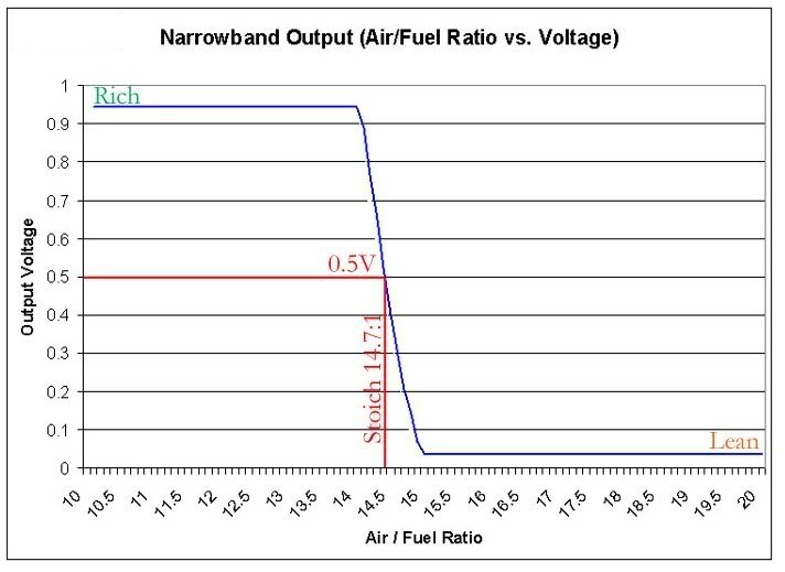

If first sensor is wideband you can see lambda staying around 1 (or I think around 1900mv for tsi)
Second sensor should be between 0.2 and 0.7v (probably around 0.390v)
Depress the gas pedal and see if both change in opposite direction. As you see on pictures how values go for rich and lean, opposite way.
If they are properly working they should move.
Also second sensor should be steady on idle, meaning cat is working.
If first sensor is narrow band, then both values should go in same direction when you depress gas pedal while standing.
If first sensor is narrow band, it should fluctuate at the idle, meaning it is changing from rich to lean, but second one should be steady meaning cat is working.
If first one is lazy, then it is not working.

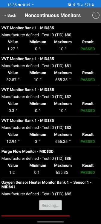

Hey @Bingodalton

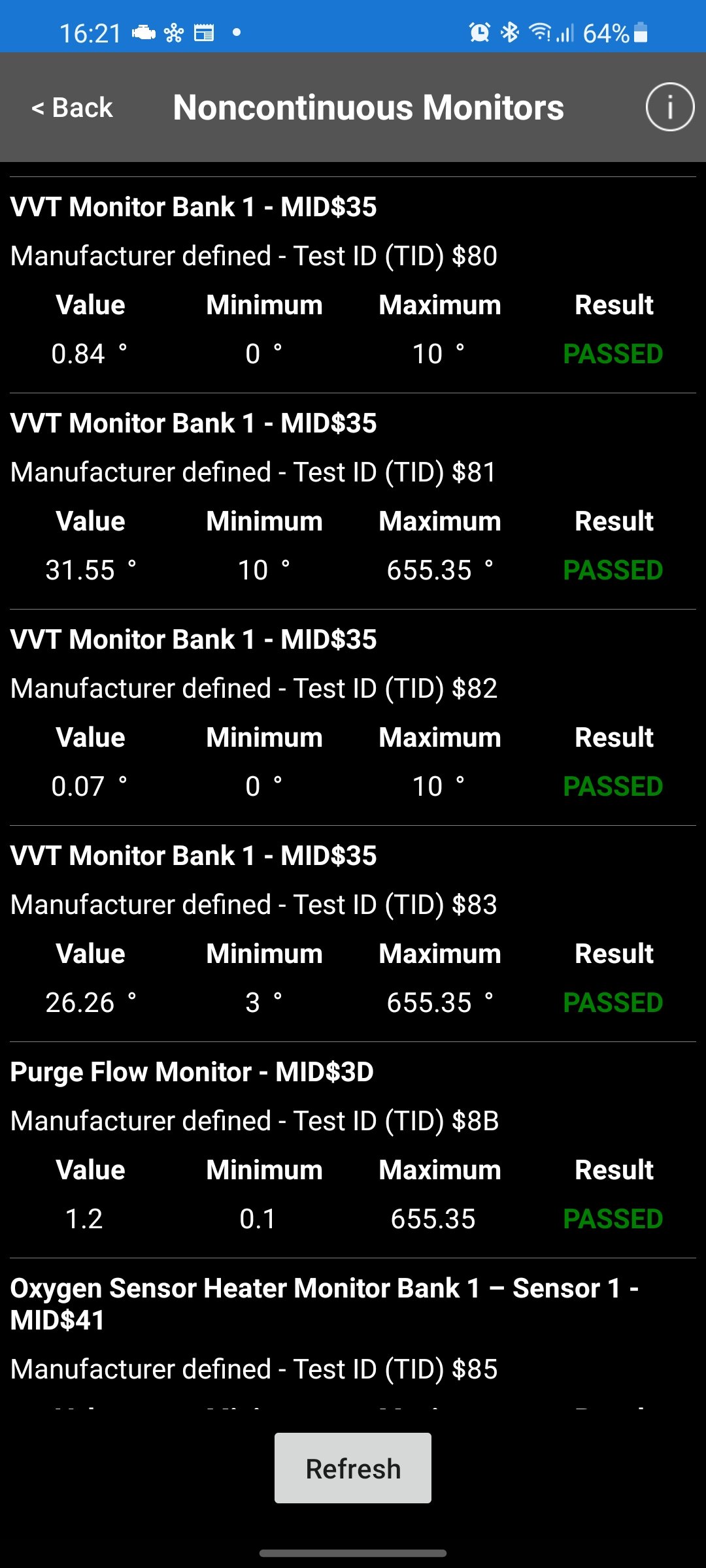

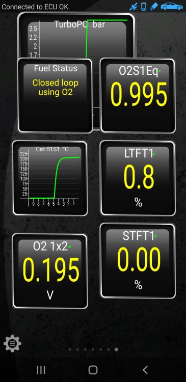

I've just hooked up my monitoring to the car and I don't have "Camshaft Adjustment Intake Bank 1" but I do have "VVT Monitor Bank 1"
Here are the results:
Do these look out of spec to you?
Give me half an hour, will reply
Give me half an hour, will reply.
This is when engine is warm?
Guessing by vcds, first value is echaus specified, then exhaust actual, then intake specified, then intake actual.
After engine settles from cold start, first one is 0, as well assecond one, third one probably depends on engine. On mine it is 15 or 16 and fourth one shoukd be +/- with third one, fluctuating. For example 14.2, 14.3, 14.2, 14.4,...
Check which ones are steady, defined and which ones go up and down.
Just at the Gym but will reply when I'm home. Thanks for your help so far @Bingodalton

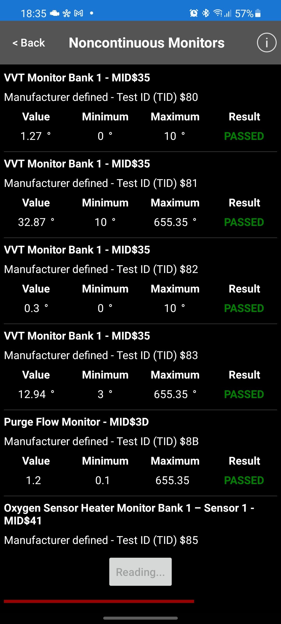

I checked on torque pro. These are not those values. They do not show the same value as on vcds.
@BingodaltonMy misfire occurs when the engine is slightly warm or hot. Usually when it's bone cold there are no misfires.
Here is the data from the engine being luke-warm:

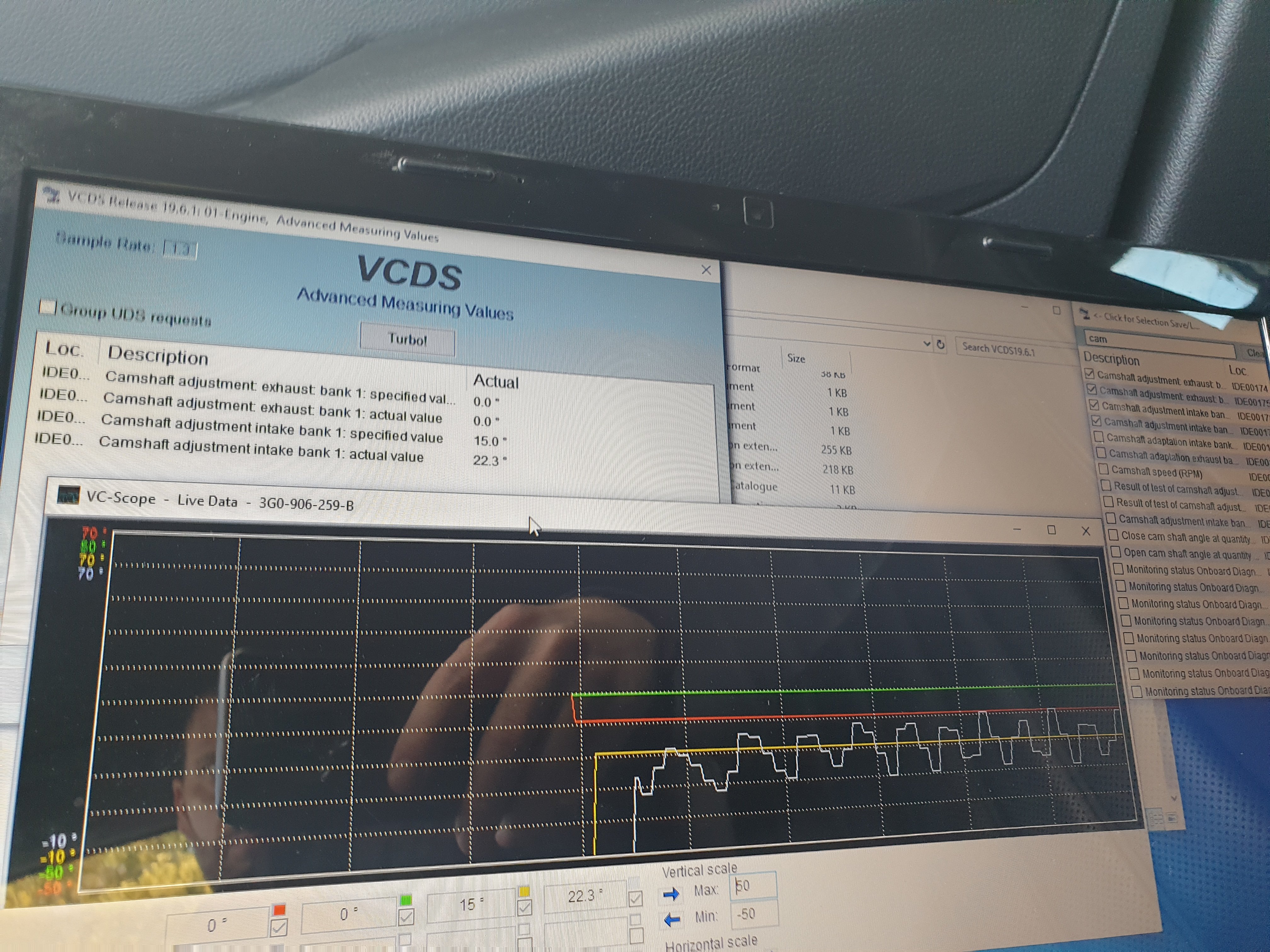

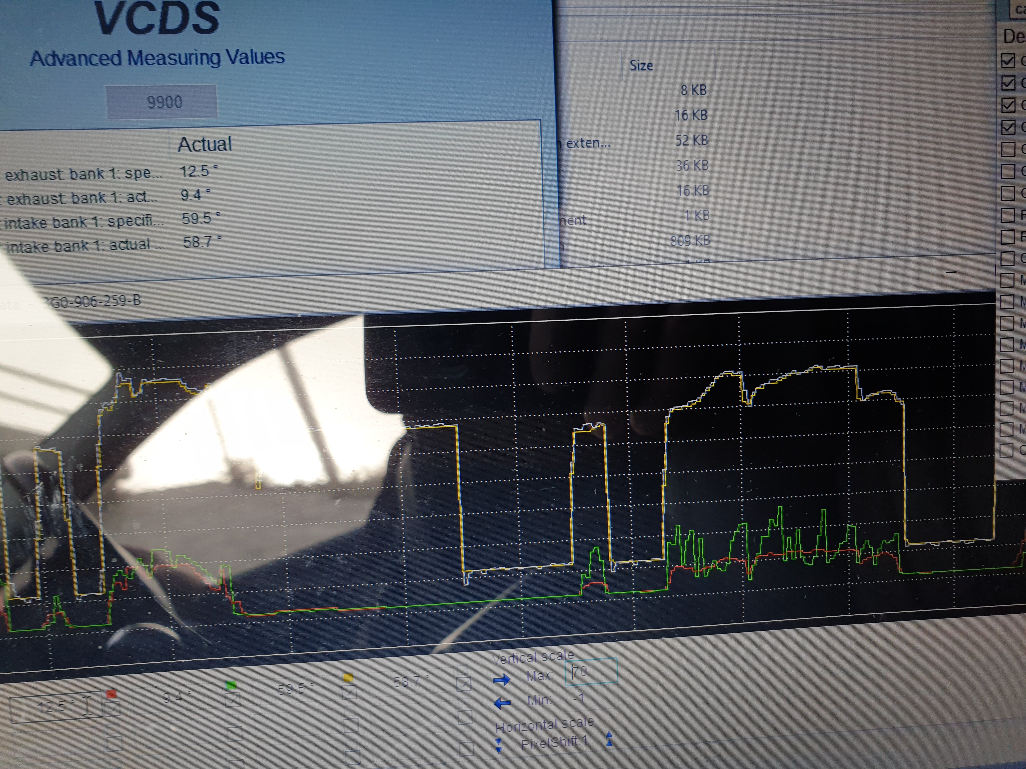

First picture, while driving.
You can see, upper two lines are intake magnet actual/specified.
Lower two lines are exhaust magnet actual/specified.
Difference between first two is less than 1, while for other two is more in some cases.
In data left upper corner, firs is exhaust, then intake.
Second picture is with old intake magnet on idle. Then exhaust is on 0.
You can see how intake tries to catch 15, going up and down.
You realize how good should work new magnet, following specified value.
