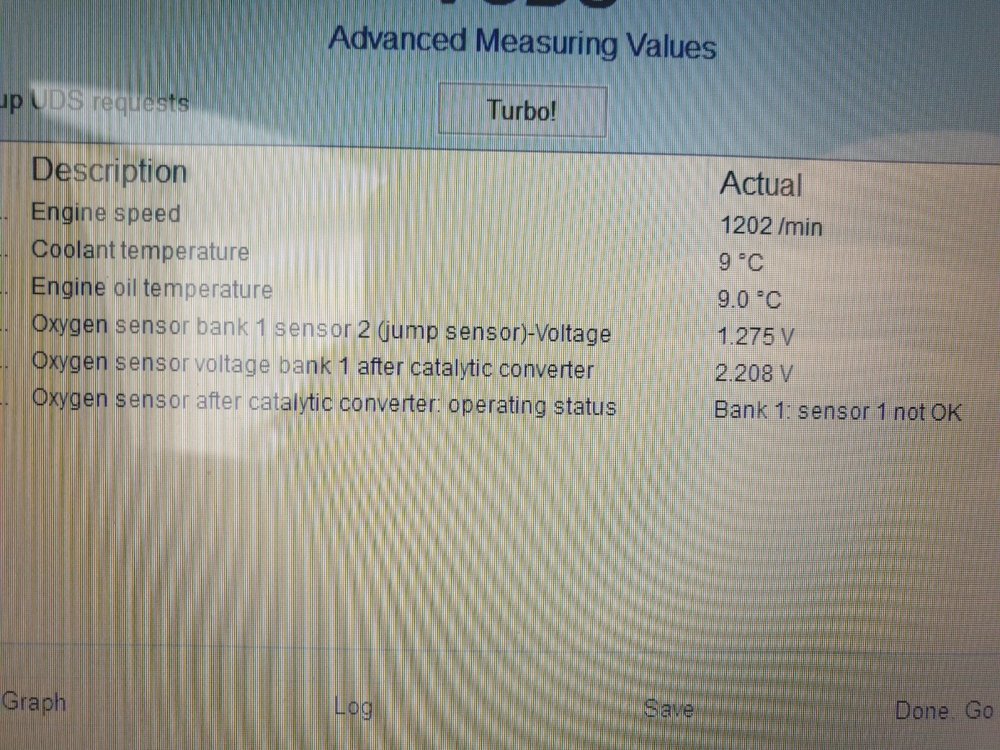

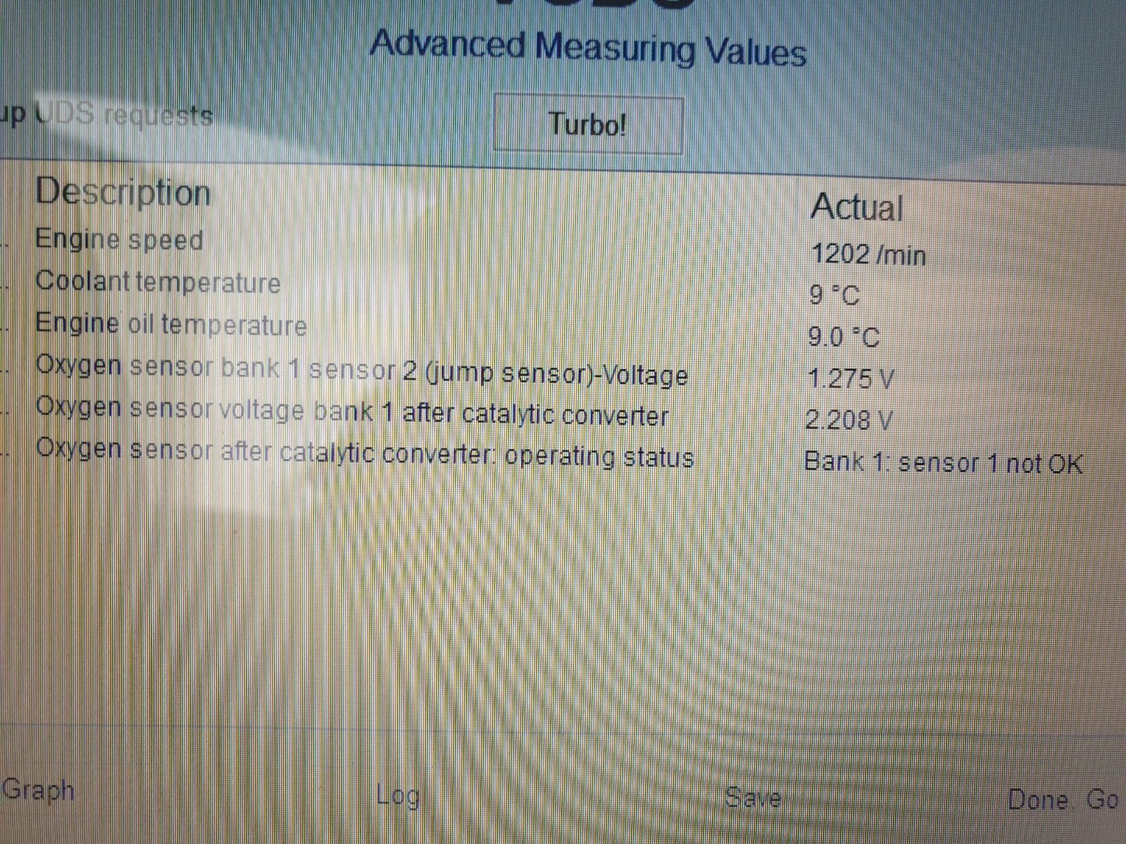

Could you check your 'Operating Status' when warm? Mine shows 'Not OK' but two days ago it was showing as 'OK'
I don't know if this value changes on the cat temperate, or if my post-cat o2 sensor is intermittently faulty.
Thanks for your help so far.

I will take you few pics this morning.
I think your O2 sensor is faulty, or to say I am sure.
Fortunatelly it is the cheaper one.
If you tell this data to any mechanic around you, they will say the same.
Except there is some other reading for Sensor 2, but I am also sure it is this one.
You can try to disconnect it and see the difference by urself.
It alsi has logic to your negative fuel trims, it is reading Rich condition, and thus removing fuel constantly.

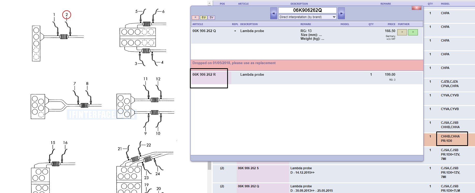

Thanks @Bingodalton
In case my sensor is faulty could you give me the part number? I'd image it's the same as your superb.

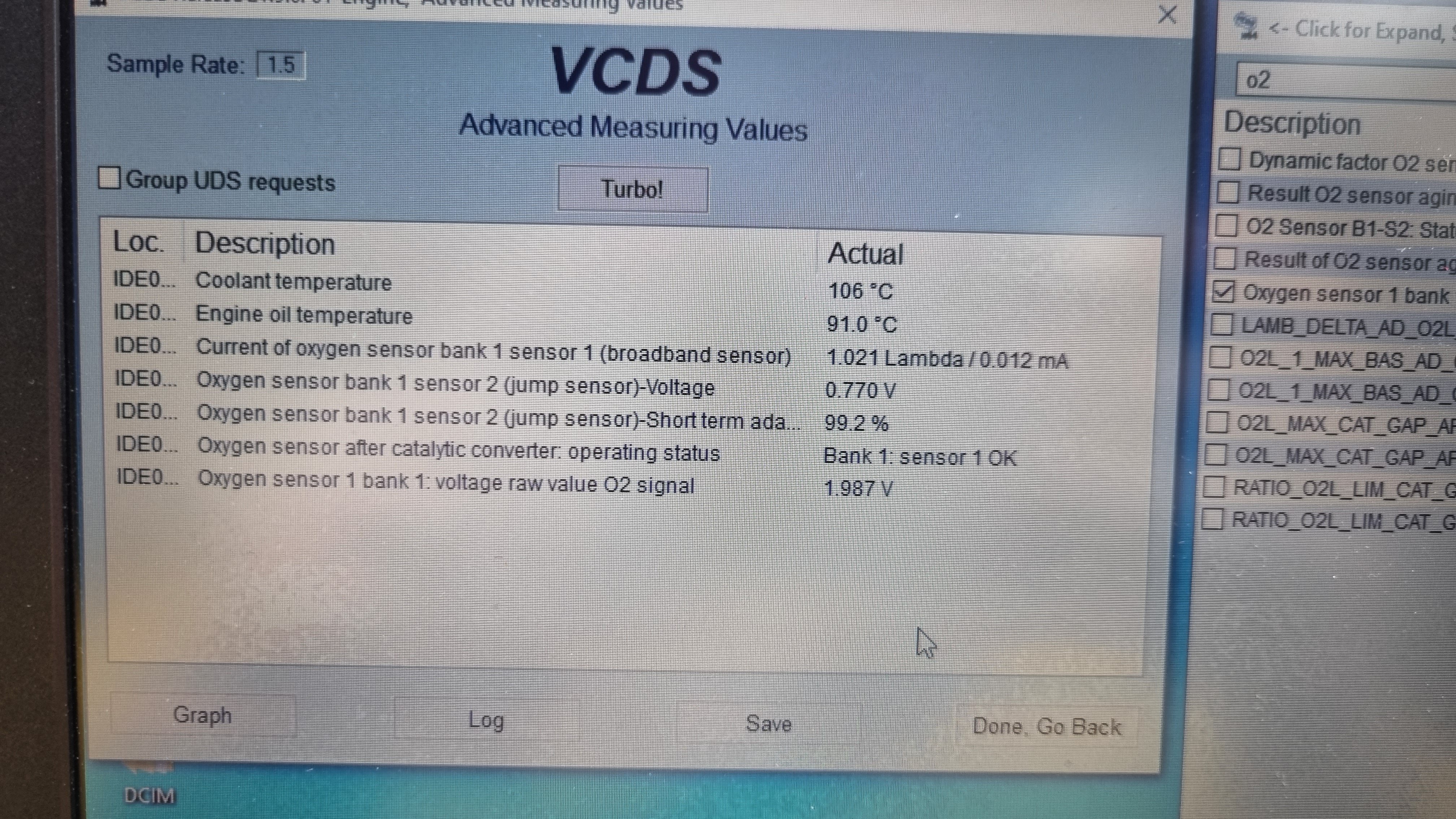

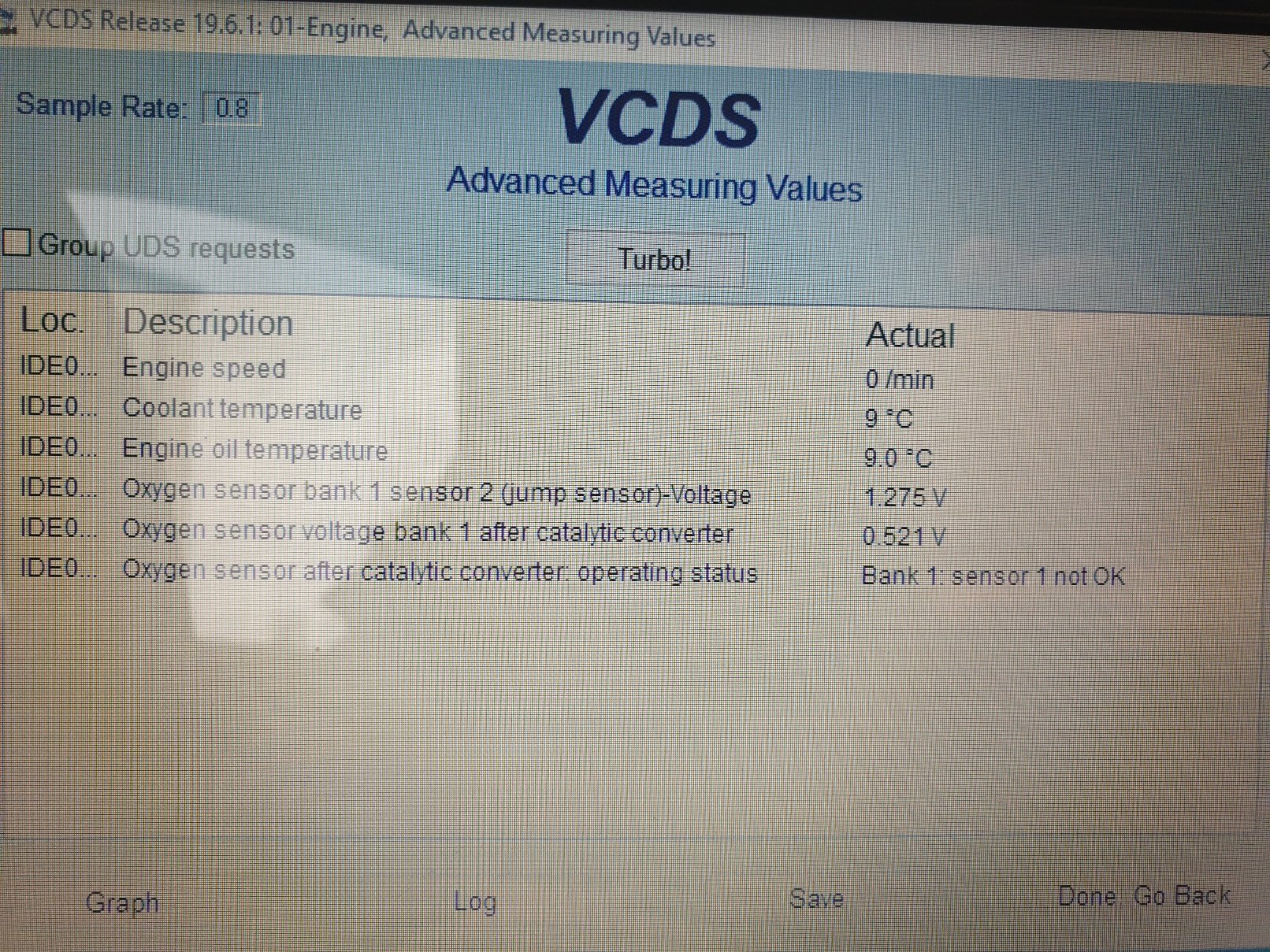

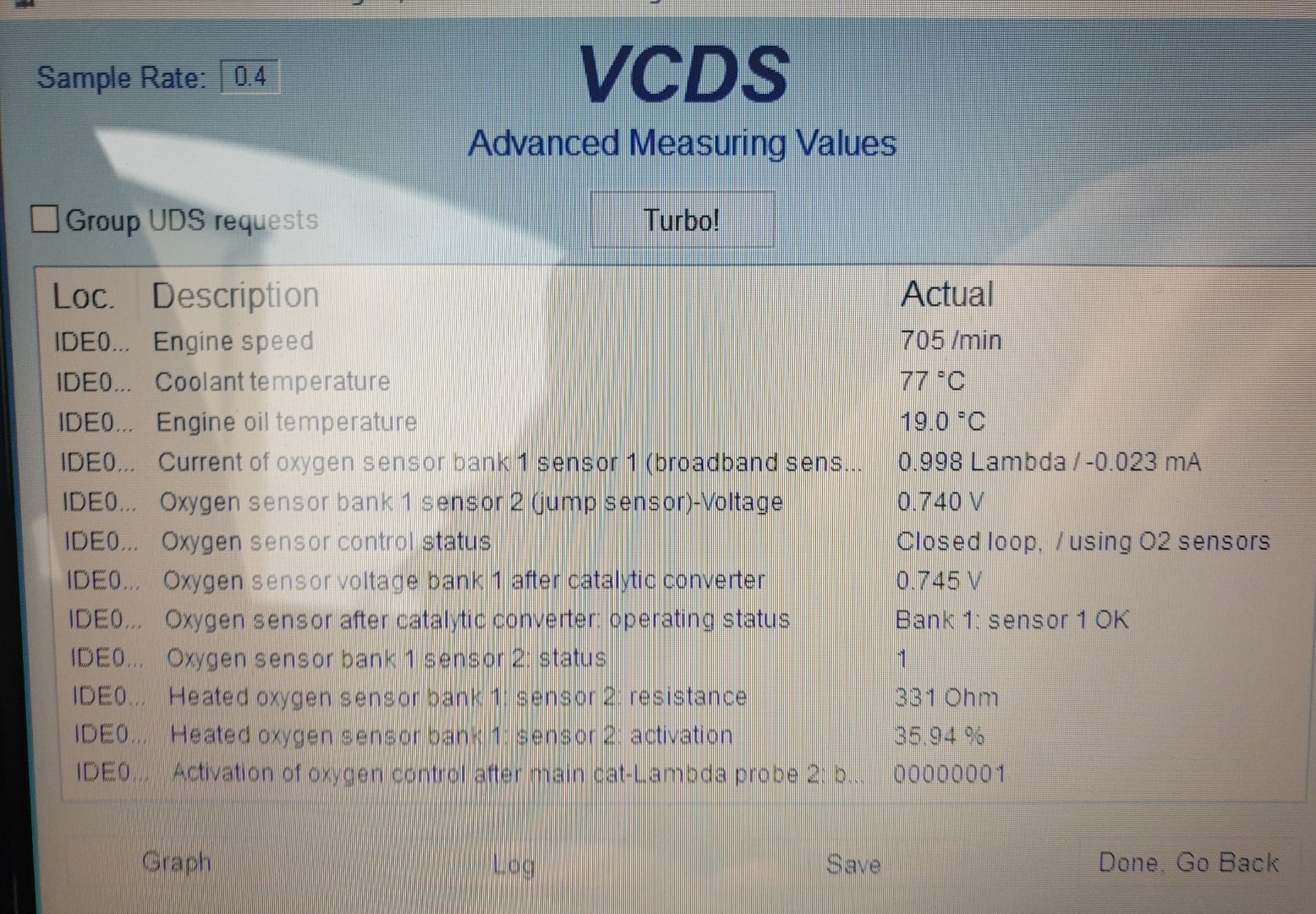

Here are data.
- not started
- started
- cold
- heated

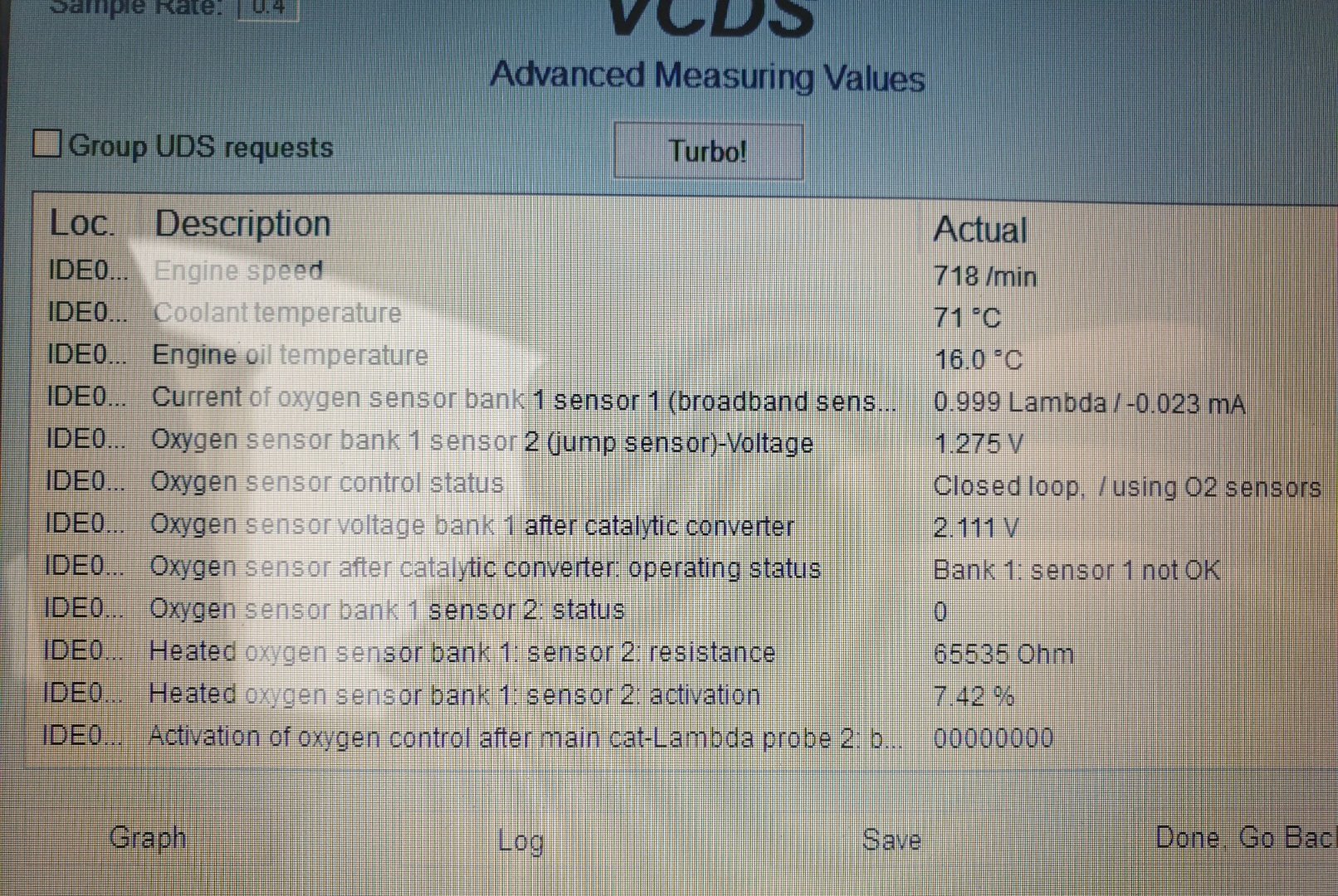

Check if it ever starts to change voltage from 1.275V

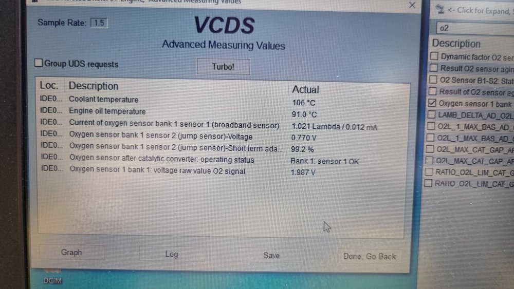

@Bingodalton I took the car out and drove it quite hard. Here is the results:
This looks fine then. Is it working better after hard drive?
Is O2 sensor changing its behavior when you are at idle and it is cooling down?
Have you checked for errors with VCDS now when you have it? Do the AutoScan.
If I get out of the car, and then get back in 30 minutes later the car will misfire at idle.
The O2 sensor reverts back to 1.275V when this happens.
The car has one fault for the N82 valve, but this is just a fault with the heater matrix. I'm fixing this myself in a couple of weeks. This shouldn't cause misfires.

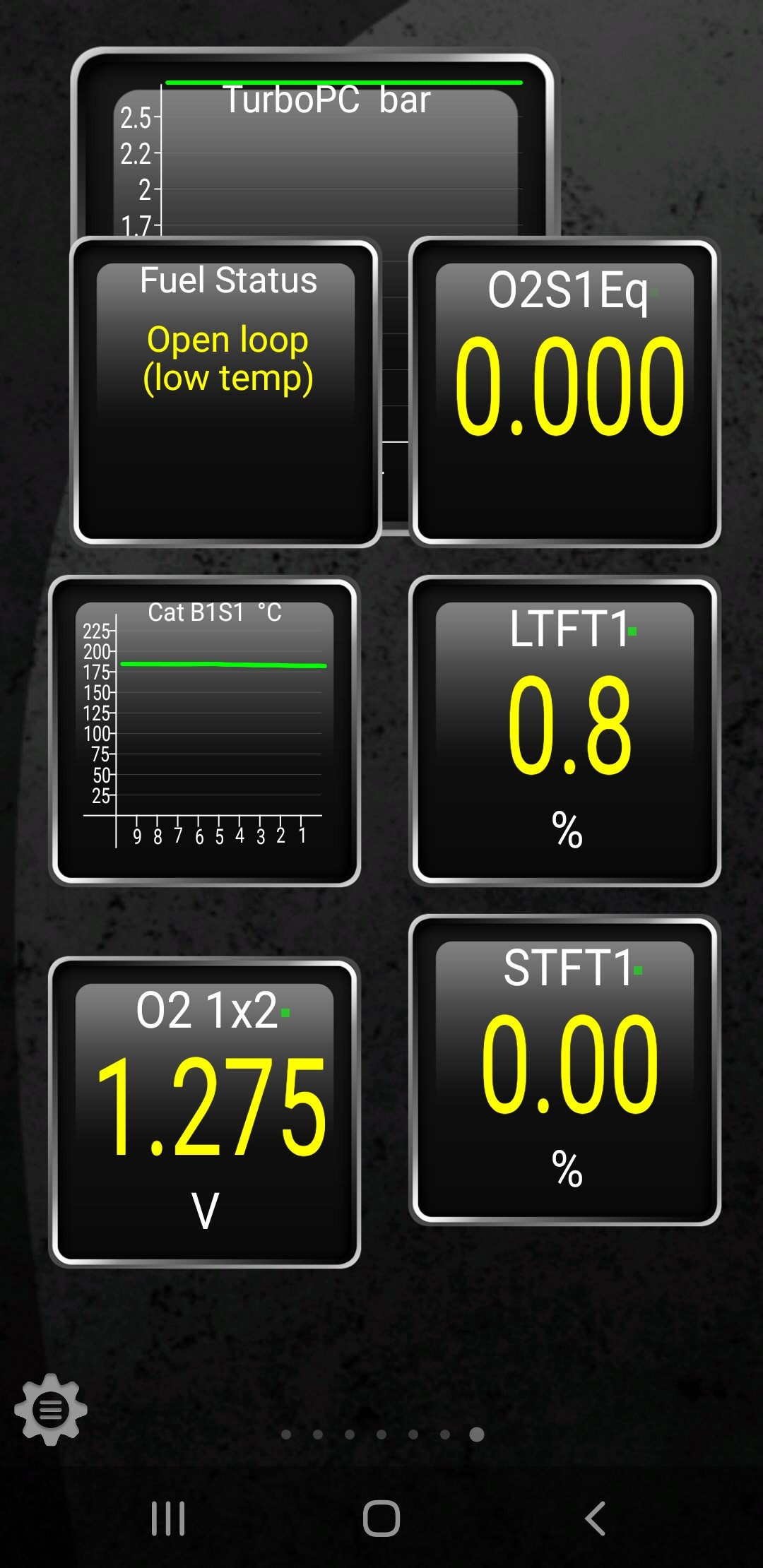

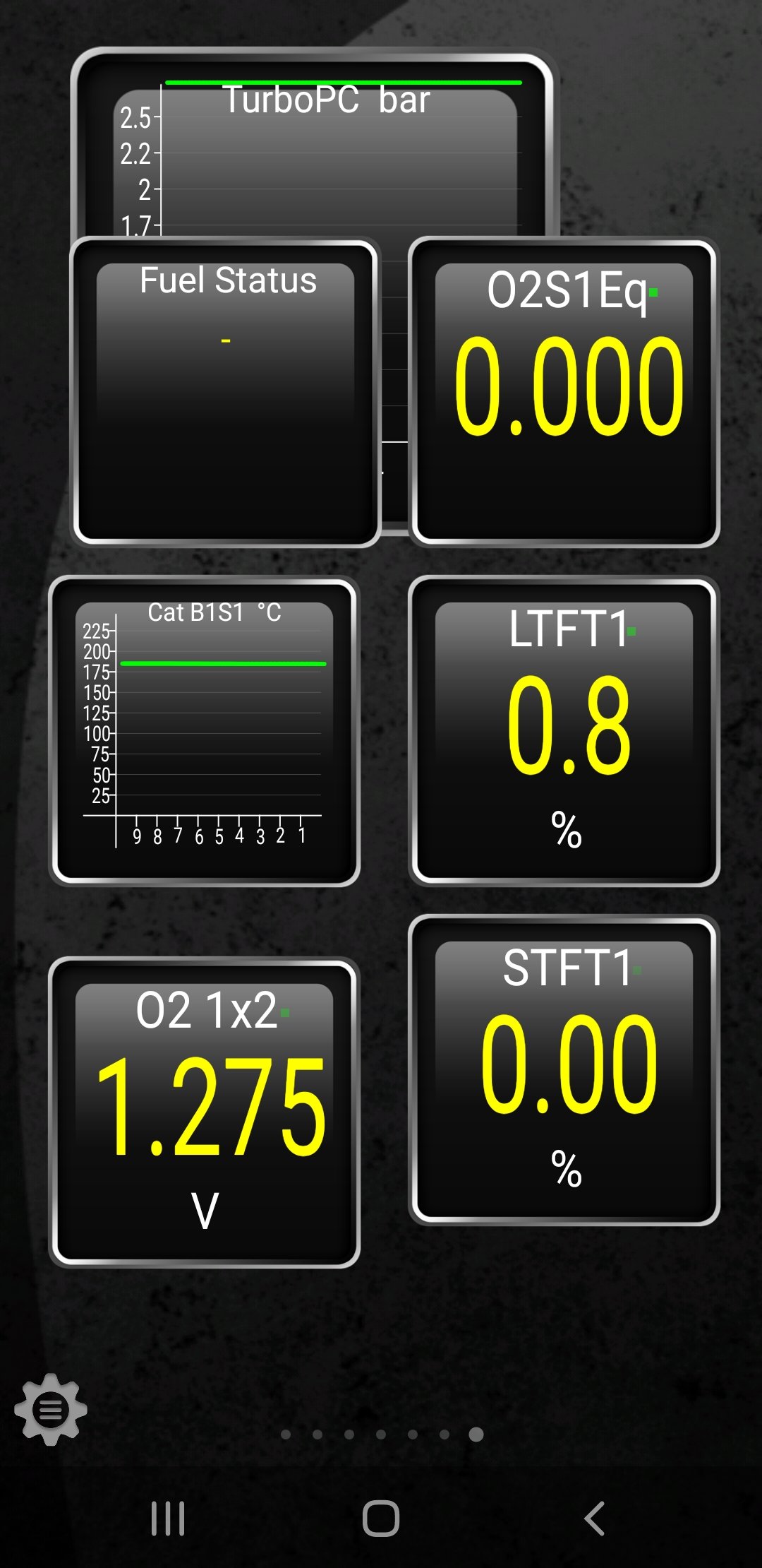

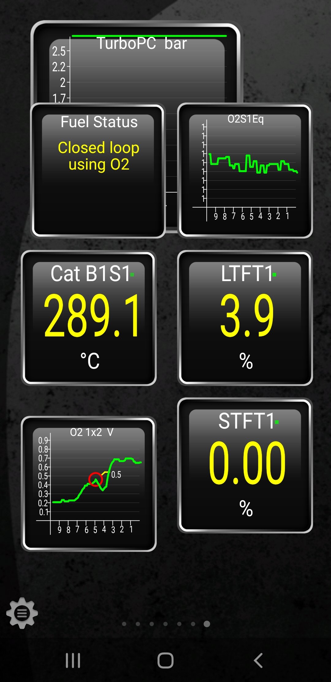

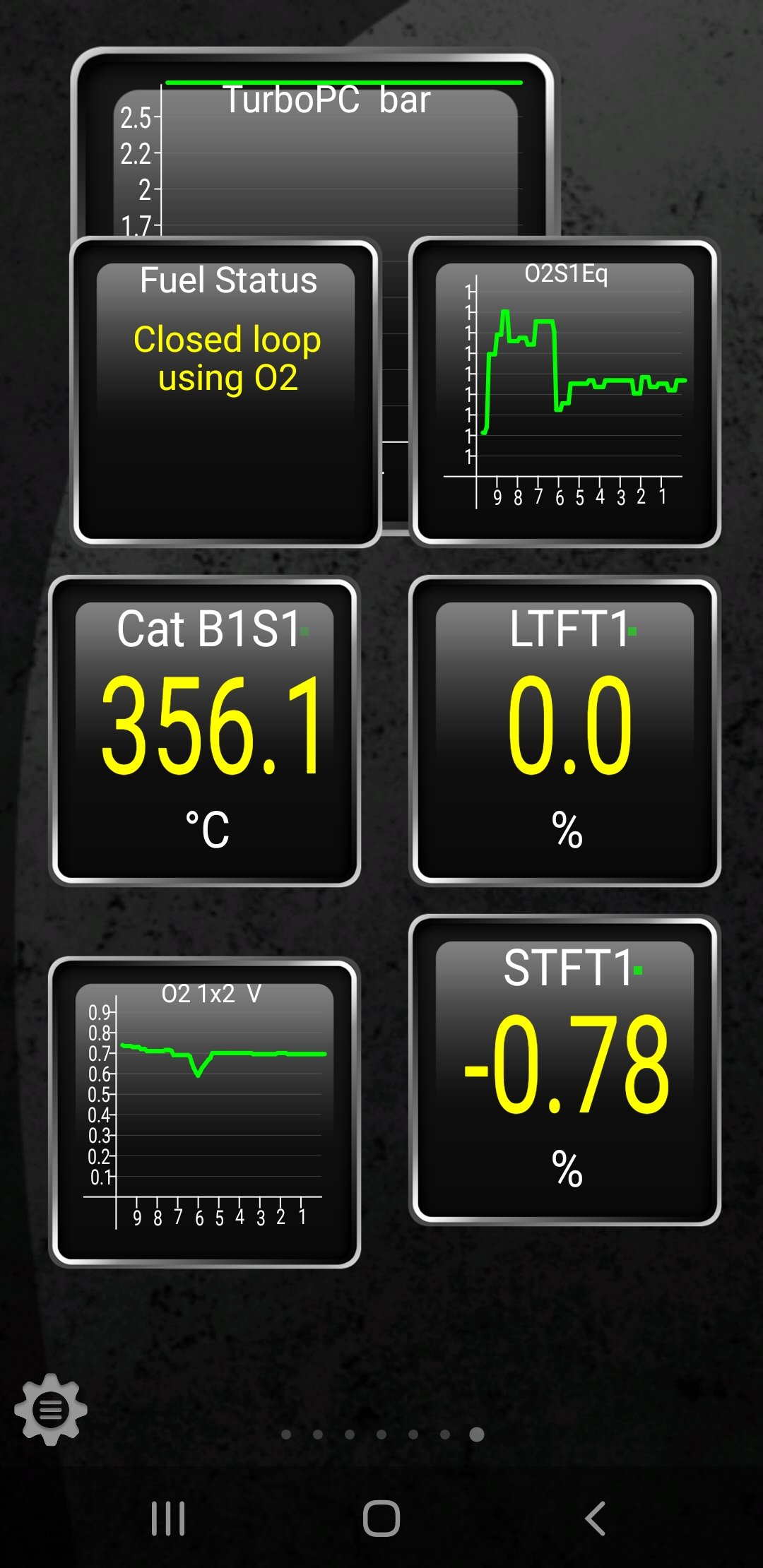

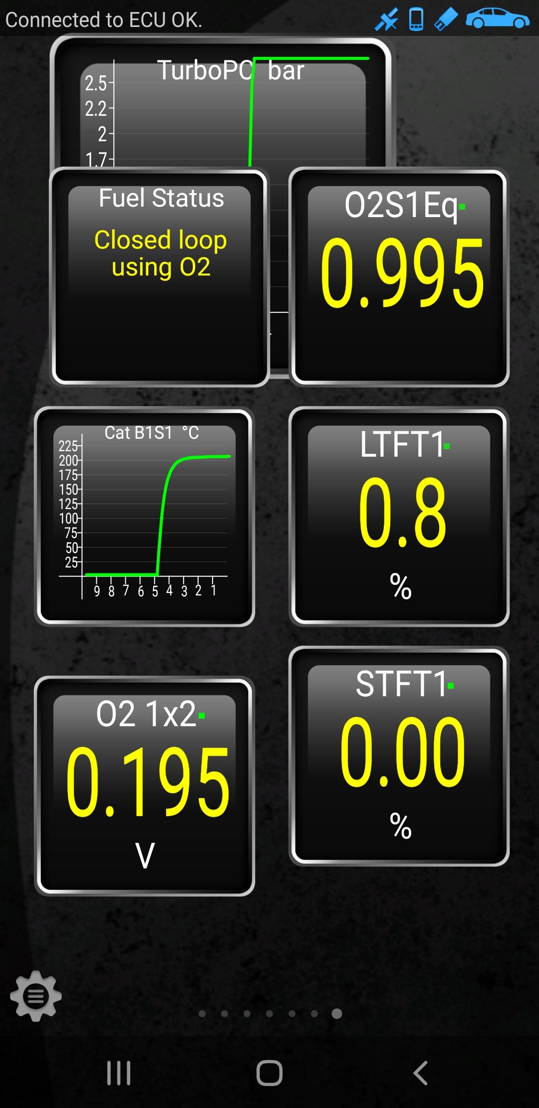

I did it with Torque.
Engine not running
- Emgine started - around 50c temperature
- Engine running after 10s. Cat is still cold.
- Engine running, cat heated
 - Engine running, cat heated.
I had to run it on 2000rpm in order to heat it. If I leave it on idle, cat temp goes down, and O2 S2 goes to 0.2V again. Not consuming O2.

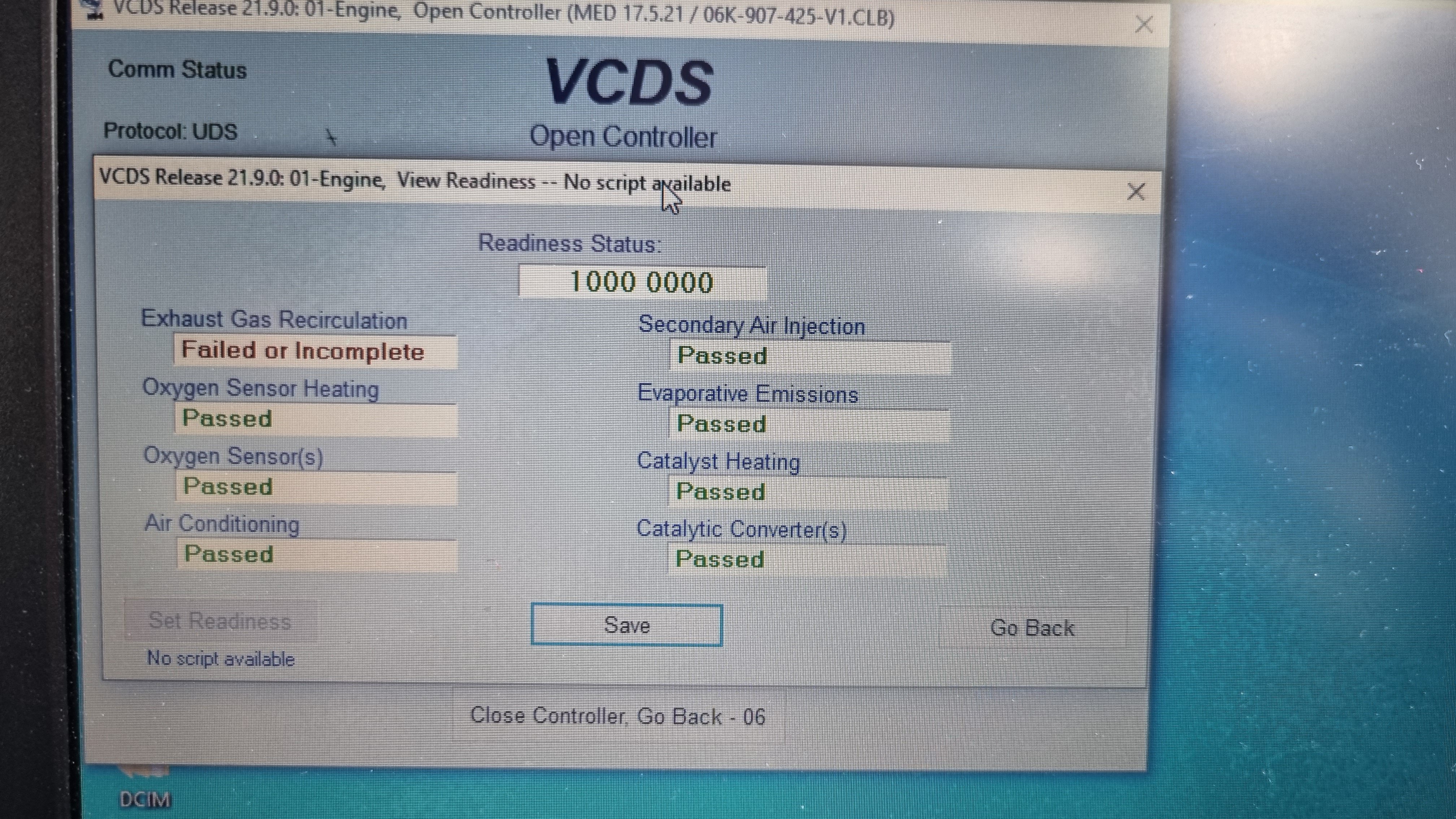

What your readiness say? What did not passed the test?
Vcds > Engine > Readiness
Hi @Bingodalton
Sorry about the delay replying, work has been hectic.
Here is my readiness:
As my car is a Petrol I assume I don't need to worry about the EGR failure?
Petrols have EGR too.
Isn't that controlled via the VVT on the Petrol models though?
I have this afternoon just swapped the magnetic adjuster on the intake cam so maybe that's why it's showing as failed? I know it can take a few miles of driving to pass readiness tests.
Edited by the_slug
Probably, yes.
What year and engine code?
17 minutes ago, Wino said:
Probably, yes.
Hey @Wino!
2014 CHHB (220PS)
Interesting.
Must be controlled via the VVT then. So I guess I just need to drive more to get the readiness to "Pass"
I replaced the intake magnet and took it out for a drive, then ran a scan so I guess I haven't driven it enough yet?
Check in few days, after some miles
