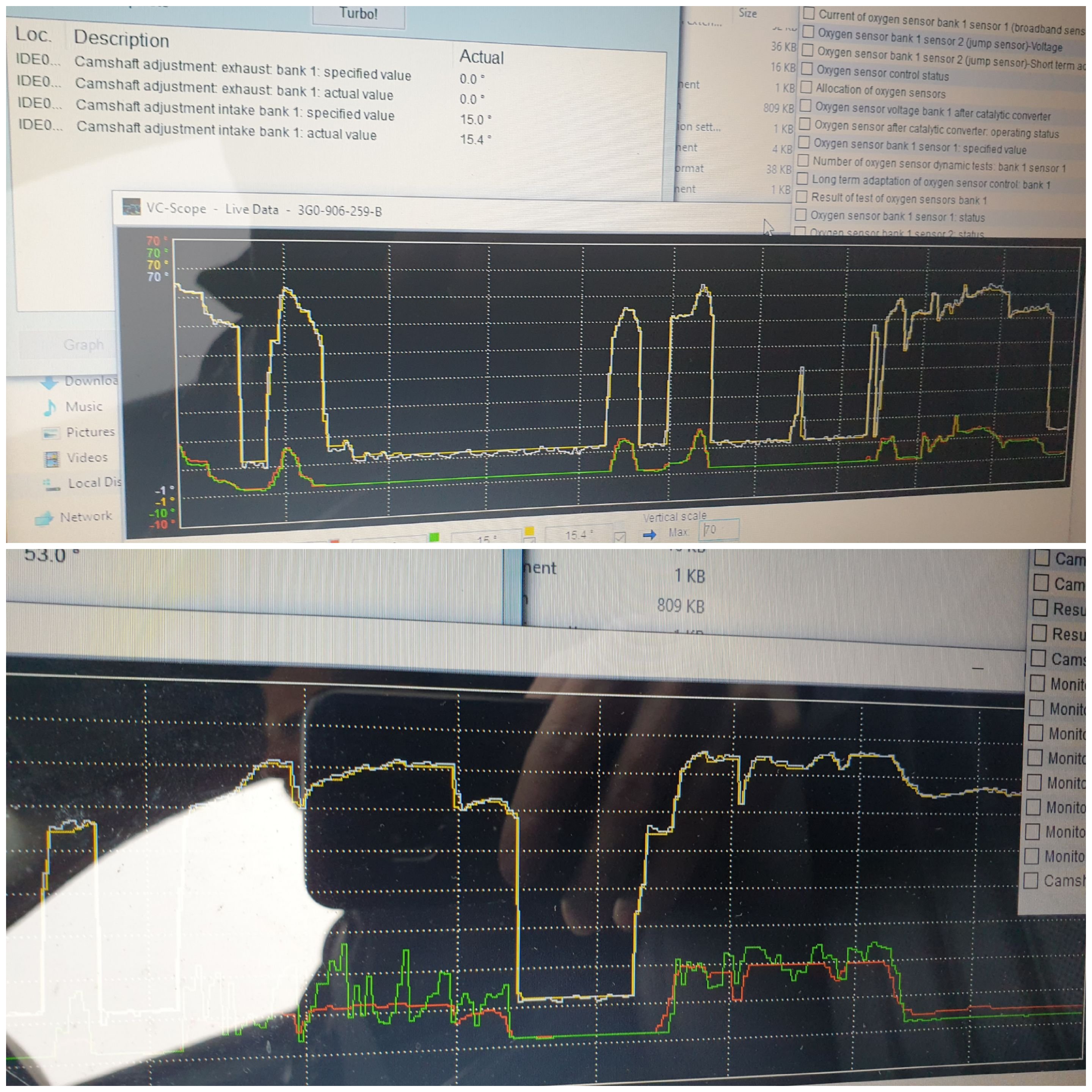

Old magnet, 2 days after cleaning.
New magnet.

New magnet for exhaust camshaft installed and here are new graph vs old graph.
Red is specified, green actual.
I can not feel the difference, so its minor, but still it is visible how well it is working compared to old one.

Exhaust one was sticky too. I will record it also.
It is visible by data on graph and it sounds different too.

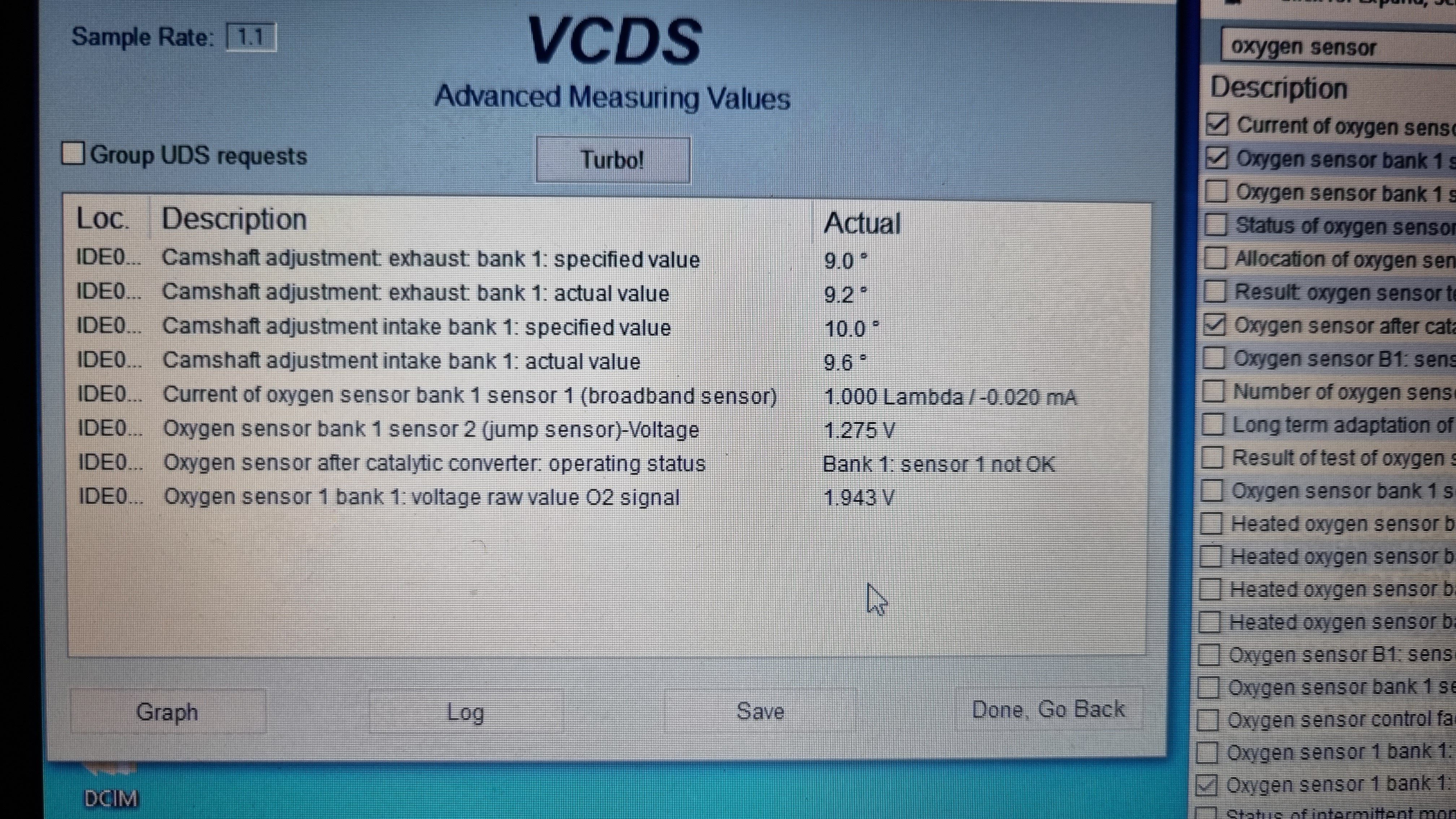

@Bingodalton

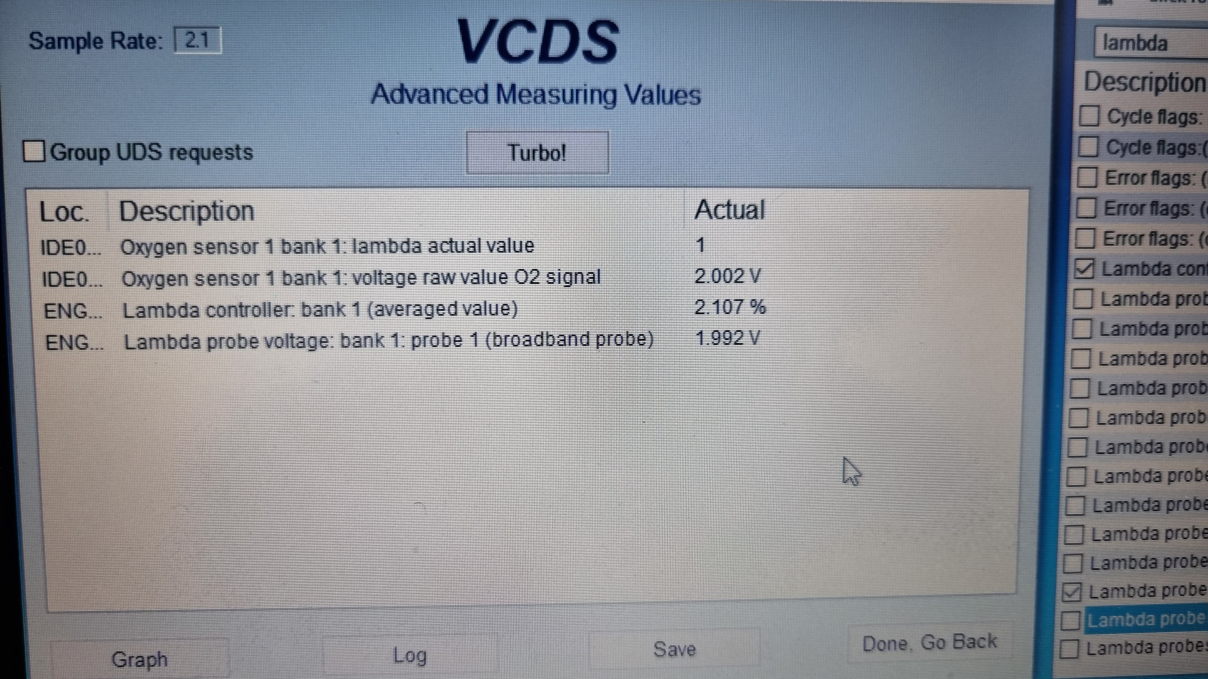

I'm still waiting for my adjuster to arrive, but in the mean time I've checked pre-cat O2 readings via VCDS.
Do they look right to you?

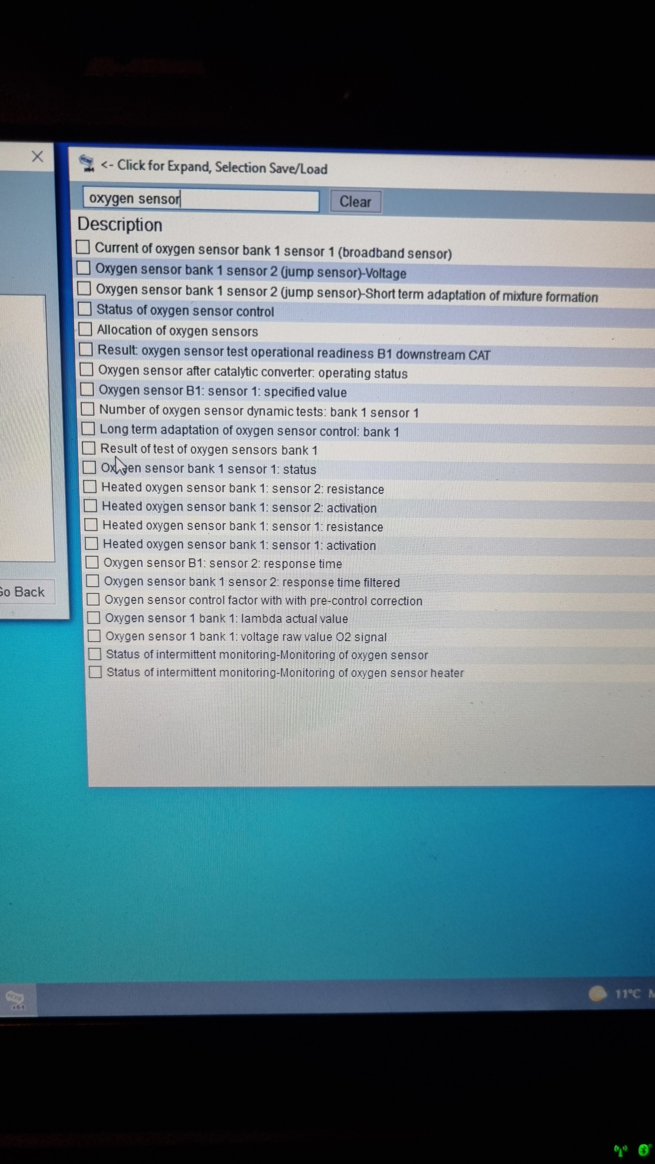

Can you check the adjuster. Camshaft Adjuster intake and exhaust. What are the readings?
My Lambda has 4 decimal places., broadband probe is there at 1.9xx V, but Lambda actual value goes from 0.9902 to 1.088, strange you have just 1.
Averaged value is there, depends, from -0.2 to up to 3.0%, I am looking at some video, before I changed magnets.
You can check Oxygen Sensor bank1 sensor 2 (jump voltage).
Hi @Bingodalton
Here's the data you asked for:
Your magnets look ok 😞
At least when you took your photo.
I guess intake one is not fluctuating a lot.
Your sensor 2 looks way out. Its value is between 0 and 0.9v, notmally 0.2 to 0.7V.
They say when cat is working and warmed value is around 0.7 to 0.8v, as it is removing oxygen from exhaust gases and indicating rich value.
Your log is showing rich value, way too rich.
While lambda is showing that it is good air/fuel ratio.
Is it warmed up?
If yes, then you can follow just lambda where it is 4 decimals and Sensor 2, click on graph and look at it.
Both should be still, flat lines, almost.
Depress the gas pedal few times and take a look at the graph.
Check how both sensors behave.
Lambda goes up and down very fast and steep, while Sensor 2 goes down and slowly up to flat line with little fluctuation when you release gas pedal.
But, O2 narrowband sensor should never show above 1V, so it seems it it broken.
Check if value is moving at all.
Could be your problem, that it is correcting your fuel trims.
You said they are negative?
It even say this sensor is not OK, but maybe it is not warmed up yet.

The intake magnet "actual" struggles to keep up with the requested, but it does eventually settle around the same number. So I still think it's worth replacing.
Yes the car is warmed up.
Can you let me know the name of the two sensors I need to graph? There's a lot of them available 😆
Camshaft magnets will always trying to keep with specified value, but as I see i range of +/-1.
You need to check values with "broadband sensor" and "jump sensor".
First one if upstream, before cat. Other one is downstream, after cat.
They are different types, so they do not behave same way.

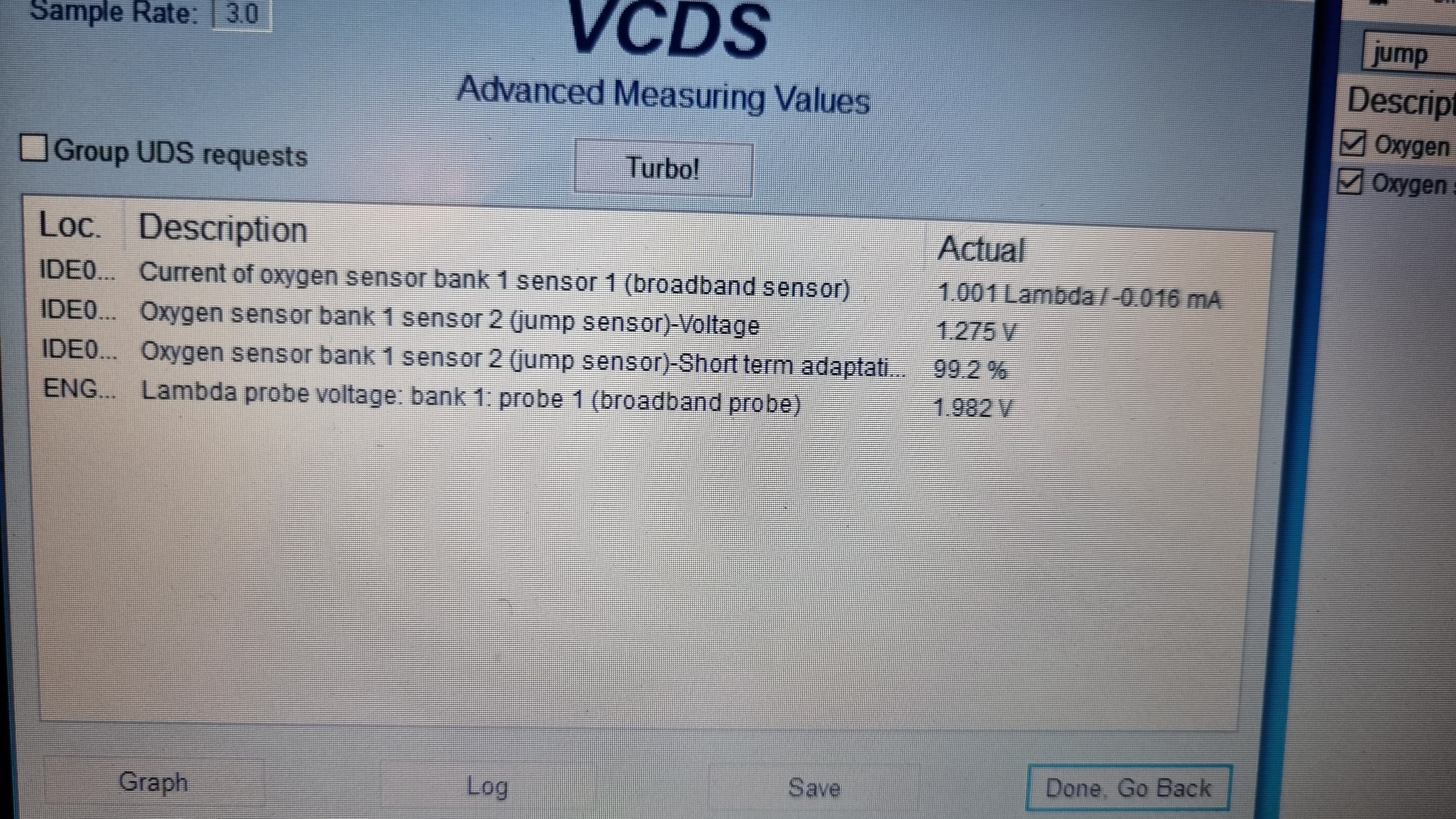

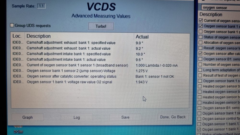

Your sensor 2 is not changing voltage at all? 1.275V always?

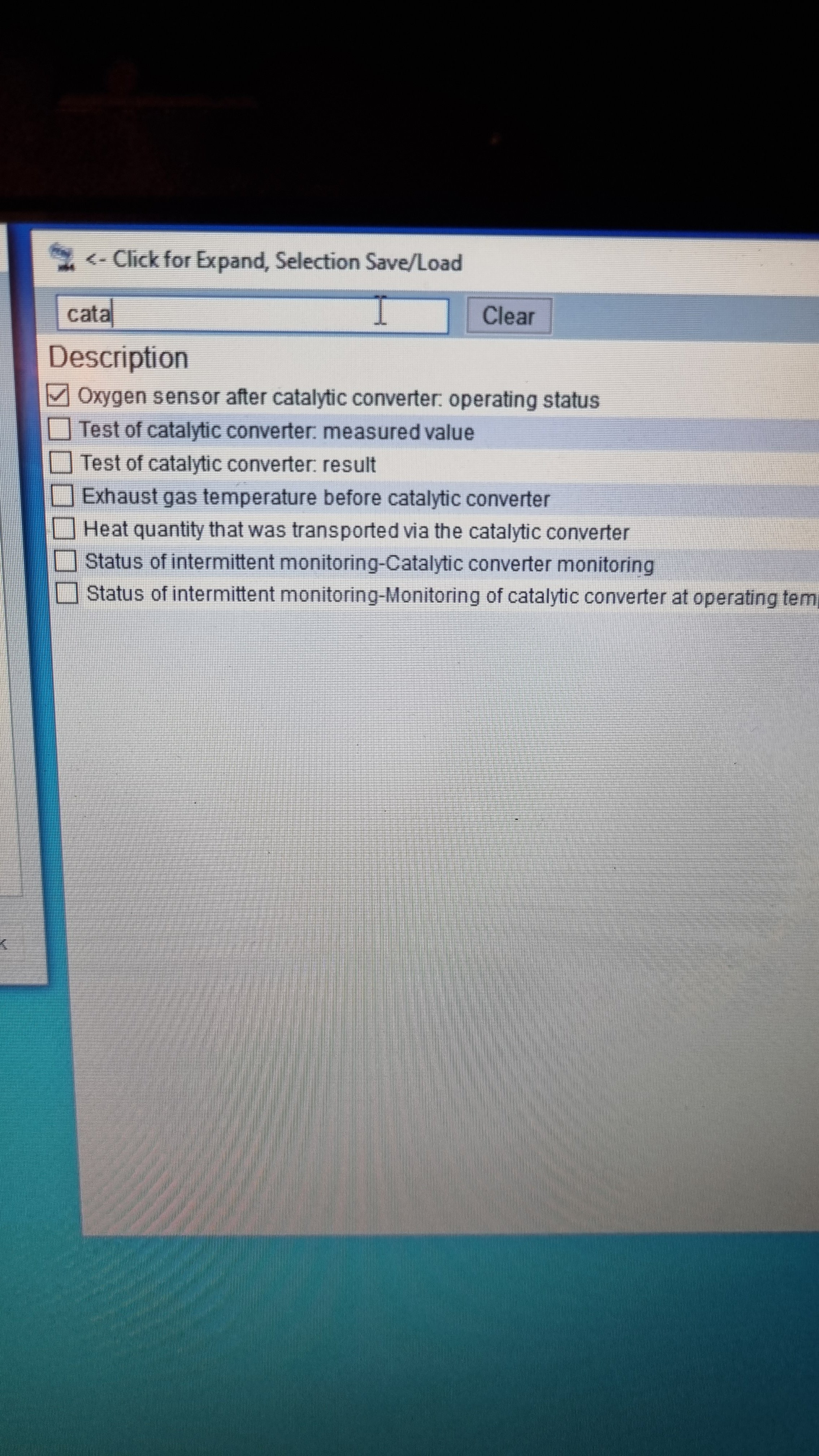

Can you check Oxygen sensor voltage bank 1 after catalytic converter?
This should be read same as Sensor 2 jump sensor voltage.
It should not go above 1V at the first place and it should fluctuate a bit.
It is faulty O2 sensor or some wiring problem.
You do not have downpipe without cat?
No, the sensor always stays at the same voltage.
I don't seem to have that sensor available?

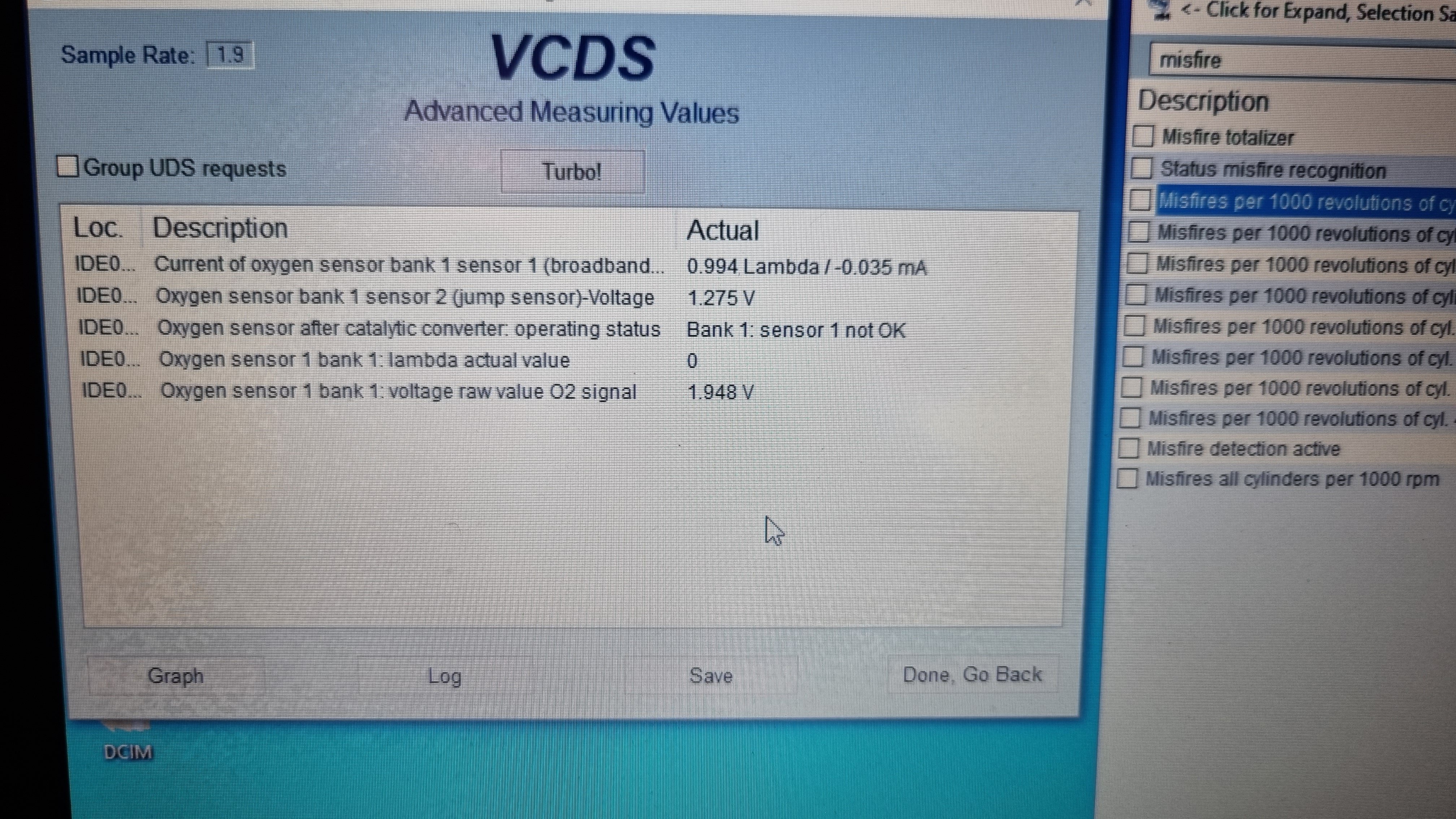

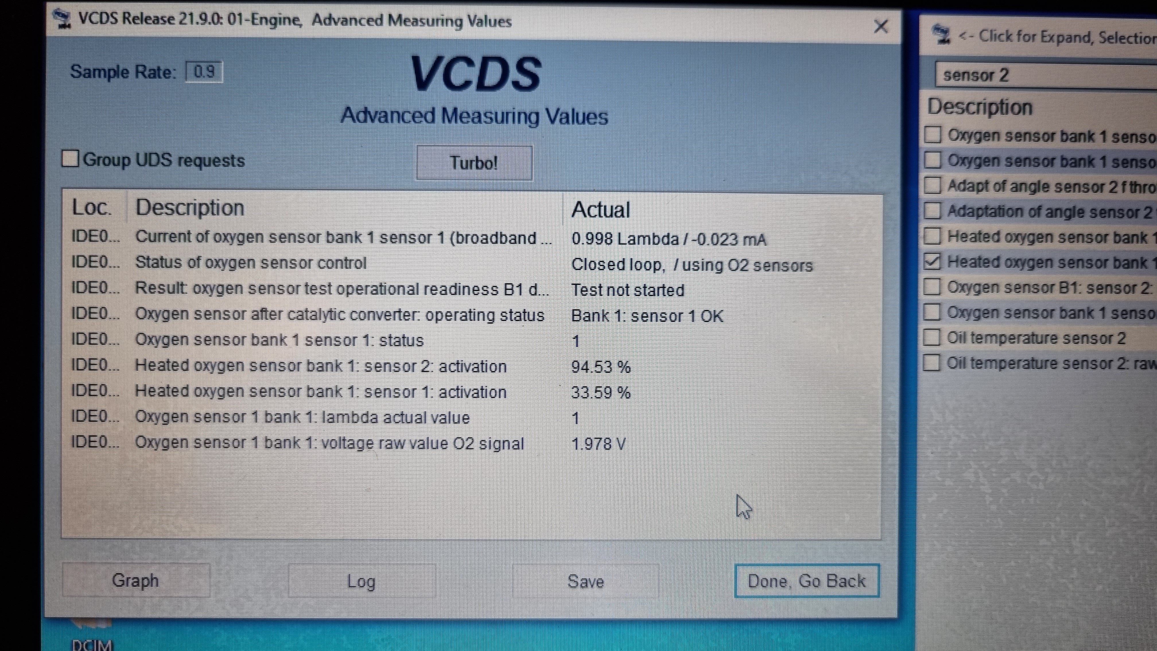

20211125_204019.thumb.jpg.18a61d20f522298d9a71469206115c03.jpg20211125_204433.thumb.jpg.192c0db33c0f52c73dfc0abafe7a11d0.jpg

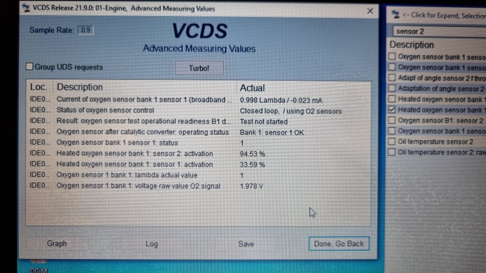

Here are readings from just now:
I would say that this sensor is not working at all.
On mine, this value is 0.7-0.8V
