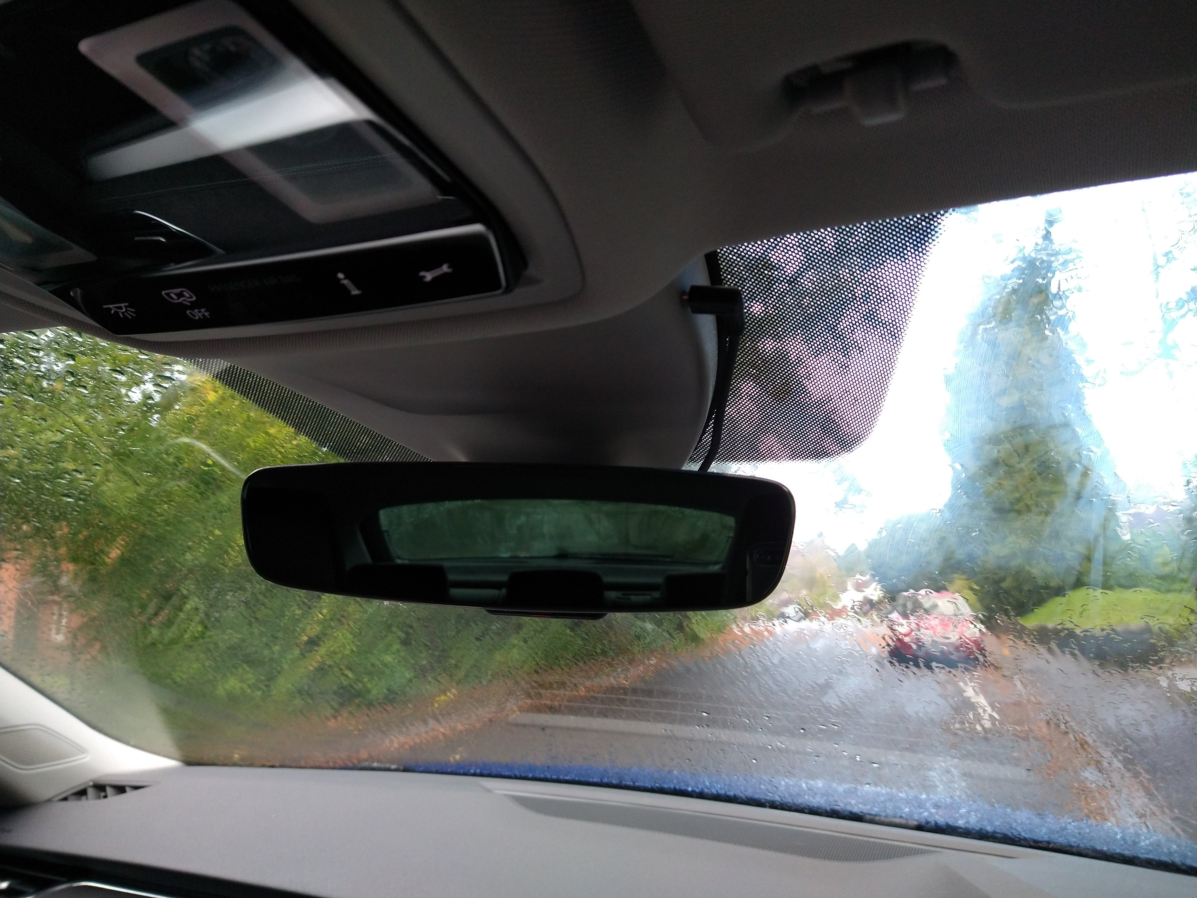

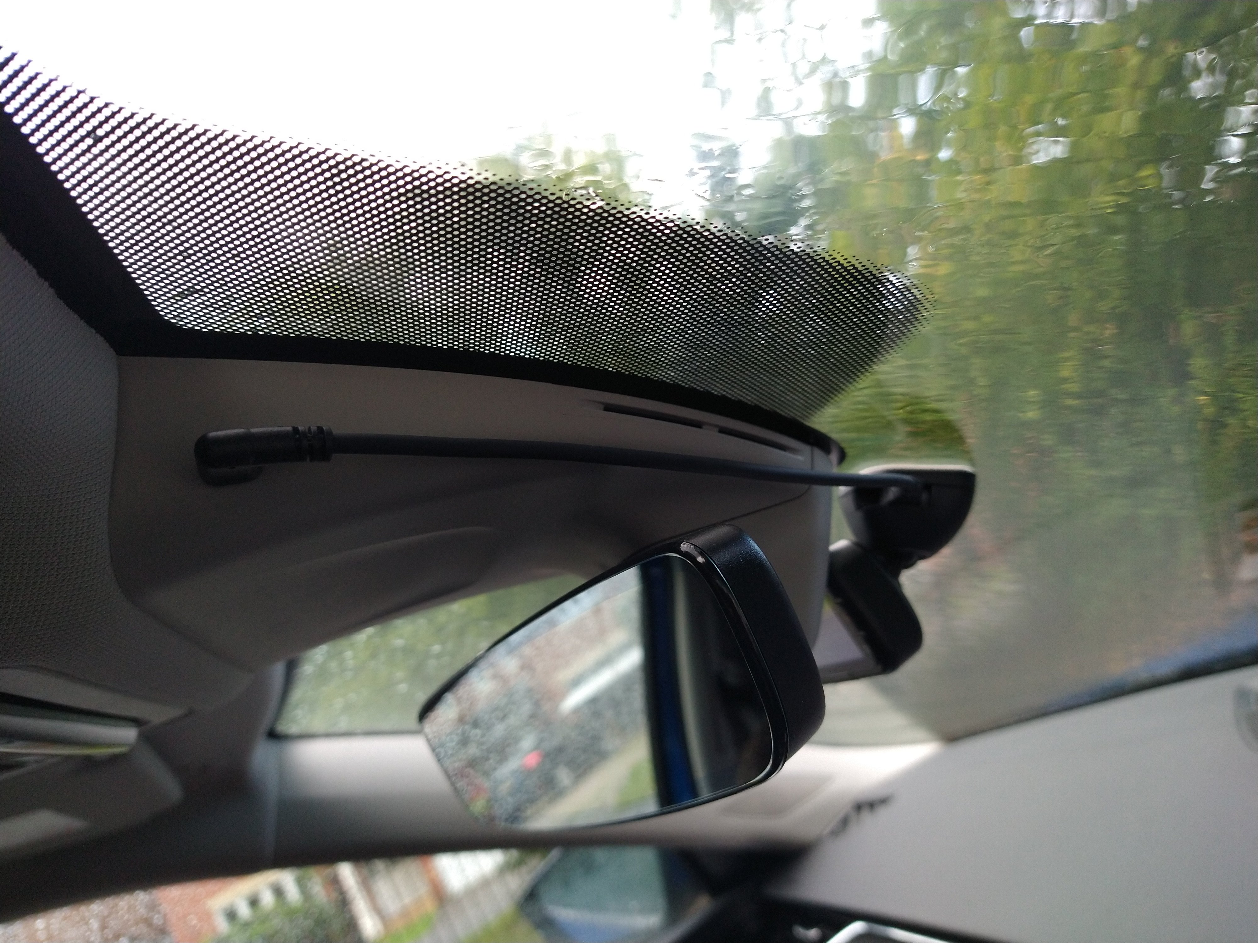

Hi James,
Sorry I never got a chance and actually ended up making a custom cable and then wrapping it with the hdmi extension cable from my Nextbase 622GW. I have the Nextbase rear view camera module and extension (not the one that sticks to the back window) that is stuck to the front screen. Both the USB and HDMI cables are wrapped in the black OEM fabric tape that is hidden behind the mirror. I'll take a wee pic or two tomorrow when it's daylight to show you what I mean.
It does the job just nicely and more importantly was non destructive and removable.
John

Hi James,
Sorry to hear about you being rear ended. Hope no one was hurt.
I took a few pictures today, sorry but the light is overcast today but you should get the just. You can see them here.
John

Many thanks for this John. That looks really neatly done, and as you say, easily removable too. Out of interest what are the pictures like on the rear camera? I'm very tempted to try this route of having a rear camera.

To be honest, I haven't actually downloaded any footage yet. It's obviously not as good as a dedicated camera on the rear window but you can see the cars behind you on the wee preview. I'll upload a test video for you soon.
