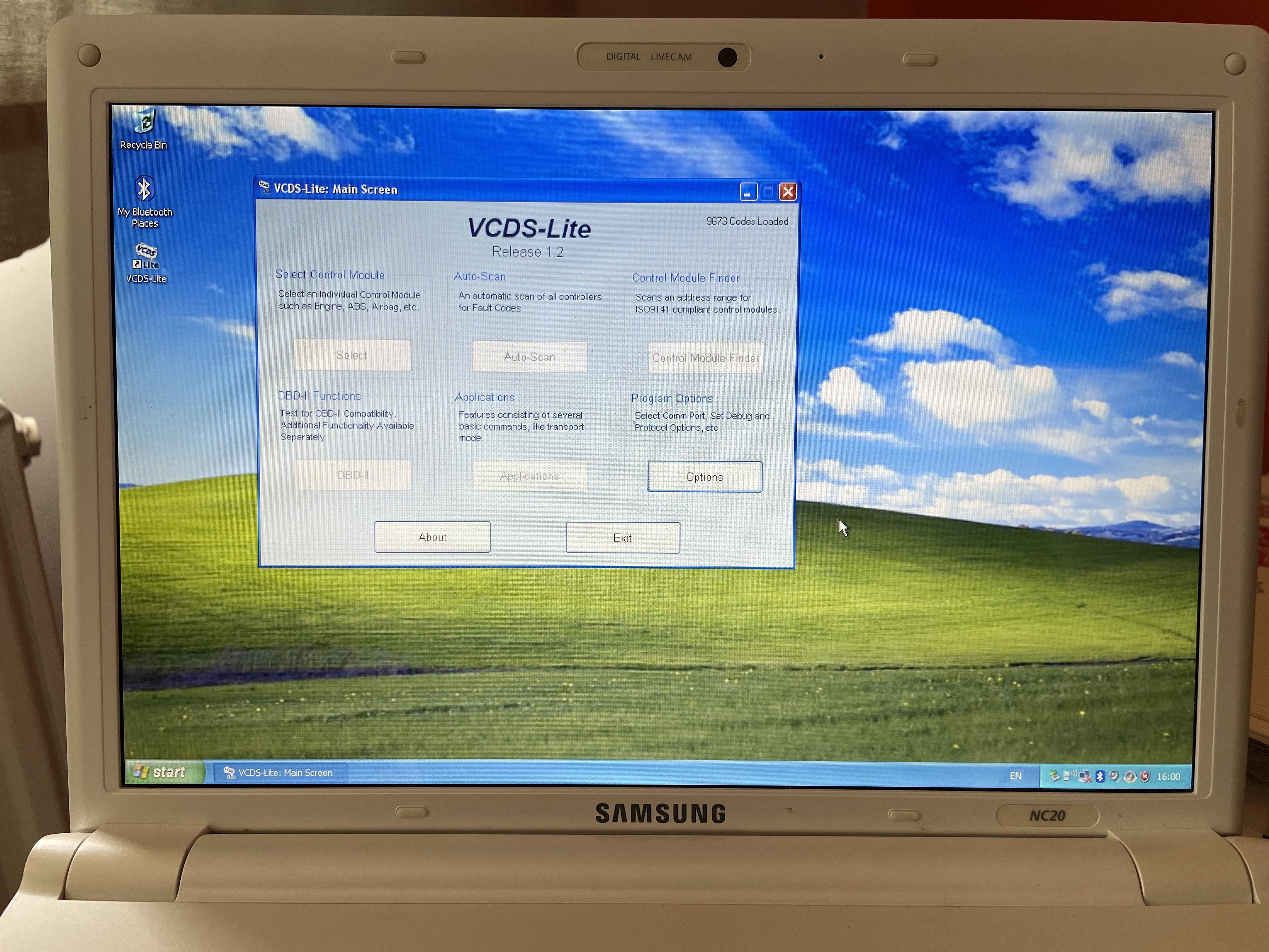

Oh Windows XP how i've missed you.
VCDS Lite ready and waiting for the cable to arrive.
Hopefully we'll have an answer to this one by the end of the week.

Let me know how you get on with it. I've got a Windows XP-era laptop sitting spare that VCDS-Lite could go onto. Even if it does work under 10, I'd like to give this laptop another use too. :)
I'm eagerly awaiting the delivery of the cable so I will update asap.
12 hours ago, sepulchrave said:
It works under windows 10 as well.
Yes indeed, and I was impressed by the range of VCDS supported OS versions.. I think for this little netbook anything more than Windows XP would be a bit sluggish tho and not needed since i only need to run one program.
Whilst clean installing XP it was also nice to reminisce about how this installer is only ~500mb and used to fit on a single CD!
Windows 10 in comparison is ~5gb!

So, with a little help from Gendan support, (many thanks and kind regards) - I installed the correct xp drivers and got the com port setup.
I only had limited time to play over my lunch break but I did manage to:
  • plug it in to the car
  • select control module
  • 01-Engine
  • VCDS-Lite showed me the engine screen and some numbers that i don't yet understand
  • I hit fault codes and it loaded a screen that said 'no fault codes' or similar
  • Going back to the Engine view the buttons were suddenly greyed out and the status in top left suggested that there was a connection issue and it was trying various baud rates?
Possibly I need to adjust the baud rate in the options to get this working more stable? any suggestion?
I hope to have another play with this after work and take some screenshots, but despite the above it does seem to work if badly, with my 07 mk2.
