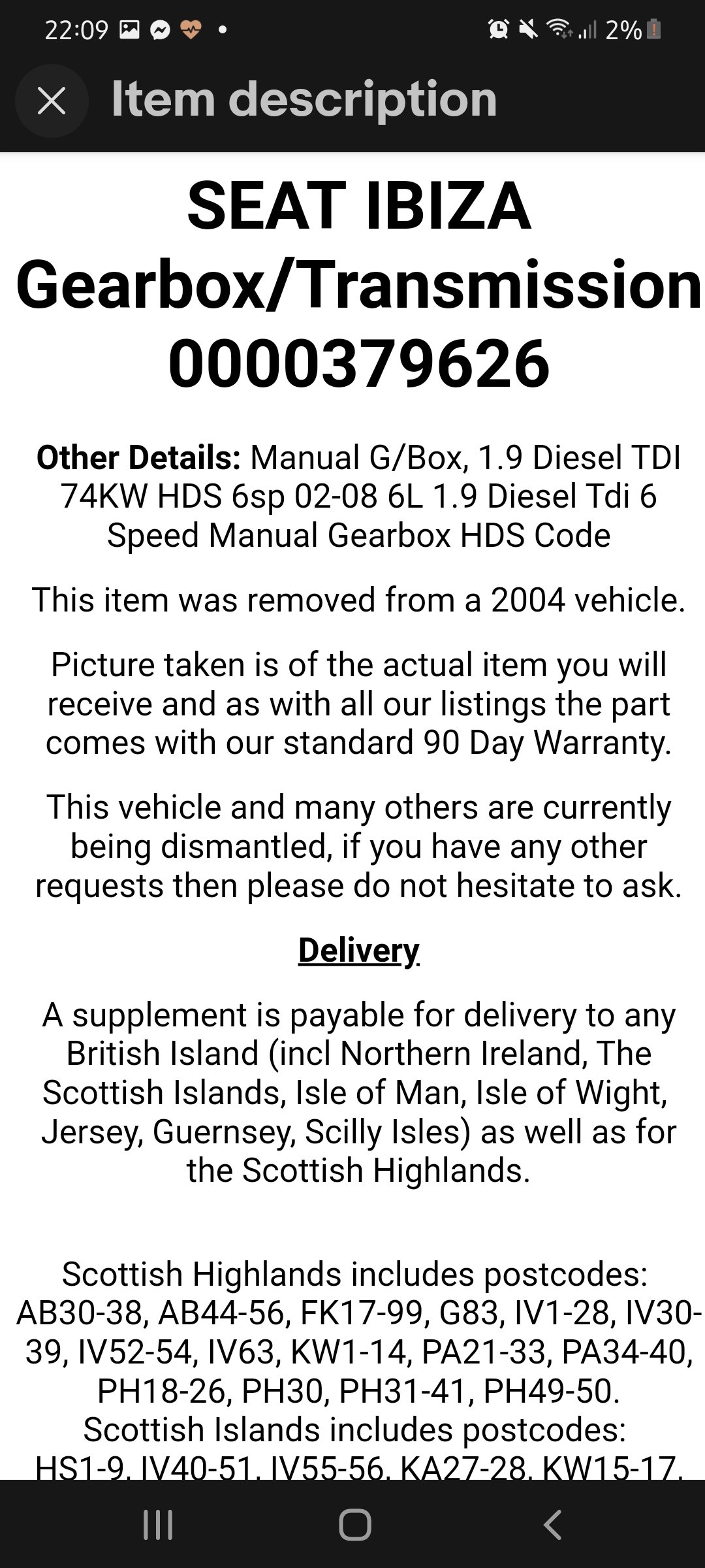

She has a HDS gearbox currently. Would this HDS from a Seat Ibiza be compatible? Or would the gearbox mounting be different?

That will fit just fine, an Ibiza is exactly the same car (Polo 9N) under a much uglier skin.
Yes. The easy way to know if you're looking at a plug and play compatible engine or gearbox is to check that it has the same code (HDS in this case).

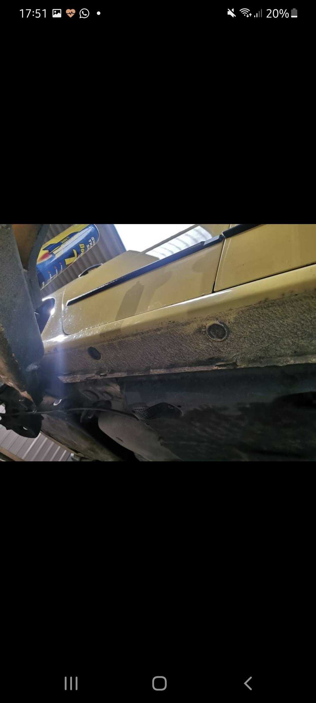

Buttercup has some surface rust on the sills, corner of the wheel arches, little on the bonnet edge and scuffs to her bumpers (which also need new clips, any direction on where to order bumper clips would be great guys 🙂). I don't think she's ever seen polish in her life, so is currently an array of yellows. I will attach some piccys later 🙂

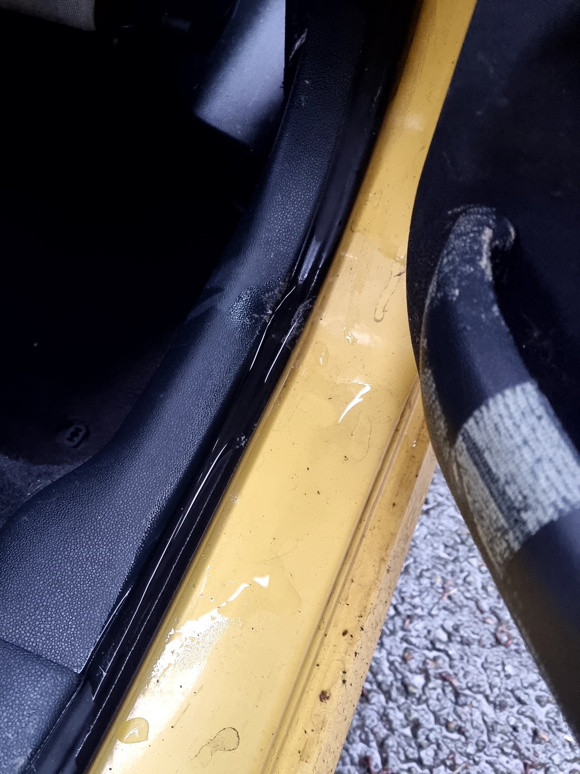

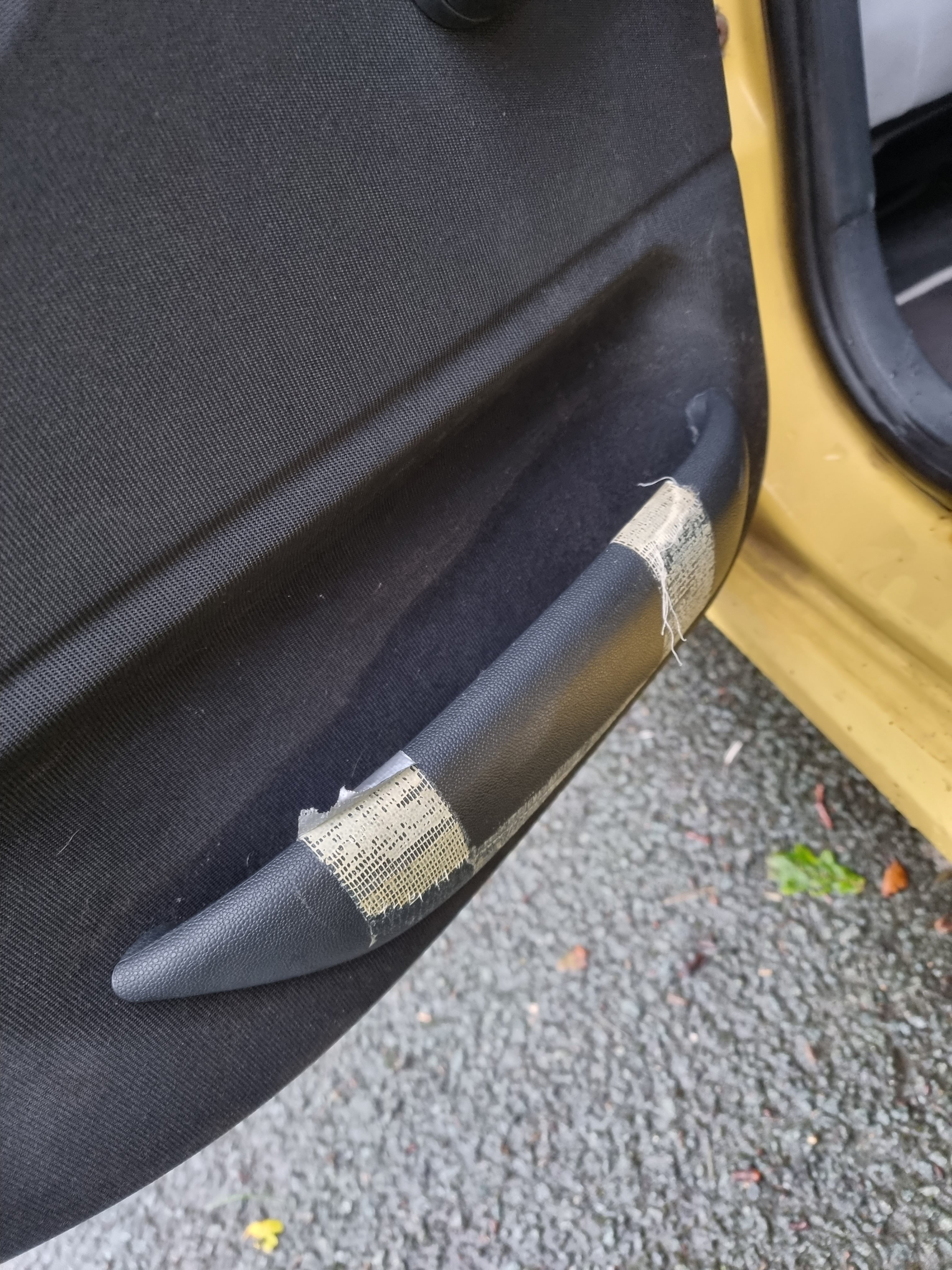

Going to tackle the leaky doors sometime this week, common issue I believe so watch out for this. Found some super fix vids on YouTube for this.
Hey, silver ain't so bad! I think silver looks sexy with the contrast of the black trims, and dents are character hey! Rusty pics to follow.

Rear door leaks are very rarely caused by the seals you can see.

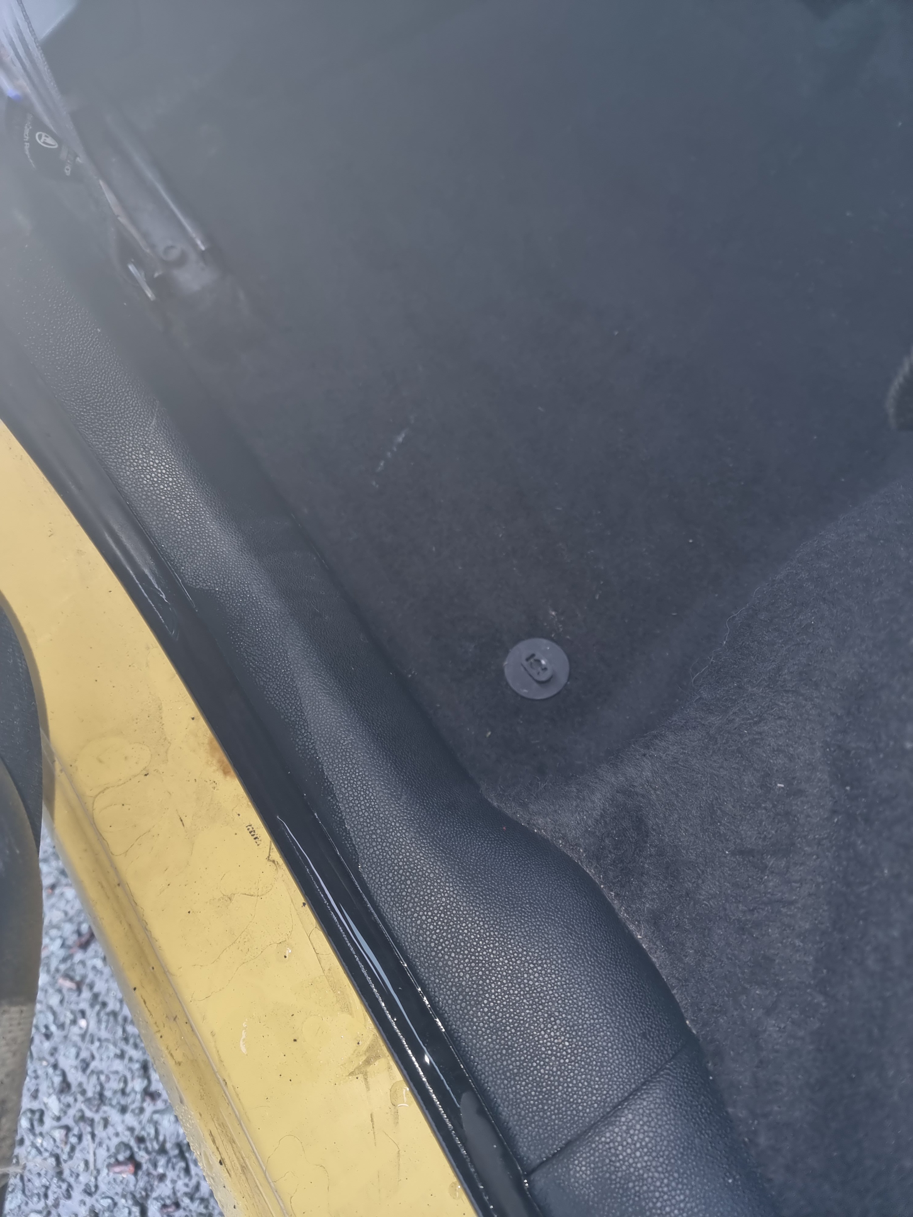

As Wino says. It's most likely the door carriers behind the door cards. When you go to replace those door cards for the ones from that SE then whack a bit of sealant around the bottom of the door carrier and also up the rear edge.

And most of the way up the rear edge.

A short term help for the leaky door carriers is to make "curtains" out of old plastic bags or similar. Looks like someone already had that on yours at some point due to the tape gunk left on the rear door cubbies.
