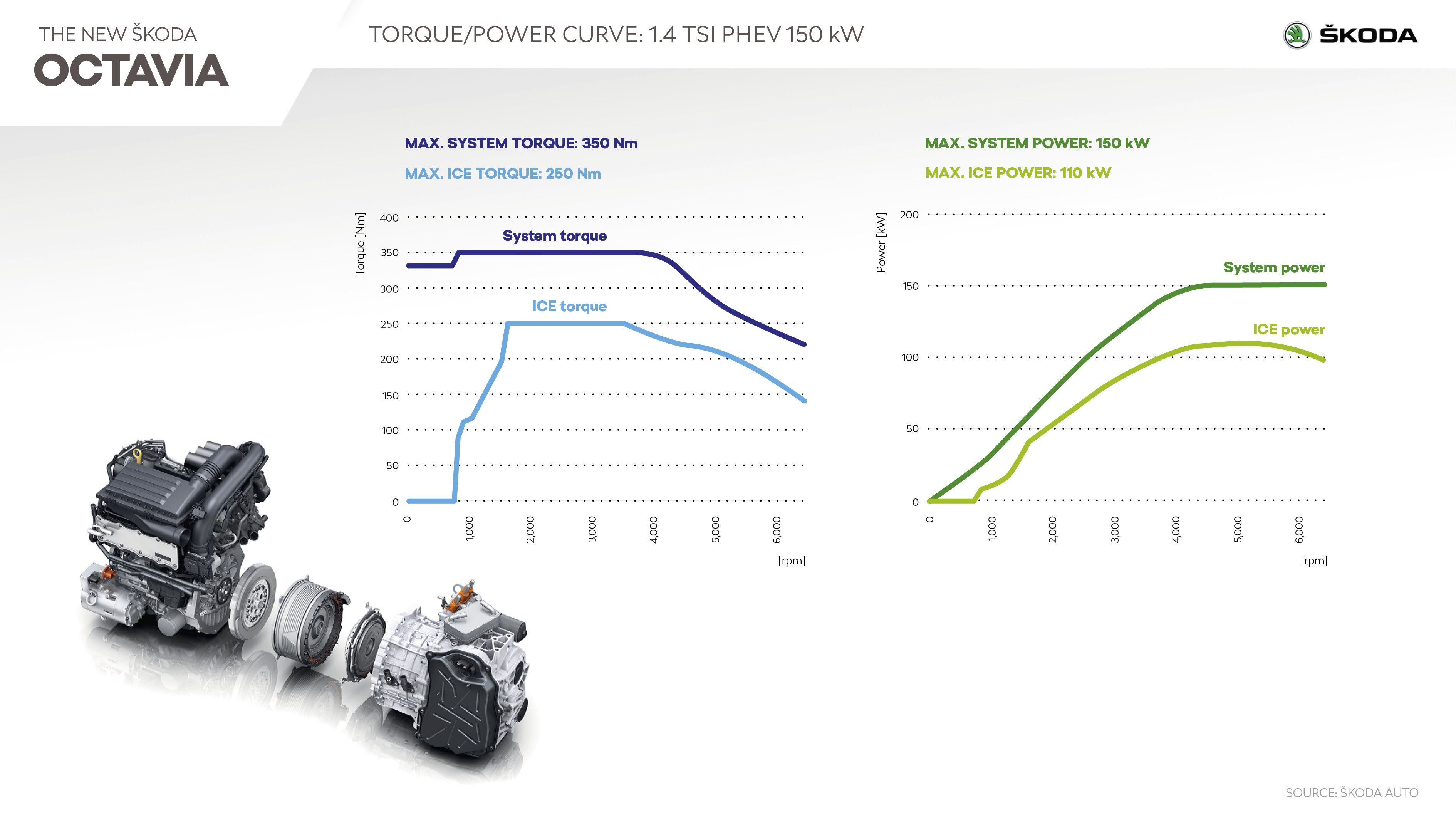

edit: added some pictures showing the two powertrains. ICE output is the same. Both have max output even if the battery shows 0km range, since there is still some juice left after 0km.
octavia_en_1-4_rs_iv_power.thumb.jpg.971df7ce40faca9bbe880613792f7e25.jpgoctavia_en_1-4_iv_power.thumb.jpg.0de9538c2517da358c39ce6b254367b0.jpg

- 1.4TSI output is the same on both.- this I don't understand, though I see it from the pics... I was told the RS has been mapped... so why no extra power?
- RS iV gets more juice from the electric engine. - I don't follow,, the electric engine is the same, right? And the electric boost works well on the sportline at high speeds. How is the RS different?

1.4TSI output is the same on paper, and i dont believe it has any internal changes either. Might have some small adjustments on the mapping.
Electric engine is the same, its just mapped to produce more power. Not sure how long can it produce more power.
