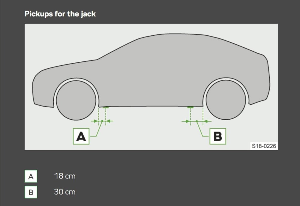

I'm about to change wheels on my new Octavia, but the lifting points aren't clearly marked and the manual doesn't provide much detail other than 18 cm in the front and 30 cm in the back. I seriously cannot see where the jack should go. I've had many smaller cars where these markings were very clear.
Does anyone have a good advice on how to see where the jack should be put?

And some visual presentation.

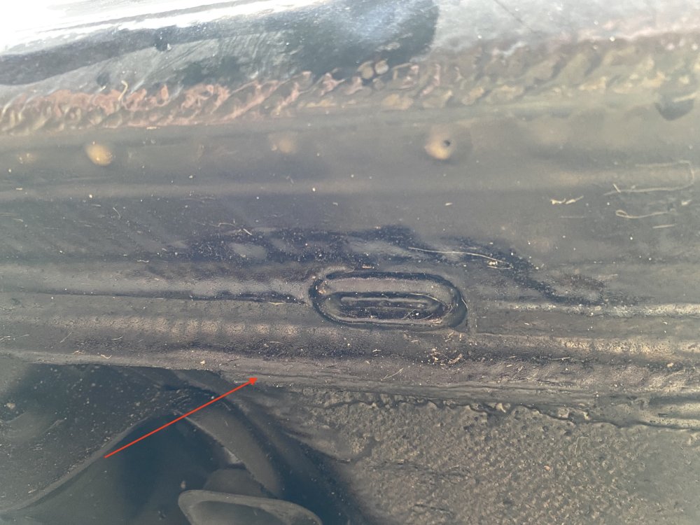

I found the indents on the side of the cars as shown on the great picture that TheUltraRunner posted.

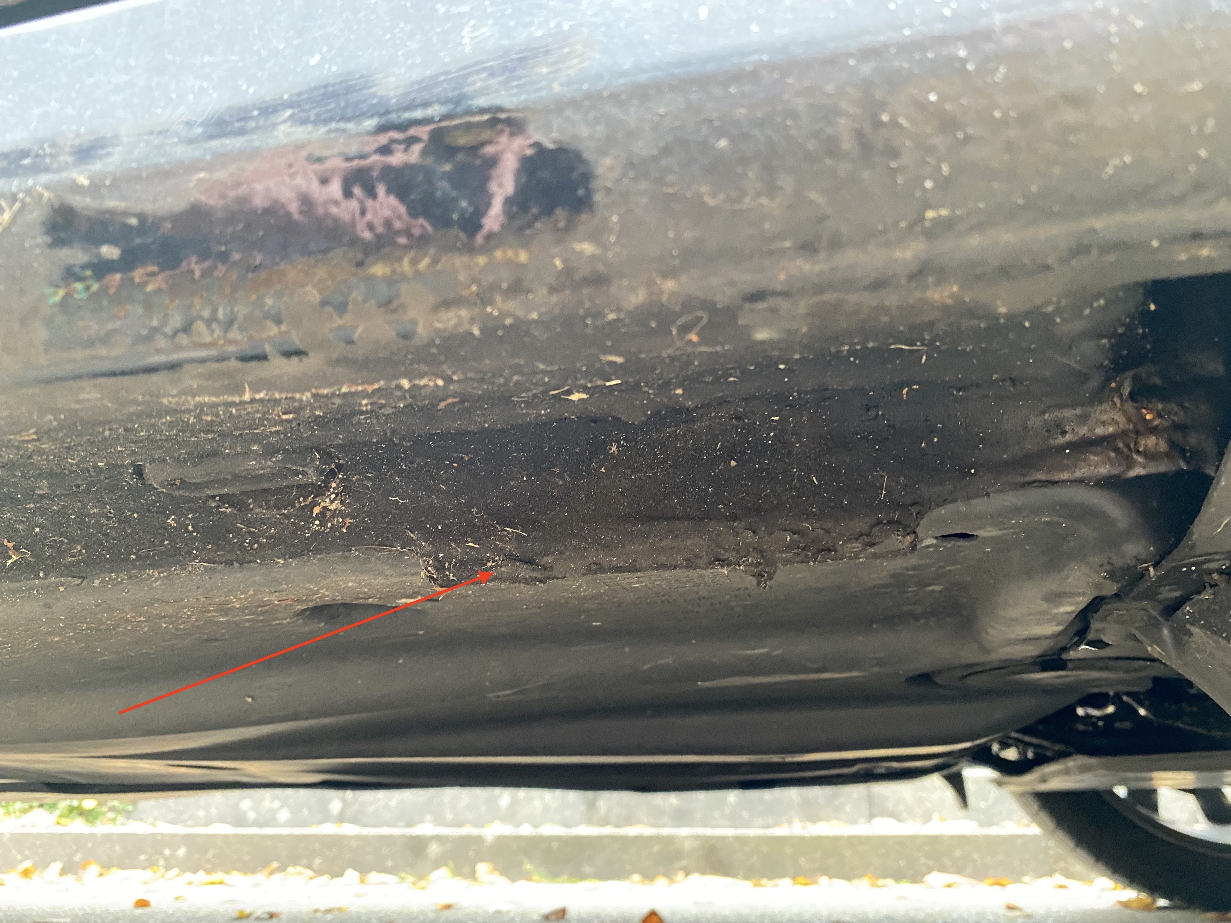

This is what it looks like under the car:
I tried to add an arrow indicating where I think the jack should go...
This looks correct.

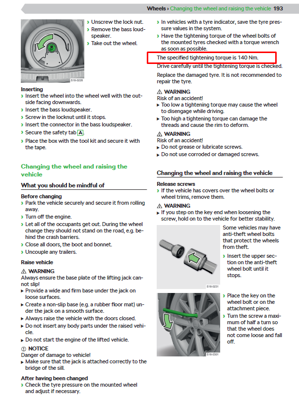

How many NM do you torque the bolts with?
Thanks
/JZ
As prescribed...140 nm.
I overlooked that info. Thanks! :)
