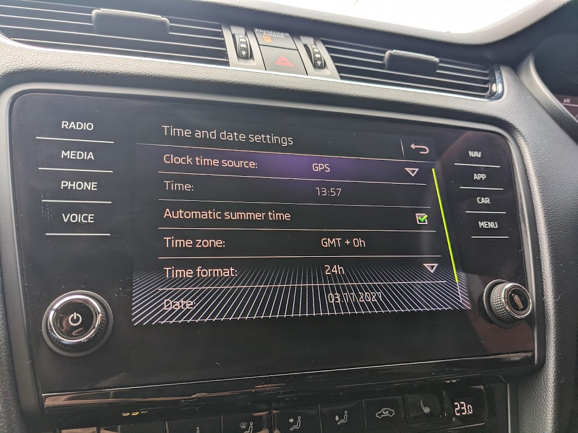

Even though Clock time Source is selected GPS but time doesn't auto change..am i missing something in the setting?

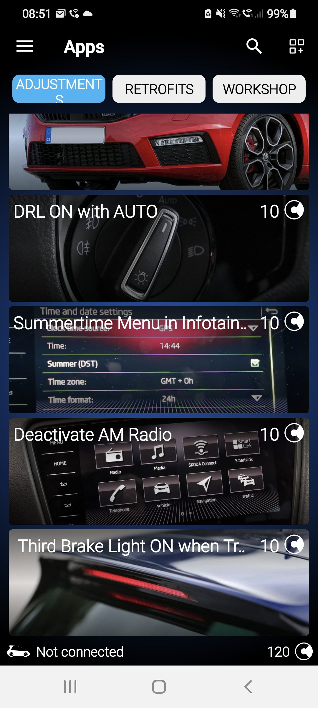

I've enabled it via OBD11 and it still doesn't work. 🙄

Via the built-in apps in OBD11.

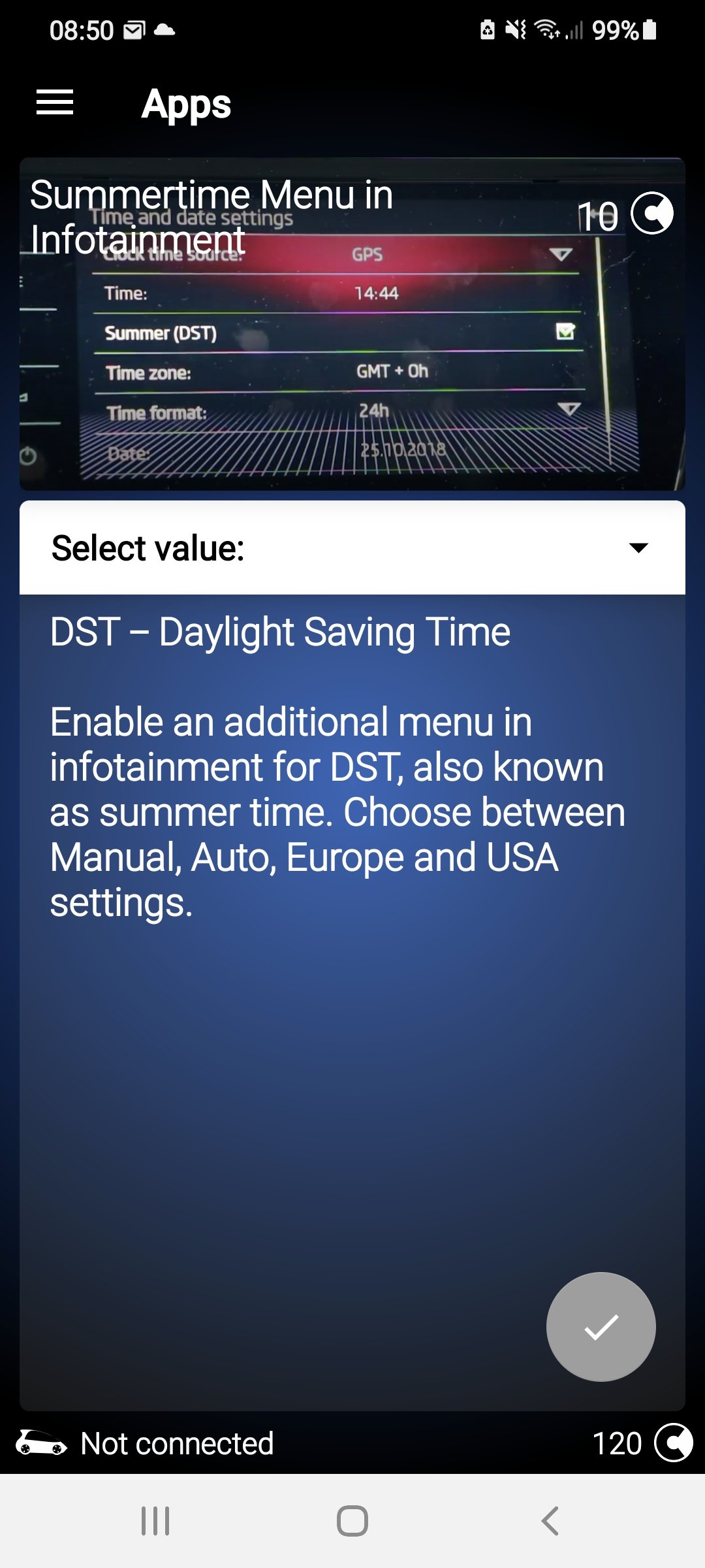

Okay ...here is the coding. See Page 2 for the specific coding you need. It works with all MIB systems (not just the advertised Columbus). I've tried it on a Bolero and Amunsden too and it works just fine.
Did my Pre fl using OBD11, worked first time for me, the instructions  are the same I believe.
1 - Controller 5F - Infotainment
2 - 10 - Adaptations
3 - Summertime Automatic
4 - Stored Value - Europe
Thanks everyone for the replies and help but i figured out that there is no way of doing automatic time changing in this car ..the coding or from the app of OBD11 will just give me Summer (DST) option which i already have in the car.

Well it is possible... Works perfectly in my MK3:
Did you reboot the headunit after making the change by holding the power button for 10-20s until the boot logo was displayed?

Really!!! How did you do it? When I was doing it using OBD11's app, it wasn't successful. I tried to do it other way as well and it didn't accept the changing. i red the article related failure any adaptation and it said, some coding car doesn't accept and some coding car asks for the security code. So I thought, my specific car wouldn't accept the change.
