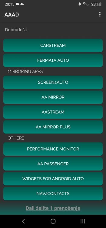

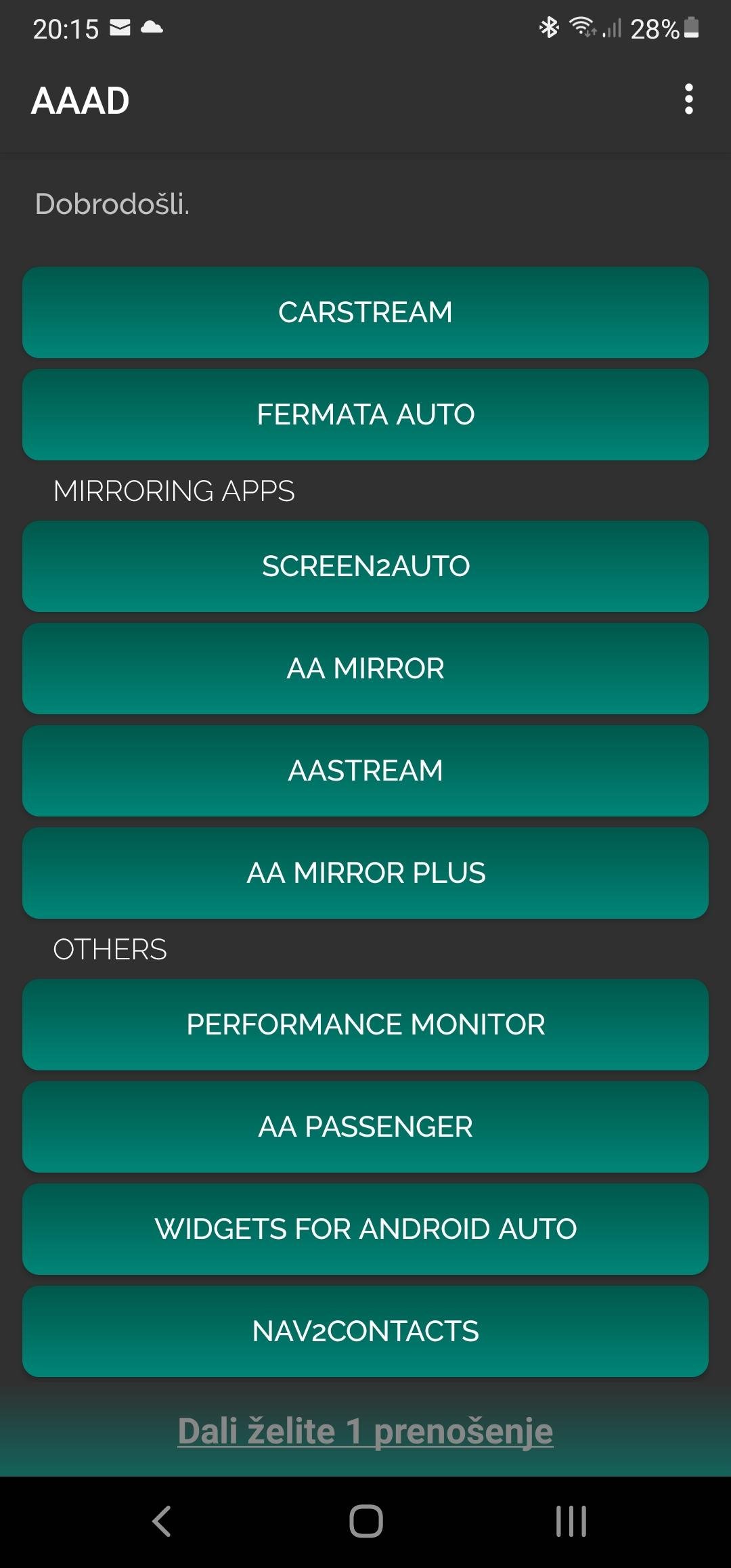

someone asked for video on display. NO! its not mirroring bt aplication u can use has also mirroring . its called fermata auto . u can watch you tube , tv through mirroring. but there is  some steps before you can install this app on yours mobi. first of all u need to install king instaler then AAAD app, you can find it on net. after that try to find version fermata auto 1.8.7 and install with king instaler. You can easiliy find all tutorials on github.com
Android auto with new version has some restrictions so only way is install with king installer and if you want control through stering wheel there is fermata control. cheers.  it looks like pic down. hope admin  will allow this post . free vers of aaad will allow downloading only 2 app. aaad.thumb.jpg.800de9a5a8eba9d7f2811a22cce648eb.jpg

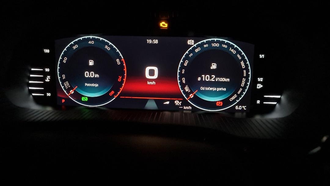

maybe you didnt noticed but you can change tachometer view .
  Control unit 17 - Adaptations - tachometer end value - my first version ,default was  2 with end speed 260 now its version 6 , after you enter desired value press ignition off , ignition on and new version will be shown instantly
