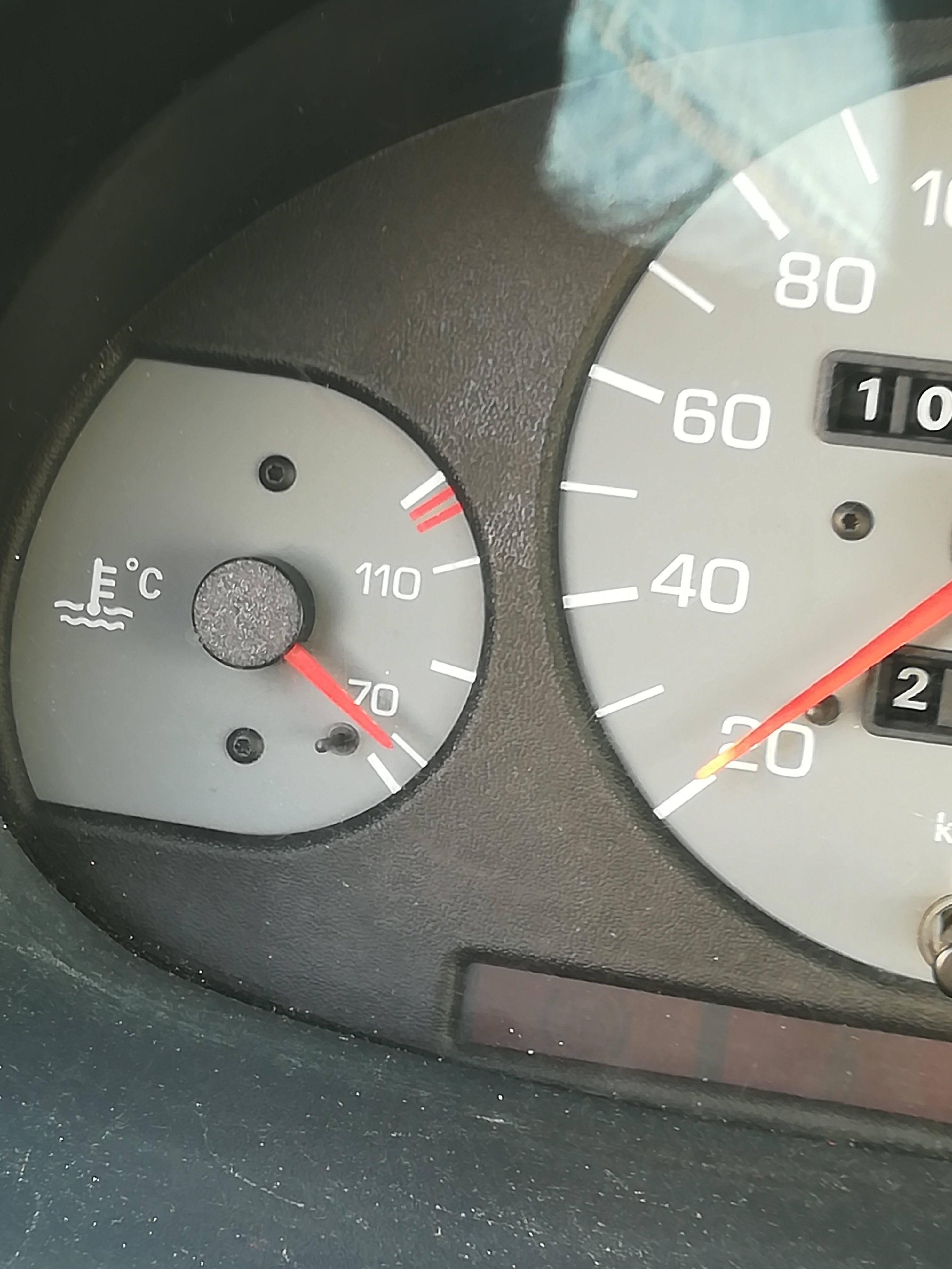

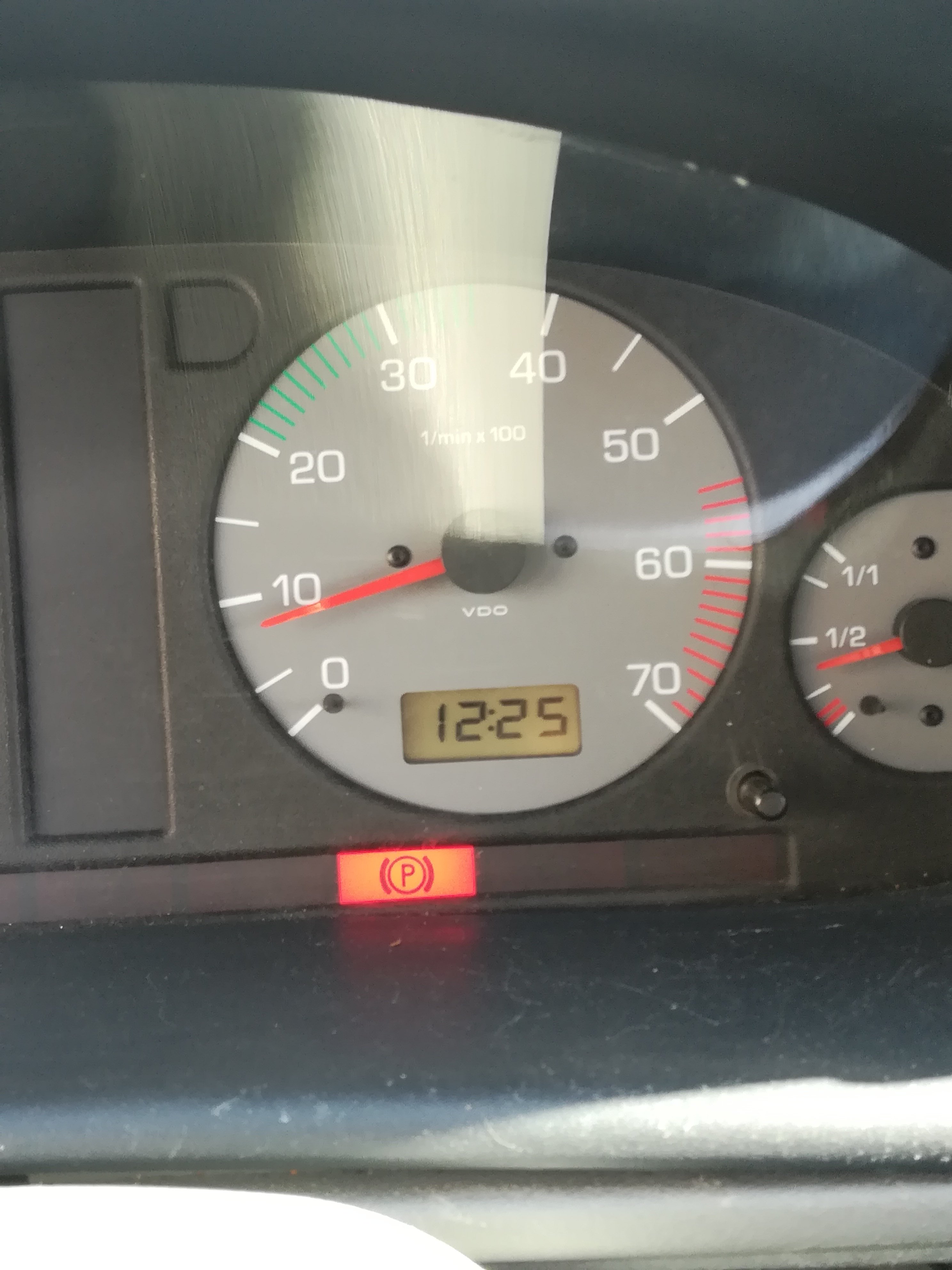

A few hours later, 12:22 pm idle is at about an indicated 1,100 ("And few hours later, Scenario No1(?)).  Two or three minutes later about indicated 800+ and 70c.  To me you didn't need or want a static warm up here.

I'm wondering what causing the low revs cold morning start... 🤔🤔 For me the ideal cold start is 1100revs static warm-up, 3-4 minutes to get 70C  without any engine load and the metal expansions to be smoothly.
