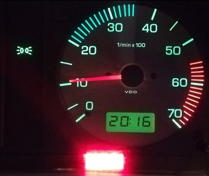

I didn't touched the pedal, the rev jumped to 1100 and stayed there for 3+ minutes, then dropped to 850.
That's my problem for more than a year, when the car's motor has ''cooled" for few hours then i have this phenomenon.

Looking at Thefeliciahacker's video again it is the same, from initial start up tachometer needle rises and jumps to then drop back, so ignore me.
Update:
Today the programmer told me that my ECU has a problem especially the ''cold start" chip that's why i burn too much fuel in the beginning of each route.
Tomorrow another ECU will be installed to make some tests and let's hope that the problem will be solved.

Don't know guys but it has deside to work normally.. 🤔🙄🙄
you have to figure out what changed.
On 16/12/2021 at 17:20, HappySkoda said:
 ok guys  second video.
From 2:16 till 3:21 the idle was 900 rpm, mine is 1100 rpm for 3:40 minutes.
