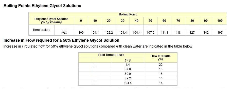

While searching for this matter i saw this
https://www.engineeringtoolbox.com/ethylene-glycol-d_146.html
Between 30% or 40% Ethylene Glycol the boiling point is identical, 104.4 'C

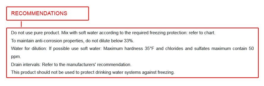

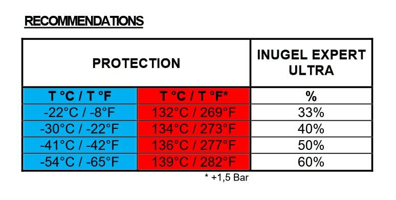

From the Motul coolant that i use now i have found this
https://azupim01.motul.com/media/motulData/DO/base/inugel_expert_ultra_en_fr_motul.pdf
To maintain anti-corrosion properties, do not dilute below 33%
There is a statement missing from your table of boiling point against mixture. This statement should read "At standard temperature and pressure". Your Skoda, like mine and almost all other cars on the road with water jacket cooling systems, has a pressurised system, which raises the boiling point of a 50/50 mix to more like 115C at sea level.
Yes the boiling point of water is less as we get higher in the mountain but about those number that many coolants say 200-220-23-240 "c etc is there a possibility for our car to stand such a temperature?
The limit is 120 'C and after that the ''Boom" comes.

Also if the manufacturer recommends a minimum of 33% that would be it.

The 33% is from Motul G11 specifications.
The book says 40% to cover all the countries.
I saw the 33% and guessed it might be 40% in the book, personally I would go with 40% as that gives a good margin for error from 33% too.

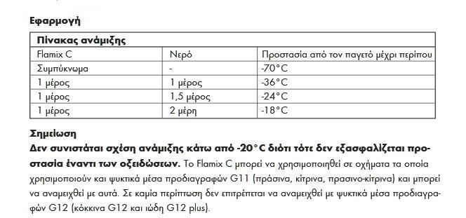

Wurth Flamix C G11 says no less than mixture for -20 'C because there will be no protection against corrosion.
On the other hand Motul G11 suggests to maintain anti-corrosion properties, do not dilute below 33% which is at least for -22 'C protection.

The 33% Ethylene glycol percentage is really THE rule for minimum protection from corrosion or there a possibility to be a selling trick?

and lower concentrations do not protect against corrosion) and 70%, which are usable up to about −65 °C.
So, to what extent you will mix antifreeze and water mostly depends on the weather conditions. Just be careful not to dilute the antifreeze too much, as this will significantly raise the freezing point and will not protect against corrosion.
Further, low concentrations of antifreeze do not protect enough from corrosion because they do not have enough corrosion inhibitors
https://totalenergies.rs/en/advice-proposals/ehow/antifreeze-everything-you-need-know
BS 6580: https://www.smithandallan.com/documents/PRODUCT INFO Antifreeze BS 6580.pdf
For a ready-to-use coolant with good corrosion protection it is recommended to use at least 30 % by volume of engine coolant concentrate.
https://vietducjsc.vn/upload/cdn/files/COrrosion Inhibitor BS 6580.pdf

21 hours ago, D.FYLAKTOS said:
So 30% is the lowest limit and 20% for example means future problems?
Yes down to 30% it's absolutely safe. The issue as I said before is that it gets depleted rather quickly so I change it every 2 years.
