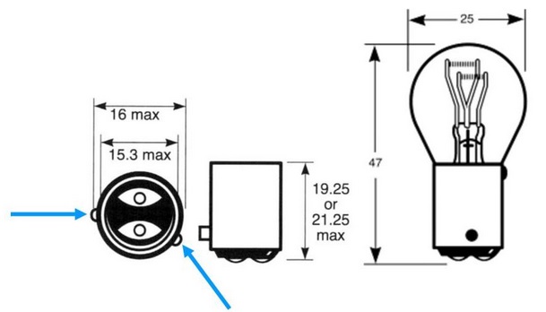

Are you sure you have the correct bulbs in? It has been known for people to jam standard stop/tail bulbs in, but the Fabia uses offset pin 566 bulbs - 12v 21/4 watt.
