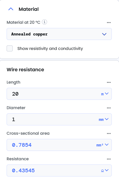

3 hours ago, Graham Butcher said:
Every metre of cable added on will add to the overall impedance of the entire circuit feeding power to the car. It is that extra cable that is the point of where everything can suddenly go downhill rapidly, you can buy extension leads from Poundland that may only just be capable of handling 5A max. The cable it self may well be copper coloured aluminium, the plug pins maybe even made from hollow extrusions, the socket contacts may be of poor quality etc.
The cable itself isn't the problem.
20 meter cable using a thin 1.0 mm cable = less than 0.5 ohm resistance.
10 amp squared * 0.5 ohm = 50 w of heat to dissipate. Easily done, no problem at all.
Have a play here:
https://www.omnicalculator.com/physics/wire-resistance
It's the plug at the end of extension cable that need careful manual monitoring, make sure no overheating.
The 3-pin domestic plug of the car cable is monitored by the EVSE.

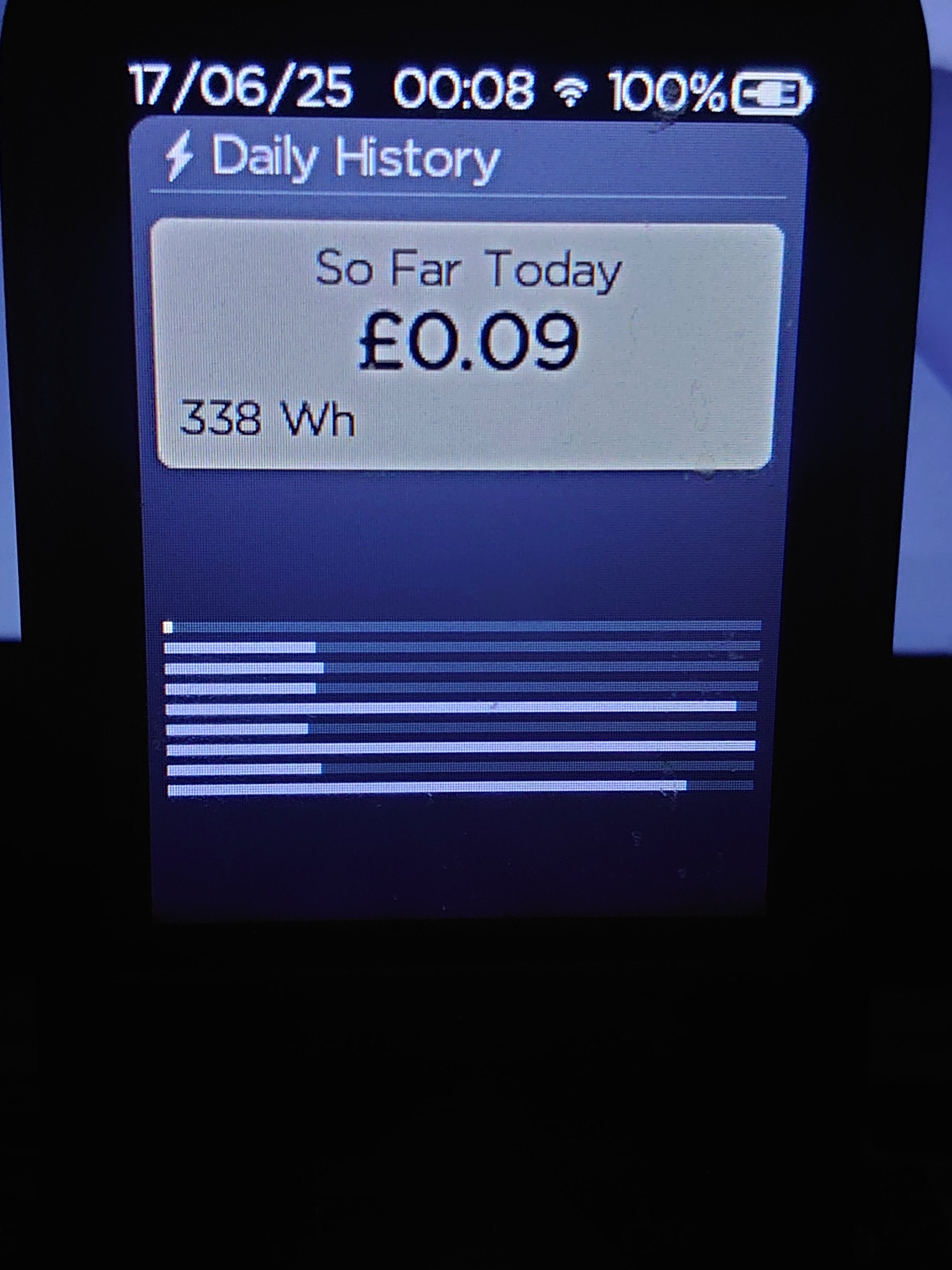

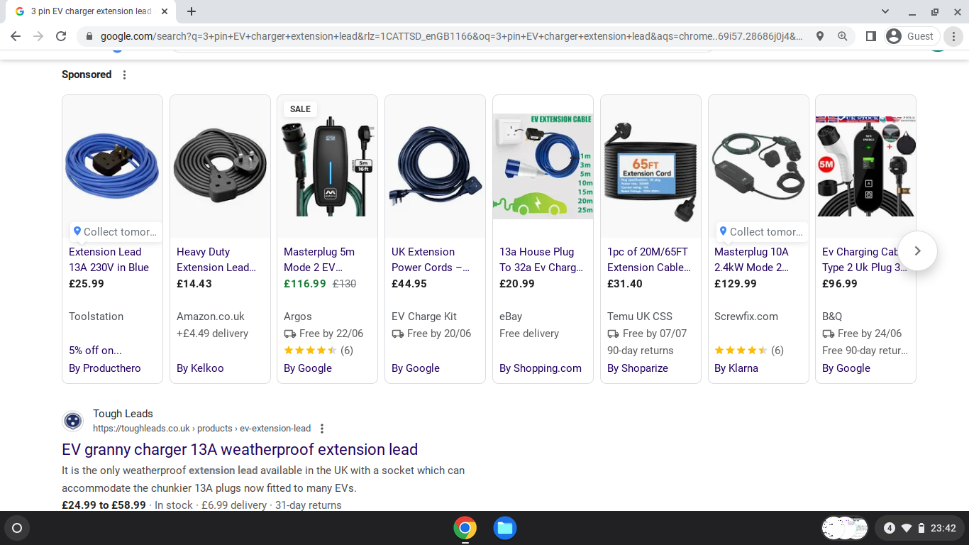

@Graham Butcher You do realise it is the car that can be set to 10 amp max.
& that i am pulling your wire.
So.
That is fine then as not cheap but is imported. Not bought from a DIY Shed though.
Who do i go to in the UK to buy one Made in Britain & where do i have to purchase it from and can i use your name and ask for a discount?
British craftsmanship, & British Standards for British Use and Britain will be a safer place and we will be healthier wealthier and wise.
God only knows how we manage to survive as long as we do with Imported cheap crap.
Bloody killers selling their junk direct to your home. I will have Ronan Keating in my head all night now. If tomorrow never comes.

Well you will know how people love to cut corners etc, eBay buyers etc, you will be amazed just how lapse we are in allowing dangerous goods into the country. The claims that are written into the packaging, none of which are true or even present.
Look at these 3 videos by another electrical engineer on a extension sold by eBay sellers, where he puts it through tests to show how it could easily cause a fire and it has a claimed rating of 10A., enjoy. 👍👍

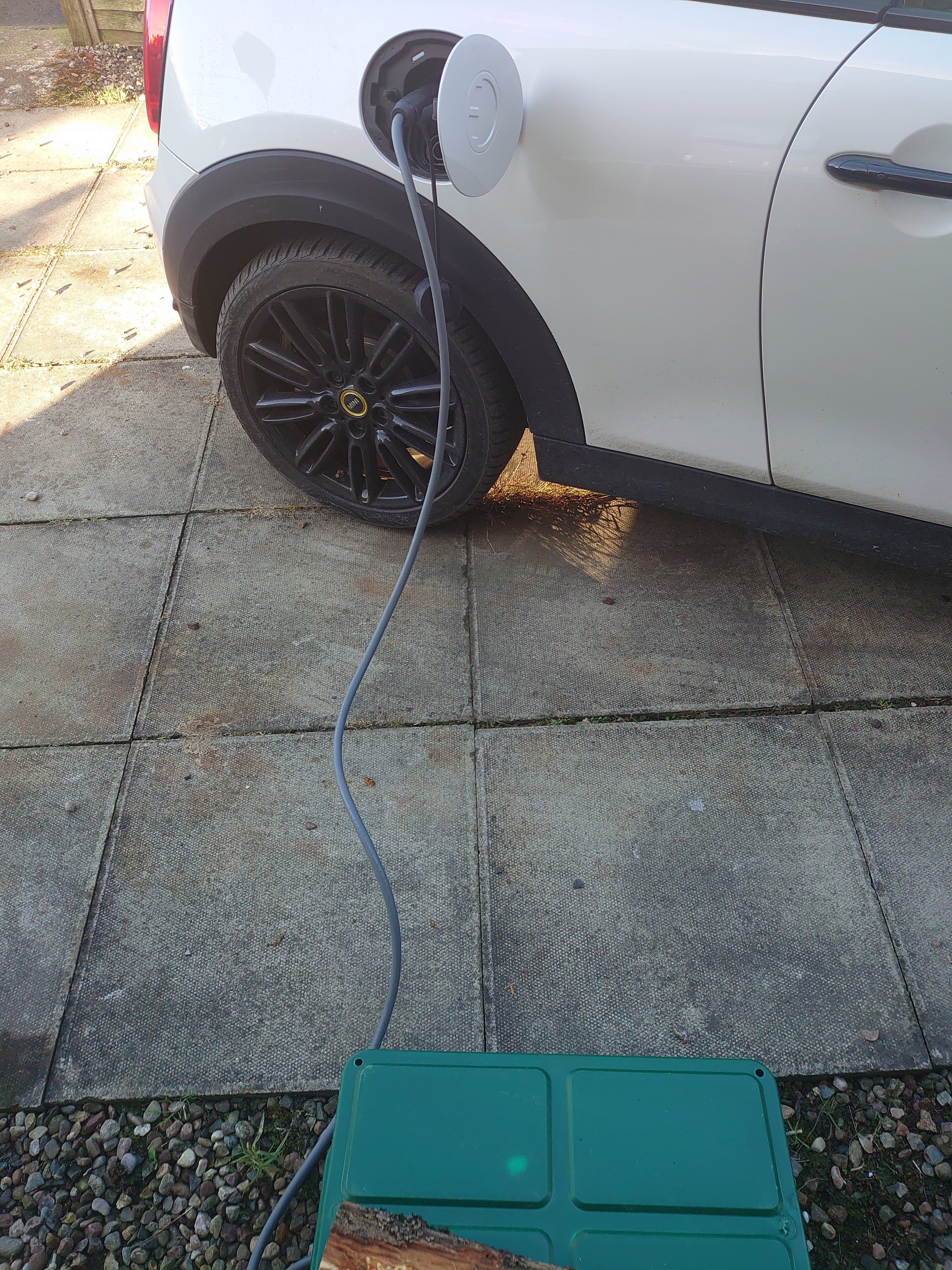

That's the sensible thing to do, but we all know that it is not always possible for loads of reasons. I'm sure if we are being honest that everyone has come across people taking massive risks with electricity daily.

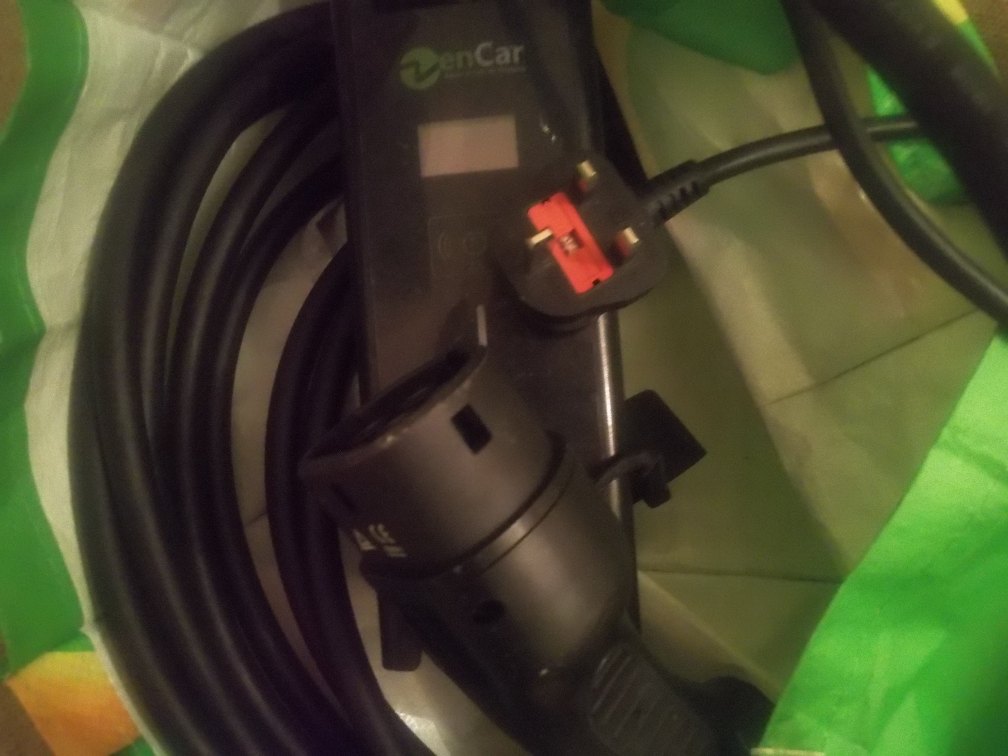

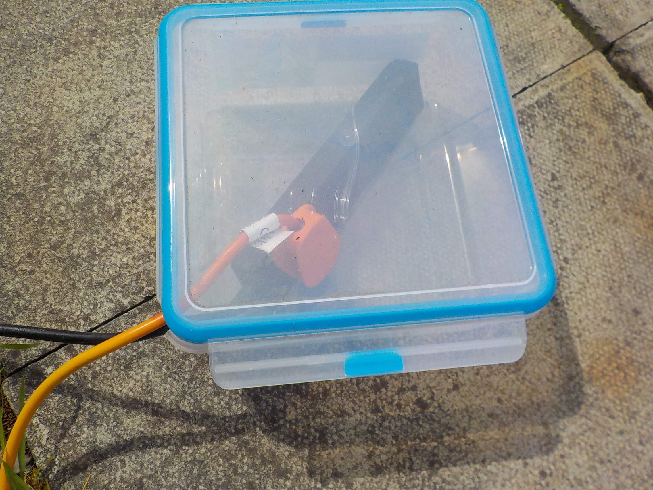

The 11 kW cable and charging unit i am back to using is twice the length of the one that came with the MINI.

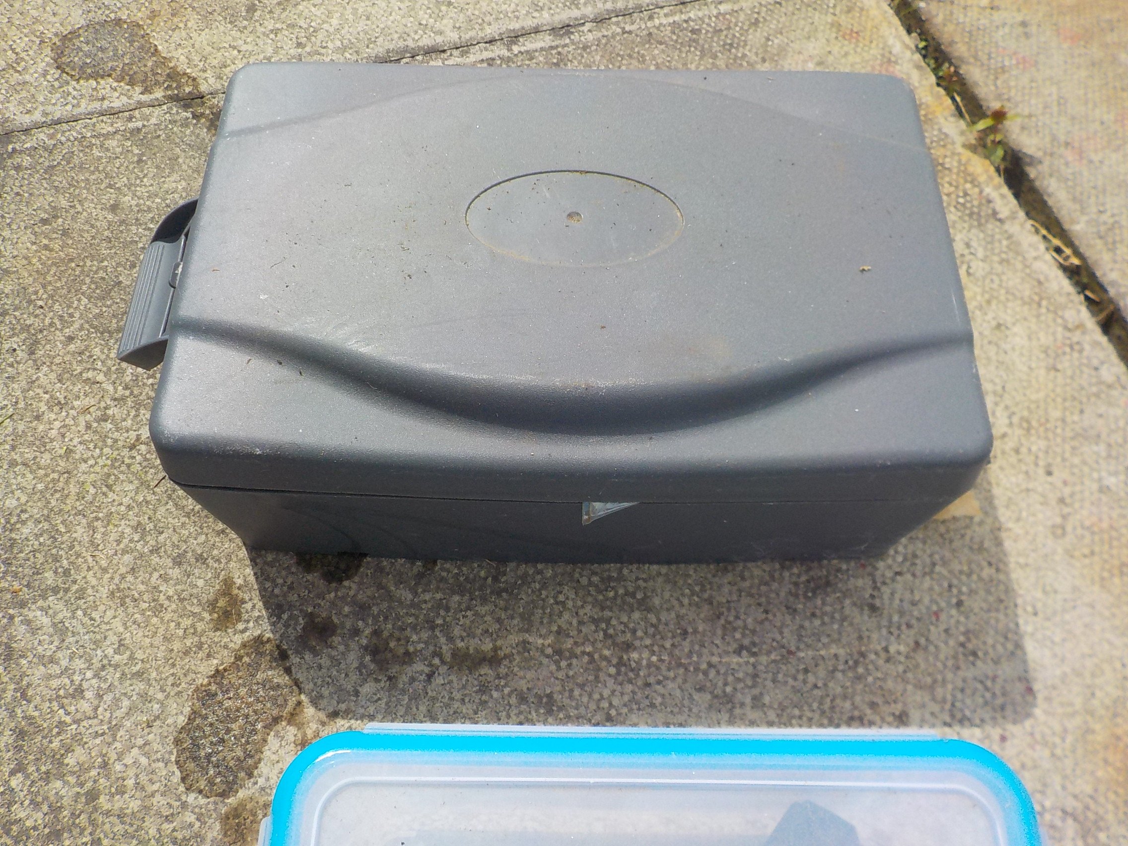

When i have to use an extension cable when away from home i have one of the boxes with me, but the charger has always been long enough from the building or outside socket to the car.
Gray cable one is the one from MINI / BMW.

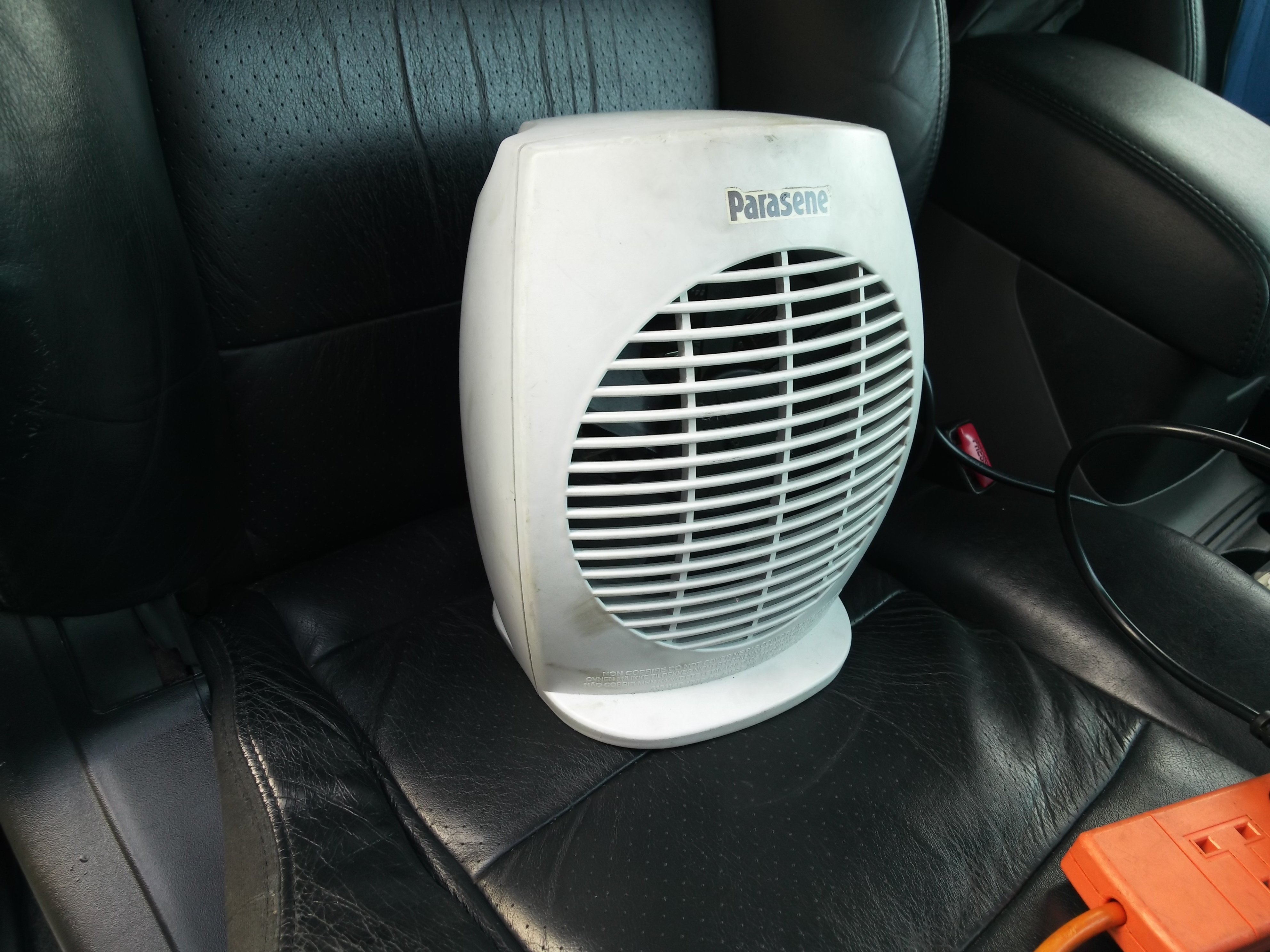

I had the Boxes and extension cables before a EV for using for the vacuum cleaner or the Green House fan heater that was used to pre heat vehicles, or keep ice free during the day / night.
DSCN0881.JPG.a18b6e3264ac470c58b204e4433fa31e.jpeg.ff4cd94118150a64373e9d23a0a4eba8.jpeg
DSCN4339.JPG.1597a7d34cbd994683a480bf945b374a.jpeg.87fdb290c772d575b6401d6fcdbb61ed.jpeg

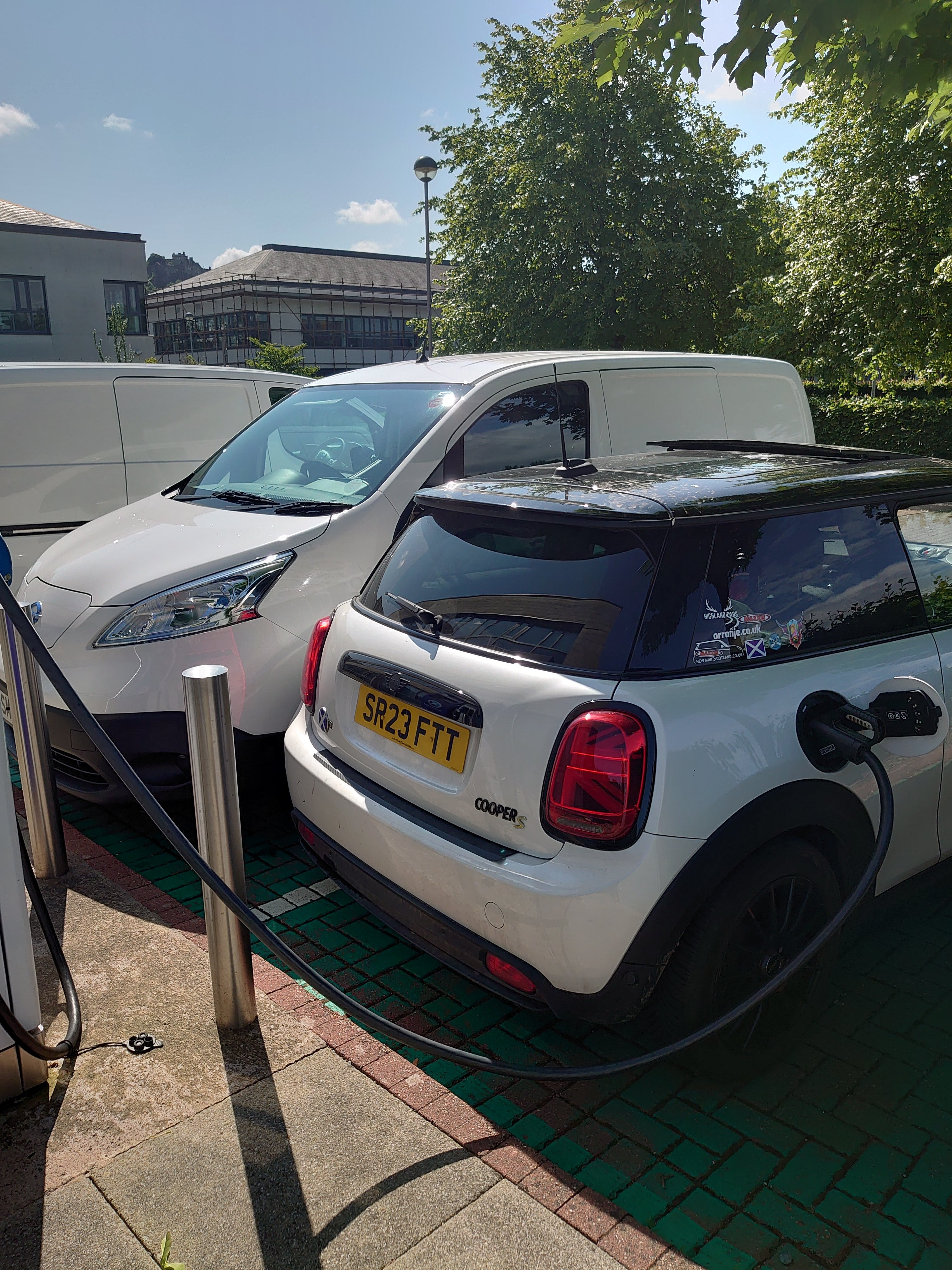

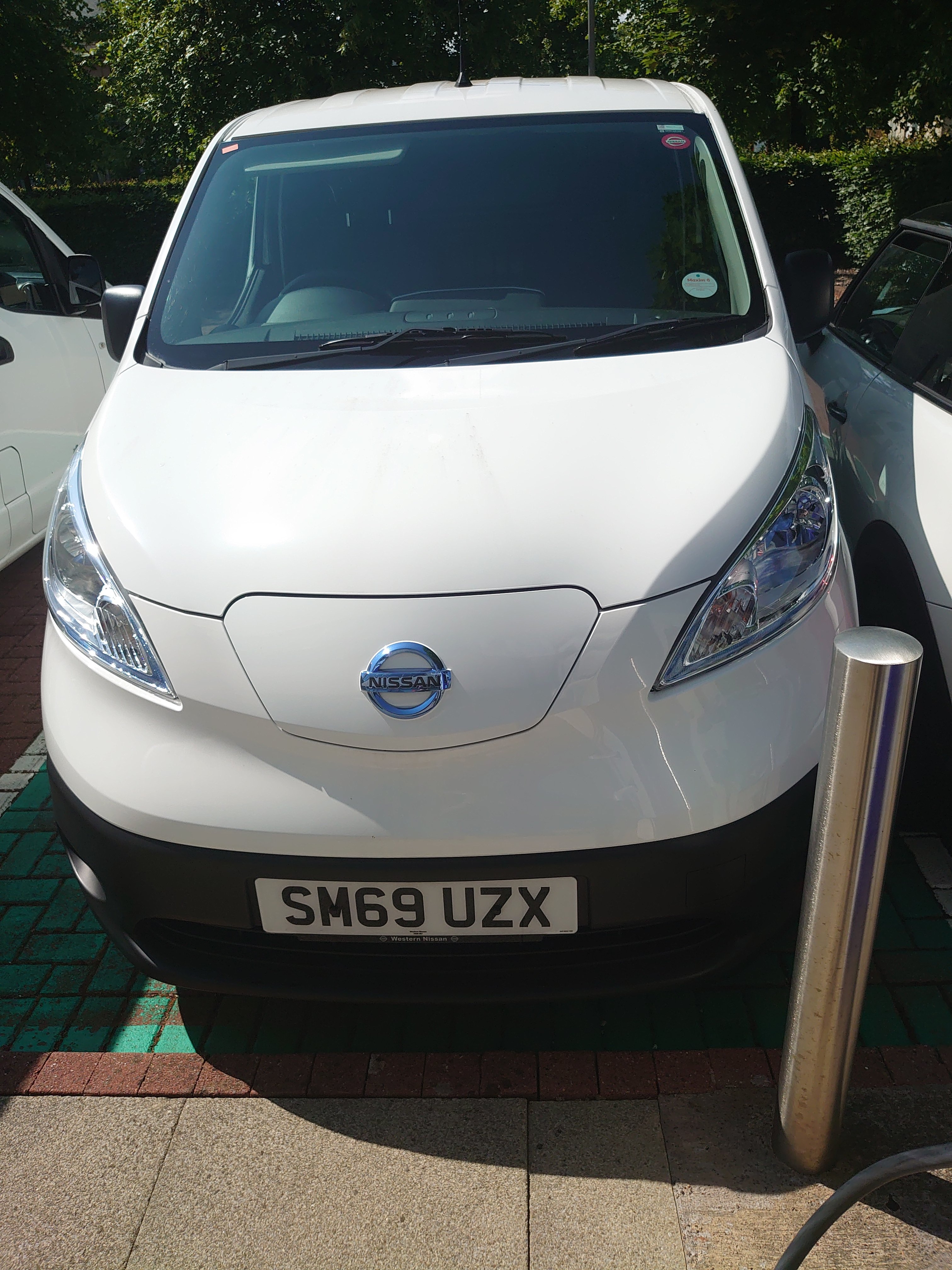

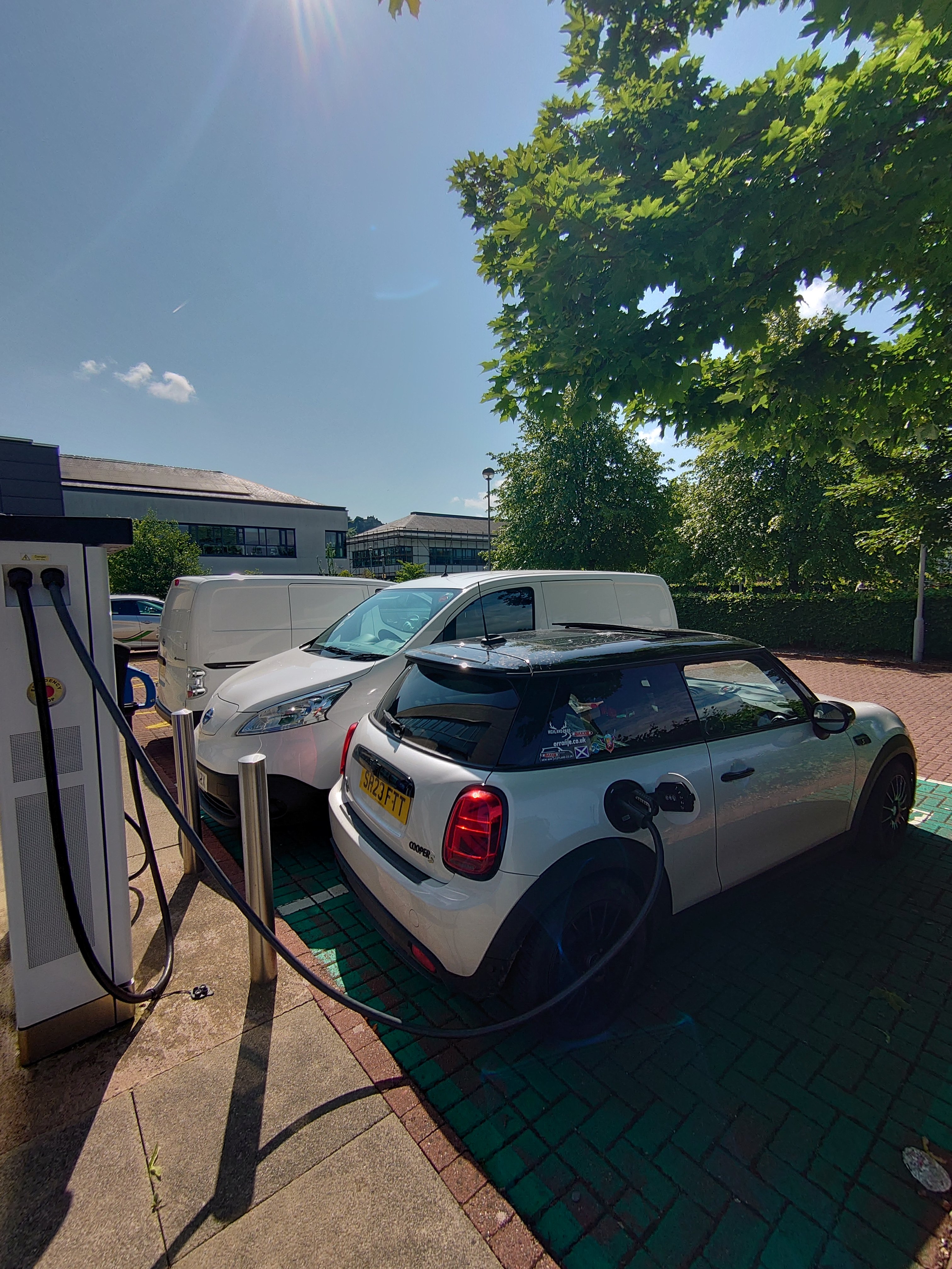

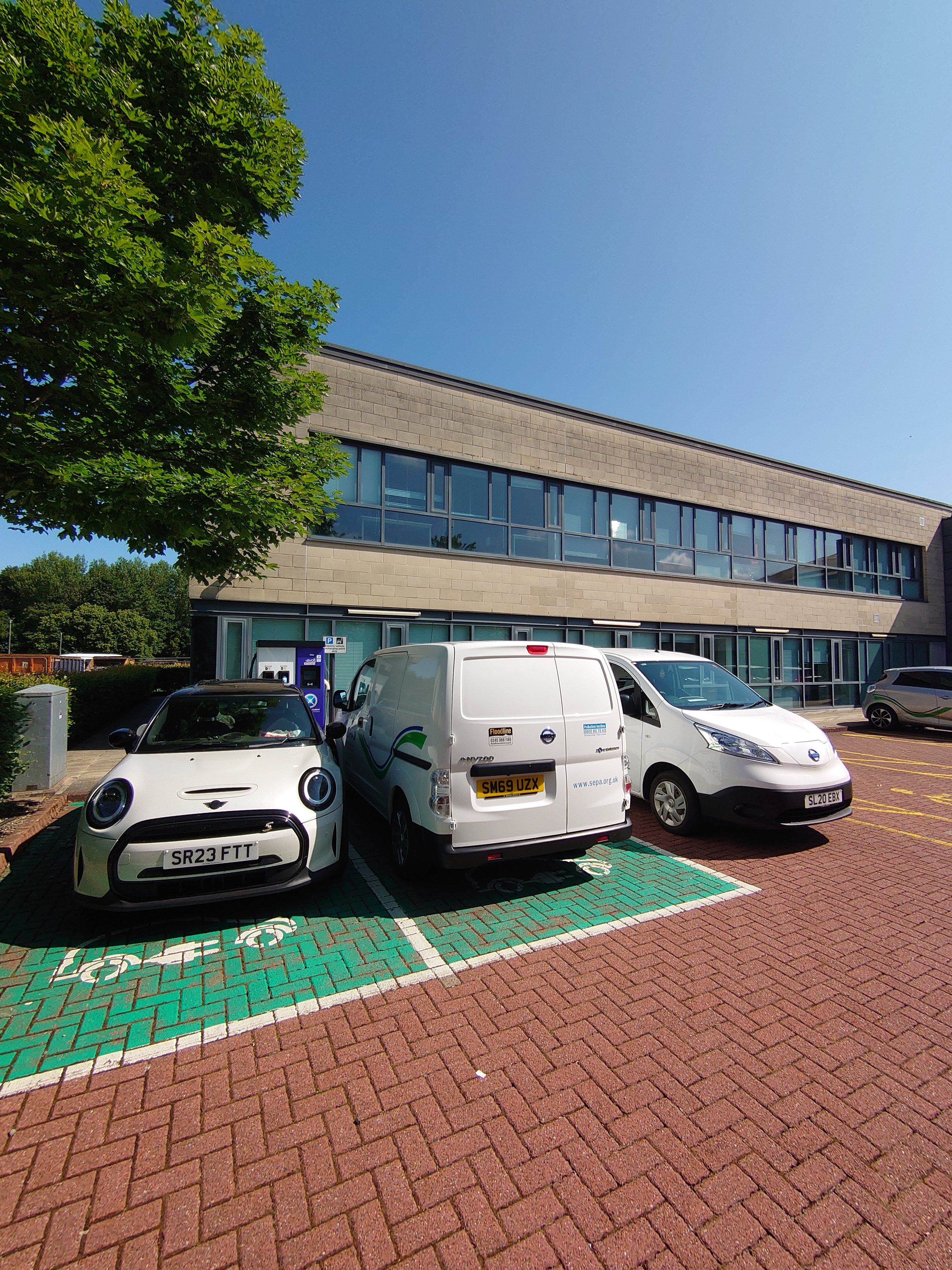

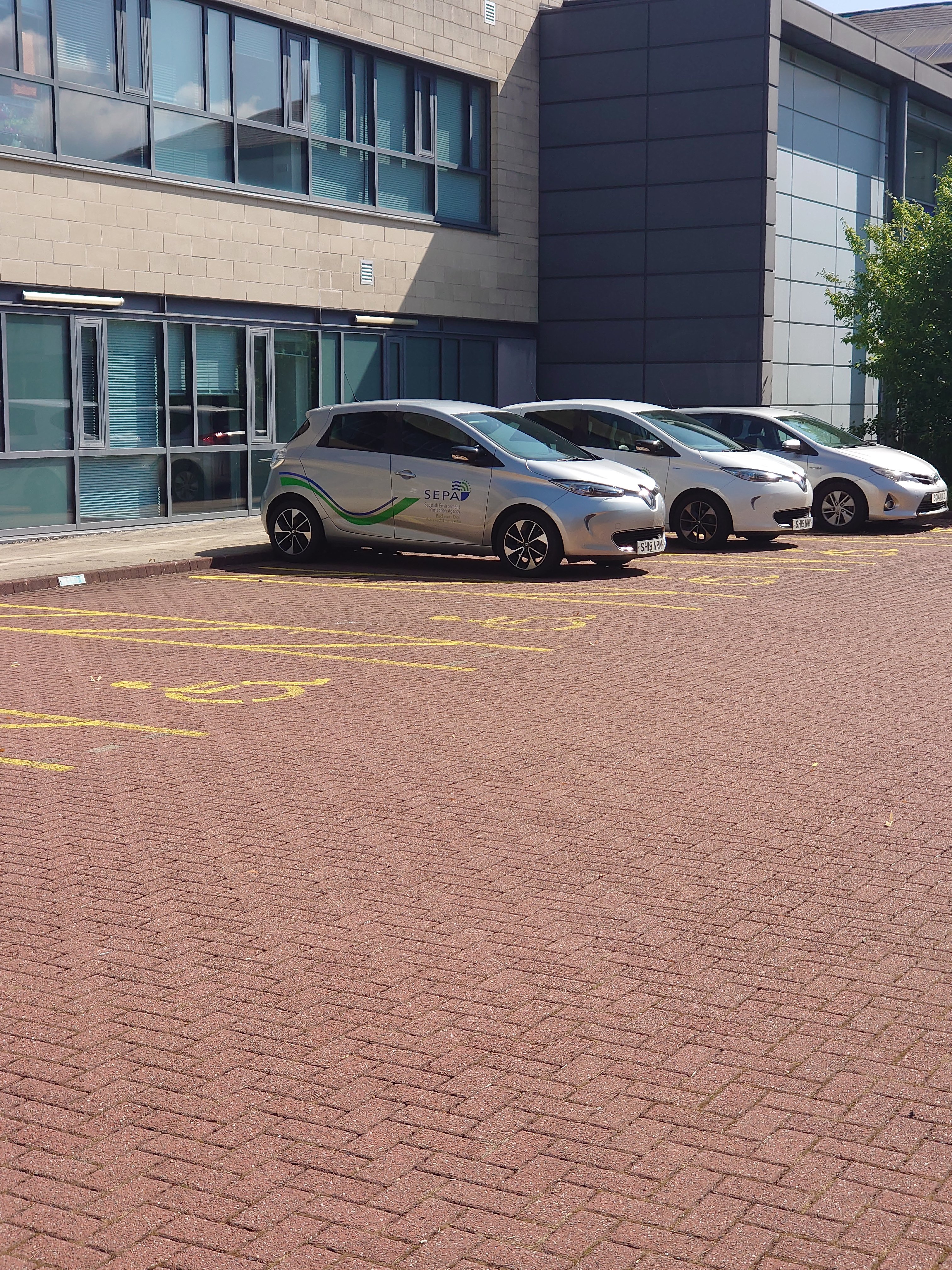

Bar stewards at SEPA Stirling. This is a public charger and DC and AC can operate at the same time. This crowd think just taking up a bay as a parking place is ok. I will try having a word inside, and ask why they no longer charge or park in what are now empty bays and chargers.
Edited by Ootohere

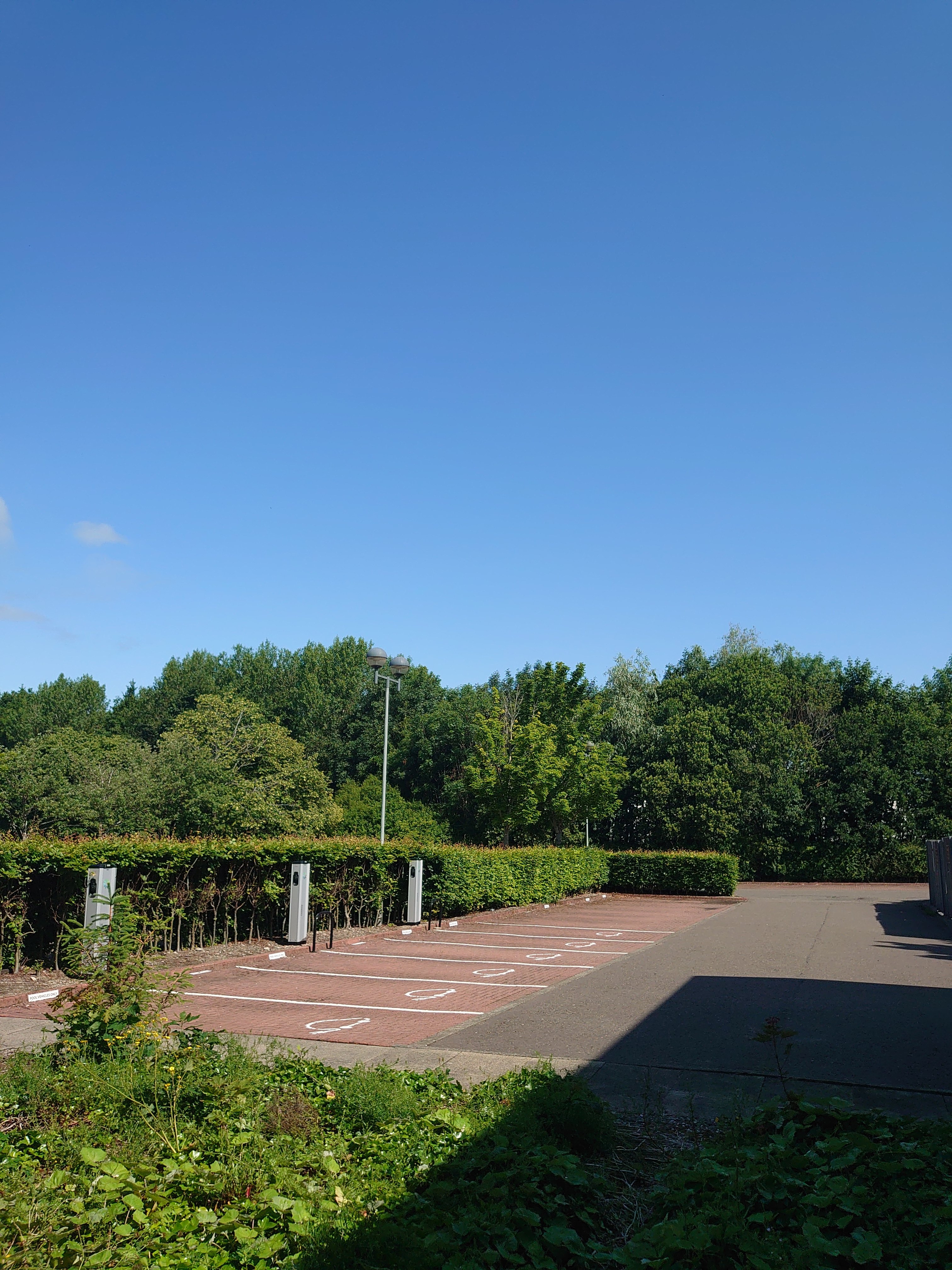

The gentleman in the building was dead nice. He could move the van, he will point out to others about awkward for some if bay just blocked... Like these educated people never knew
The flap not opening on the van and it needs charged to go to Balloch. ****** kk s

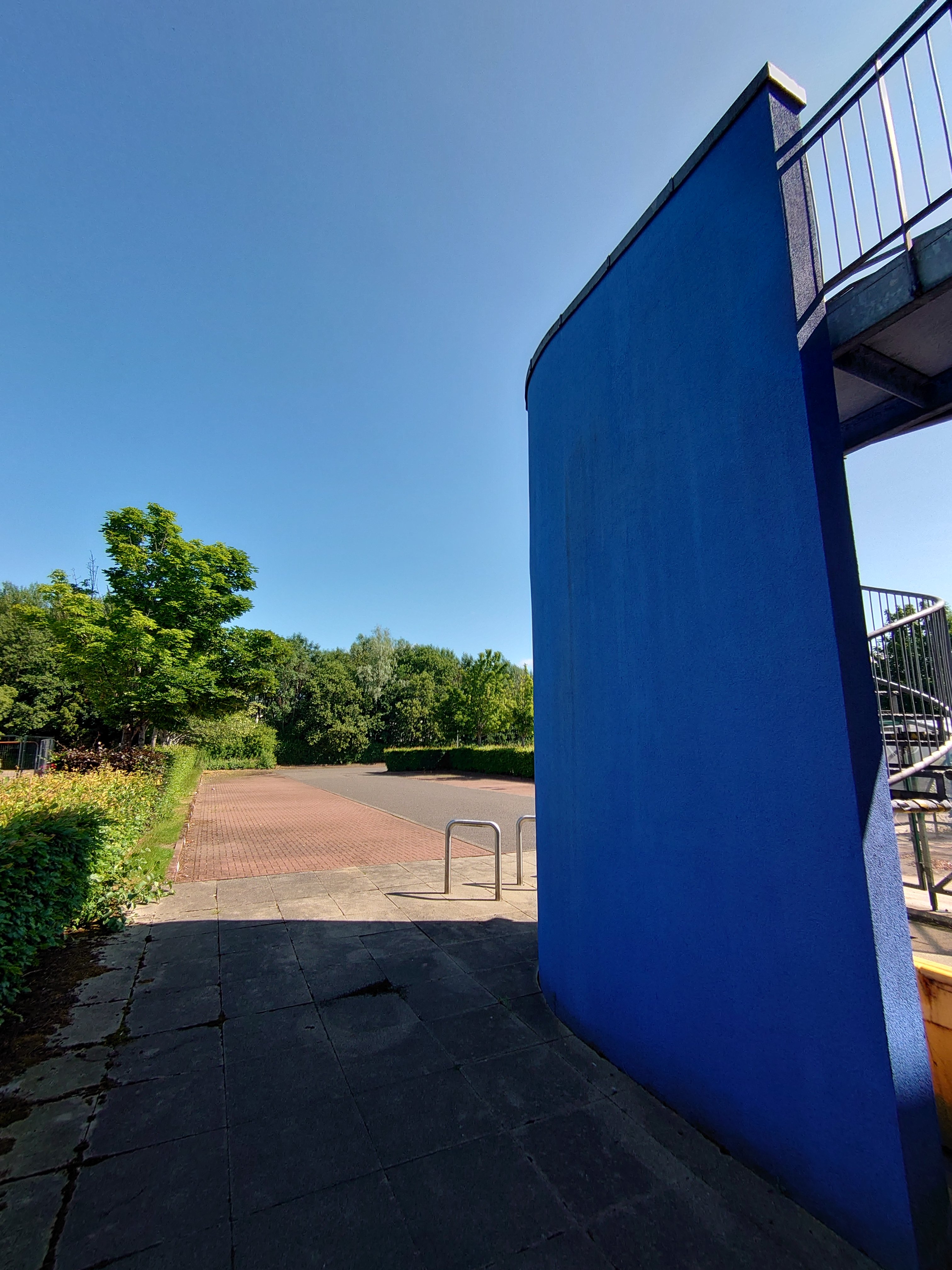

Not allowed to use rear car parks since damaged cars from roof in storm coming off. This is bloody Scotland, fix the roof while the sun shines. SEPA. You get weather forecast.

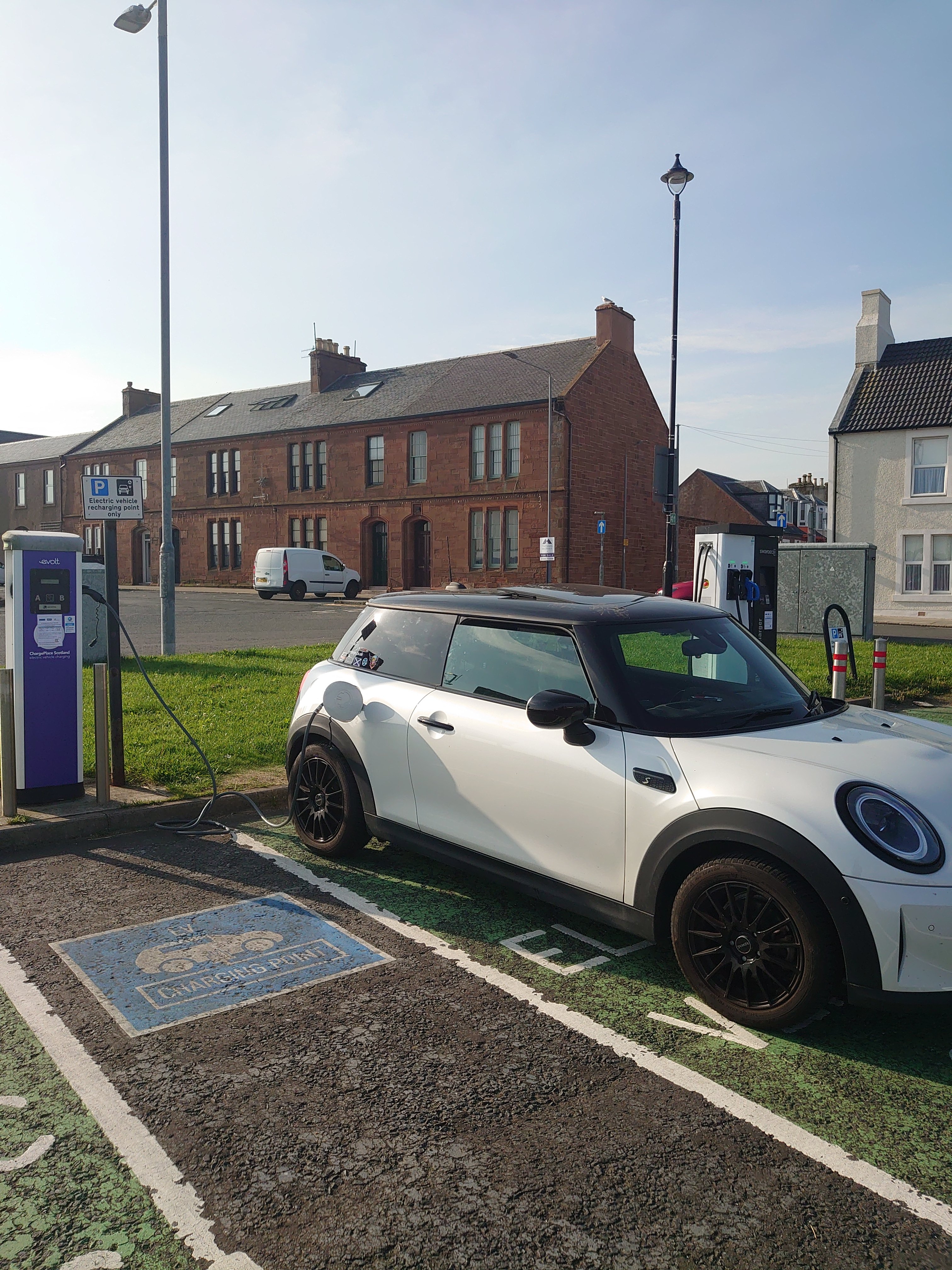

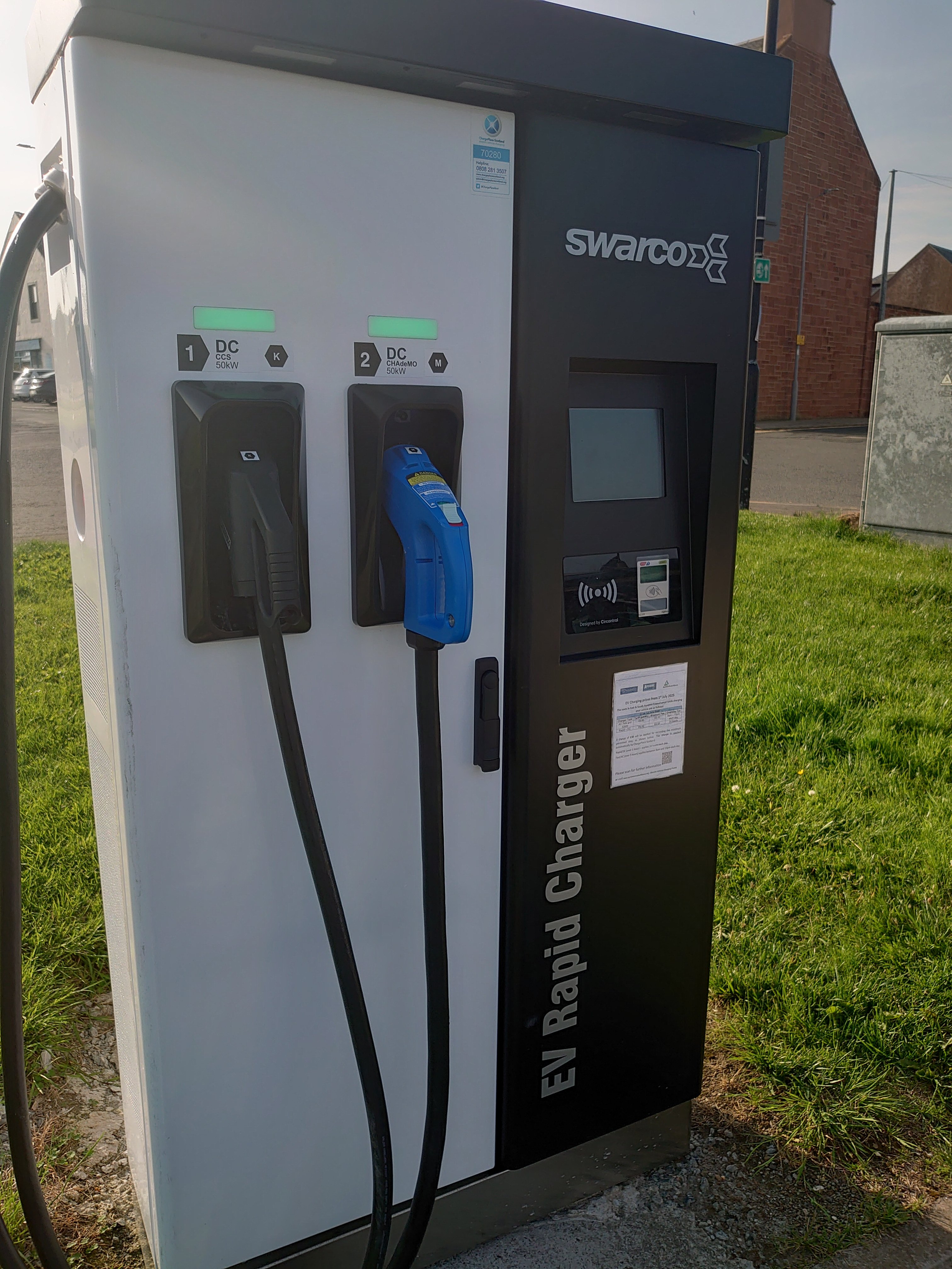

Finally the new DC charger is powered up at Girvan harbour. New one had no tethered AC on the side, so no 22 or 43 AC now.
