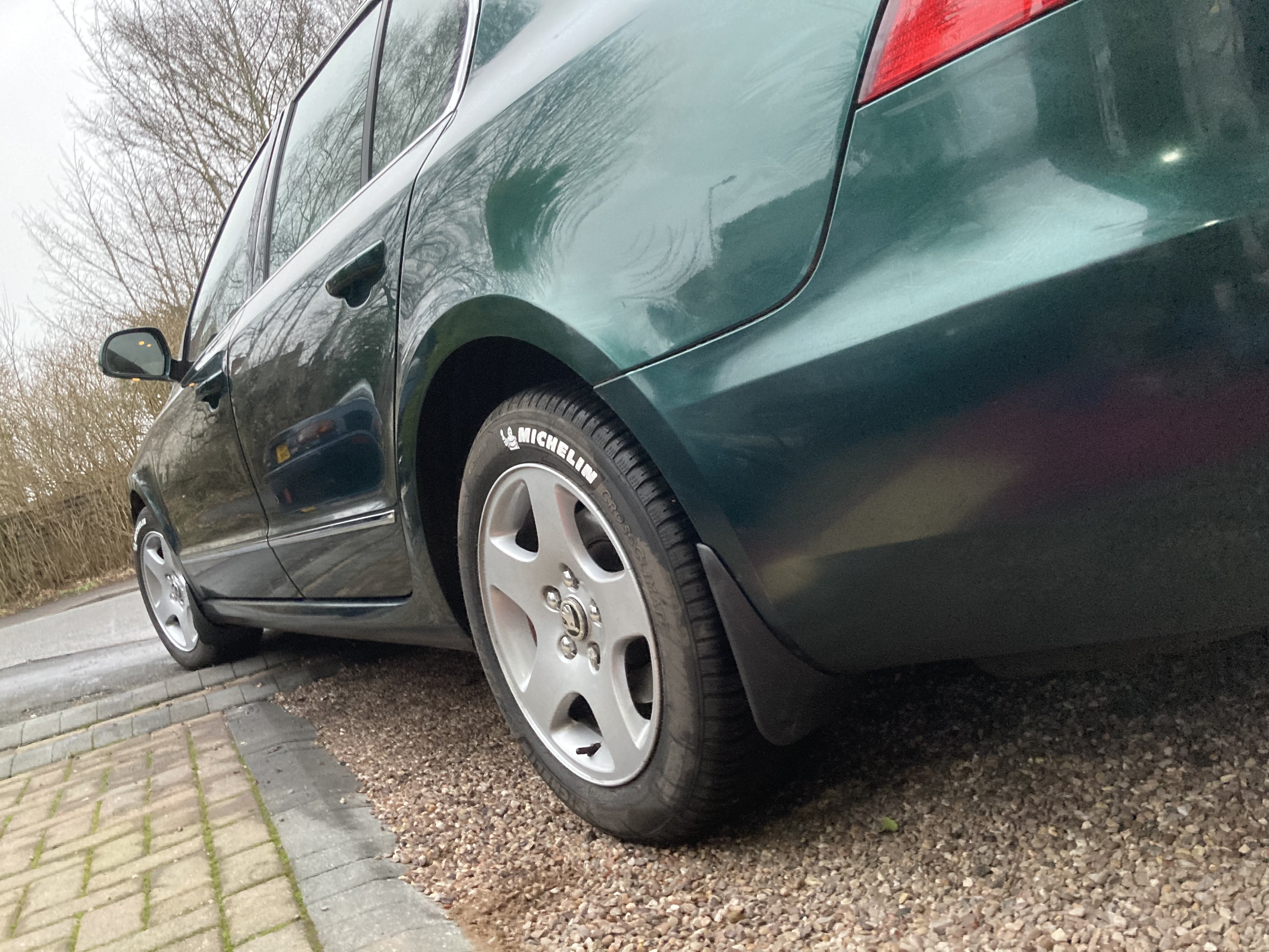

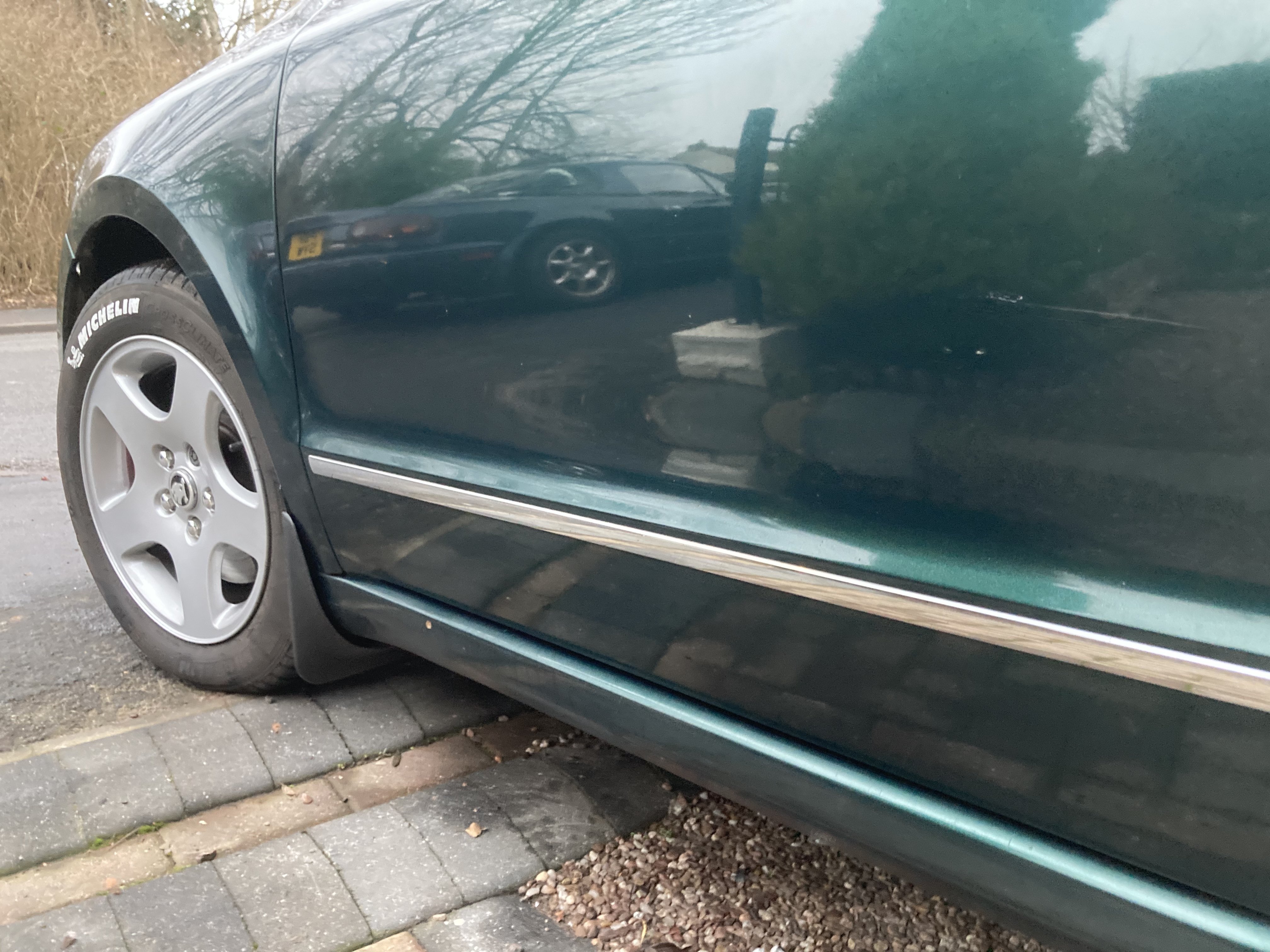

I've just bought some 16" Golf wheels today with 205/55 tyres that are hardly worn for £150. All my 225/45 17" tyres need pumping every couple of weeks so the tyres need removing and the rims cleaned and repainted.
Edited by Derbyshirebod
Better photo
A great thing to do. Yeah the 18th Ed look better but the ride with these is just great 😁
