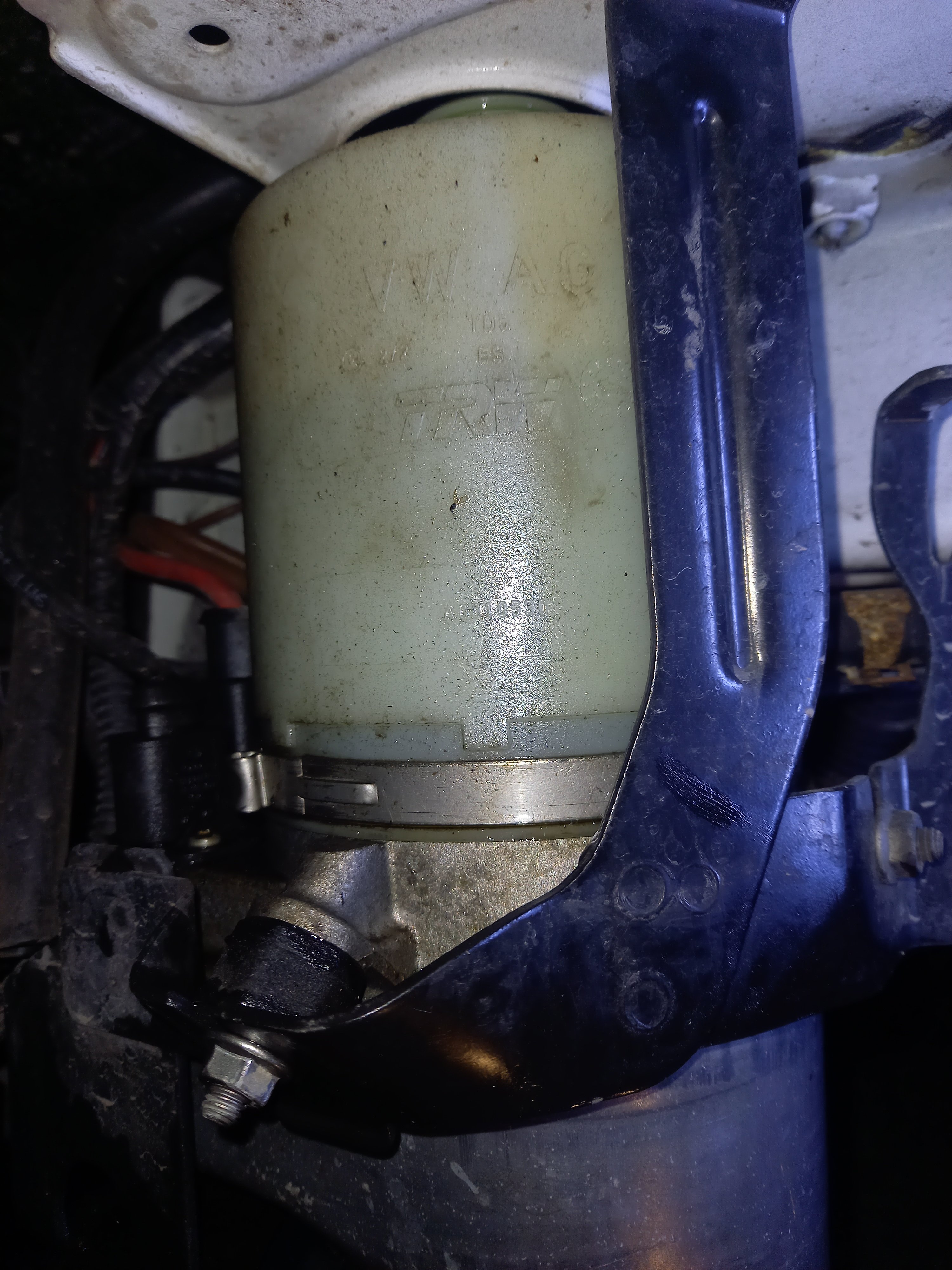

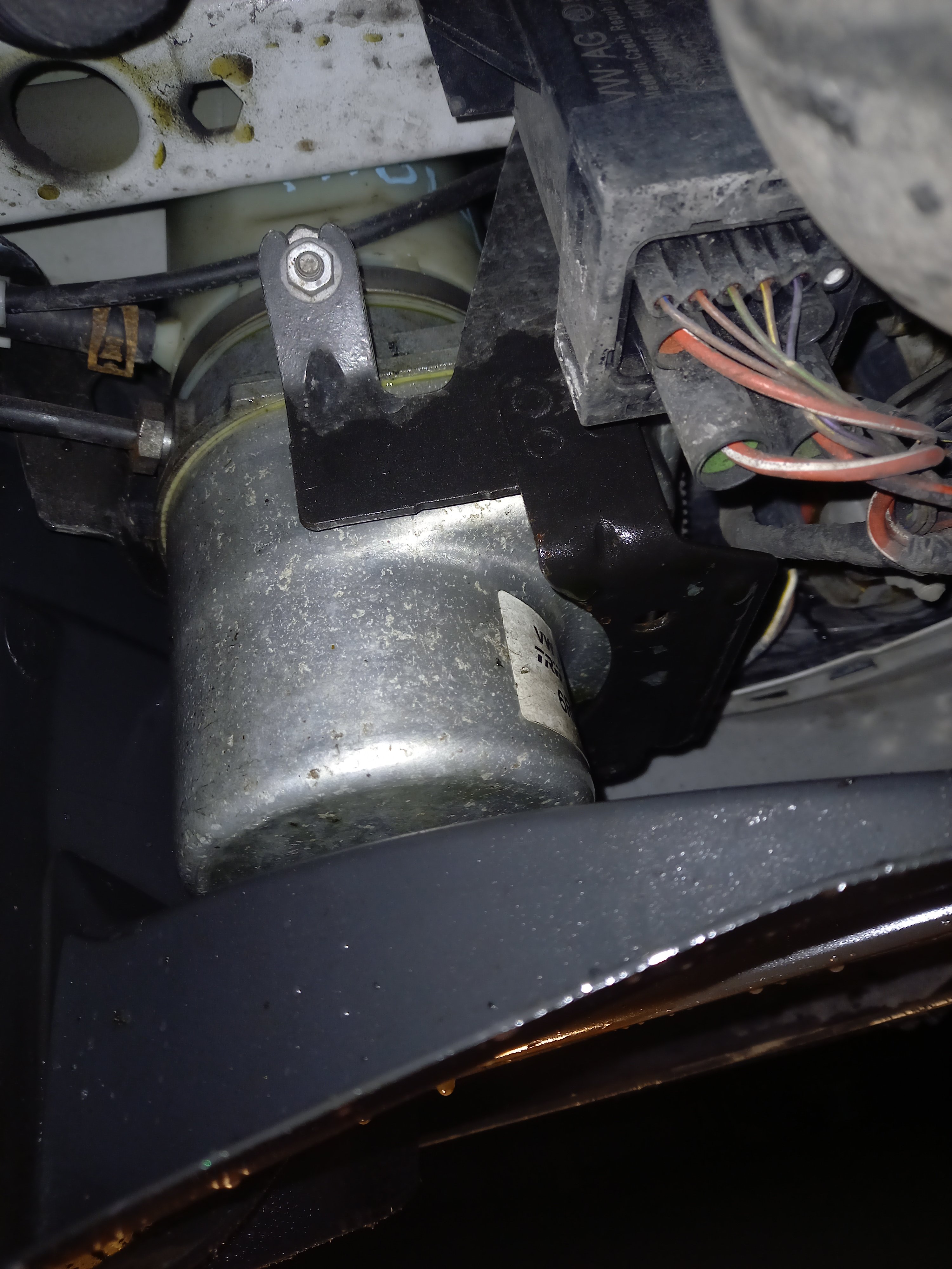

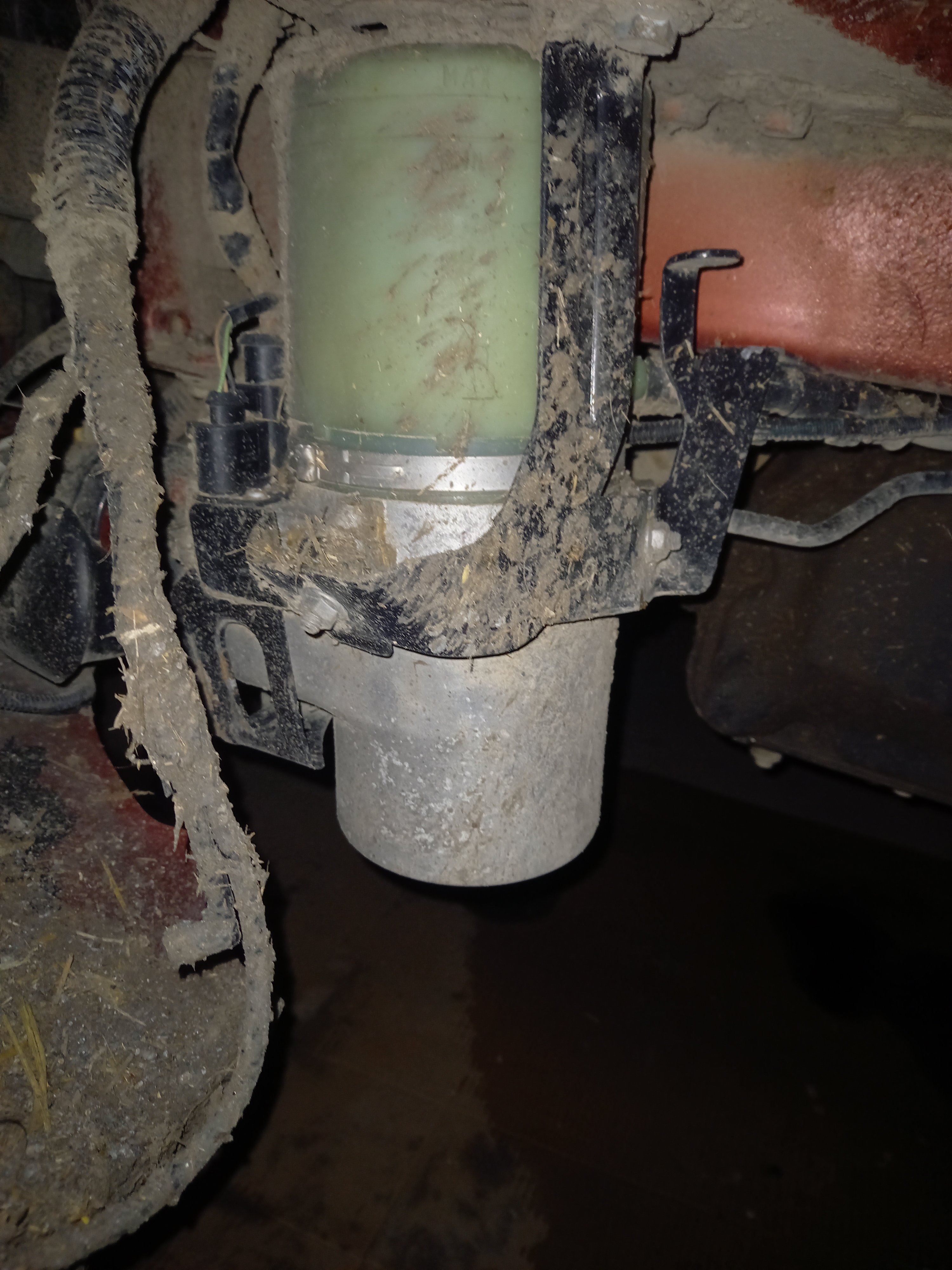

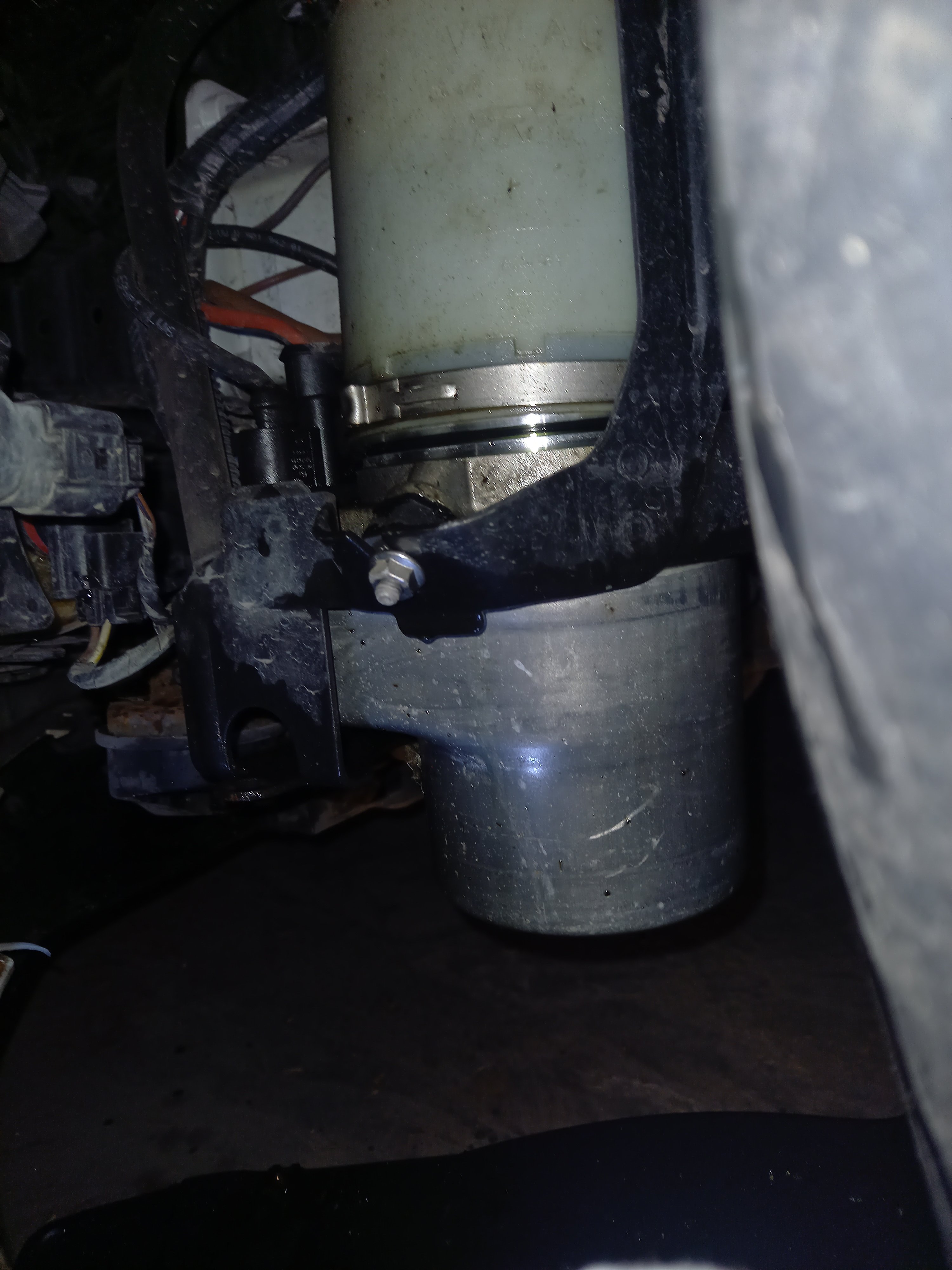

I believe I found my problem
Looks like the bottom of the pump "unit" has come off. I wasnt sure so I took a nosy under my mk1 to see...20211202_191934.thumb.jpg.9292138f5e06ef99e6bd7dbba471ff4e.jpg
Not sure how to reattach it to be honest.
Guessing I just have to push it back up?
The top half is the reservoir, the bottom half is the pump, you need to remove the entire assembly, and refit one to the other correctly and use a new clip to secure it unless the clip can be reused.

Intrigued to know what's caused that to happen. Clip looks to be unclipped, I think, but how? why?
Pressure relief valve stuck closed?
Looking at the large diameter of the O ring a huge amount of axial force could be produced if overpressured fluid cwere able to act on the whole diameter.
Forget the foregoing, I hadn't realised it was the reservoir, even if the breather was blocked that sort of pressure would not build up.

I managed to get it popped back in.
Think I got a bit more tension on that clip but time will tell if it holds.
Looks to be scrapyard writing on the other side so must have been replaced at some point before I got it.
So far its holding fluid and i've topped off the reservoir. If it holds it holds, if (most likely) it doesnt, i'll send it off to get fixed proper.

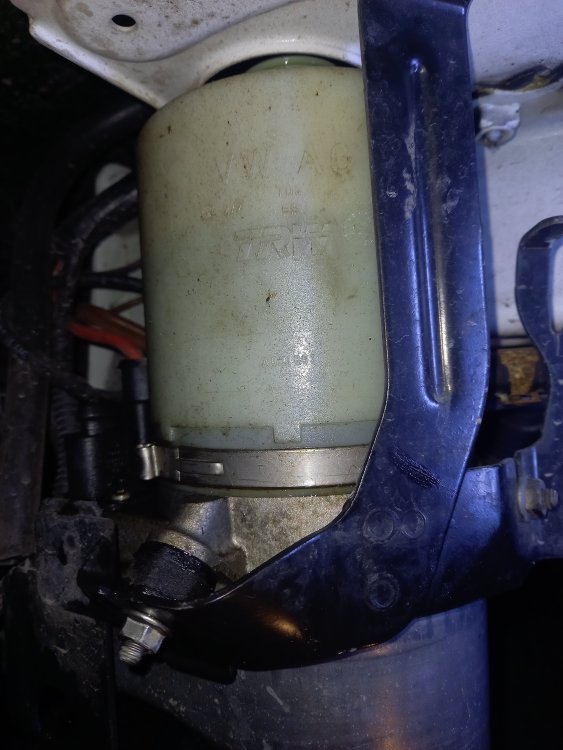

Of all the things to go wrong its certainly not something I expected! I'd be inclined to say our roads helped pry it apart lol. Most likely though it was just not put in right when it was changed.
So I did take a pic of the other side and you can see just at the top of the pump there is scrapyard writing, atleast I think it is anyway. It says "fabia" on it, naturally enough.
