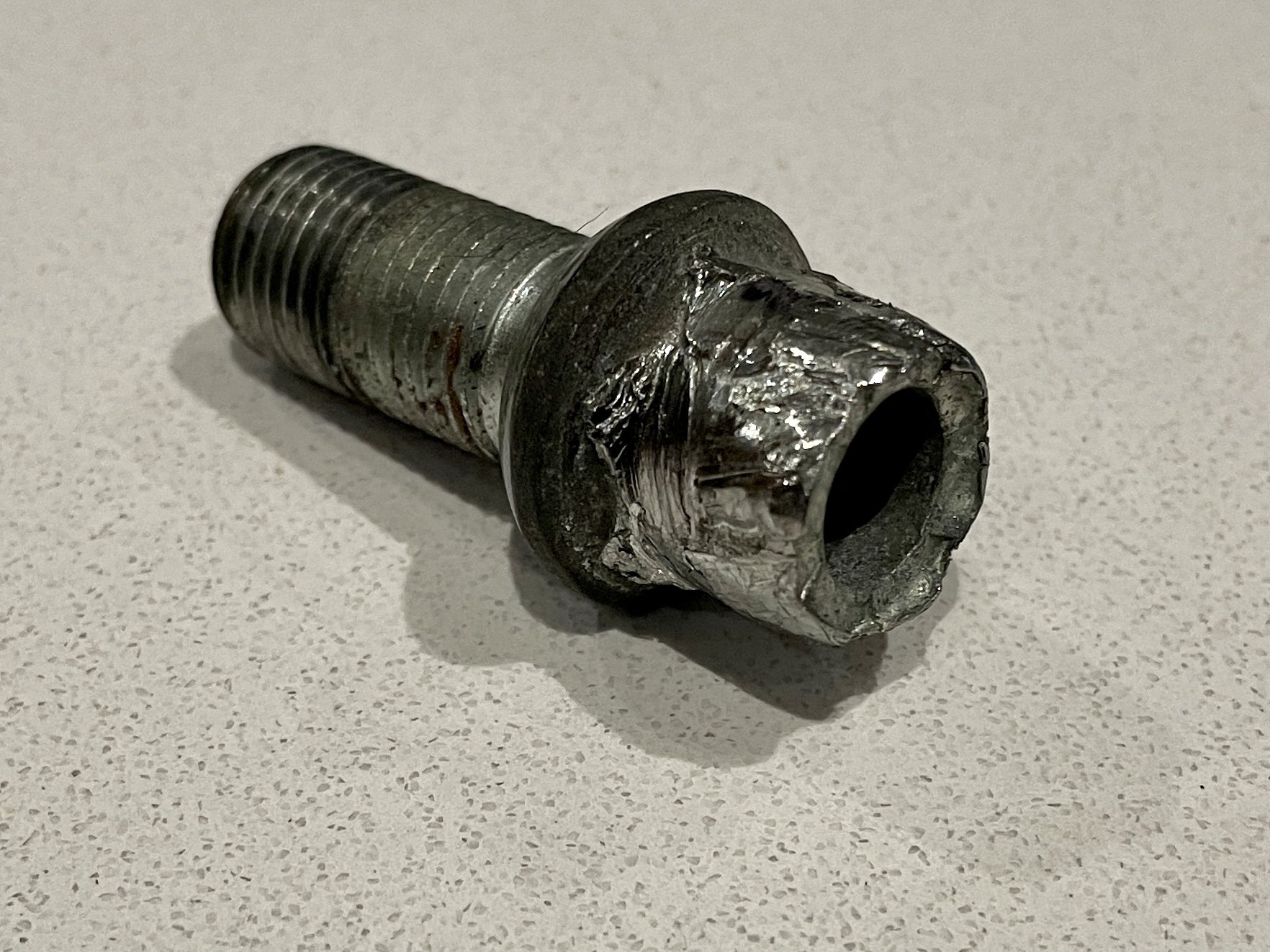

Rounded wheel bolt!!!!
Anyone know a good place to source good quality 17mm wheel bolts for my Yeti please, preferably original Skoda branded?
I've rounded off one of my wheel bolts, the 17mm socket had cracked without me knowing, serves me right for using a cheap socket I suppose!!
I hope to get it off with one of those bolt removing sockets that remove rounded bolts, but I'll need to replace there bolt and may as well get a set of five so I can do away with the locking bolts as well.

Had to take the Yeti to a garage to get the bolt removed, they used a breaker bar, good quality socket that they whacked on with a nylon mallet, and cracked it off. I doubt that I had put it on too tight as I use a torque wrench at 120Nm. I have a couple of short journeys that I need to make, so I'm checking the remaining 4 bolts on that wheel every few miles, hope to get a replacement bolt soon.

First thing too buy is a decent 17mm socket and a tool to attach it to that keeps it at the correct angle so it does not wrench off.
I cannot understand how a wheel bolt could be rounded off unless the tool is not kept parallel to the bolt with a long extension.
The way the material is laying on that bolt looks like the damage was done when tightening.
Assuming that you would have noticed that damage when putting the socket in place you didn't by any chance crack the socket by accidentally tightening before realising?

Ha, no, I didn’t tighten it by mistake.
one thing I noticed was a few other bolts were quite tight. When I last put them on I was using a brand new digital torque wrench. Despite setting it correctly I’m wondering if it’s not calibrated correctly and has over tightened them?  I’ll have to compare it to my standard torque wrench.
Yes, I absolutely need a good quality 6 sides socket and wrench/brace, the socket that cracked was a 12 point socket. I’m off to get a Halfords Advanced/Professional socket tomorrow. They do decent looking 18” Advanced breaker bar that I’ll take a look at.

TBH, I would have guessed that that damage was done with a rattle gun with its torque setting set at max and a non impact spec socket that was already worn, really surprised you can do that damage with a hand tool and not notice. 😲
I'm the only person who has touched the wheel bolts whilst I've owned the car, and I've only ever fitted/removed them using hand tools.

Ended up buying a bolt from my Skoda dealer for £6ish, as I wanted to be back to having five bolts on the wheel ASAP. Picked up a 17mm 6 x sided socket from Halfords too. Wont be using 12 point sockets on the wheels again. I now need to see if the new digital torque wrench reads the same as my normal wrench, to see if it's over tightening the bolts. Im quite sure the correct setting is 120Nm?
