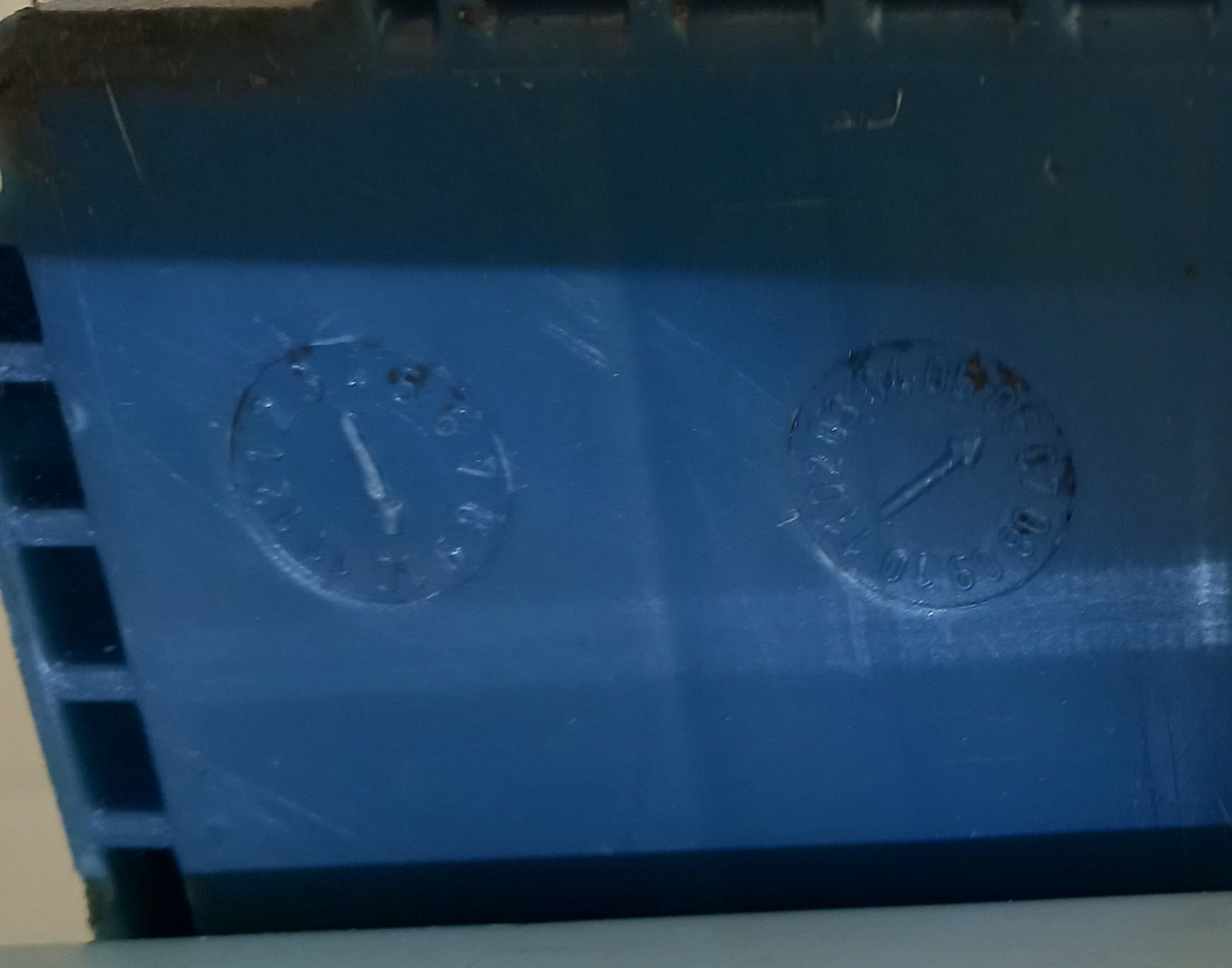

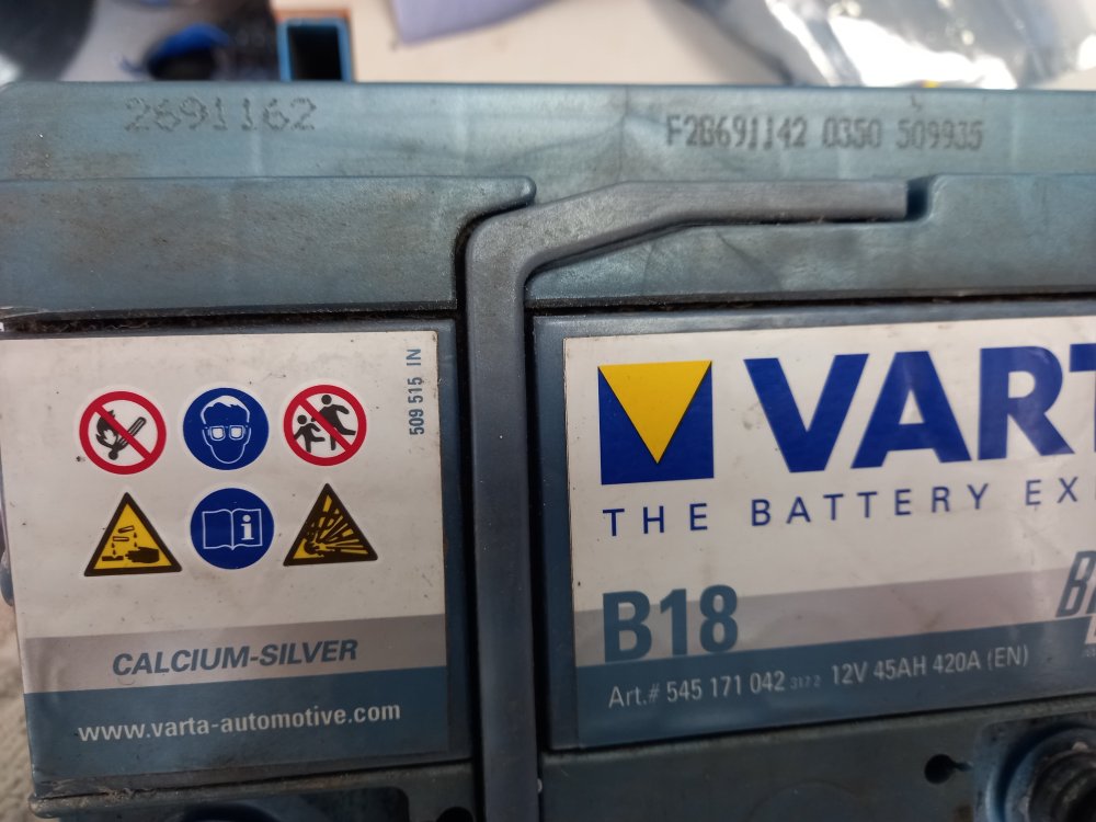

Extracted from a late 2002 Fabia, whose owner believes the battery has been replaced at least once in the car's lifetime; hazy about when.
Top photo has various numbers along top edge that may include some manufacturing date info, but it doesn't 'leap off the page' at me.  Anyone able to decode?
What is interesting is that there are some 'date wheels' on the bottom of the case that suggest October 2006 for the manufacture of that. Apologies for photo quality/lack of, especially the second.
Edited by Wino
The clock dials in the mould might be for when the case was moulded or could be for the last revision or repair to the mould, on low volume production it would normally be the latter.
The 'clocks' are probably your best bet but is there an engraving on it anywhere - the place I get my batteries from always engraves their postcode and the date of sale on the case.

Nothing I can see except what's in photo #1.
I'll check if he had the car in 2006, can't remember.
  • Sponsor
Awesome, thanks @skomaz. I was hoping something as useful as that might come out of this thread.
That fits with the production date of the case body.
