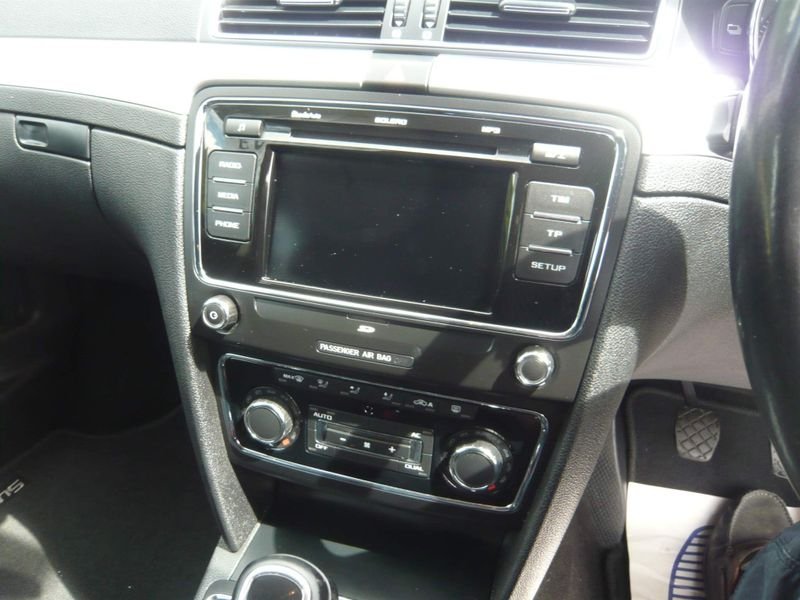

My questions revolve around the ICE.  Pictures show it's got a Bolero head unit (picture of it from the advert) - I don't think it has DAB radio.  It's also not clear if the car has Bluetooth hands free telephony.  I want both of these things.
Is it possible to fit a Columbus from the same era?  I see a couple listed on Ebay for c. £300.  Would I need a Bluetooth module as well?  Alternatively, does anyone have experience with aftermarket touchscreens?  Don't mind spending up to c.£400 to get what I want (DAB, Bluetooth).
Thanks in advance to anyone who engages!

The 2011 SE didn't come with bluetooth as standard, however if you can hold out, personally I'd definitely wait until an elegance came up.
None of them came with DAB at that age, but the elegance gets adaptive xenon headlights, leather heated seats and columbus satellite navigation as standard over the SE.

I can speak to aftermarket head units as I just took out my Columbus RNS510 and replaced with an Xtrons 10" Android 10 unit. Fitting it was a breeze but you will need some adapter cables like dual fakra to DIN and another type for the GPS if you want to use the built in car aerials rather than the feeble ones that come with the head unit. It has bluetooth and hands free. Happy to answer any questions or go more in depth as to what I bought and the process to do it if you'd like.
I bought my 4x4 SE assuming it had blue tooth as standard as there is a phone button on the Bolero head unit but it hasn't as there is no blue tooth unit under the drivers seat. 😞  I think an aftermarket head unit is probably going to be the quickest way to get Bluetooth & Sat Nav. A head unit with a with an auxiliary socket so I can connect my phone and use google maps?  https://www.ebay.co.uk/itm/143727992879

Elegance spec comes with the Columbus as standard, and the Bluetooth module under the driver's seat. I've had no complaints from people about call quality in nearly 6 years of ownership. OE microphone is fitted inside the front map light console at the top of the windscreen.
