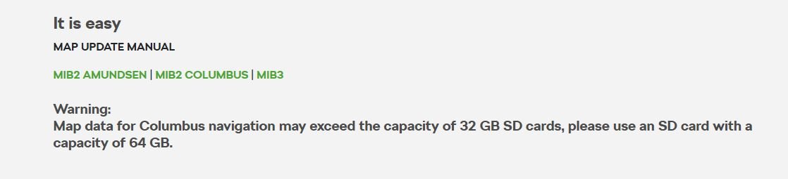

I've ordered a 64 GByte SD card since that's what Skoda recommends so I will give that a try and  report back here.

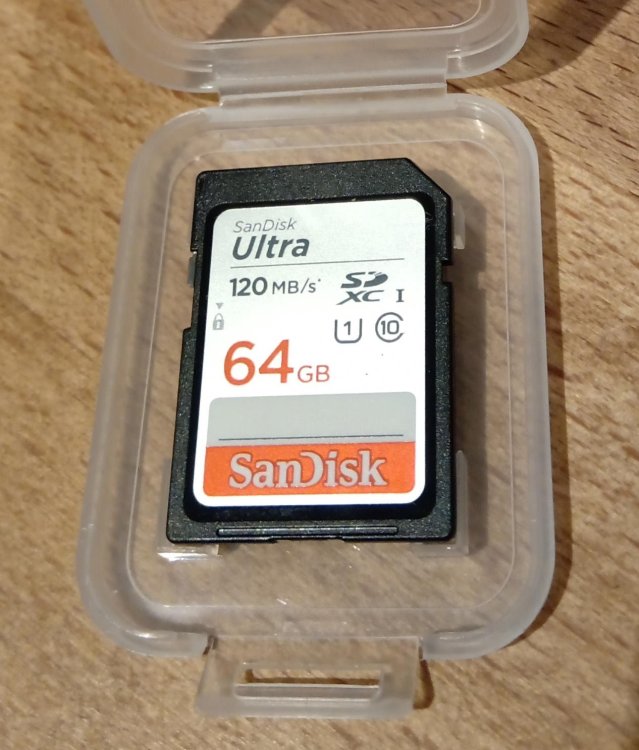

For future reference, I've attached a photo of the SD Card that worked for me.
I got a 64GByte one - just in case the SatNav database increases in size again in future. It's formatted to exFAT (which is the way it was supplied - I haven't changed or reformatted it at all). It cost about £8.99 - available just about anywhere that sells these things.
It took the best part of an hour to upload the database in the car, but there was a steady progress display on the Columbus screen to indicate how far it had gone.
