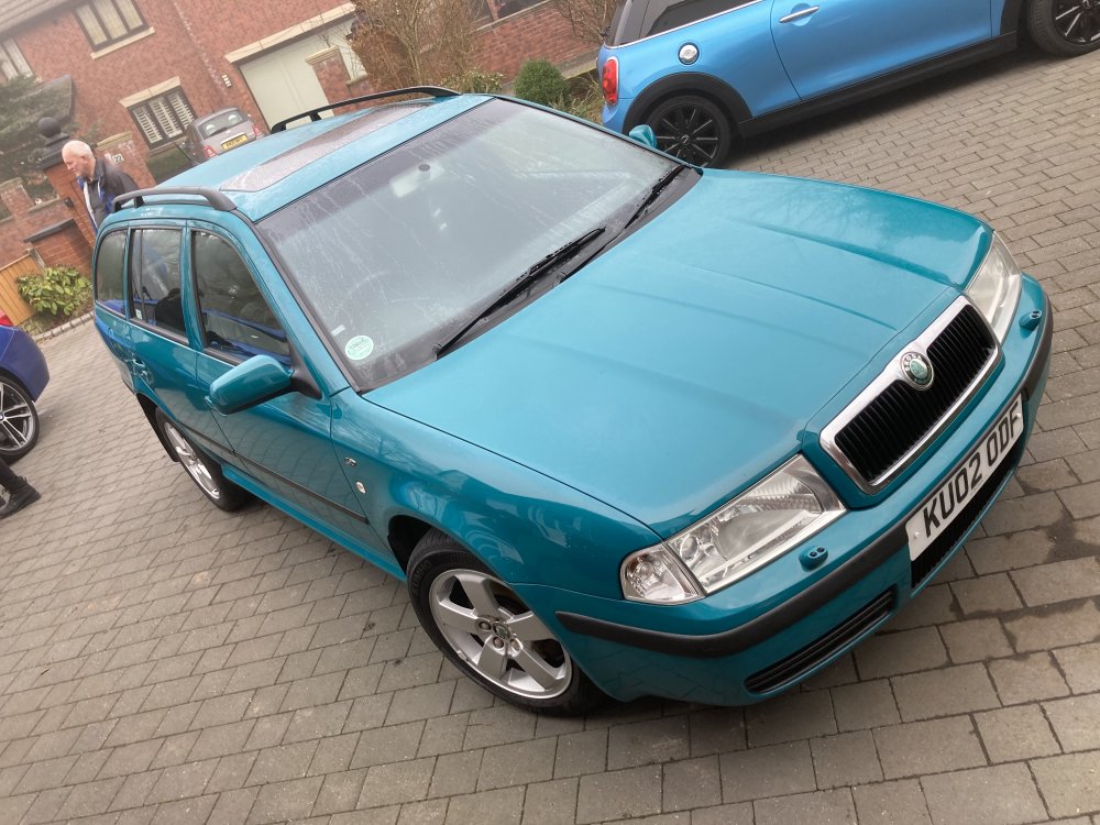

I’ve just recently purchased a 2002 Mk1 Octavia 1.8t 4x4 estate.
