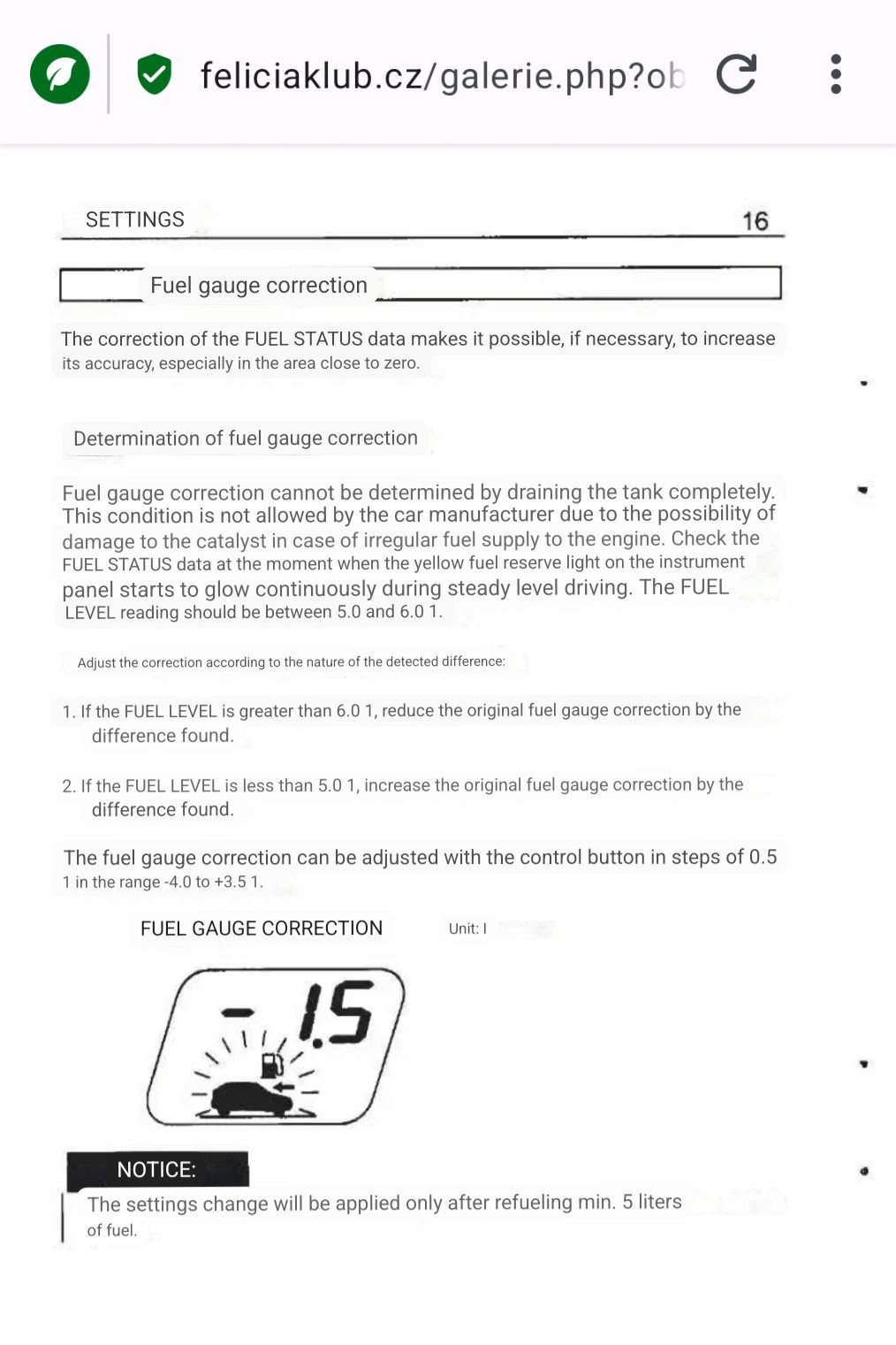

I have the TC-6 for about 2 years and i have to disagree with that, not totally but in a specific point.
In Total (with the symbol Σ) and in the remaining kilometres with the gasoline that it's left in the tank (with the symbol > 📳 ) there is a difference of 1 ltr from the reality.
Although there is a calibration function and i have it in the maximum (its +7) but that difference can not be zeroed. Since the TC-6 works together with the factory float i don't know if that 1lt maximum difference is because after switching Off the car when parked the gasoline in the tank isn't immediately ''calm'' or the inclination of the ground (uphill-downhill) cause this.
I will post photos soon as a proof.
Fuel gauge is calibrated in a different menu.
As you said, it uses factory float, so it's not very precise.
