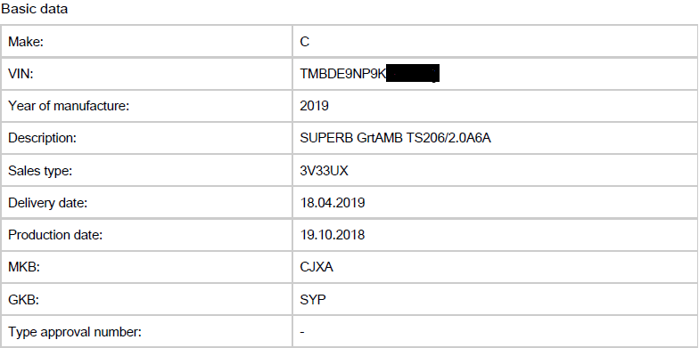

CHHB which is the 220 tsi uses direct and manifold injection
I think this covers it . CJX has MPI apparently.

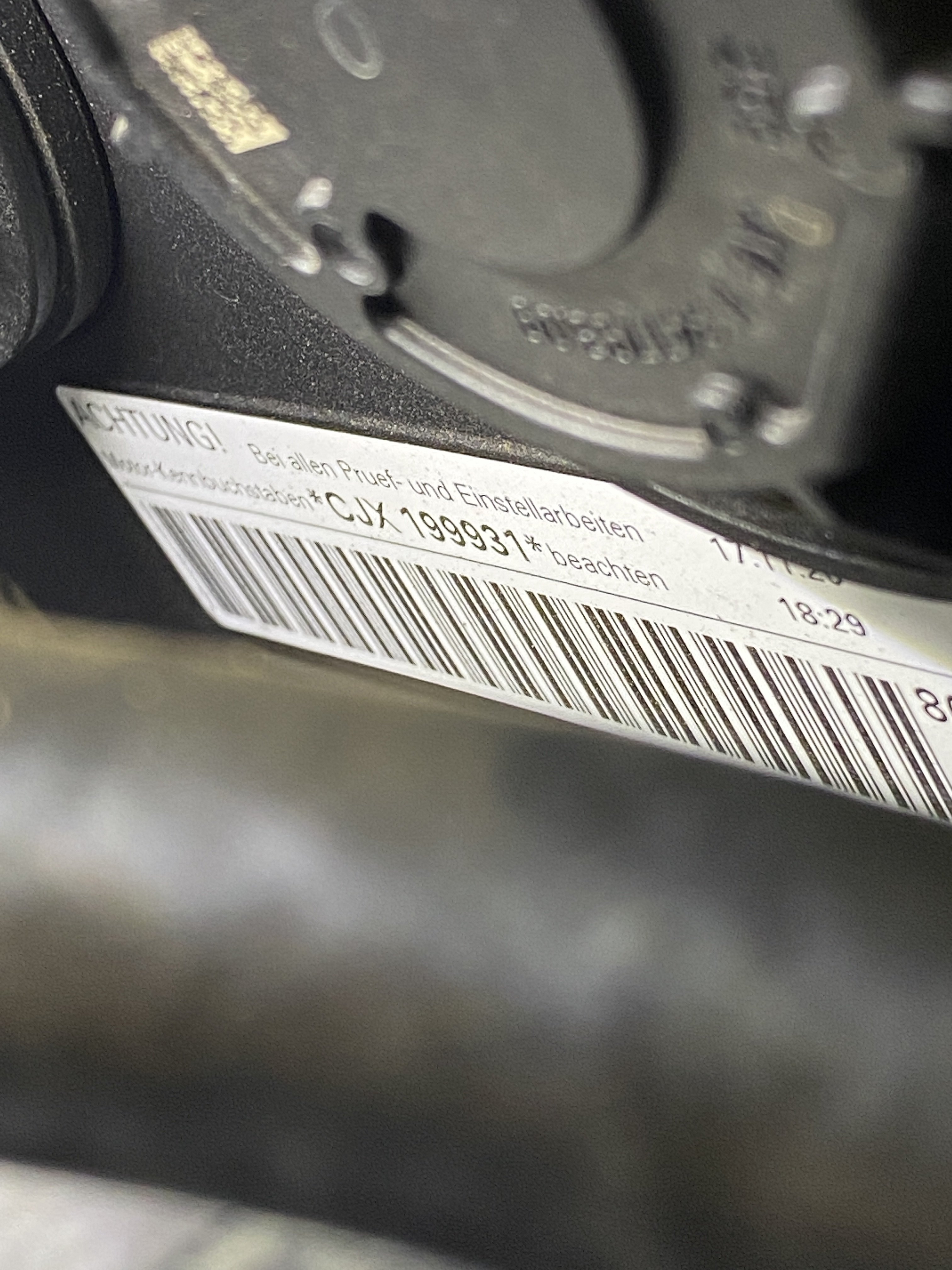

Aus delivered MY21 206 Superb Sportline has the CJX engine (just had a look at the plate on the side of my engine). So Multi-Point Injection.

Maybe in other markets Skoda has reverted to DI engines, but the the Aus-spec 206 engines continue with the CJX version with MPI. Attached is the placard on the side of my MY21 Engine.

It is easier to take a picture of the engine, to know if there is MPI or not.
I think, but I am not sure, that CJX does not mean it is with MPI.

Engine code tells everything.
Engine code of 272 is DNU, no MPI.
New 280 engine code should be DNF, no MPI as well.
Both of them pair with 7 speed DSG, and have GPF.
While CJX, has both direct injection and mpi, pairs with 6sp DQ250, and works without GPF. That's the engine and transmission Australian received in their Superb Sportlines.

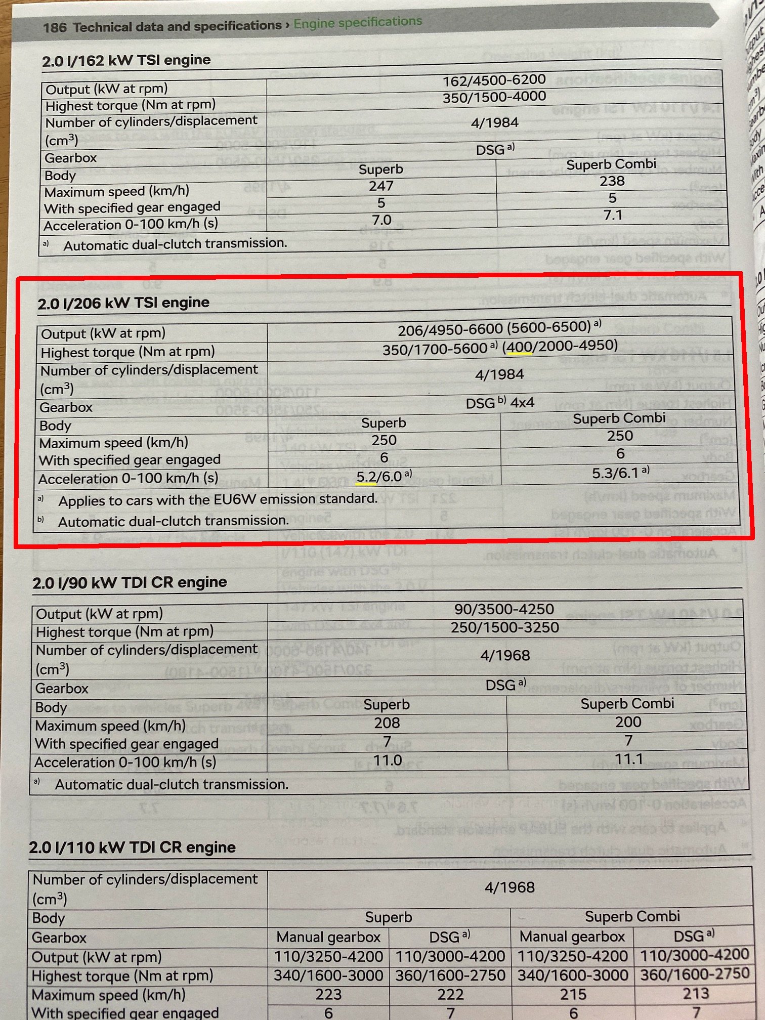

So what's interesting in the back of my MY21 user manual, is that there are performance figures for the non-Euro 6 engines (ie. the CJX fitted to my vehicle) which show increased torque and acceleration compared to the Euro 6 compliant 206KW versions in other markets.
