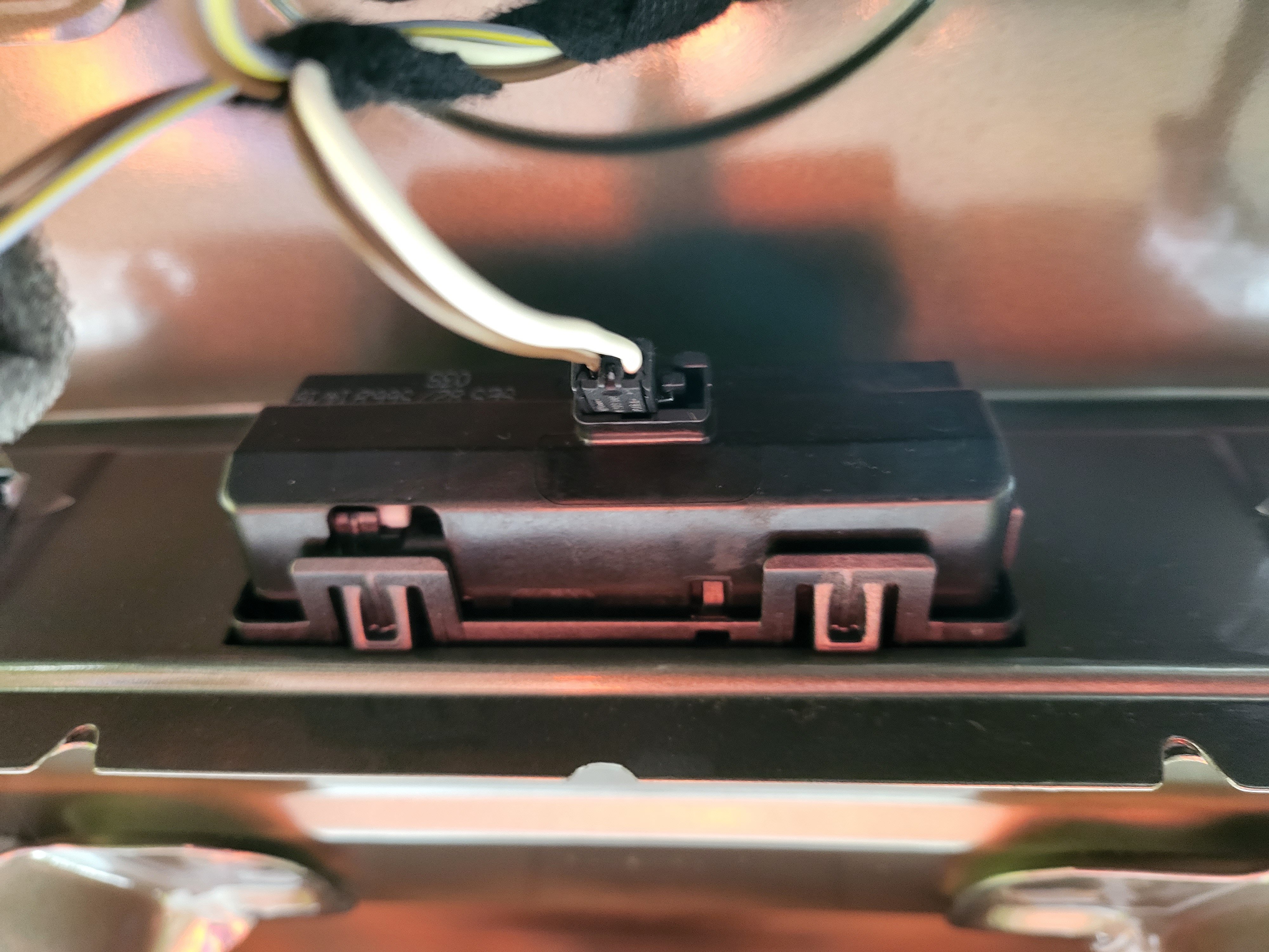

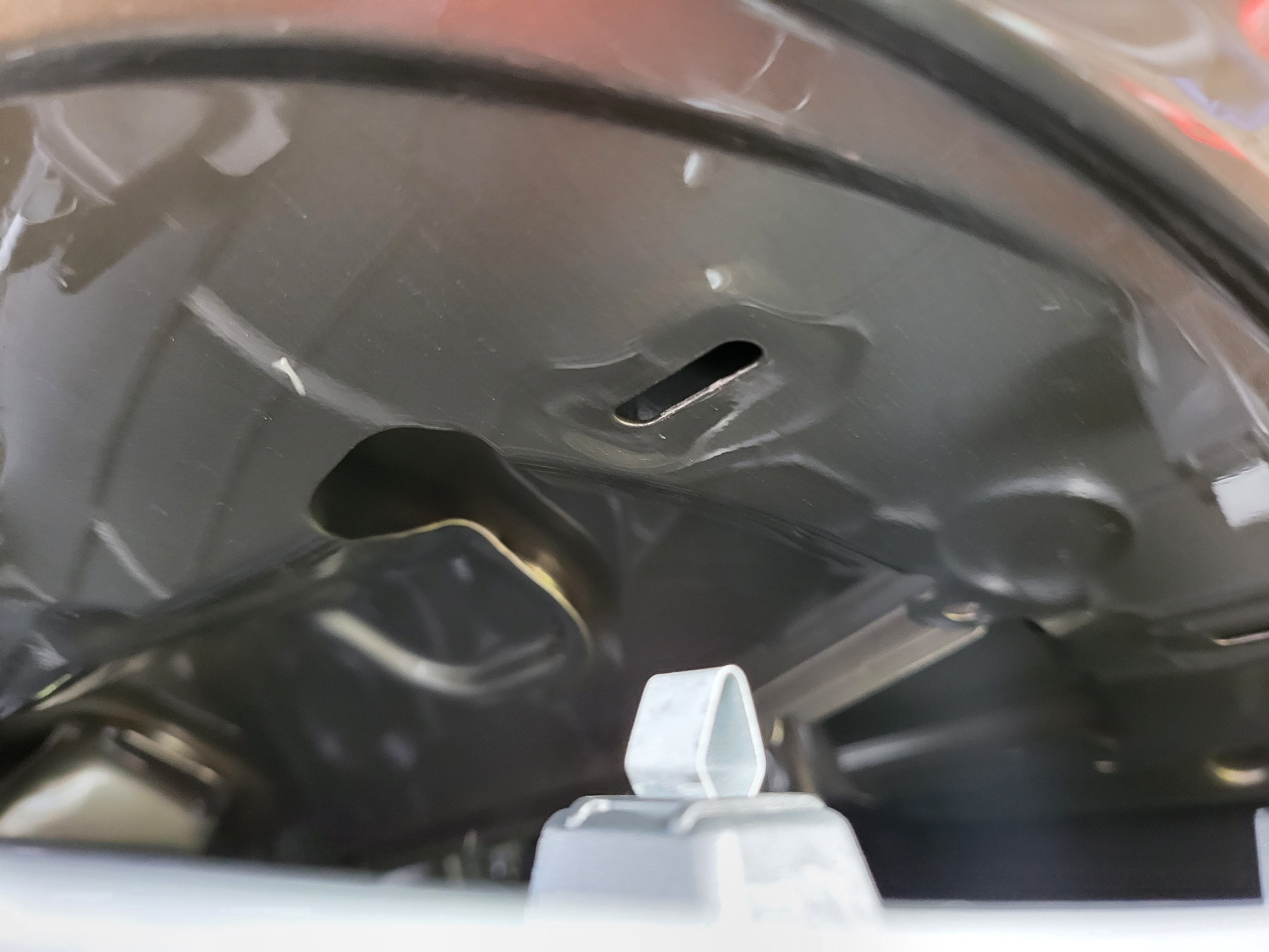

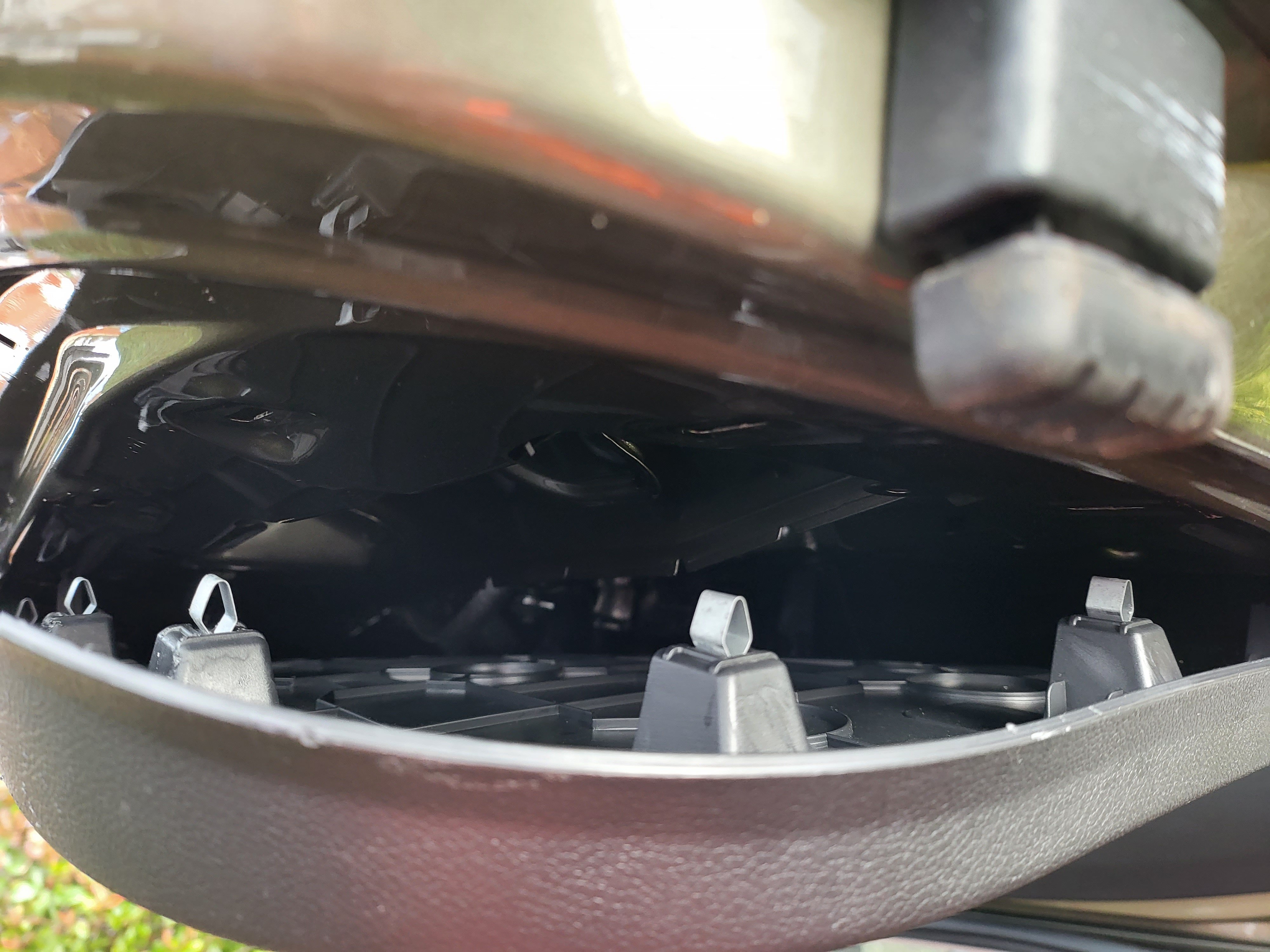

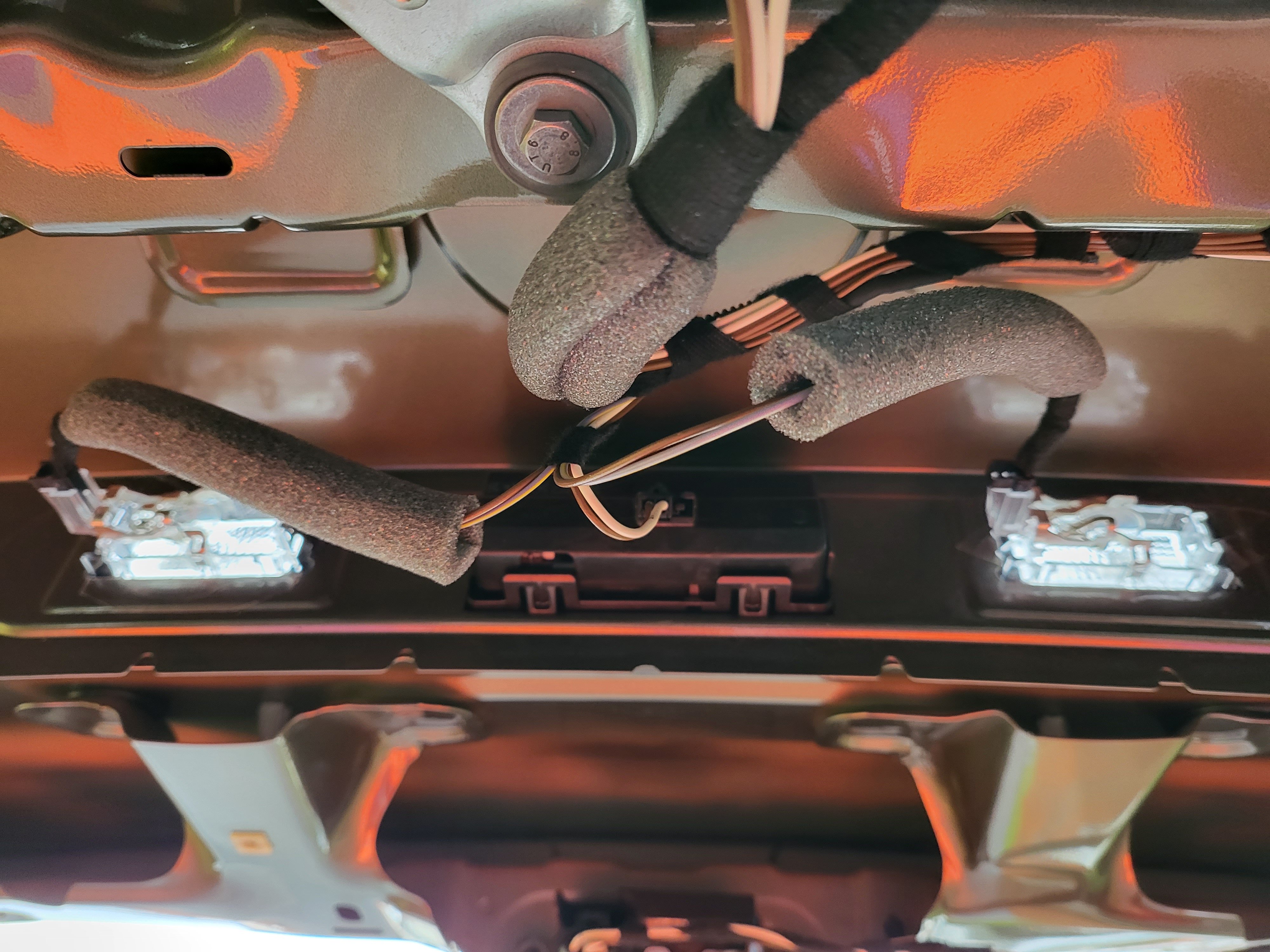

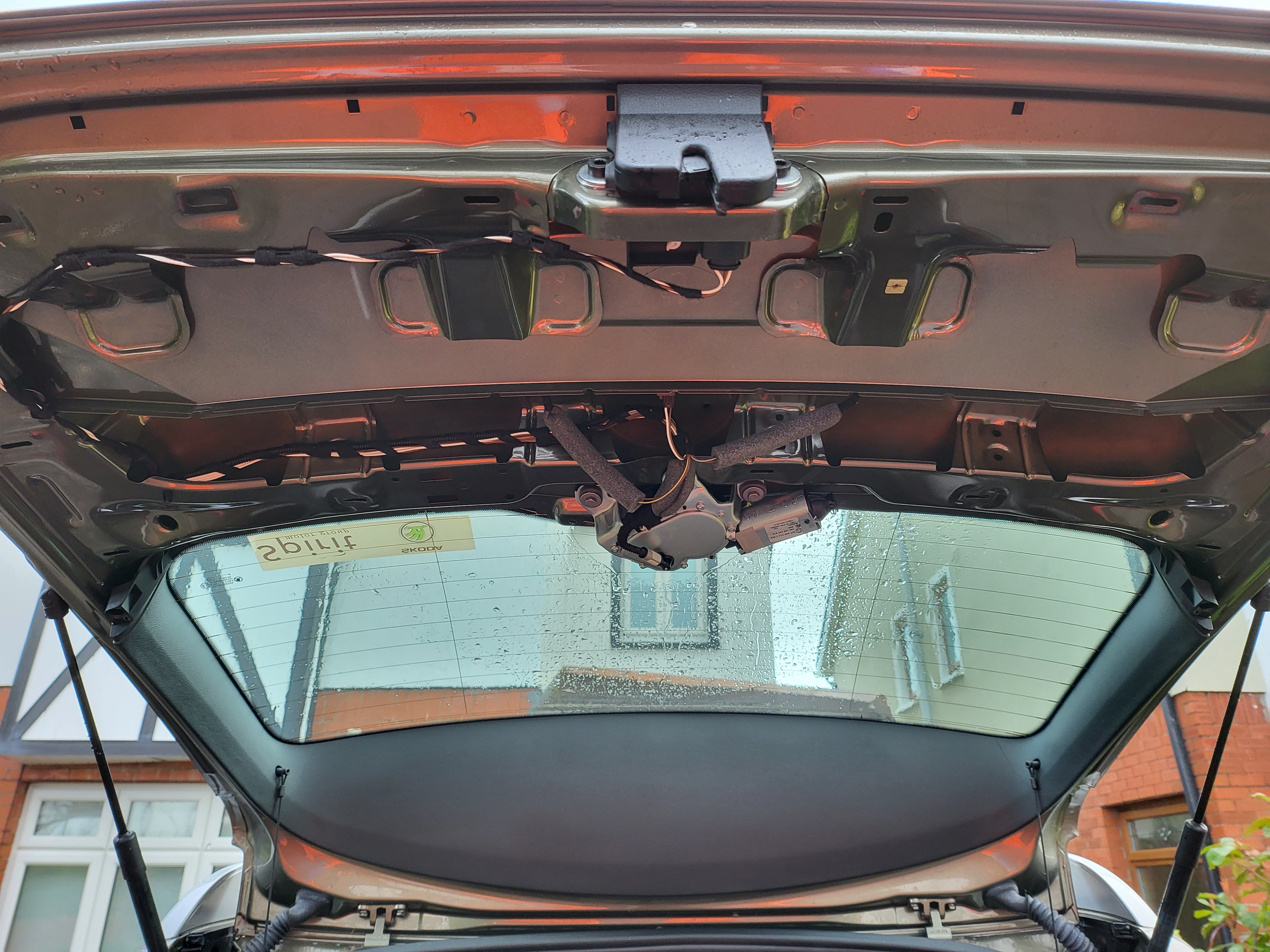

Hiya!

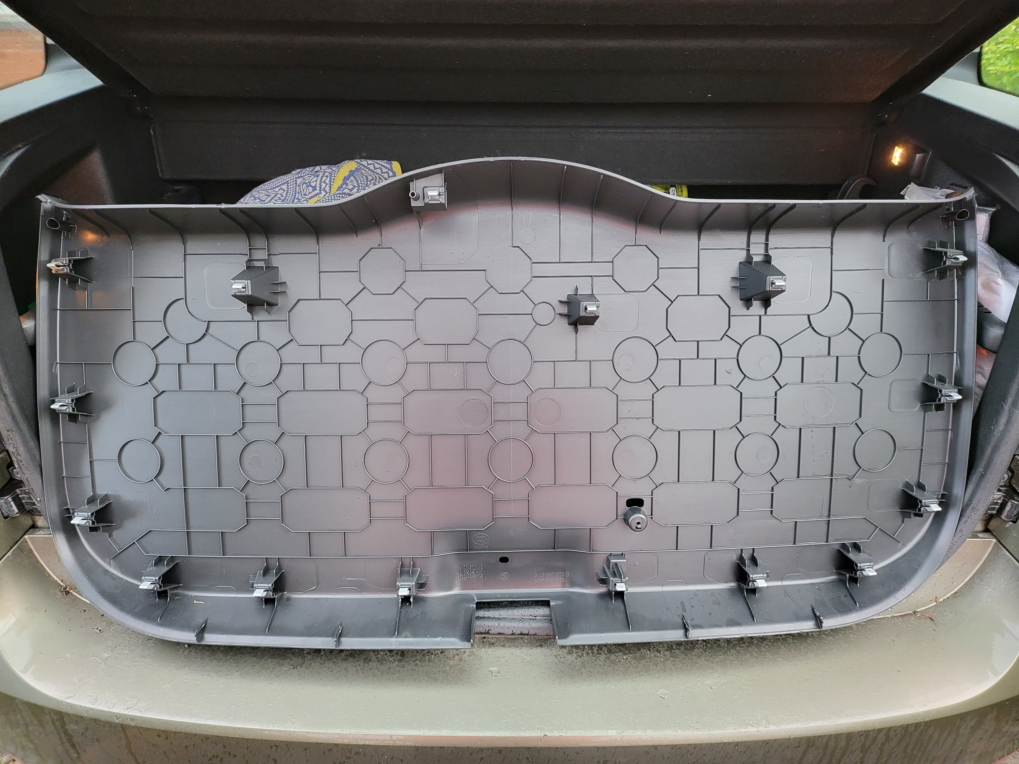

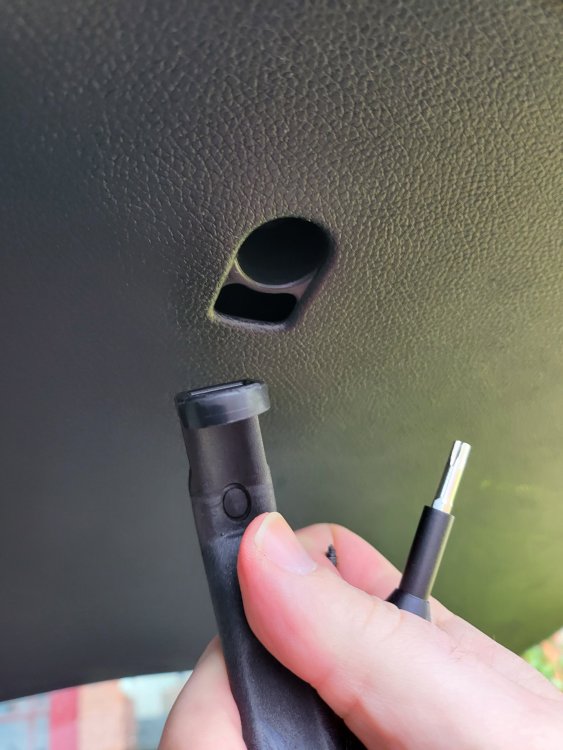

Had a "rummage around" the Skoda Yeti boot panel to check which connector is used for my boot opener, as I've decided to purchase a new reversing camera that replaces the boot opener. I don't want to drill holes in my Yeti. It's the LS8012 connector for my face-lift Yeti. I think the pre-facelift Yeti has the other connector.
A right pain in the backside to remove. Unscrewed the rubber boot strap and pulled it out. To remove the boot panel, the clips attached to the body requires getting a long strong plastic "spatula-like" implement or two and with fingers forcibly pull it off as the clips are on tight. I've left the panel off until I get my new reversing camera as I don't fancy removing it again. I began at the bottom, closest to the boot lock, as I had the best access and not like some where the panel meets the window.
I'm buying this on Amazon UK (I have vouchers to use), Dynavsal 1280 x 780p night vision camera together with this in case I need it: 12 Volt Rectifier.
At the moment I think I'll pull the reversing camera cable through the bottom of the car, as opposed to via the roof. Mind you, I might change my mind as I'm doing it... 🙂

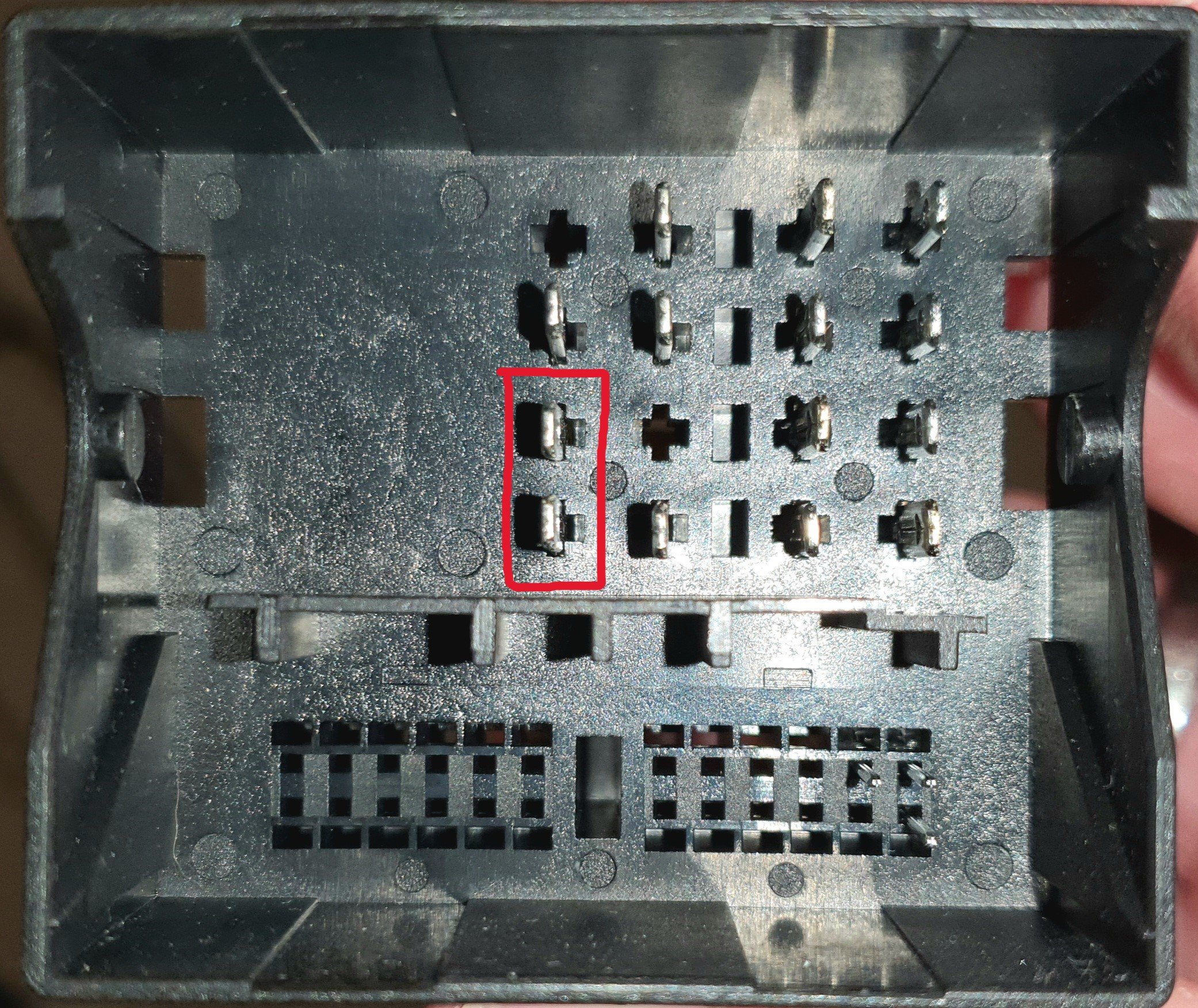

Hi Gaff

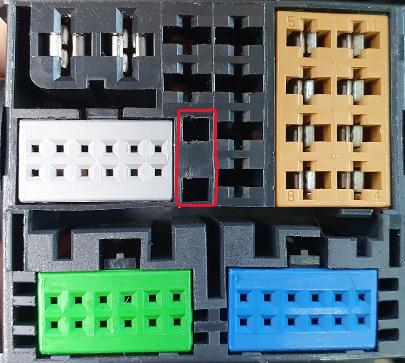

Thank you for that guide! I bought a MA90TVLS from XTRONS a little while back because my Amundsen 2's screen in my yeti has gradually stopped responding to touch and I don't fancy forking out £1000+ on the JVC that Skoda are offering. The connector from the head unit to the Quadlock is almost right, but not quite. Did you find the same thing? Is that why you had to use the ISOQMB connector? There seem to be a lot of these that are available and they all look slightly different to one another. Do you remember what you searched for to find yours? Or have a link to it?
Thanks!
Shooz
Hiya Shooz,
I bought the ISOMQB from here https://www.navi4all.com/en/ as my Yeti is the MQB platform (second generation). I suggest talking to Navi4All to make sure you get the right version for your car and ICE system.
Best of luck and Sláinte!
Gaff
Edited by GaffCelticViking
Thanks for the quick reply, Gaff!
I got hold of Navi4All. They were very understanding, but unfortunately they don't sell the ISOQMB cable on its own. I bought my unit from the XTRONS Amazon shop, so I guess they would be the next best people to ask. I just hope they don't point at the bit in bold in the user manual where they don't recommend installing the unit if I have not had the correct training 😬
*sigh* It really shouldn't be this hard...
Shooz
