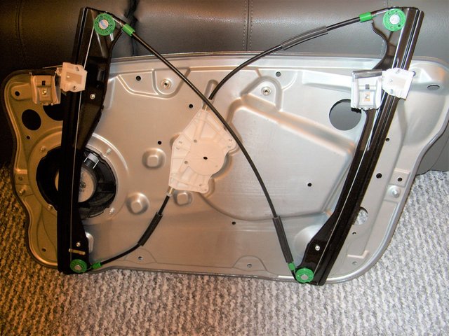

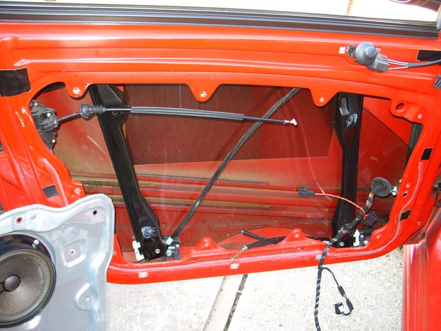

Reversing out of the drive this morning, rolled the passenger front window down to see better as it was wet, and bang! Window fell inside the door. Cables all wrapped around the regulator plastic cog where the motor drives it. Two years is all I got out of a full new regulator panel :x

Had a heck of a job drilling the pop rivets out of the regulator uprights to get the panel off. The rivets were just spinning with the drill but I got them in the end.
14 minutes ago, sepulchrave said:
Chinese rubbish from ECP?
Is there a brand you recommend? I thought they were all pretty much the same apart from genuine which will probably be an arm and a leg?
Edited by TMB
This was the new one that has just failed...
Since I'm thinking of getting rid of the car soon, I think I will just fit another similar one.

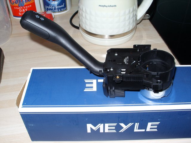

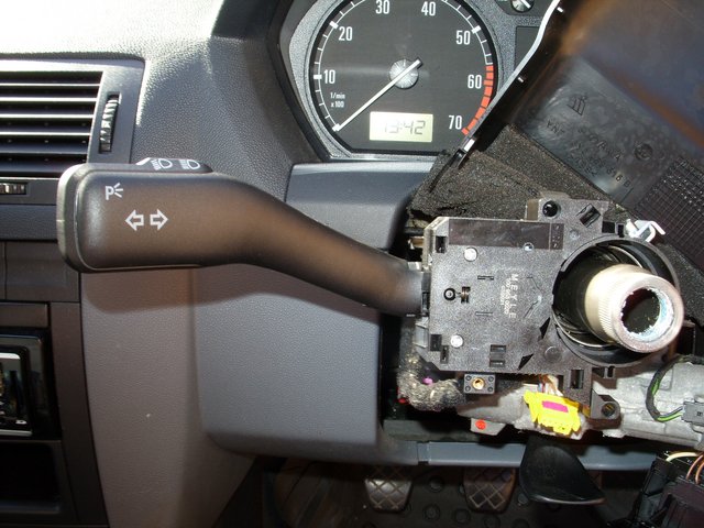

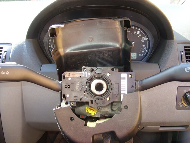

Only just bought a new indicator stalk too as my main beam flash has thrown the towel in.
  • TMB changed the title to Window Mechanism Again
Nice day outside so I got the indicator stalk done. Main beam now flashes again 👍 Airbag light was on afterwards so had to erase the code. Stalk was quite a bargain at £16.90 for a Meyle one.

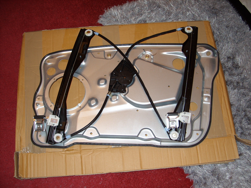

New panel has arrived. Paid twice as much this time for something that pupports to be ''OE Quality''.
https://www.ebay.co.uk/itm/193241436844
