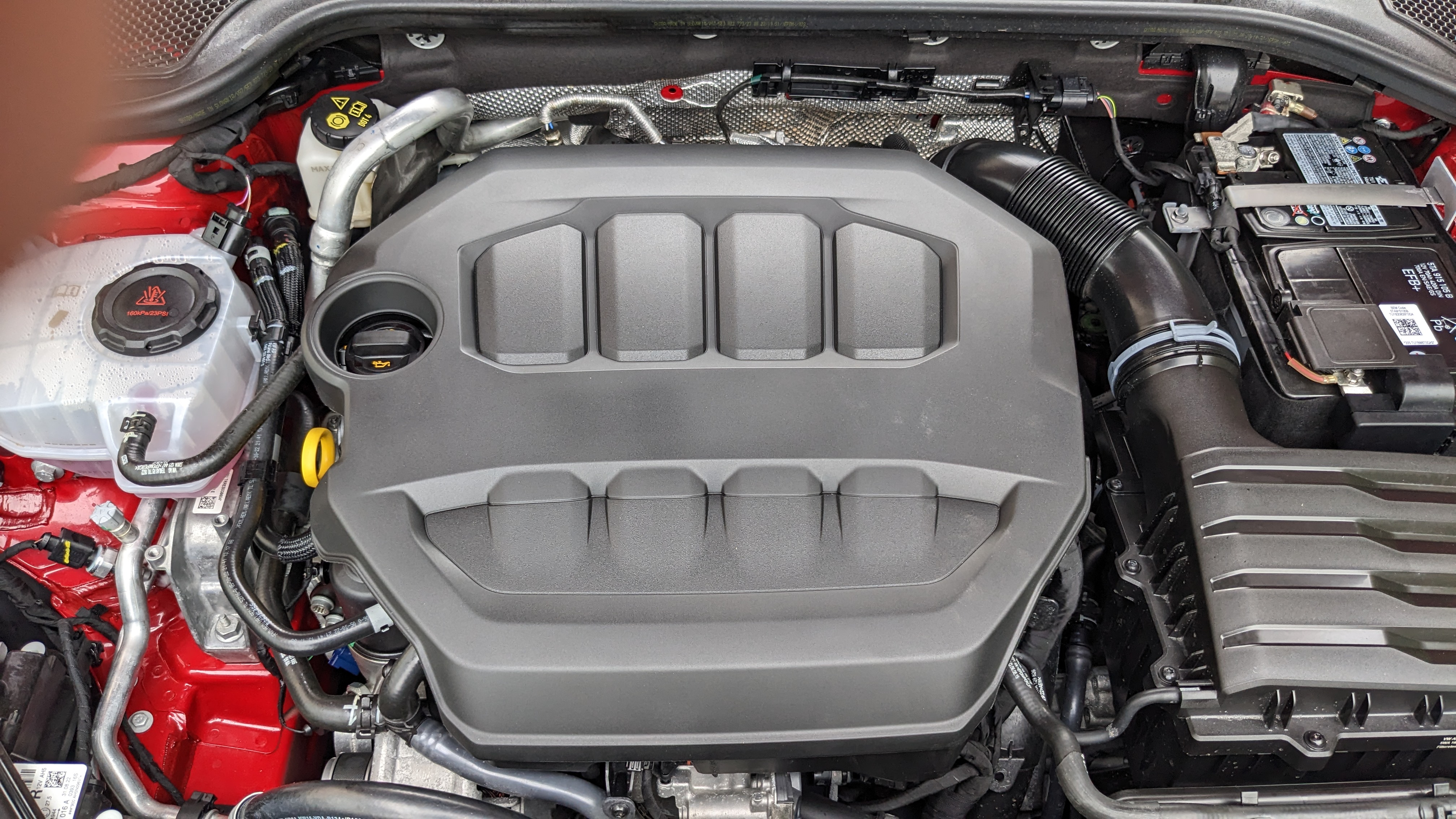

I want to keep it in a budget, wanna put cash on the downpipe after ECU remap, so I bought a used 06k103925dd/de/df part from a VW Passat B8 2.0 TSI. After checking @bigreddognz photos (Thanks a lot for the top notch quality!) the part should work, locking points are in the same position.
After the exhaustive photo comparison, just two remarks from EU vs NZ versions:
- Do you know why the oil fill cap is located on the exhaust camshaft position in NZ version whilst in EU is on the inlet position?
- Do you know why the turbo is located in a lower position in NZ version? I am missing the O2 sensor in the downpipe collar ... I guess it is due to different emission regulation ... but the lower position?

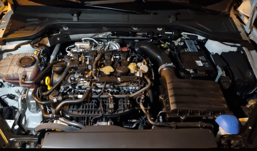

Nice catch Mario. It looks like also some other bits and pieces are positioned different.
This is EU version of the engine for comparison.

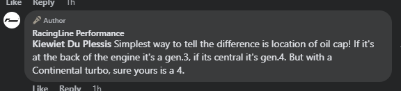

Looks like in NZ they still have the gen3 engines. Like for example in the South Africa.
Here is the comment from Racingline Performance from Facebook discussing about differences between gen3 and gen4 engines.
Then they do not have DNPA engines but DKTB … Therefore ECUs I guess they are different, not the SImos 19.6  but the 18 ... Interesting.

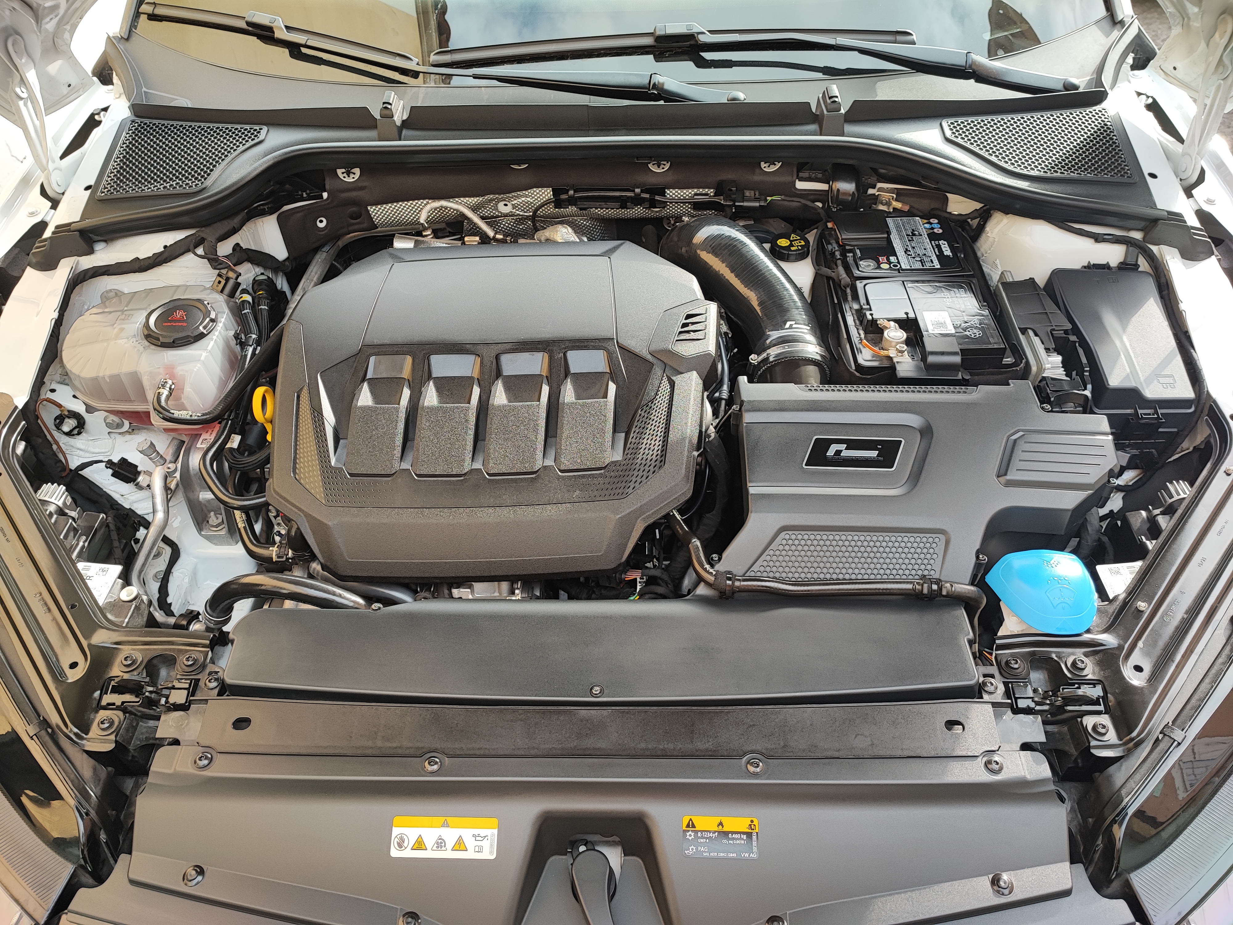

And there it is:
It fits like a glove. There is waaaay more clearance in the back side with the turbo and downpipe than with the original one. No clashes with the upper part of the engine but the engine tap is hidden any time so, If you want to put oil in, you have to remove the cover ... 4 seconds movement.
30 minutes ago, Mario_Delgado said:
And there it is:
/cdn-cgi/mirage/64980a09945e107f0bdf21b0c1c8460c1e85e844458fcfe9461ae2fc0480b0f6/1280/https://www.briskoda.net/forums/uploads/monthly_2023_02/1677165041623.thumb.jpg.a3c8a599848b89f330351a83baa7d63e.jpg
Looks good. How much did that cost you?
70 EUR with 20 EUR express shipment. Part just 50 EUR.

6 hours ago, Mario_Delgado said:
And there it is:
/cdn-cgi/mirage/cb421ab56d49fc04a6d2fbf879208cc19ddd9d51c205cc494b6b8fa6c0c7be3b/1280/https://www.briskoda.net/forums/uploads/monthly_2023_02/1677165041623.thumb.jpg.a3c8a599848b89f330351a83baa7d63e.jpg
Looks a lot better with the engine cover, don't see why we should have to buy one though...
14 hours ago, Mario_Delgado said:
And there it is:
You also seem to have a non-stock air-filter-box cover. Was it part of the same 70 Eur deal?
That's it, Racingline air intake with pleated cotton filter + turbo inlet.
The cover was bought online to a spare parts company in Holland. It came in a very mint condition, more than happy with my purchase. Now that it's known that it works (With its assumptions, btw), you could go to check the availability of the part to any of the VW replacement parts shop if you want to roll with a cover on. Online I see it's available here, more expensive though: https://www.oemvwshop.com/06k103925df-cover-p2291869/
Funny thing is that online that the part is already listed as compatible with Octavia mk4 (NN 2020 -) but the DNPA code is not in the engine spec table … so I assume that the fact of having the oil tap covered means not compatible part. I did a brief check and all engine codes from the table have the oil tap on the exhaust camshaft side.
