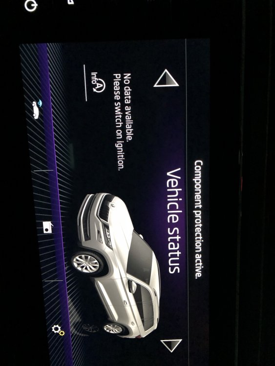

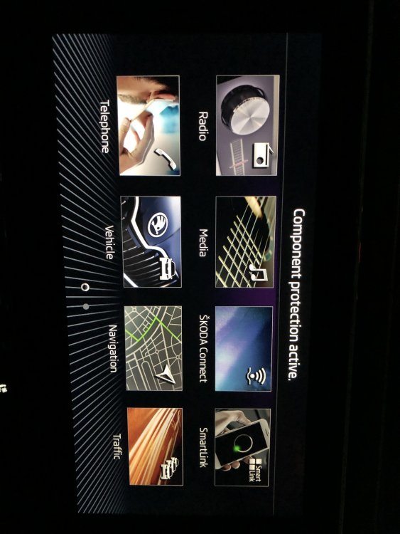

Columbus 565035021E CP remove and Coding
This Columbus host was originally used on Kodiaq, and now it has been installed on MQB Superb. How to remove the component protection? It is also necessary to change the Kodiaq model on the screen to Superb display, or modify it in VCDS to the code combination displayed by Superb model How much, and the screen shows that the right-hand driving position is changed to the left.

Component protection can only be done using main dealer software with a license.
there is no getting round that.

Do I need a dealer to remove component protection?
A dealer can do it yes. Based on the quoted writing im assuming youre not in the UK, let alone Europe? I offer it in the UK

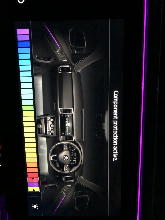

Regarding driving position, what do you mean? where is it you are seeing the driving position on the display?
Maybe I didn't understand what you meant, I already own the VAS5054 and can link it with my skoda superb normally.
Regarding the driving position, it is in the menu Vehicle---Setting---Background Lighting
