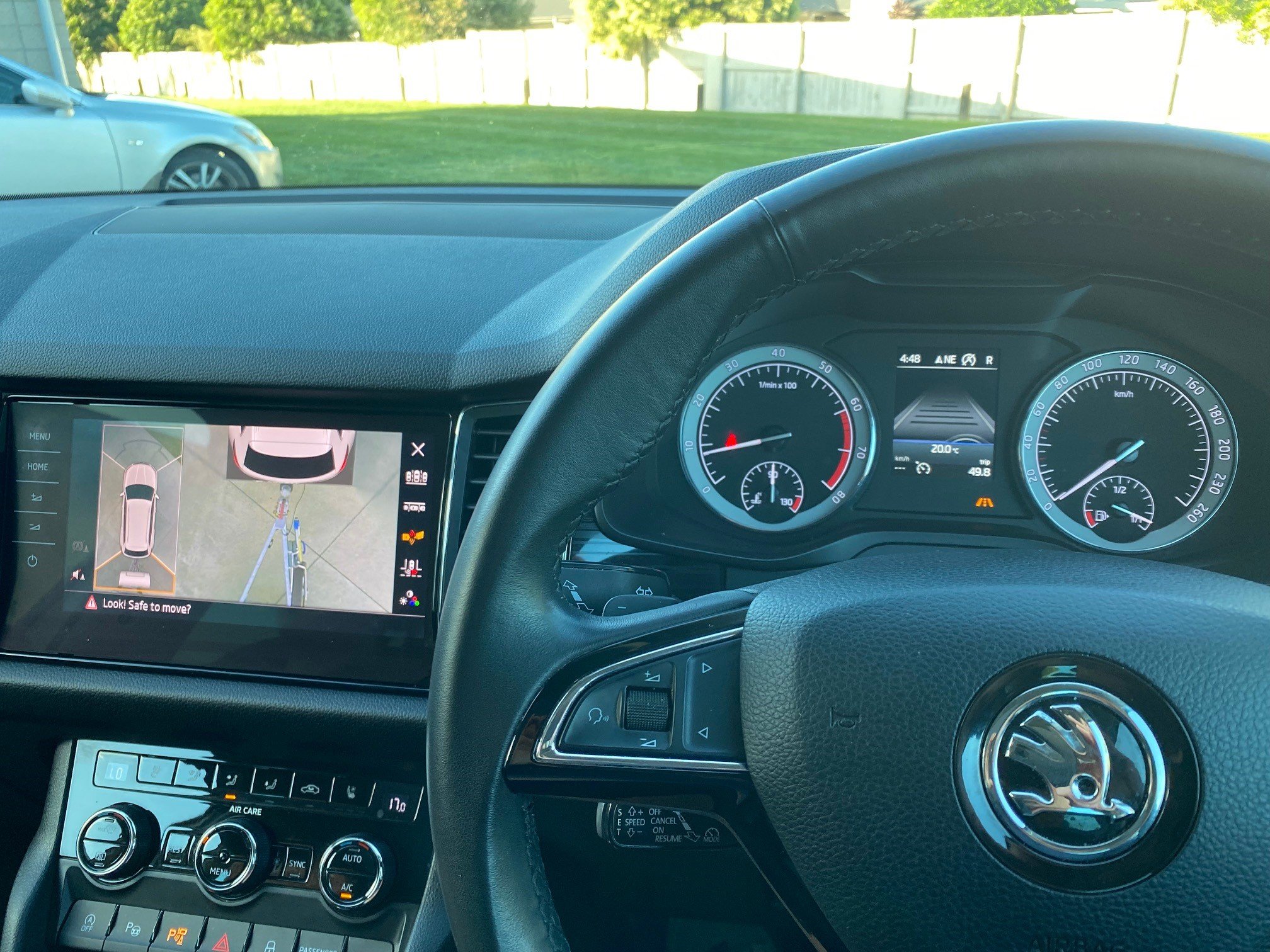

No joystick control presented when Trailer Assist selected
I purchased a 2017 Kodiaq which came with an aftermarket tow bar and wiring loom. After learning of all of the Trailer Assist features I asked my dealer to install the factory loom. The car came with Trailer Prep and Park Assist, Multi function camera.
The dealer installed the loom and coded trailer assist but were not able to see the mirror joystick controls displaying in the instrument cluster when Trailer Assist was selected. It was thought that this might be due to not having a trailer connected
I tested with my trailer connected but had the same result. The car detects the trailer but won't present the mirror controls when Trailer Assist is selected. Any advise much appreciated.

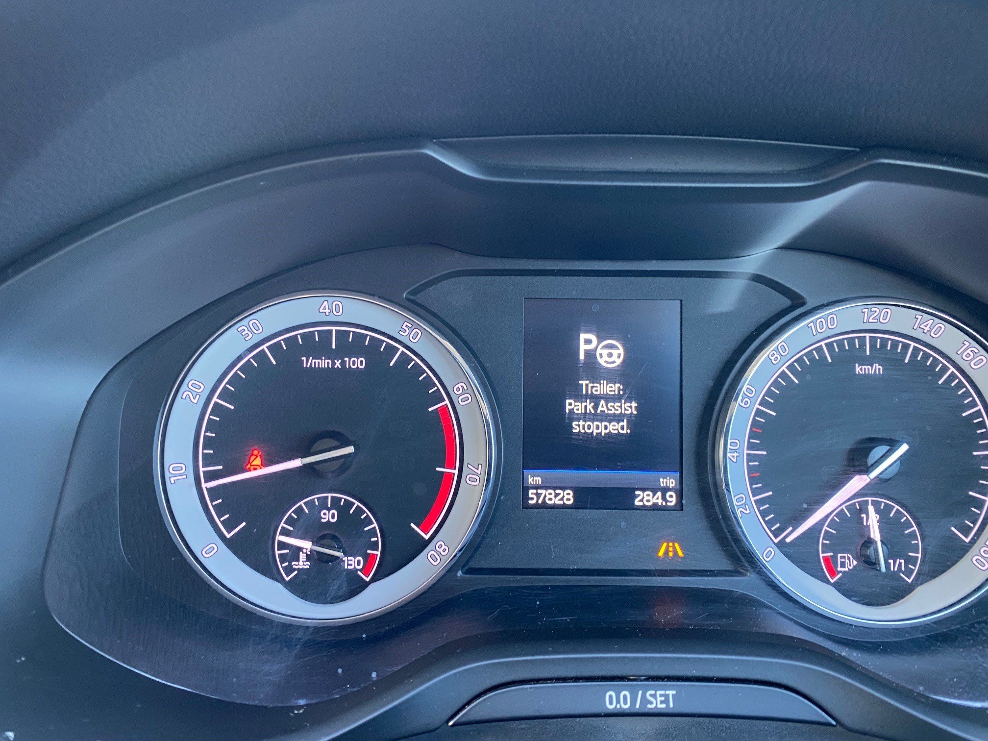

When I press the Park Assist with the trailer connected, I get the message "Trailer Park Assist stopped" appearing in the console. At no point am I presented with the message as per the above link "Trailer Assistant: to start, press the Park button!"

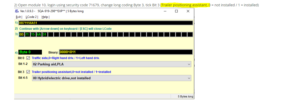

I wonder if they missed this step
I have just found out that the dealer did not do all of the coding as per the Skoda Superb  Guide, citing not being able to from their programming / diagnostic equipment.
Which means it's time for me to get coding.
