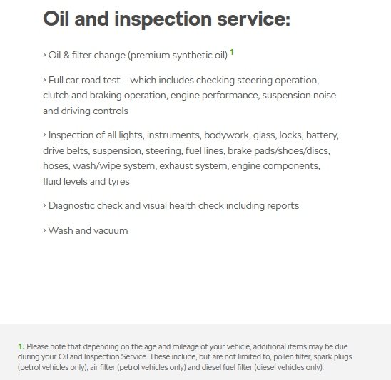

A Service Plan needs looked at to see if it is just Oil & Inspection Services and then Extended Scope because that is not to Manufacturers Recommendations.

Air Filter, Spark Plugs are extras, AC is extra.                So you need to look at what you want doing and when and what is or is not included.

The price of the Air & Pollen filters certainly allow a nice profit considering you are paying for a Oil & Inspection Service and maybe Extended Scope.
If they were actually 'Inspecting' an Air Filter it takes no extra time taking out the old one and putting in the new one.

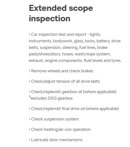

Air and pollen filters are included in the service plan at the 'extended scope' service, had mine done last week.

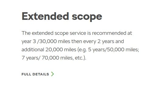

  What servicing was previously done pre Extended scope and oil and inspection service?  Extended Scope comes up every 3 years.   So would pollen and air filter get changed on all 3 year old petrol cars if the had a service plan?   That is not to Skoda / VW recommendations or schedule.    The pollen filter is due at 2 years.  The air filter would be at the 2nd Extended Scope so at 6 years, maybe 60,000 miles.

Extended Scope comes up every 3 years.   So would pollen and air filter get changed on all 3 year old petrol cars if the had a service plan?   That is not to Skoda / VW recommendations or schedule.    The pollen filter is due at 2 years.  The air filter would be at the 2nd Extended Scope so at 6 years, maybe 60,000 miles.  Looks like the service plan gives you more than the service schedule requires and I guess they've done the extended scope service with the filters early as this is included. I'm not complaining as I feel the car has been serviced appropriately for the use it's had.
