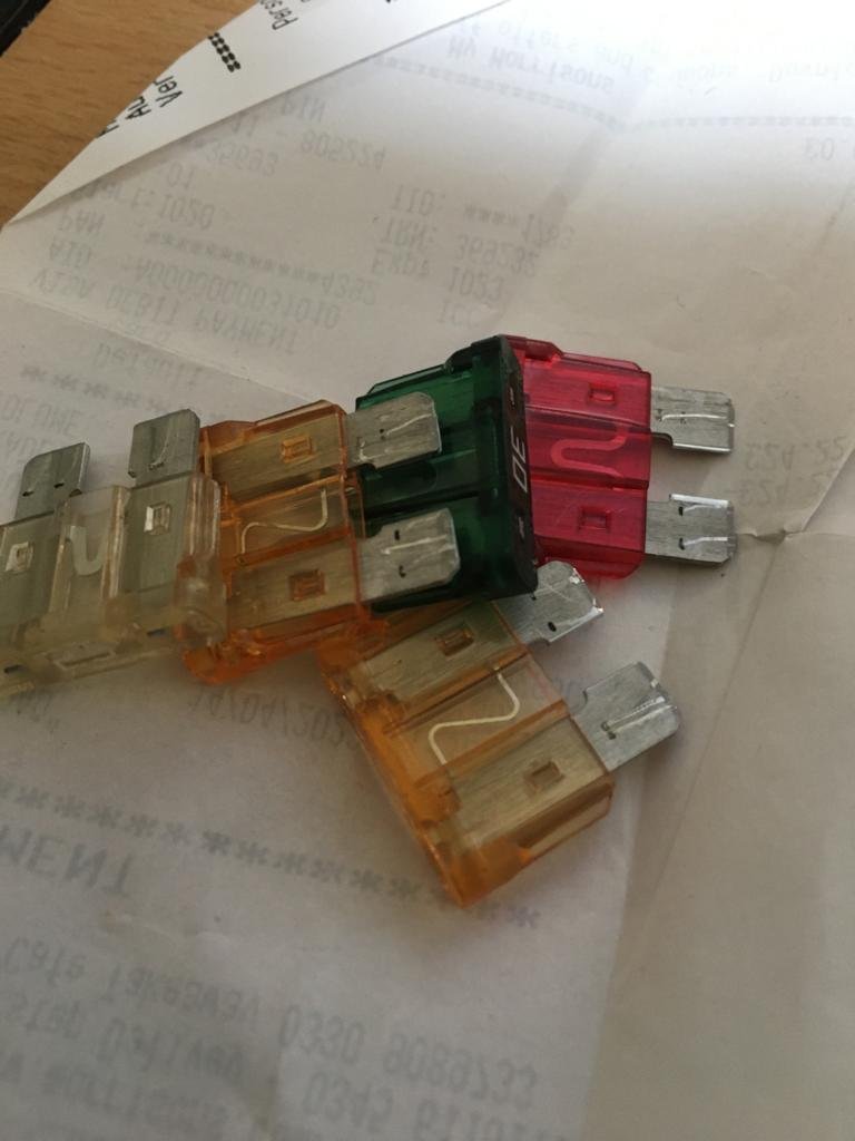

ABS light probably from messing with its strip fuse, most other codes probably from disconnecting and reconnecting things. Clear all and see what, if anything returns.
A/C codes probably recirculation flap problem (standard on most Fabias of this age, largely irrelevant unless stuck shut), and low refrigerant causing G65 one.
Edited by Pete_Ex-Wino
Rogue apostrophe autoincorrected
Thanks Pete , Mechanic did clear all code it came back , I shall check all strip fuses again I had tested  5 normal car fuses with multimeter which were next to strip fuses in closed box (  right side 5 wires box)  all looked OK , I think working electronics of car I  should disconnect both terminals of battery not just one .

Dear Pete, Another update changed  number 4 fragile fuse  , ABS sensor light gone , just engine light on , I think all fuses must eb chnaged at least 2-3 years once they just cost few pennies,   I will get  thermostat change  and update the behaviour, my courier had also reached  dartford hope to get all parts by Monday.
I am driving 4-5 miles with full cold air and engine bonnet open and car is running smooth does not it is heating , hope it is fine please.
Much apprecaited your support and time.
