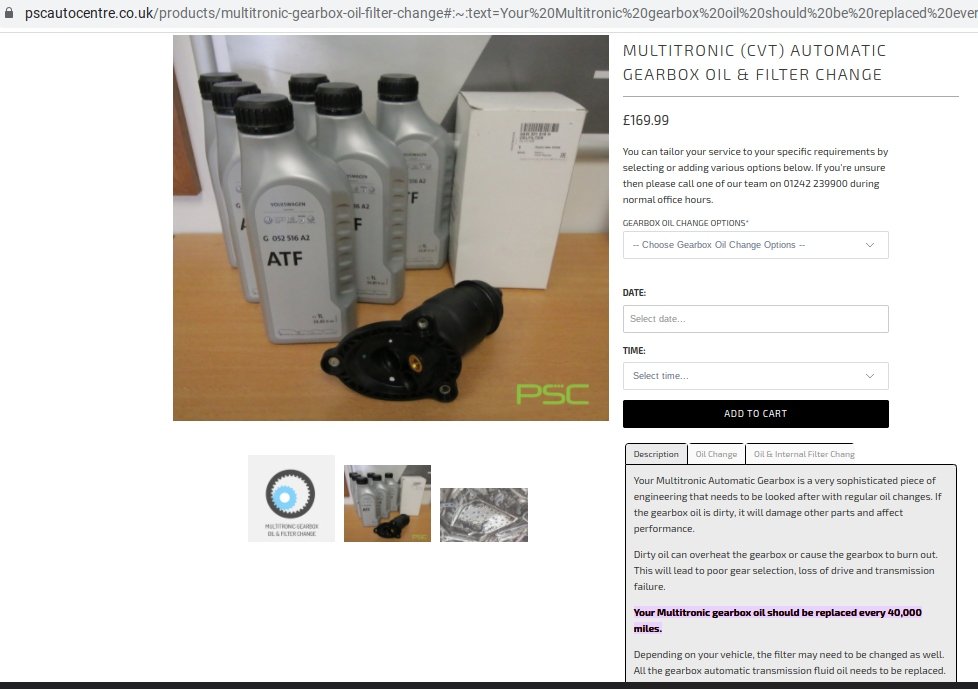

@Trilogy2kWhere are you in the world?
In the UK the Audi Multitronic CVT oil changes are at 40,000 miles and in some other world regions @ 38,000 miles.
6 / 7 speed wet clutch DSG oil changes are at 40,000 miles unless a vehicle with a DQ381 that is at 80,000 miles.
