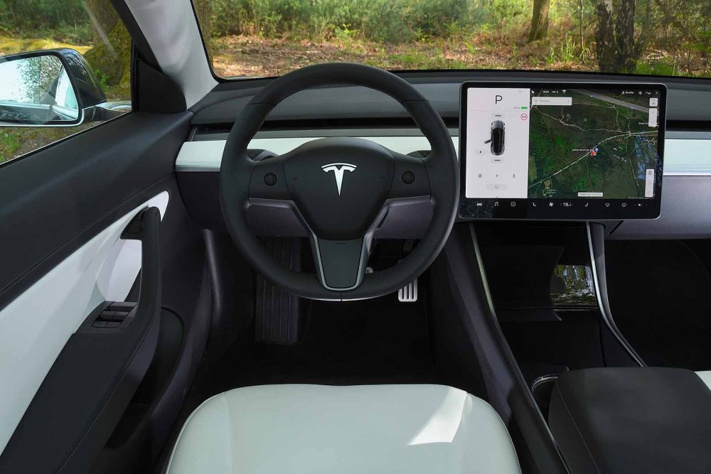

  1. But? Why not? A custom ECU application would be the foundation of advanced mods. Let it be turbo or supercharger application or custom dashboards. You name it. There are advanced tools like 3D printers now to build the dream dashboards.

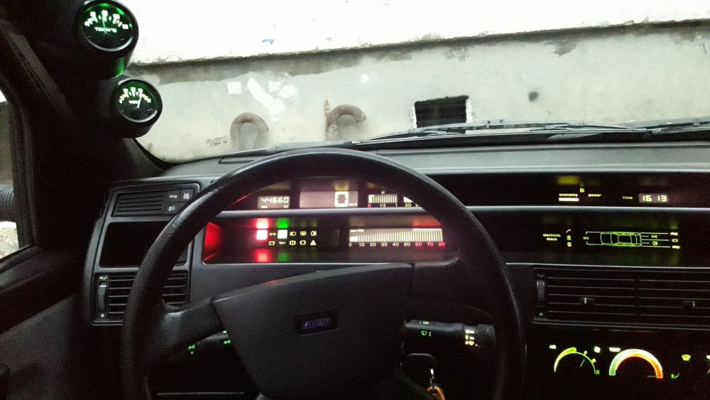

  2. Some of them are over the top for my liking but great collection. Those were futuristic designs of that era. That future came as this:
