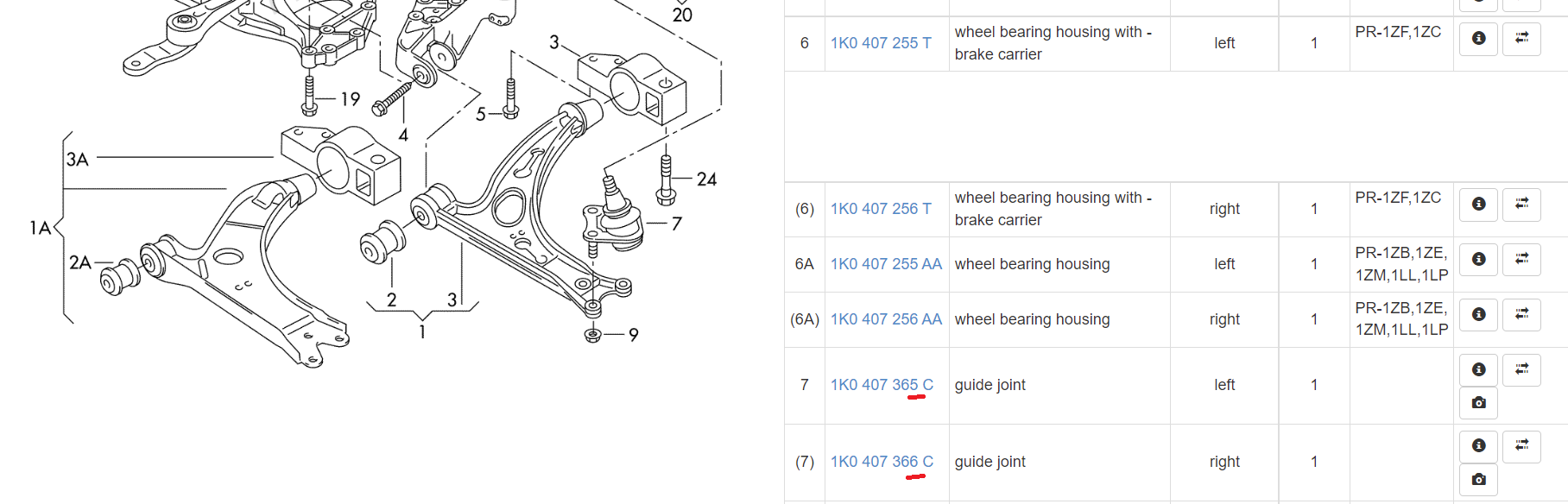

I'm guessing you mean the outer CV joint?
Same part number both sides, see here drive shaft; for 6 speed manual gearbox; D - 20.11... - Octavia(OCT) [EUROPA 2010 year] (7zap.com)
Or maybe you mean the ball joint connecting wishbone to bearing carrier?
Those are handed, item 7's here wishbone; wheel bearing housing; anti-roll bar - Octavia(OCT) [EUROPA 2010 year] (7zap.com)
What Moog part number do you have?

6 minutes ago, Nexus21 said:
I’m hoping they weren’t sided
Still not 100% sure which ball joint you are referring to, is it the item 7 here? In which case they are handed, as can be seen by the different part numbers for left and right:
Thank you yes I have seen that after more investigation.
Its 1 k0 407 366 c,just 1 number different than the left hand one.
