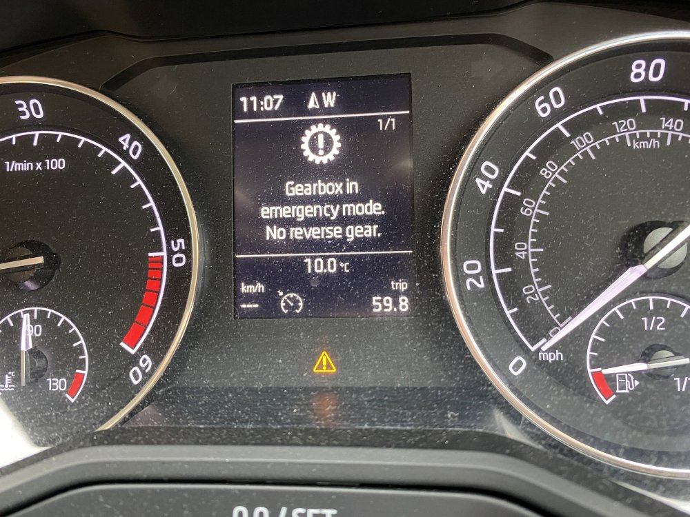

Hello to all friends from the forum.  I will tell you about my superb adventure which ended with a ride on a tow truck.
My car is 2016 Skoda superb 2.0tdi 150hp dsg6 (dq250) actual millage 52k miles.

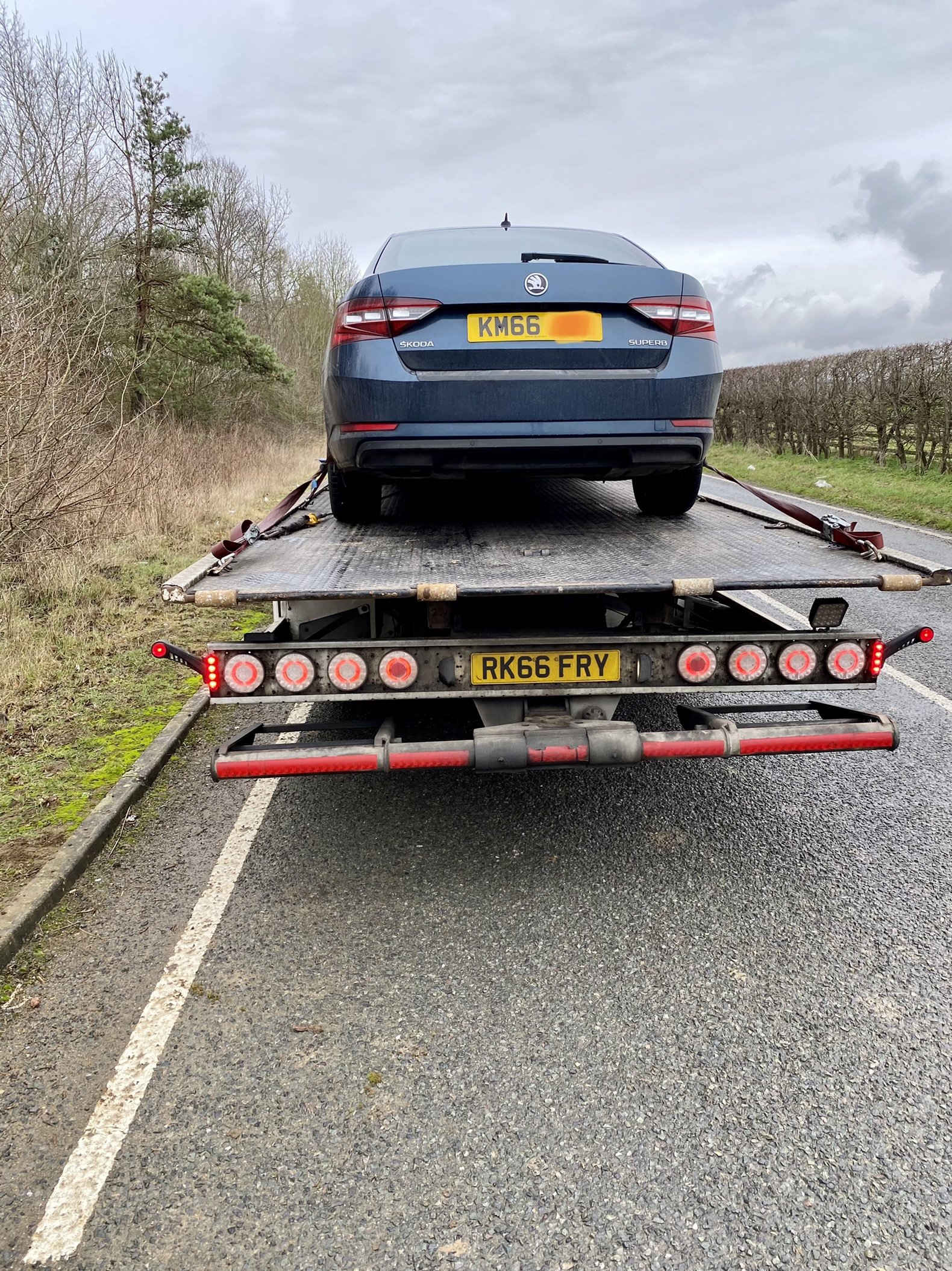

While driving on the highway, the car lost all gears and on the computer screen I had information about the gearbox failure.  I had to call a tow truck and the car went to the skoda service.
I'm lucky in the whole situation that I was persuaded in Skoda Northampton to take the Skoda all-in plan, so the whole thing was fixed at no cost to me.
The first diagnosis of the service is a mechatronics failure.  A new mechatronics was ordered and it turned out that, unfortunately, it did not help.  The car still did not run.  I waited for the decisions of the Skoda headquarters to approve the replacement of the DSG box with a new one.  The whole thing took 5 weeks before I got my car back, but the skoda service replaced my dsg gearboxes with a brand new one at no cost + they paid for a replacement car which i used for 5 weeks.
