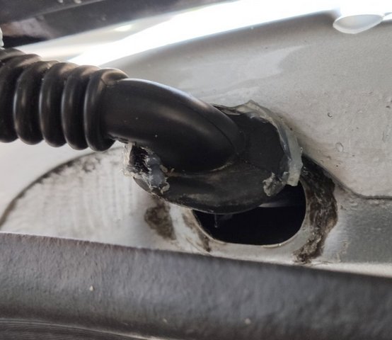

This is a photo before the modification from the mechanic, i had some silicone for aquarium on trying to reinforce the waterproofing.
Later some extra cables must pass so i removed the grommet and the mechanic made things much better than me (proper materials as glues for plastic,windshield glue etc).

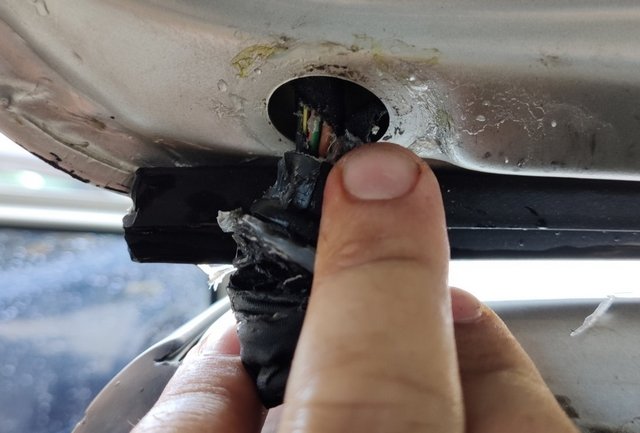

Here is the mechanic's fingers removing my ''work'', as you can see after some months a cut show-up so i had to go to a professional to fix it permanently.

The remains of the old (original) are visible.
I was confused by these remains:
