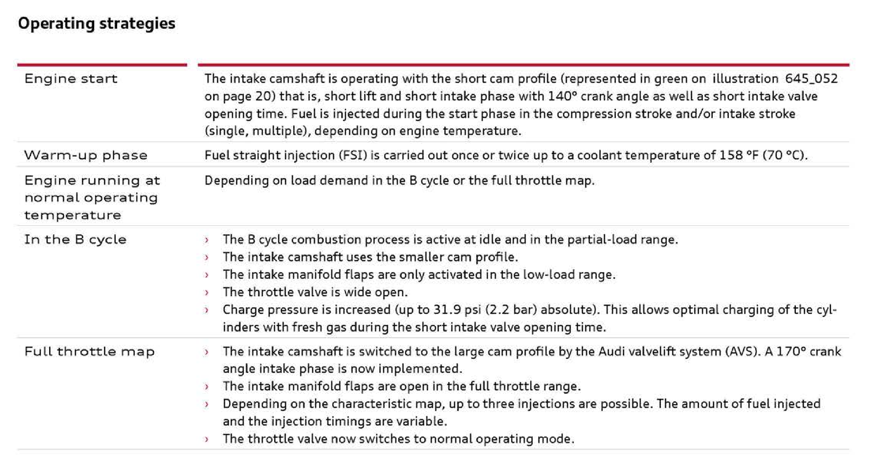

There are probably several factors, @Pessimal

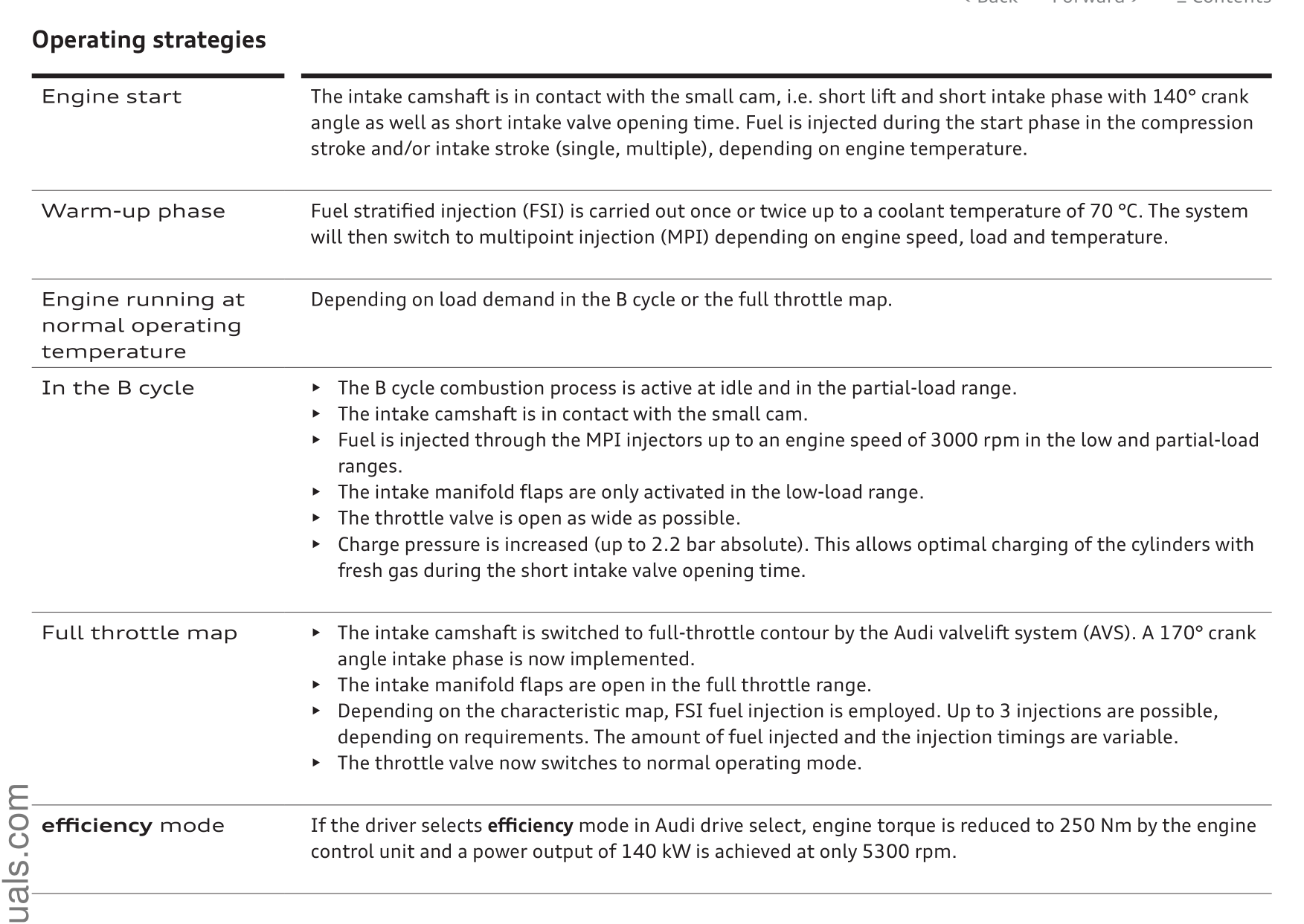

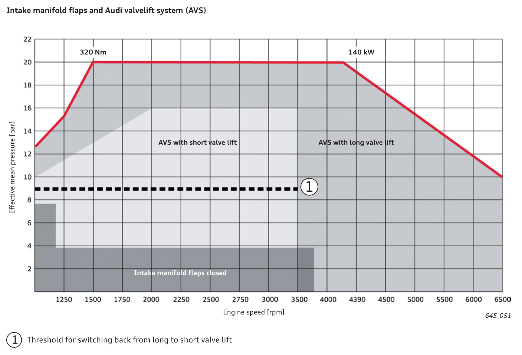

Firstly, it's a different engine. The Gen3 vRS engine (and I think the 220 is the same) has VVT on the exhaust valves.
The Gen3B engine in my car has VVT on the inlet valves. They close early before the piston is at BDC.
I'd like to give you a full explanation of why this is a good thing, but to be completely honest, I don't fully understand why it improves fuel economy, but apparently it does.
The early valve closing is on low throttle/low load demand. When there is driver demand for more fuel/power, the inlet valve timing changes to the power mode.
The images below are from the VAG eSelf Study Program 920163
Secondly, I consciously drive economically most of the time. Despite this, when the engine is cold and on short runs in stop/start traffic, the economy isn't great, TBH. It was in the high 20's on a short trip to the shops yesterday, despite driving carefully, the traffic was too stop/start to get decent economy. But on the 7 mile drive to work in freely moving traffic, I get high 40's if I'm careful, or low 40's if I'm not being as careful. On a long run, I get low 50's without much bother or mid 50's if I'm careful and keep the speed under. I also don't drive the car hard until the oil is up to 80°C, and on the drive to work, that doesn't happen at this time of year.

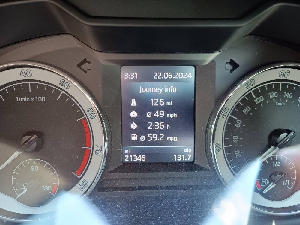

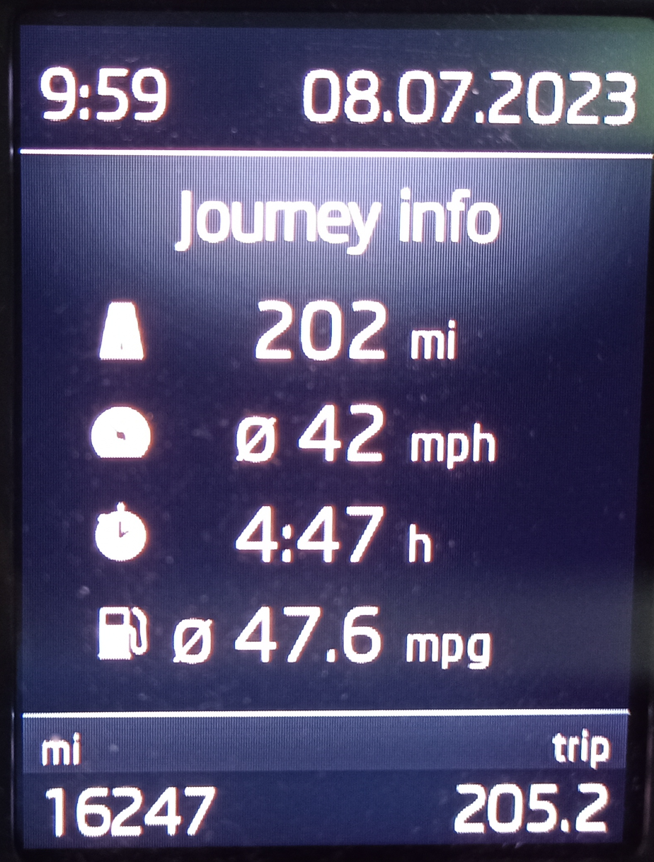

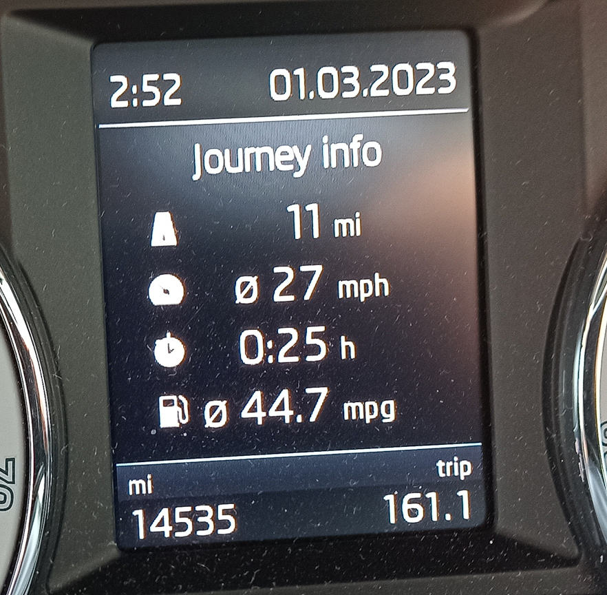

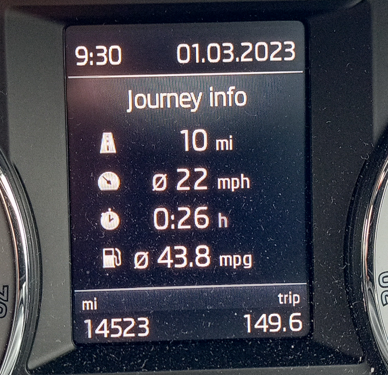

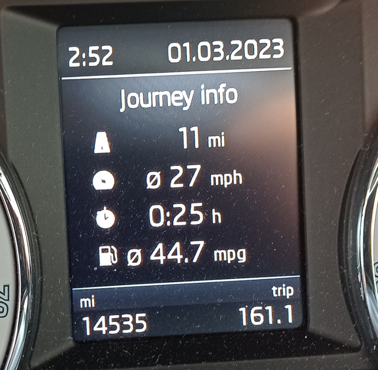

I checked my commute yesterday, and on my current route to work it's actually about a 10 mile journey, with a slightly different route coming home. (Work for the very wonderful HS2 causes delays & detours at the moment.)
Yesterday was a fairly typical journey, though I wasn't particularly careful about economy on the way home, which has a bit less traffic. The journey has 2.8 miles of motorway, but the rest is urban commuting traffic, albeit avoiding peak times.
image.png.cdc7d577512dfabeb3f8f0d6975c6e0b.pngimage.thumb.png.8eb3cd1582c11359feea5126ffd58a2d.png

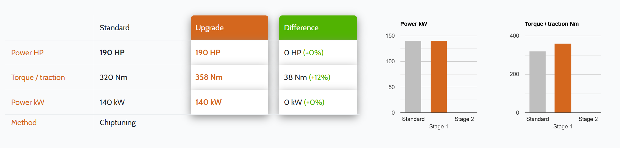

Just came across this tuner too.
https://puretuning.net/en/chiptuning-files/skoda/skoda-octavia/2-0-tsi-190hp
Unusually, their remap claims no additional power, but claims additional low-end torque.
I don't think I've ever seen a remap that claimed no additional peak power, so I suspect this is an error.
There's no "Stage 2" available at the moment when I just looked, so maybe this product isn't quite ready yet. I dunno.

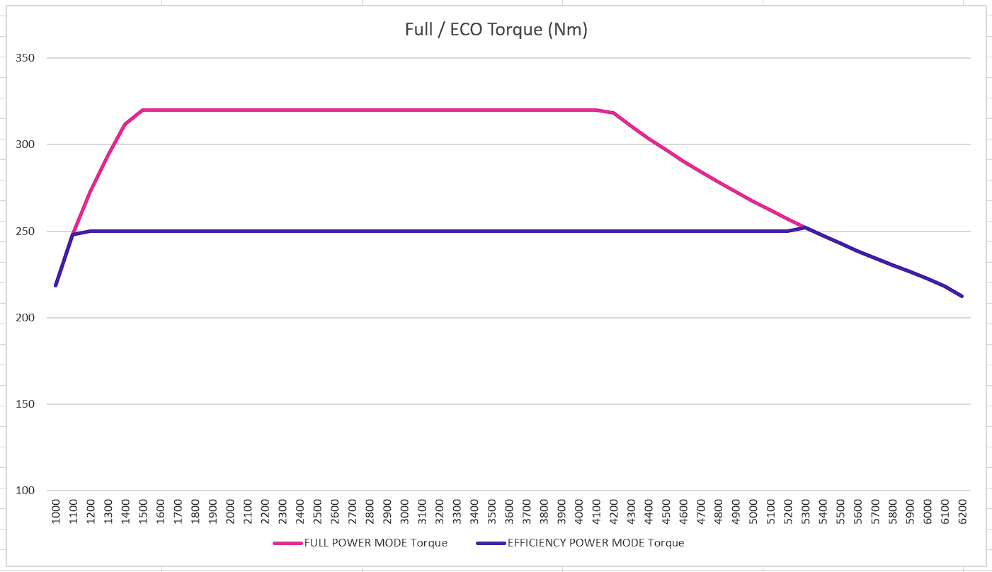

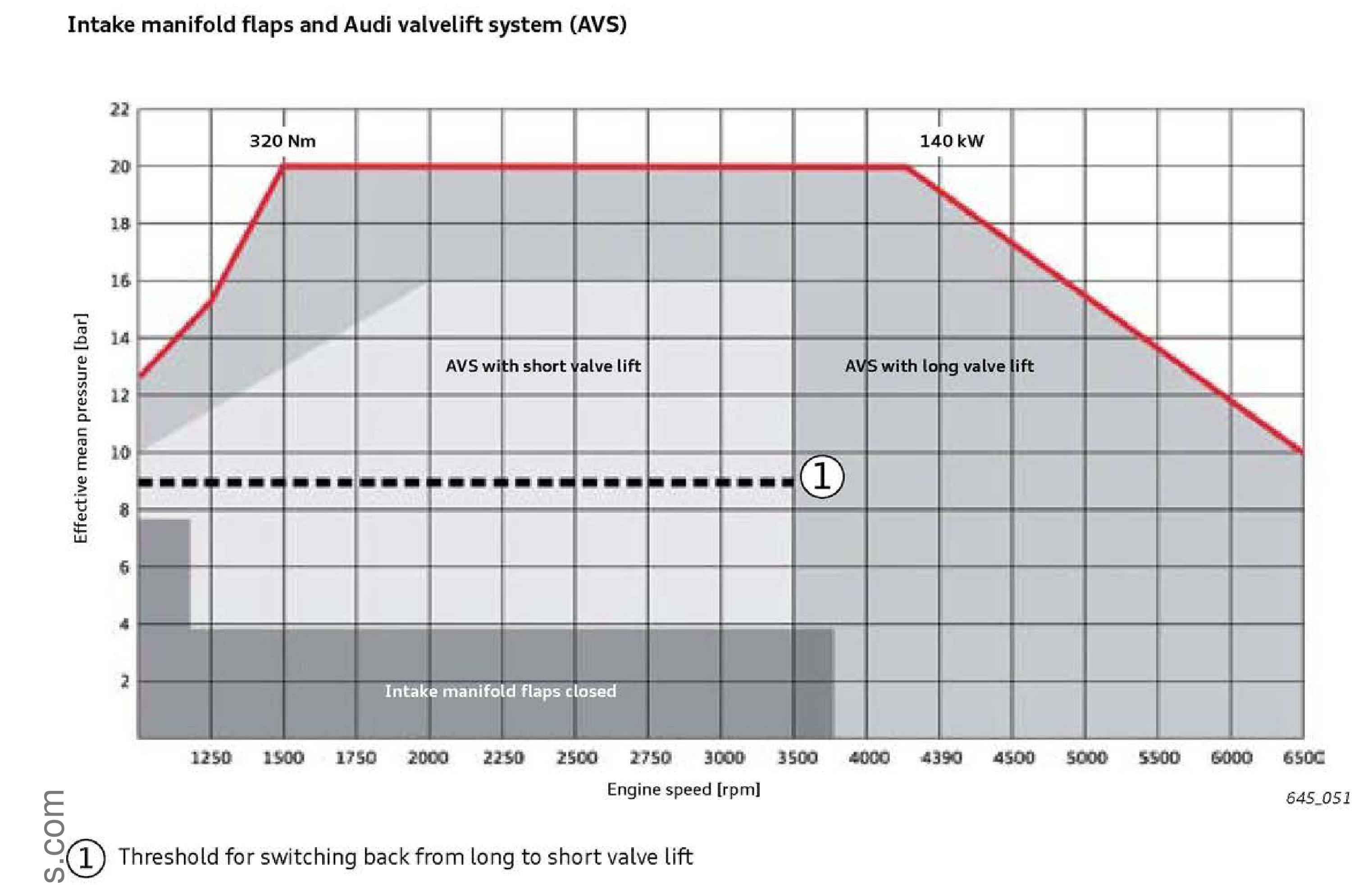

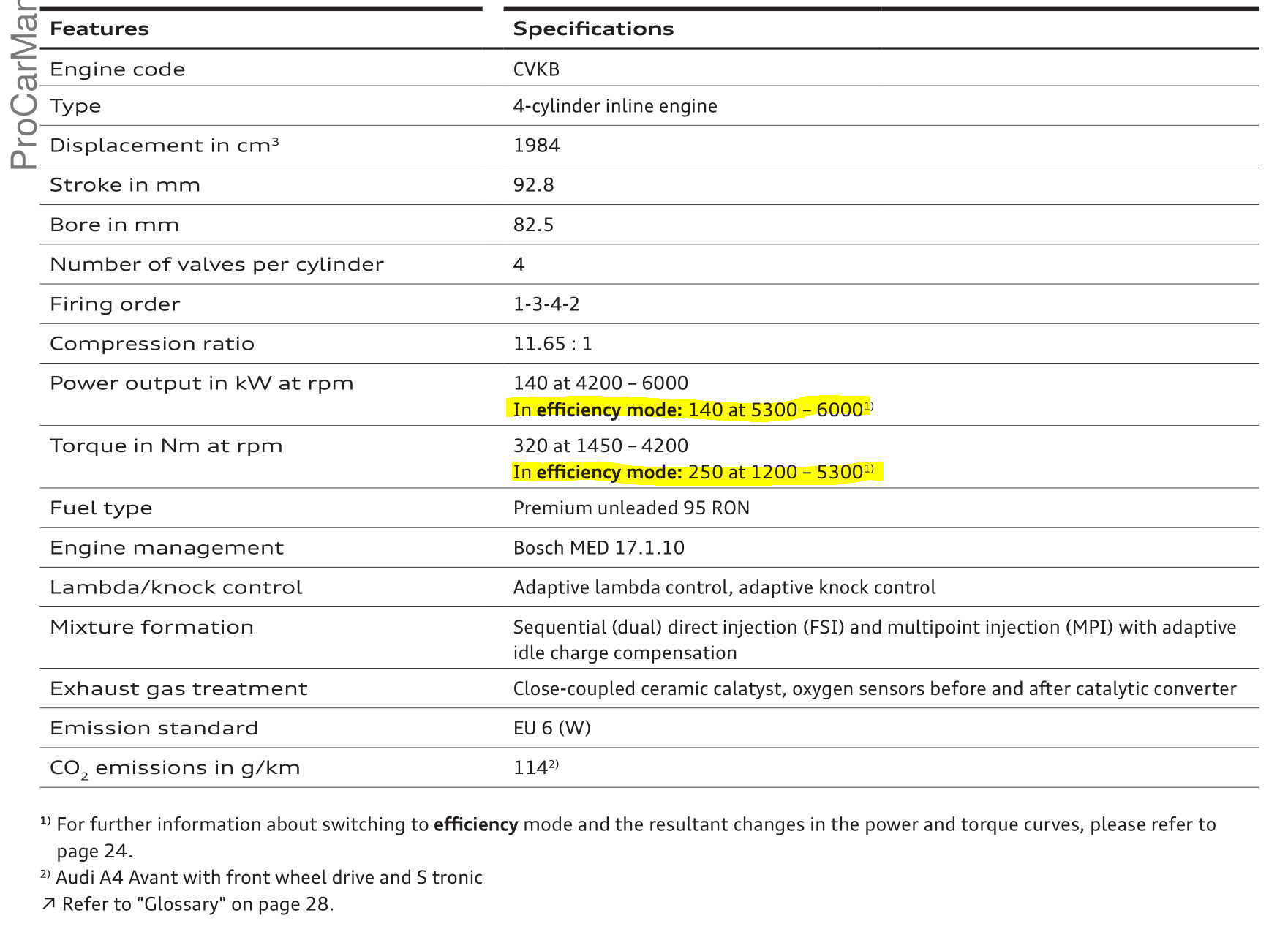

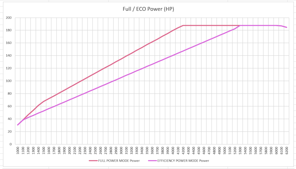

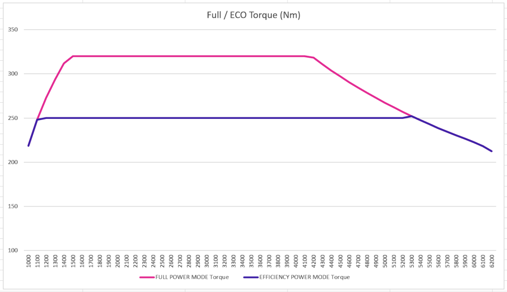

I've been doing a little studying and I thought I'd give some additional information.
The EA888 Gen3B is quite an interesting engine in that it has some very different fuelling characteristics, depending on what driving mode you're in.

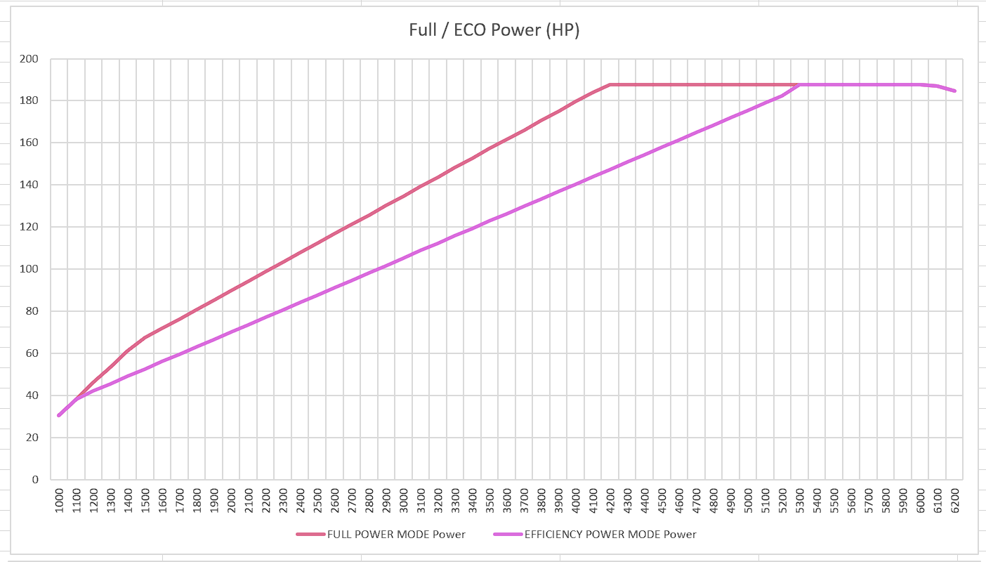

My headline finding is: ECO mode caps engine torque to 250Nm up to 5300rpm. (I think you can push past this if you absolutely floor the throttle.)
Roughly speaking, that looks like this.
That's a big old difference!
Even in standard drive mode, you use the efficient B-cycle until you get to 3500rpm.
So that's worth considering if you feel your 2.0TSI Gen3B isn't a sprightly as you would like: Are you actually inhibiting full power yourself?
(I've used red text to more easily differentiate the VAG stuff and my text in this post.)

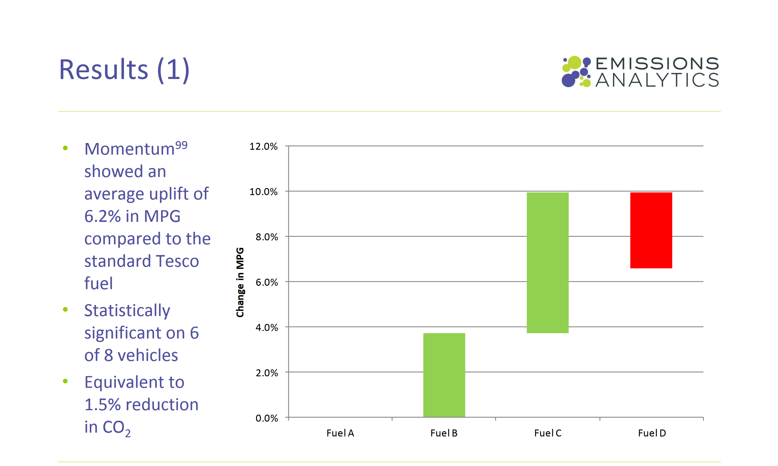

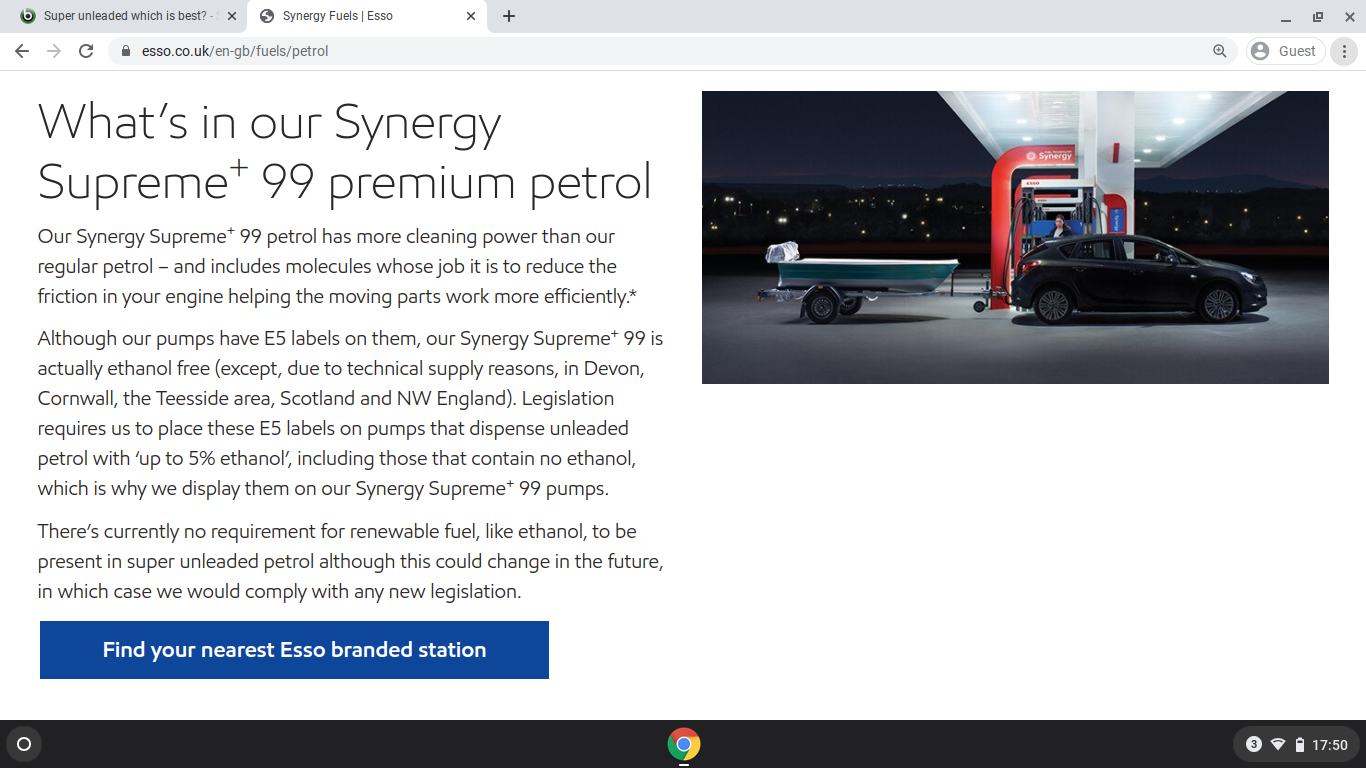

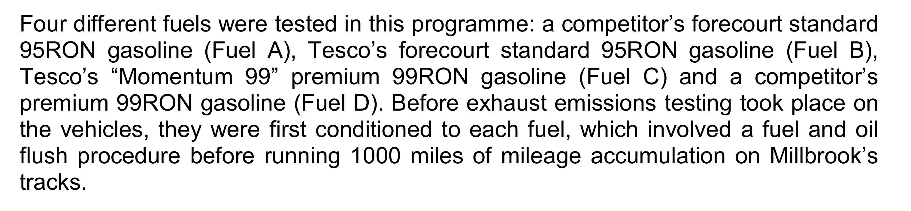

You'd think it would have been tested though, if only by some green NGO lobby group looking to ban whichever of the two emits more hydrocarbons, carbon monoxide, kryptonite gas or whatever they're worried about now. 😋
I can link you Tesco's testing they had done in 2012 with their 95 Ron and 99 and AN Others.    But it was about less emissions.  But clearly they were showing for better efficiency.      Then in the UK all E5, Super unleaded is not the same as far as formulation and location location location.   Storage ,,/ distribution reasons.
GREENERGY part owned by TESCO PLC produce and Distribute Momentum 99 & also ESSO Fuels in some parts of the UK and other fuels E5 / E10 to other independents / retail forecourts.
276235547_1384336435_Screenshot2022-01-3014_03_59.jpg.d43b66a38bf086423e31cbd1b02722b8(1).jpg.36fe5772d927b86674b025b891bf3028.jpg
388380a097b04fe693a8c27db8bb4974 (1).pdf 995.53 kB · 0 downloads 6ca06d648b9541e78fa838fece4a1a23 (1) (12).pdf 2.86 MB · 0 downloads
The results are slightly confusing to me, because it looks to me like there's a bit better than a 4% improvement in MPG switching from regular to super unleaded that can be reliably assumed.
Not sure where the 6% improvement is shown.
I realise their fuel may be better than some random competitor's, but between the two types of Tesco's own fuel, it appears to me you can count on about 4% extra MPG, in like for like driving.
Granted, I might well be misunderstanding the results.
