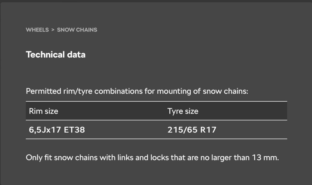

From the owners manual…
Thanks. I have read that, when I followed it up with Skoda(here in Aus) they were unable to provide anything that would fit and basically said they hadn't had to look into it before.

The recommended 17” wheel size is 6.5 x17.  ET 38  5x112 PCD and a centre bore of 57.1. Fitted with a 215x65x17 tyre and as noted chain links must be no larger than 13mm.
The part numbers for the recommended Nanuq 17” alloys are…
silver 565071497 8Z8
black 565071497D FL8

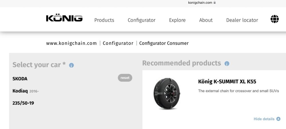

The Konig K-Summits arent legal for Buller and Hotham.  Dont get me started on the stupid regulations.
I have 255/40 R20 on a Q3.
Anyway, I cant put chains on front of my Q3 as there is no inside clearance between the suspension guard and the inside of the front tyre.  I have some old Biathlon chains for my Octavia RS (225/40 R18), but they arent legal for Buller and Hotham anymore either.
The Konig XG-12 Pro 247 will fit the rear wheels of my Q3.  You only need to fit chains to 2 of the wheels for a 4WD or the driving wheels of a 2WD.  The roads in Australia rarely have snow on them, and it is only for the last few km.  Drive slow, take it easy, put chains on the rear wheels, it isn't a race.  Kodiaq is AWD and will send drive to wheels with most traction.  Hence the rears.
