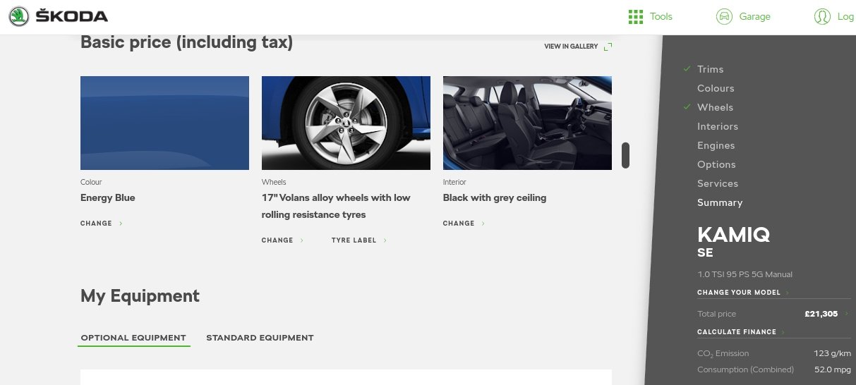

'Low rolling resistance tyres' are listed on some Skoda Models on some wheel sizes. ie Scala & Kamiq.
More often now all Skoda are on ECO tyres, SUMMER TYRES.
even when fitted to SUV's, EV's. Part or Full time 4x4's AWD's.

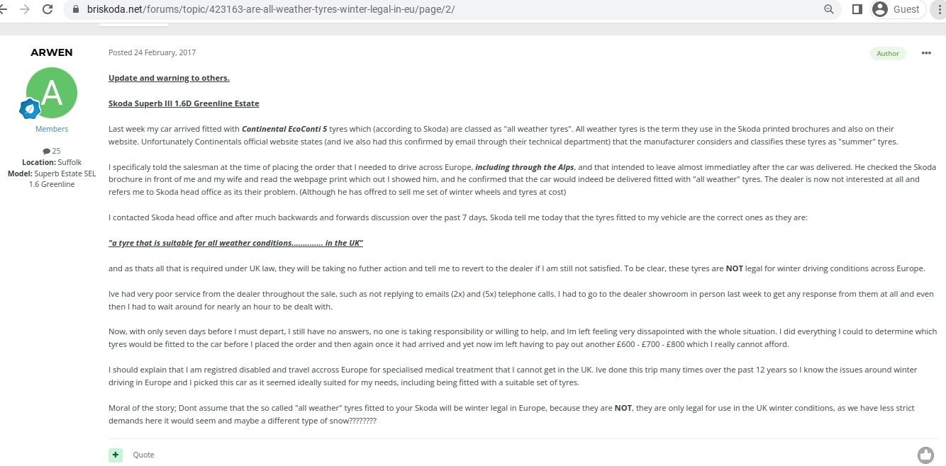

(Skoda sometimes have in a Brochure that cars have All Season Tyres, ie summer tyres, then offer 'All Seasons' as an Option, they mean 'All Weather / All Season'. eg suitable for winter.)
http://briskoda.net/forums/topic/423163-are-all-weathertyres-winter-legal-in-eu
http://briskoda.net/forums/topic/440953-factory-fit-all-season-tyres
Different when 'All Season' is used to mean 'All Weather'  which might be Summer bias & Winter Certificated. eg CrossClimates, + or 2 or whatever.
Then we have Wet Weather Tyres, All-Terrain, Winter Tyres, Studded or not, we have all sort of term used around the globe.
As to M+S Marking or 3 Peak M+S and 3PMSF then @Carlstoncan give you chapter and verse.
