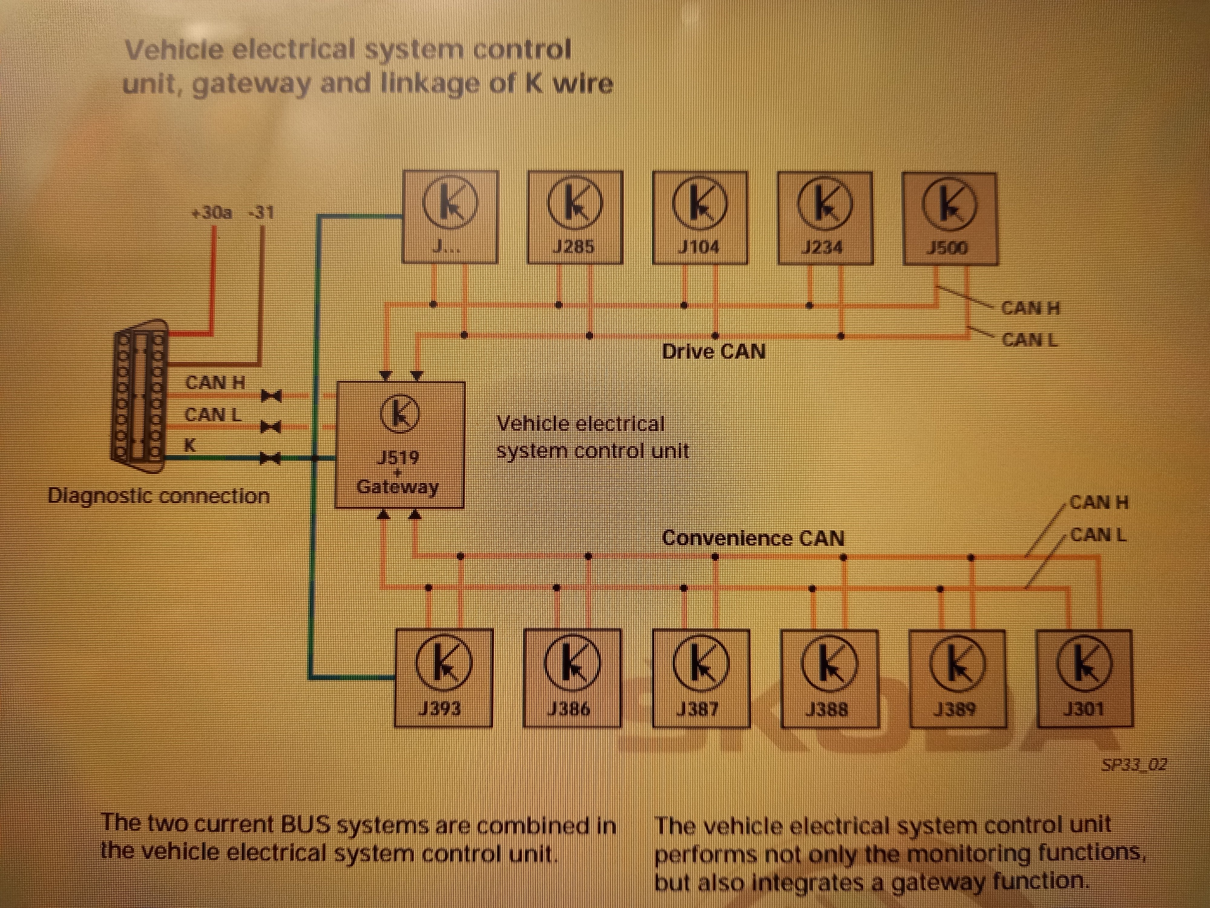

Info about rpm will come by CAN messaging from engine ECU, I expect.
With VCDS  in section 17 (Instruments) the output tests should drive the needle to prove the instrument motor is ok
  • Sponsor
Good thinking Nige.
yes i guess su it comes thru the can bus .
i dont have the ecu but i have the vcu that is after the ecu and plugs into the cluster at the output.
at the input there are no can bus wires
  • Sponsor
If you have the onboard supply control unit (vcu?) you should be able to talk to that with VCDS and do what Nige suggested.

the problem is that i dont know the rmp wire
i know its a wire because there is no other possible way for the ecu to send the signal thru the vcu
  • Sponsor
What year is the car?
As I said, rpm data gets to cluster by CAN; VCU has CAN connections to every other module that uses CAN.
  • Sponsor
J285 is cluster.
the year is 2008
And i want to use the cluster with an arduino to show ingame rev ,speed,fuel,etc
  • Sponsor
OK, so a mk2 Fabia, but same applies.
Don't think I can assist any further.
The RPM & coolant temperature are sent via the engine ECU on the CANbus drive network, the vehicle speed and fuel quantity are analogue inputs into the speedo unit however if the car has ABS then the vehicle speed is also via the CANbus via the ABS control unit
