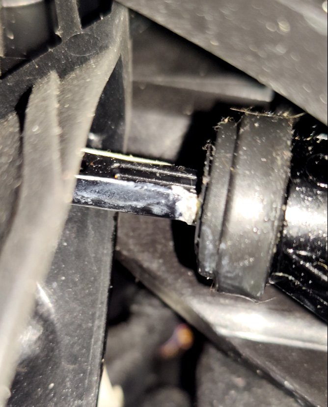

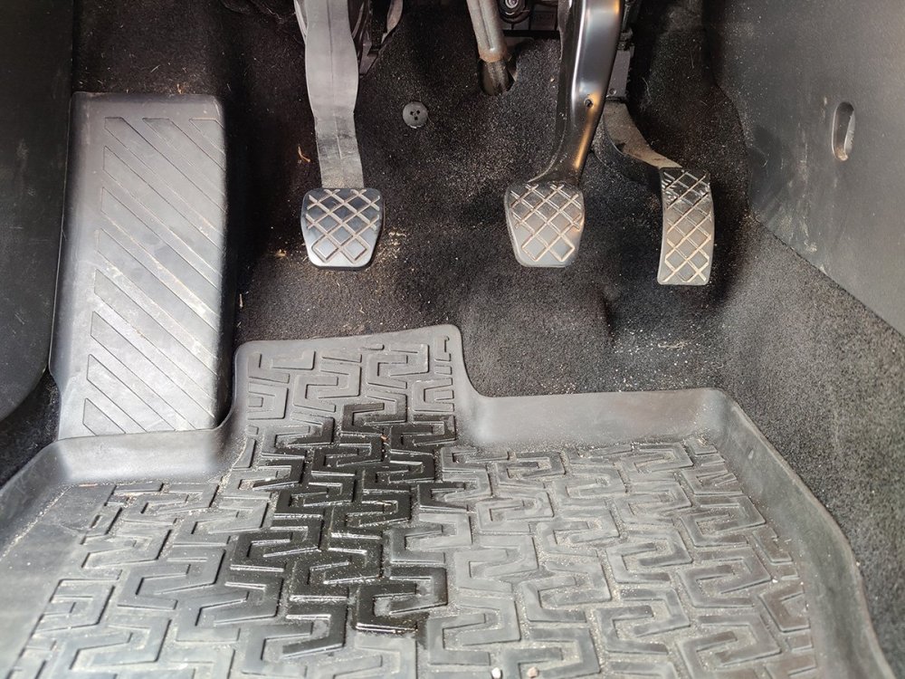

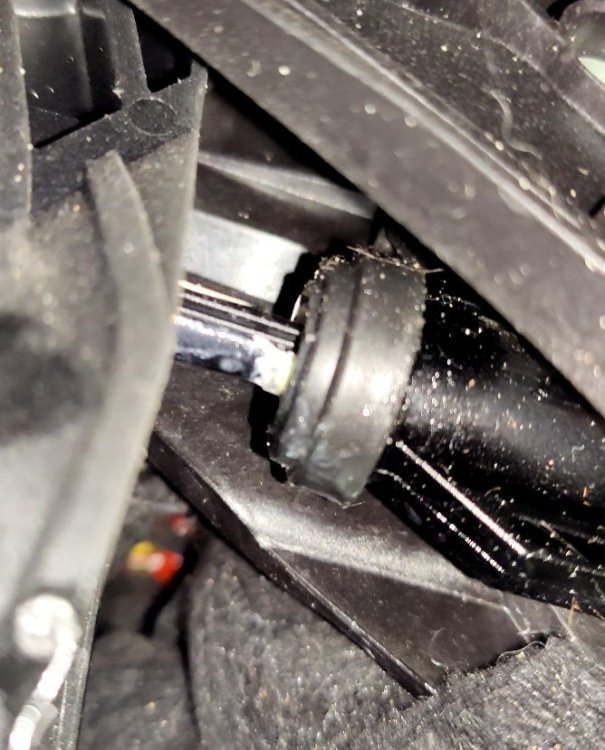

My Octavia 2016 mk 3 has recently started leaking fluid inside the cabin onto the floor.
From closer inspection, it stems from the clutch pedal. More precisely, it seems to be coming from the metal rod the pedal pushes in (please excuse the terminology - not a mechanic.)
From searching on Google and Briskoda, it appears others have previously had issues with either the clutch master/slave cylinder. Can't quite determine if it's the same issue here, so thought I'd ask the pros.
The clutch itself is "fine". It doesn't fall to the floor and seem to be as responsive as ever. I have not put in extra clutch fluid. The liquid is clear and oily - doesn't smell.
Is this something I can fix myself?
Thanks in advance for all suggestions.

Clutch master cylinder, a rare failure. That pushrod that you assume is metal is actually plastic as is the entire cylinder assembly with the exception of an internal magnet to activate the reed switch.
About £118 retail from Skoda/TPS, as low as €18 delivered on the internet for a pattern part.
A tricky job first time round especially fitting the rigid pipe into the cylinder, make sure the pipe seal did not detach and remain in the old cylinder and that it fits back on the pipe end with a forced "click" do not put it in the new cylinder & then fit the pipe, it will not seal.
In fact given that the cylinders dont wear and leak that pipe seal may well be where your leaking fluid is coming from, has any work been done before in that area?
