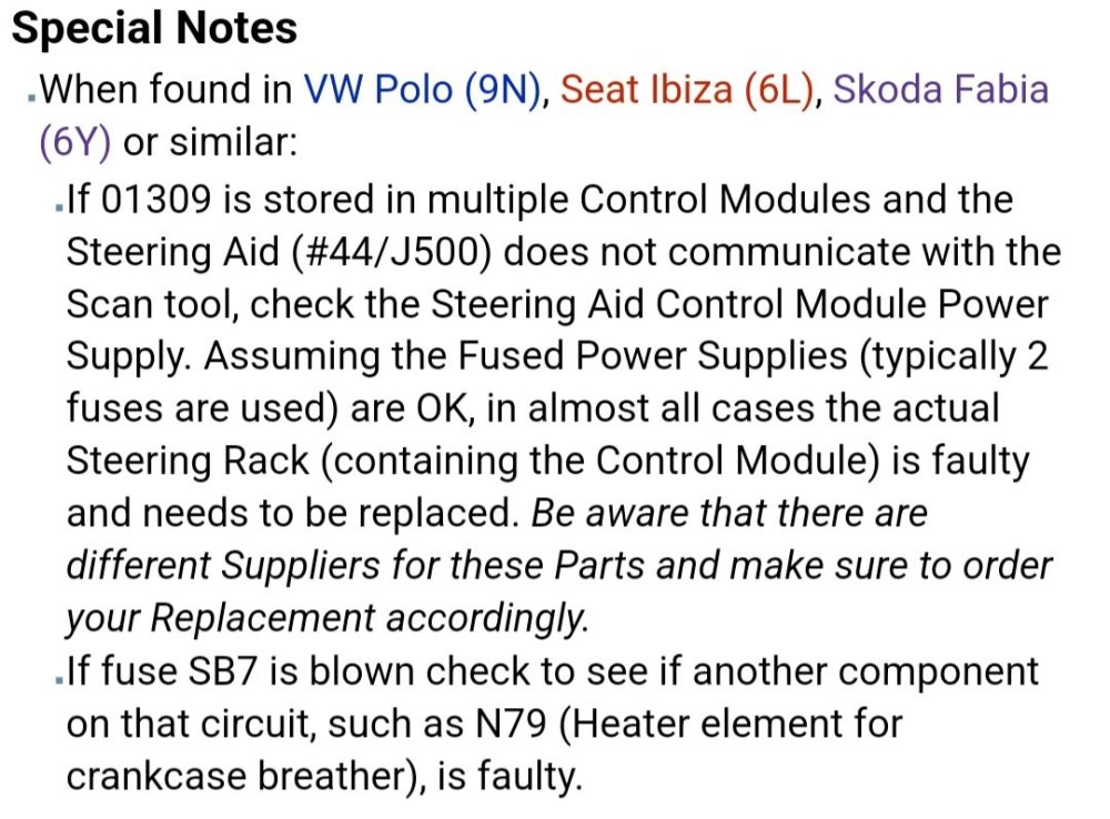

@ScottB832I don't know if you got to the end of the steering issues? I sorted mine out today! After much umming and urring I ordered a rack, ripped the old one out on my driveway and found this. Fitted new one put some spacers in the dog bone mount to give it clearance and tested it. I've never felt fabia power steering but it's nicer than my 22 plate Vito so I'm over the moon.
I bought the new one as a service exchange for £150 on eBay! 3 years and 60k mile warranty.
Hope this helps you out mate, if you haven't already sorted the steering in your car 😉

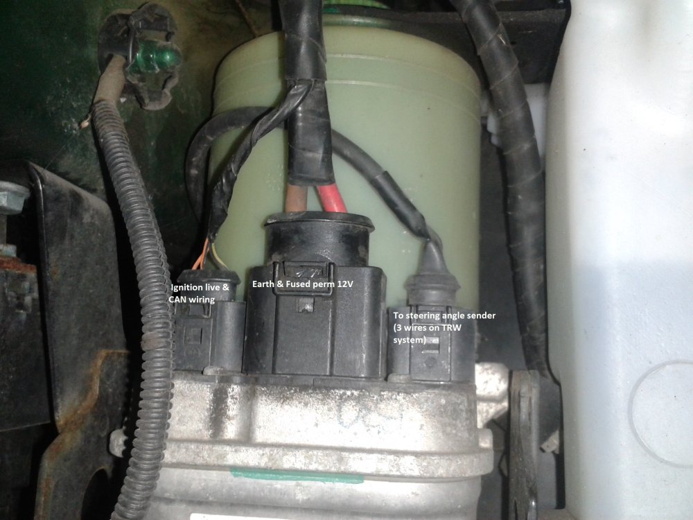

    It's very simple, the PAS pump uses a massive amount of current, around 60A peak, if the alternator or the battery are not in tip-top condition then the reference voltage will quickly sag under this l
  • Breezy_Pete
    Breezy_Pete
    That sounds really very unlikely.   The PAS system is pretty self-contained. Angle rate sensor plugs straight into PAS module; permanent power wiring; an ignition-on wire and a pair of CAN d
