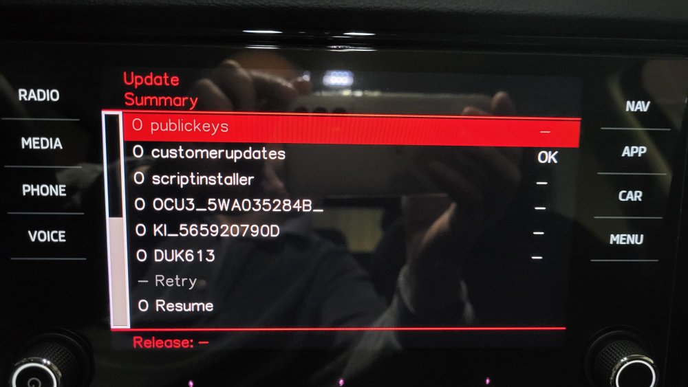

So, basically the update has finished, but not fully as it seems.
The infotainment now shows below pic and I don't know how to proceed.
Should I press the item which reads "Resume"?
@MichiF The video doesn't show whole process, I can only assume you need to press "Resume" as you already think.
I took the challenge and all went fine. After using the Resume option the MIB3 restarted and is running as expected.
Right after this restart, I was offered a second update which also installed w/o any issues.
Thanks!

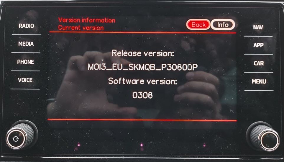

Hi,
Please accept my apologies. I gave you the wrong information earlier. It is actually MOI_EU_SKMQB_P30800P software version 0308 I have. I was looking at the wrong details from another car. Would you be able to send me a link to download 0320?
Kind regards
Dave
1 minute ago, djwwautodiagnostics said:
Hi,
Kind regards
Dave
I will need to process it (pack) the release.  Make sure you don't try to force it onto an earlier software train.
I would like to see a picture of the Software Train, and if you can any details on the Hardware version (so we can answer the question 100%)

@djwwautodiagnostics Is there any hardware version info for that at all?  More curiousity as to why one ends at 0306, and other begins at 0308 to 0320 (currently)
