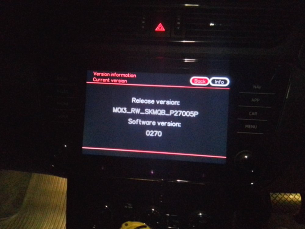

Maybe. I started from this version exactly: 20260517_053843.jpg

I'll give it a go and update here. Did you encounter any issues? I remember I read somewhere that the navigation and map may stop working when you go from version something to version 308, or something like that...

Make sure to check the zip file properties and unblock them first. Format the usb-c or sd card with FAT32 or exFAT. I had to press the update option a couple of times. It will take at least 10 mins each version. I would do one at a time and test each one thoroughly. When each update is finished, use the scroll bar to scroll down then press resume. Navigation may stop working. If so, you would need to also apply the patch. This is where i am up to. For me, nav didn't work when I bought the car. It's an ex police Skoda Superb. Go to the swap codes also in the engineering menu, select one that is already there and check your VCRN before and after upgrade. Mine currently says 1234.
