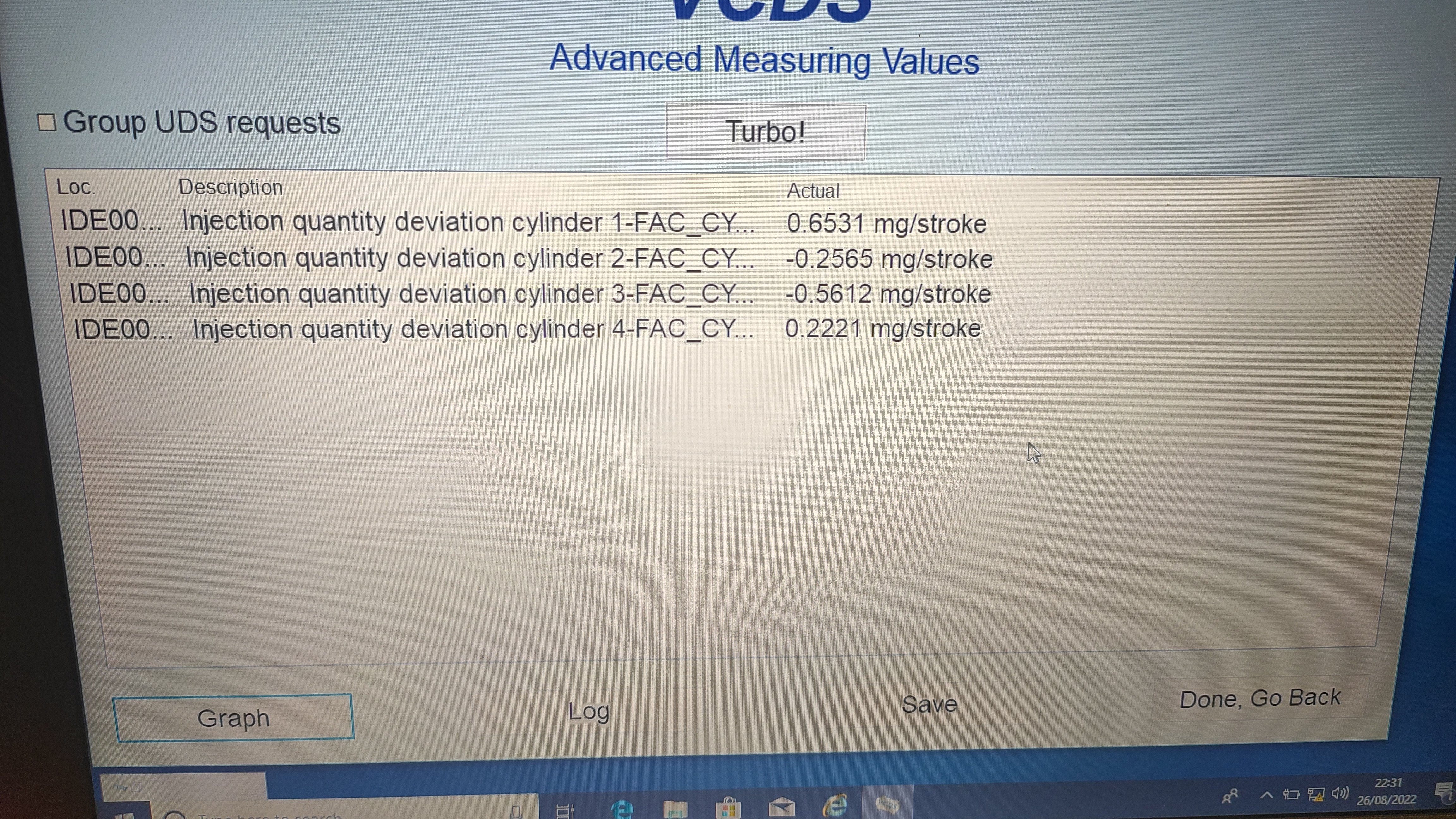

how can I test the injectors? can I use VCDS?
Yes you can, it's a 1.6 TDI so injector failure is not so much a case of "if" but "when".
so I suspect injector 1 is no good? what about injecor 3?
It's a 1.6 TDI so best advice is to replace all four injectors since they all fail very close to each other, looks like two of yours have gone already. By all means confirm the diagnosis, injectors are not cheap.

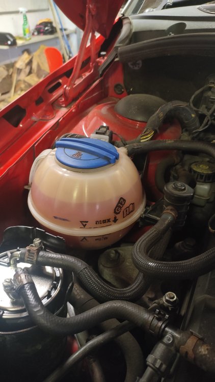

I've completed a injector adaptation again this morning and the car did it's reving thing for 20min and when I went back to inspect the engine bay, I also topped up the coolan system with some of that steel seal HG liquid which took it bang on in the middle of the tank, and this is what I found. That missing coolant is back, wtf... It was way below the min line and now it's at the top. Also I was peaking under it when it was reving and the knocking sound was definitely louder under near the oil pan. I might pull the pan off and inspect the bearings just for the fun of it at this stage.
The mysterious coolant level change is almost certainly caused by HGF, the system is being pressurised by combustion gases blowing past the gasket fire ring and that is also likely to be the source of the chuffing sound.
I fear I'm repeating myself here but I've a LOT of professional experience with engines and I've said right from the start that it's not a bearing failure and I stand by that.
I really wish you hadn't put magic jizz in the coolant because it won't fix anything, it'll just gum everything up.

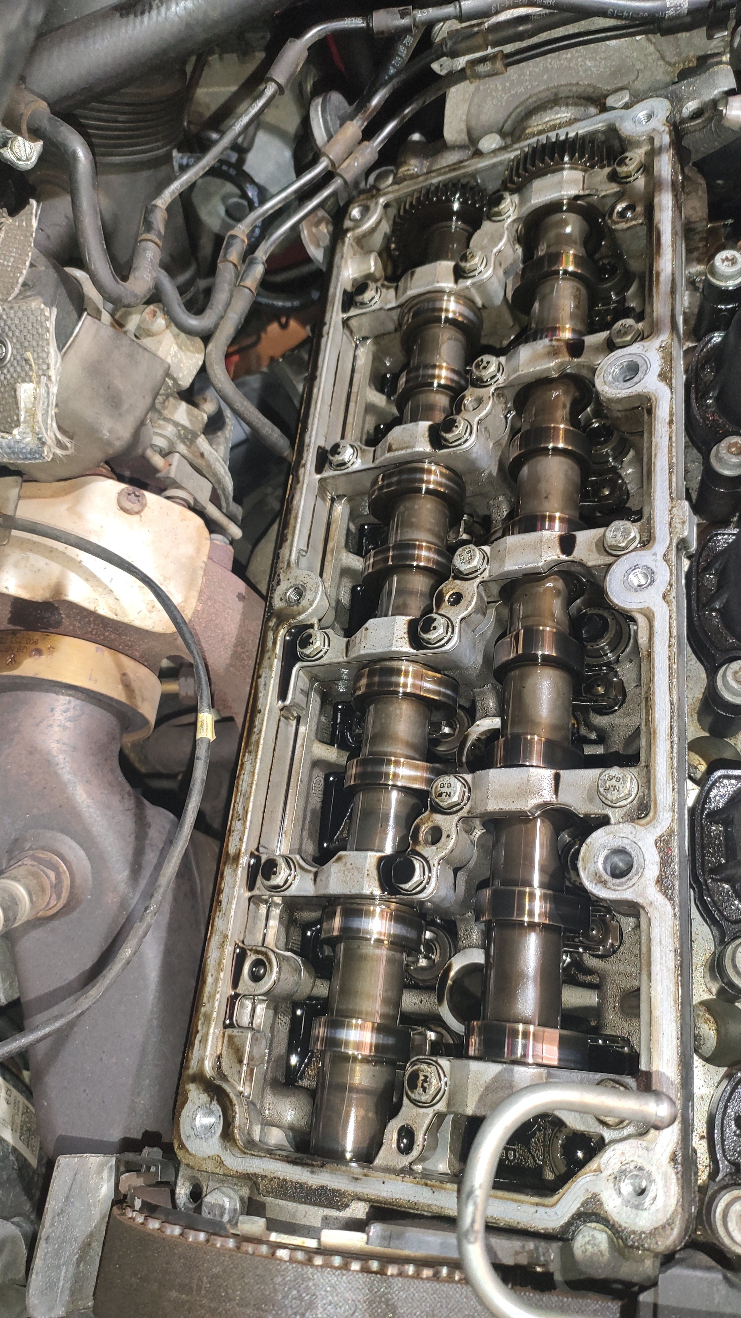

so I had a friend that came over and he pretty much said bottom end in his opinion. We did a compression test 390psi, 390psi, 380psi, 380psi (last two the battery was struggling still on charger).  Compression looks good.
Then we took the cam cover off to check for cam wear and everything looked smooth and shiny but didn't do anything past spinning it and checking the cams. Img for reference but not sure you can see anything.
I'm not sure if it's a head gasket still, I am still taking in consideration what has been said so thanks @sepulchrave it's still on my list.

Top end looks tickety boo, compression readings also decent.
Why do we think there's something wrong with the bottom end when the cooling system is clearly getting over pressurised again?
