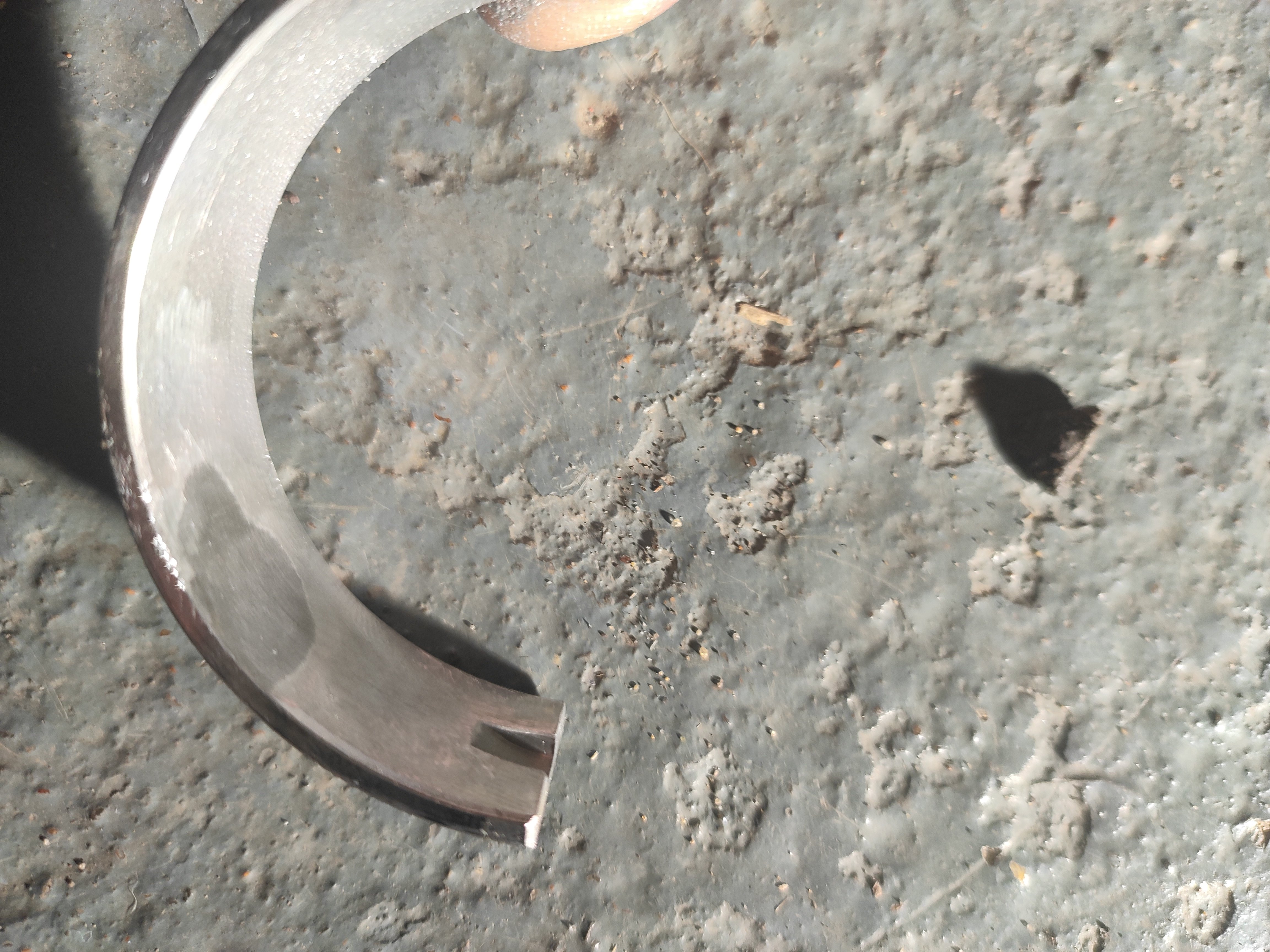

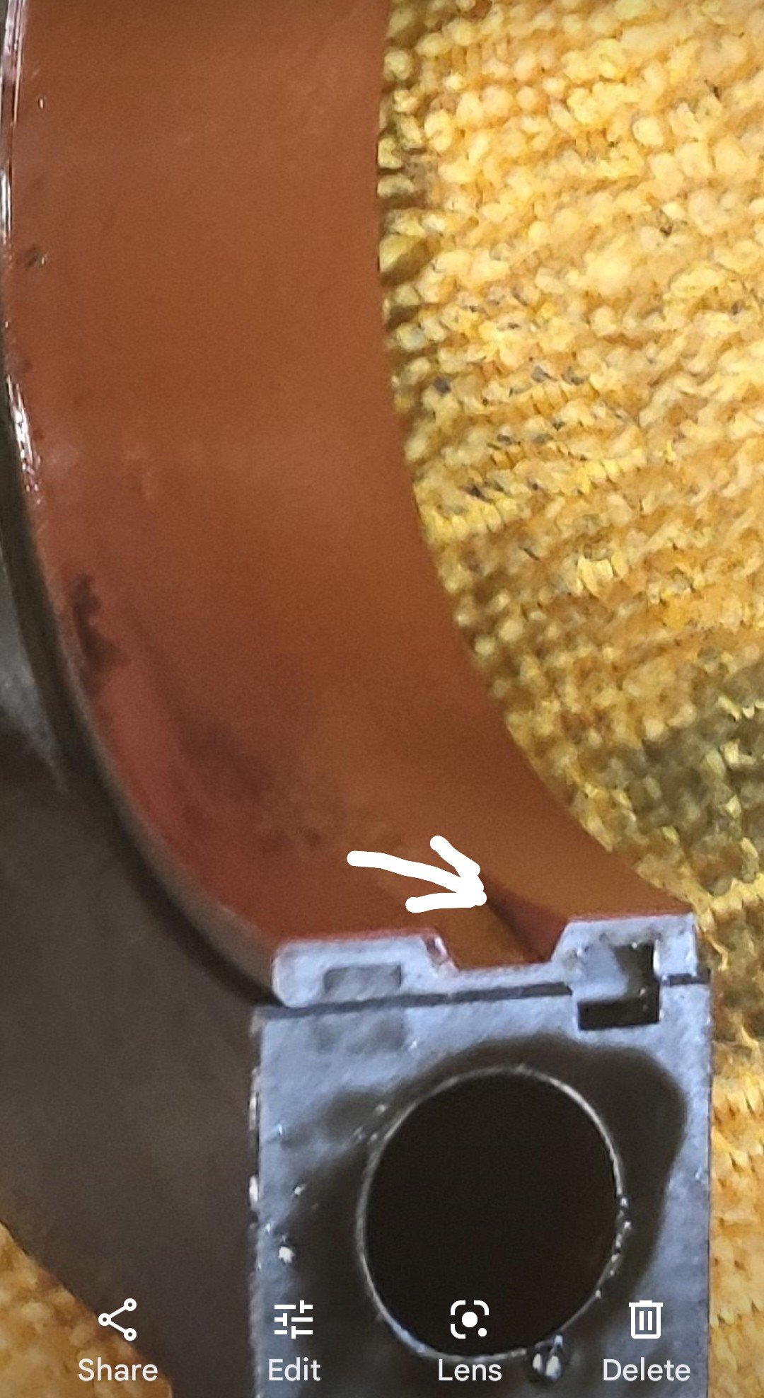

I read that this is a different type of bearing because there was very minimal scoring, almost looks like it's got a coating on it. Is there such thing as red bearings, blue berings or yellow ones? the other half looked identical. Why would this score inside this groove? that should be silver still if that was the case?
How odd, you're quite right it doesn't appear to be worn and if the crank journal is smooth then it must be a different material, I've never come across it before but if the crank's not damaged then you've got away with it and that snapped bolt must've been damaged during manufacture or assembly.
In some bmws apparently they had colour coded bearings having different clearances etc. I didn't find anything related to VAG. I actually reinstalled it as I didn't want to mess with it. It had less wear than the others but that might be because of the colour.

I have grinded a bearing down to see if it is red and there's no copper there, I think it's just the same metal, I know some are copper with a coating on but this does look to be like that.

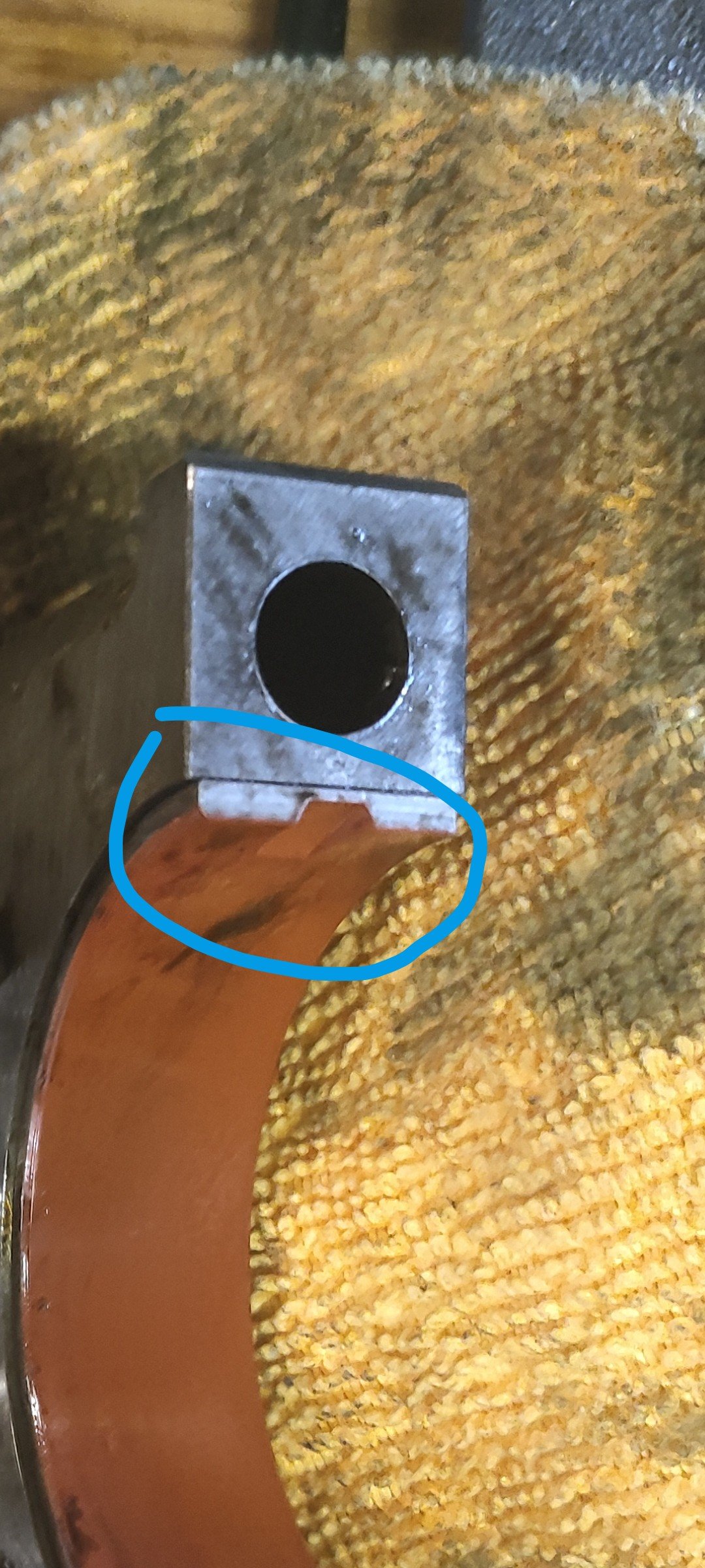

With Vandervell bearings there were two types, the standard white metal over steel bearing caps and the VP prefixed (Vandervell Performance) white metal over a copper alloy over steel shells, these race engine bearings would look identical until the white metal wore sufficient to expose the copper alloy (whose name eludes me) beneath, this was soft enough to continue functioning as a bearing and protect the crank, usually the low oil pressure and noise would precipitate their replacement, the crankshaft journals  would usually be servicable whereas with the standard bearing shells (V prefix???) once through to the steel backing it would trash the crank and often throw a conrod.
Often the big ends were the standard shells and the main bearings the copper backed ones, the white metal over the copper backing on the OP's bearing may only have been over the bearing surface and not the oil groove, that could be a modern production cost saving so a worn shell would look reddish all over and a new one grey with a red stripe in the oil groove.
The bearing in question does not have an oil groove, surprising for a main bearing, was it perchance the rear bearing with the broken cap?

I wish you could have seen it for yourself. It didn't looked scored that much and the grooves where you fixed the bearing in place were also red, how can it be , why would there be scoring on the side of this wall? To me they looked perfectly fine.
