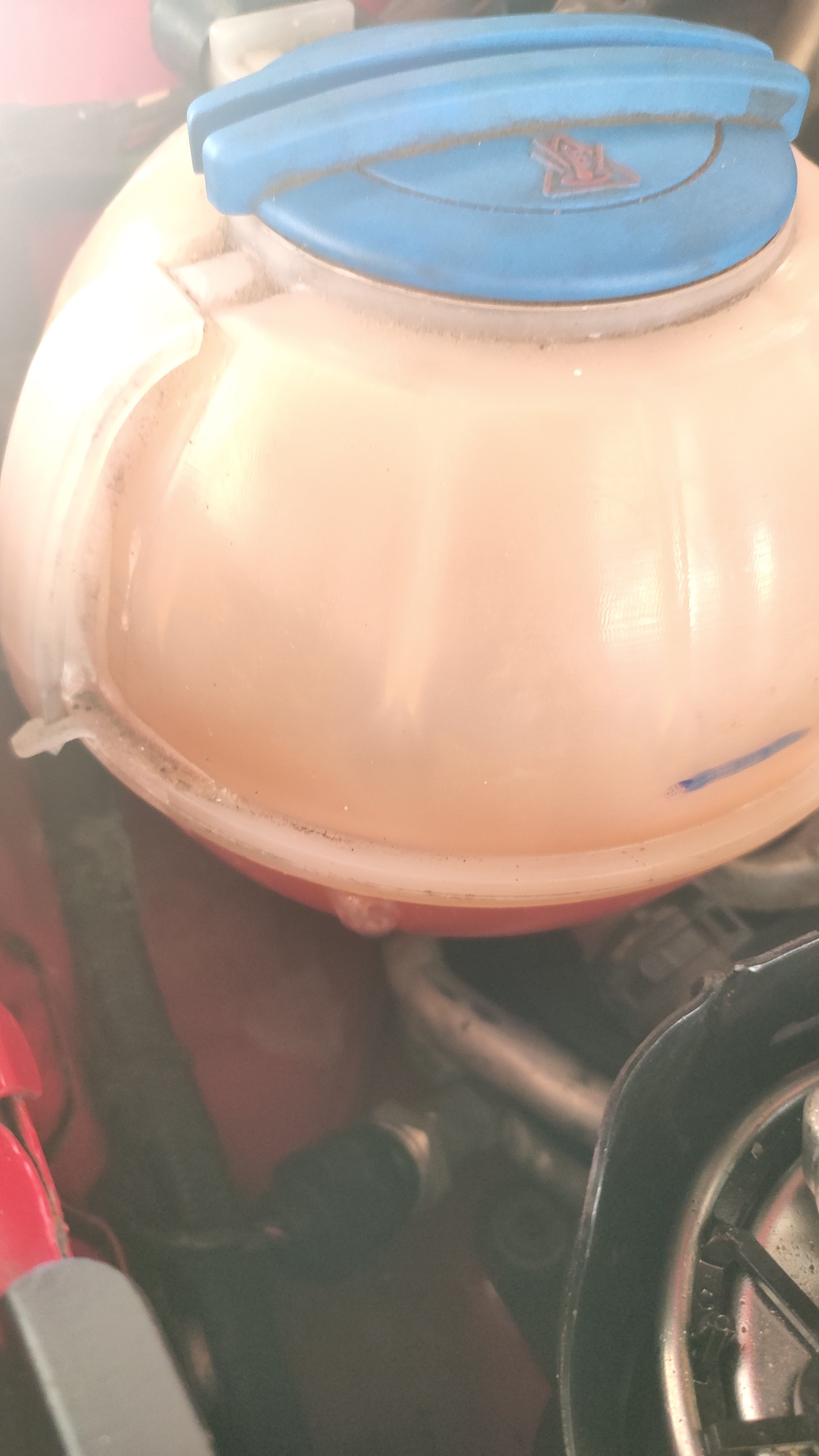

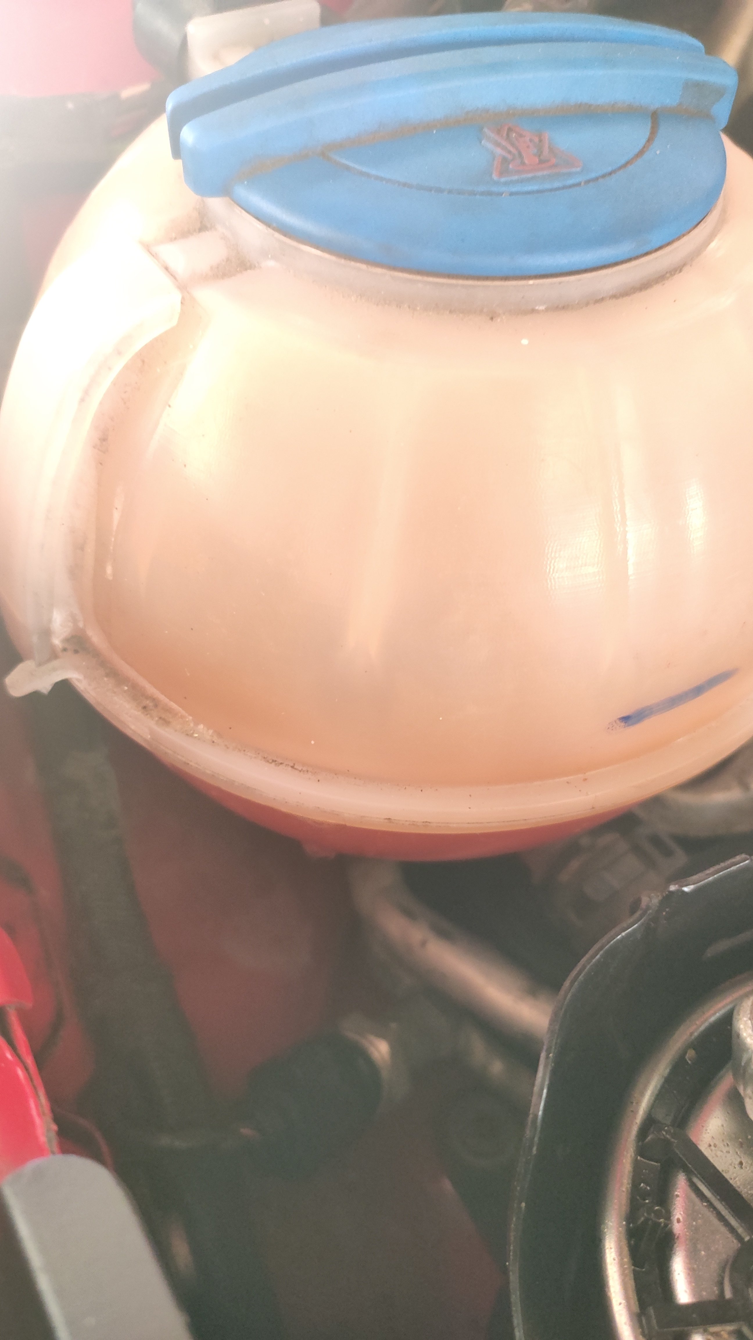

this is why the coolan has gone.
 the tank is split in the middle.
I seriously doubt it, imagine the pressure needed for the tank to split along the moulding line, the tank cap would release the pressure long before that happened.
If you release the pressure in the system by loosening the cap the coolant level should creep back up again.
i watched it coming out with my own eyes 👀
Ok, so how did that happen, the pressure in the tank must be crazy, are all the coolant pipes rock hard? Have you tried releasing the pressure when it cools down?
Thats a bit oddball. Are you sure it's not the cap seal or the level sender sending a tiny amount of water down the outside of the tank, which is then accumulating on the lip?
Edited by StevesTruck
Not at all, it comes bubbling out from the middle of the tank. Pressure must have been high yet no pipes are leaking and I have had the cap off. But should there be pressure like that in the system?? I bought another head gasket tester and I have negative results again. I waited until everything was up to temperature and did it mani times. I went and placed it near the exhaust after just to humour me and it turned yellow within less than a minute.
I'm actually waiting for a friend to spare a weekend and help me pull the engine out. Might take it down to a garage first and ask for their diagnostic.
Yep, that is a bit random. I wonder if the header tanks been replaced with a poor pattern one at some point. Either way, I think I'd chance a new tank and cap before taking the engine out.
Like I say, I think you're chasing two separate faults that together look bad.

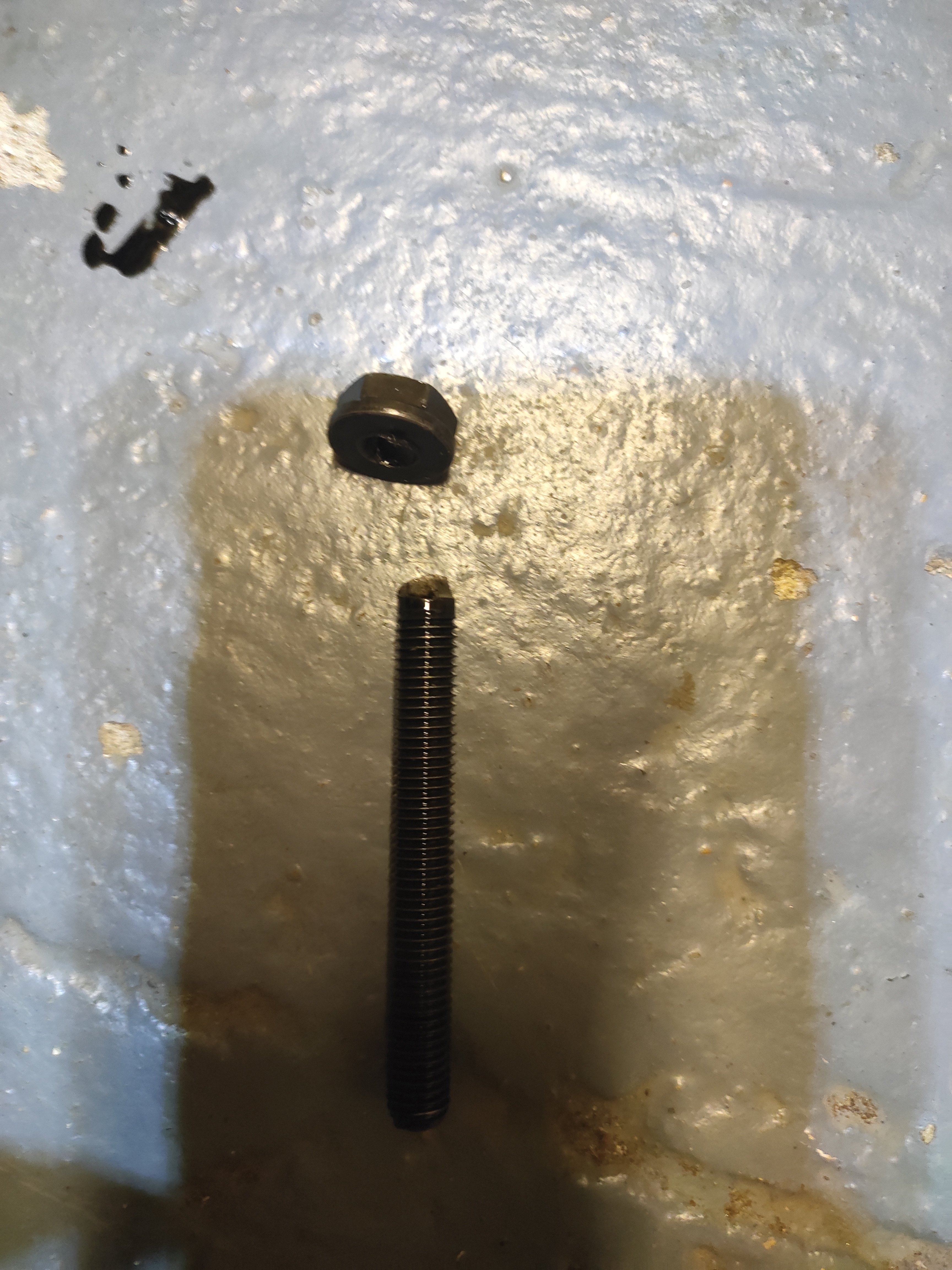

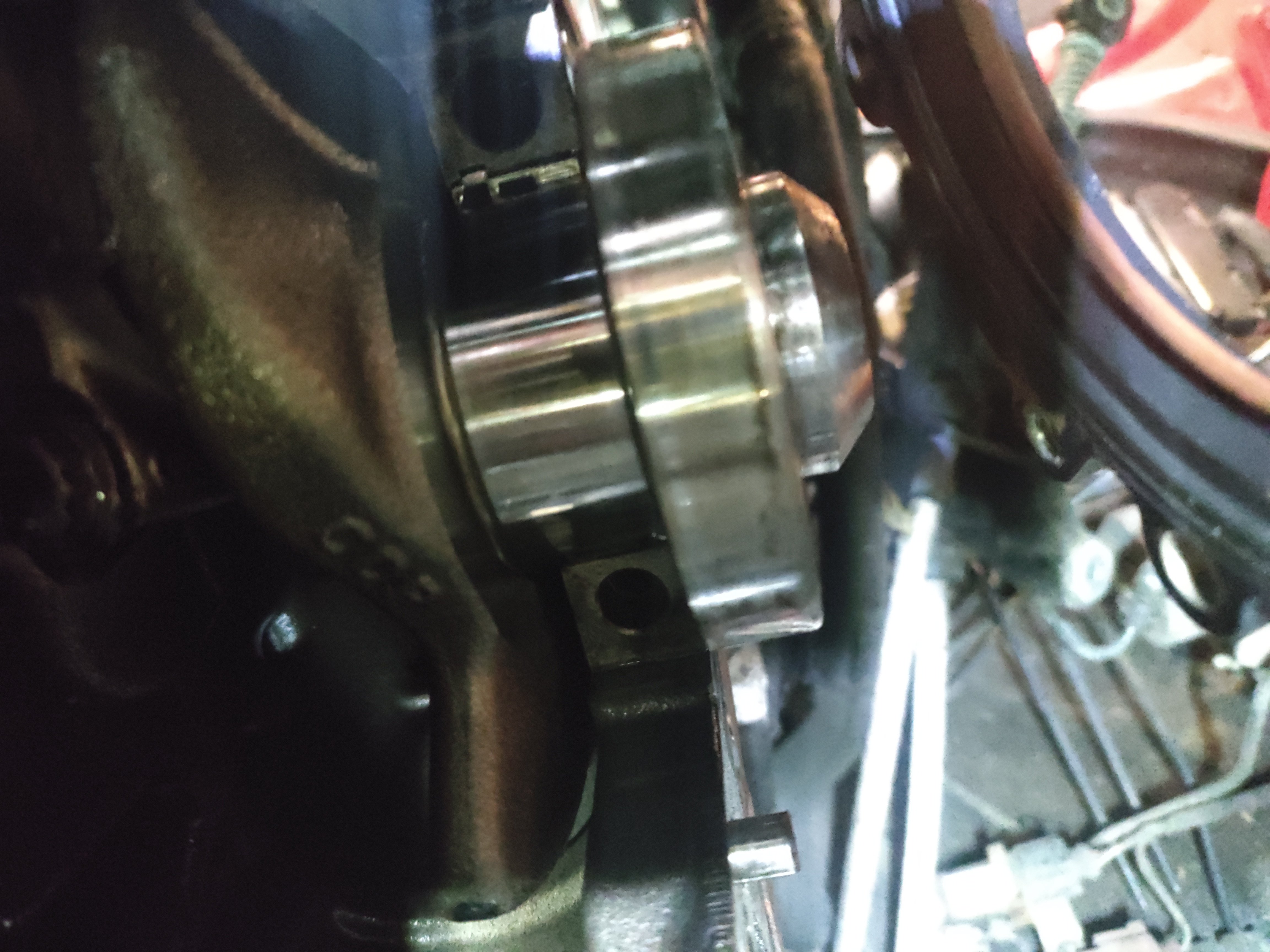

everyone, I present you the reliable 1.6 TDI engine with 126 000 miles. Go figure.
the cranckshaft bolt head has somewhat snapped off and I have unscrewed the bolt by hand.
What does this mean? Do I need to check for scooring? can I just add a new bolt?
Edited by Bertie90
Congratulations, you have a unique failure.
Since that's a main bearing cap you need to remove the other bolt and the cap so you can inspect the crank journal itself.

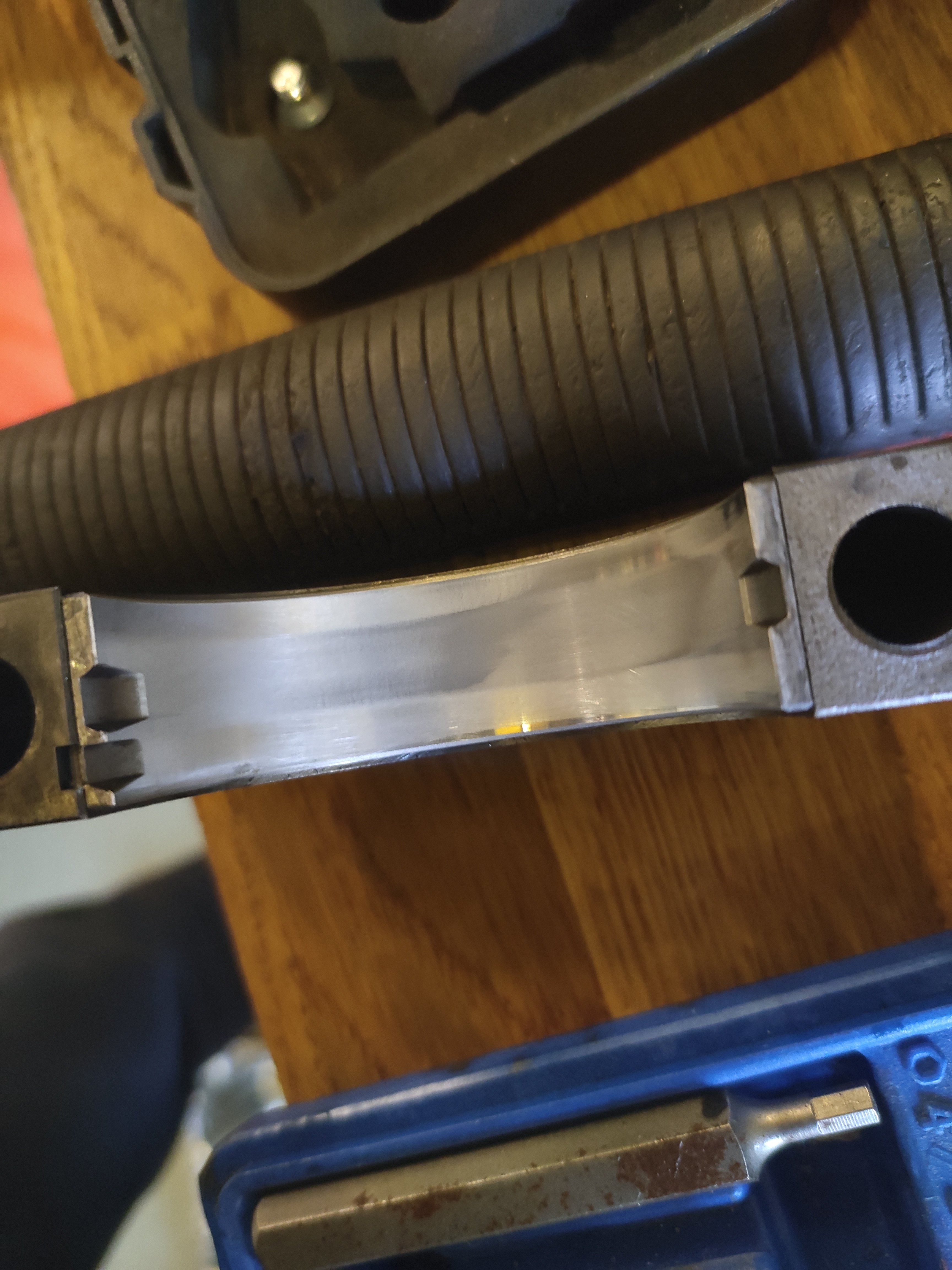

Difficult to show, the journal has these stripes that run horizontal from one end to another. I think I might be ok.
Why not replace all bearings and bolts while you have the sump off and oil drained it makes sense as it would do another 100,000 miles no problems
I will 👍
That's the bearing shell, the journal is on the crank which looks ok and if it passes the fingernail test, is ok.
The shell looks ok as well but bear in mind that you cannot safely replace the upper half of the mains with the crank fitted as trying to slide them round will end up doing more harm than good. I appreciate the temptation but bearing shells really don't wear unless they get oil starved, some of the sputter coating has gone from that shell but it's far from dead.
In your place I'd simply replace both bolts on that main bearing cap and button it back up.

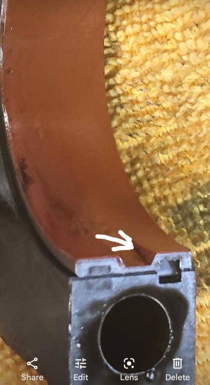

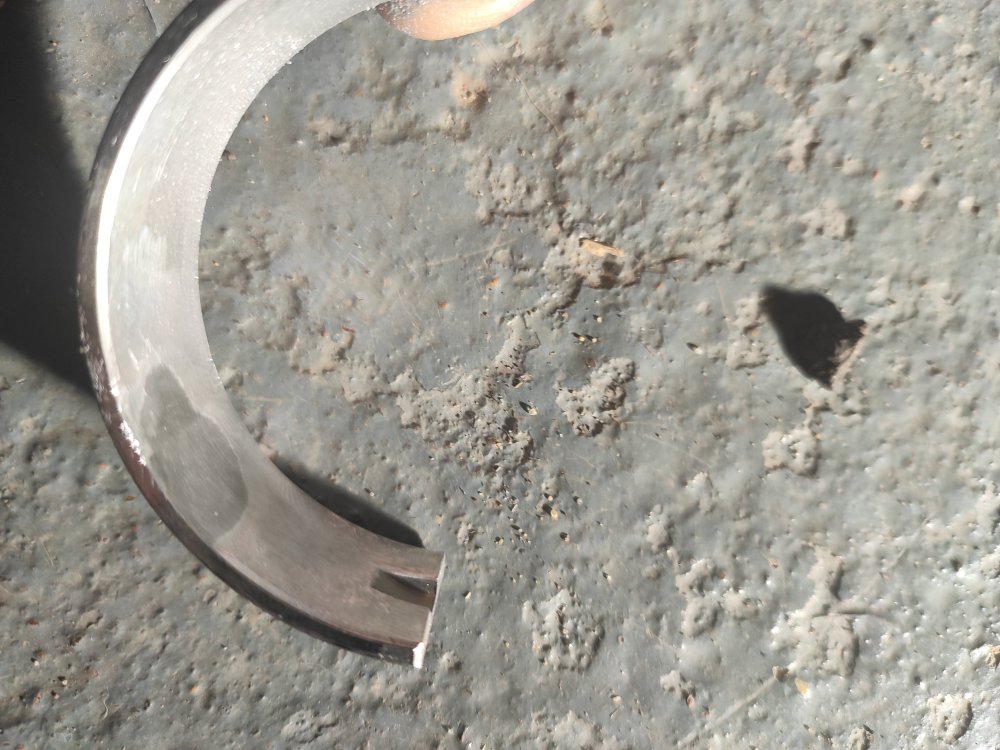

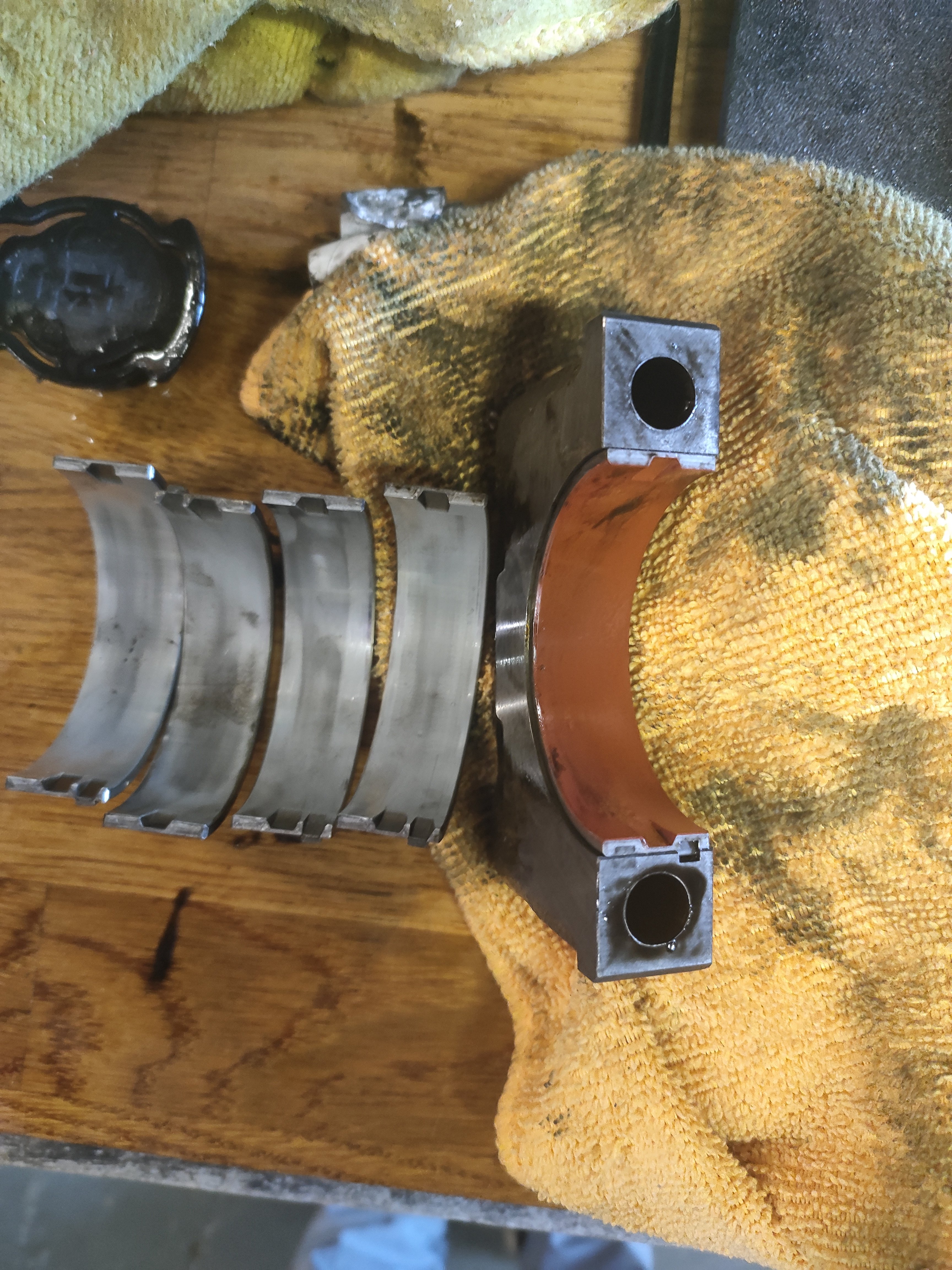

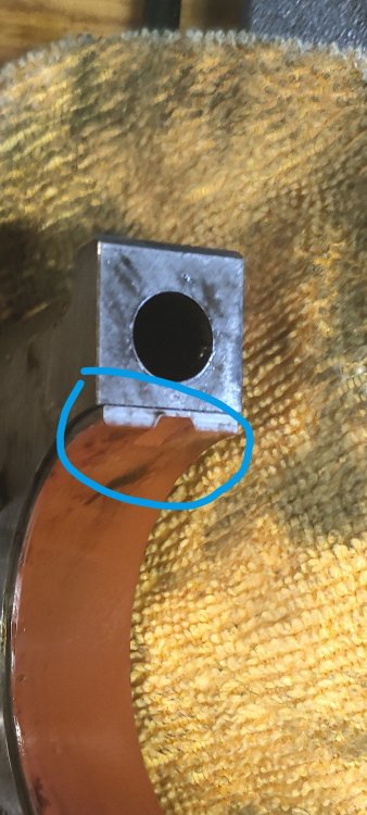

is there a reason why this is so red compared to the other ones?
Yes, that's the copper backing, it's completely worn out.
Yep, that's totally knackered.
Oil starvation is how that happened, previous owner let the level drop too low and the bearings got starved during braking or cornering when the oil sloshed away from the pickup pipe, big ends have probably had it as well.
