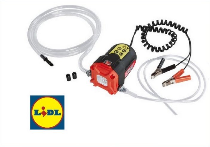

I have never used a new washer in all my years 70+, now in the Yeti I do not even take the sump plug out as for the last few years I have sucked the oil out of the dipstick tube straight into a waste can so no need to do any cleaning up or removing the undertray.
I use an oil suction pump from Lidl.
