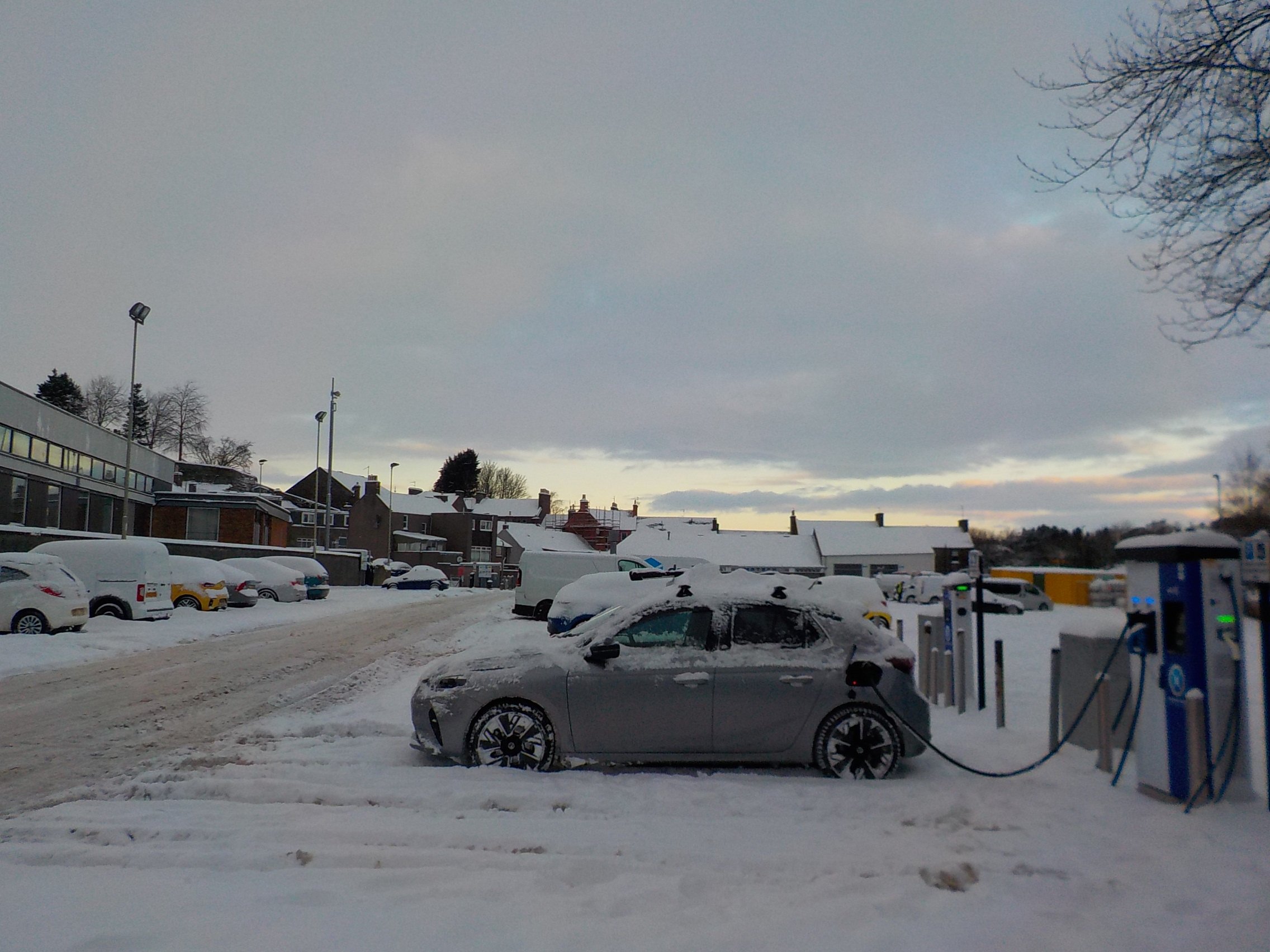

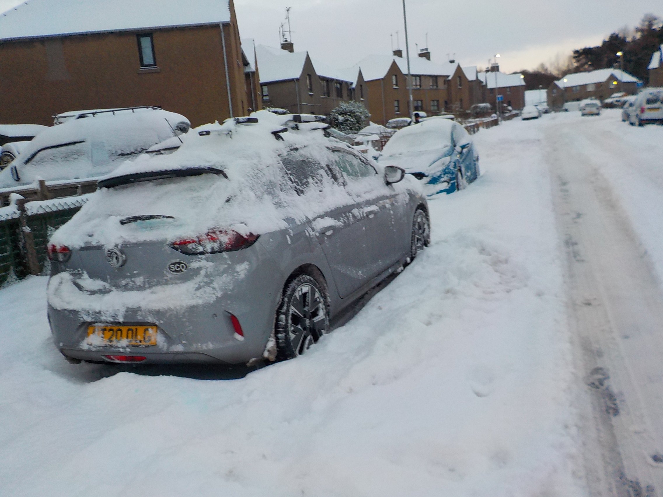

@Zinc i understand that as i drive EV's.
But heating a parked up cars battery using the battery before driving when not plugged in is saving nothing, but it does heat the cabin if you want that.
When like me you have a small battery you actually know how to hypermile them.
Pre Heating a battery while parked to just then go on a charger to get a quicker charge with a pre heated battery is just stupid, but then anyone can do as they wish.
Turning on the Car and clearing the Ice or starting it melting is simply clever, then starting the car before driving off does work.
Then you will be wanting to be putting that power back in and a heated battery when you reach the charger might make a difference.
But then the chargers can be putting out a pathetic power.
That is real world use.
 Lovely when you get plugged in, the heating up full and seat heating and the windows cracked open.
Edited by roottoot
