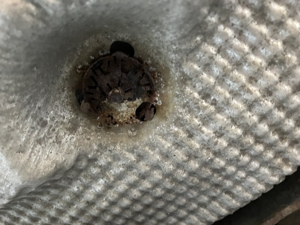

The hear shields under the back of my 2013 diesel Superb Elegance estate started rattling 2 weeks ago. I had a look underneath and found that one of these fasteners was completely rusted through:
…and a second was on its way. I’ve replaced the two rusty star washers with new ones today and it is quieter, but I still get the odd rattle. I’m wondering whether there should be some barrier or sound deadening material between the two heat shields where they overlap - which has perhaps fallen out?
Does anyone know?
Alan

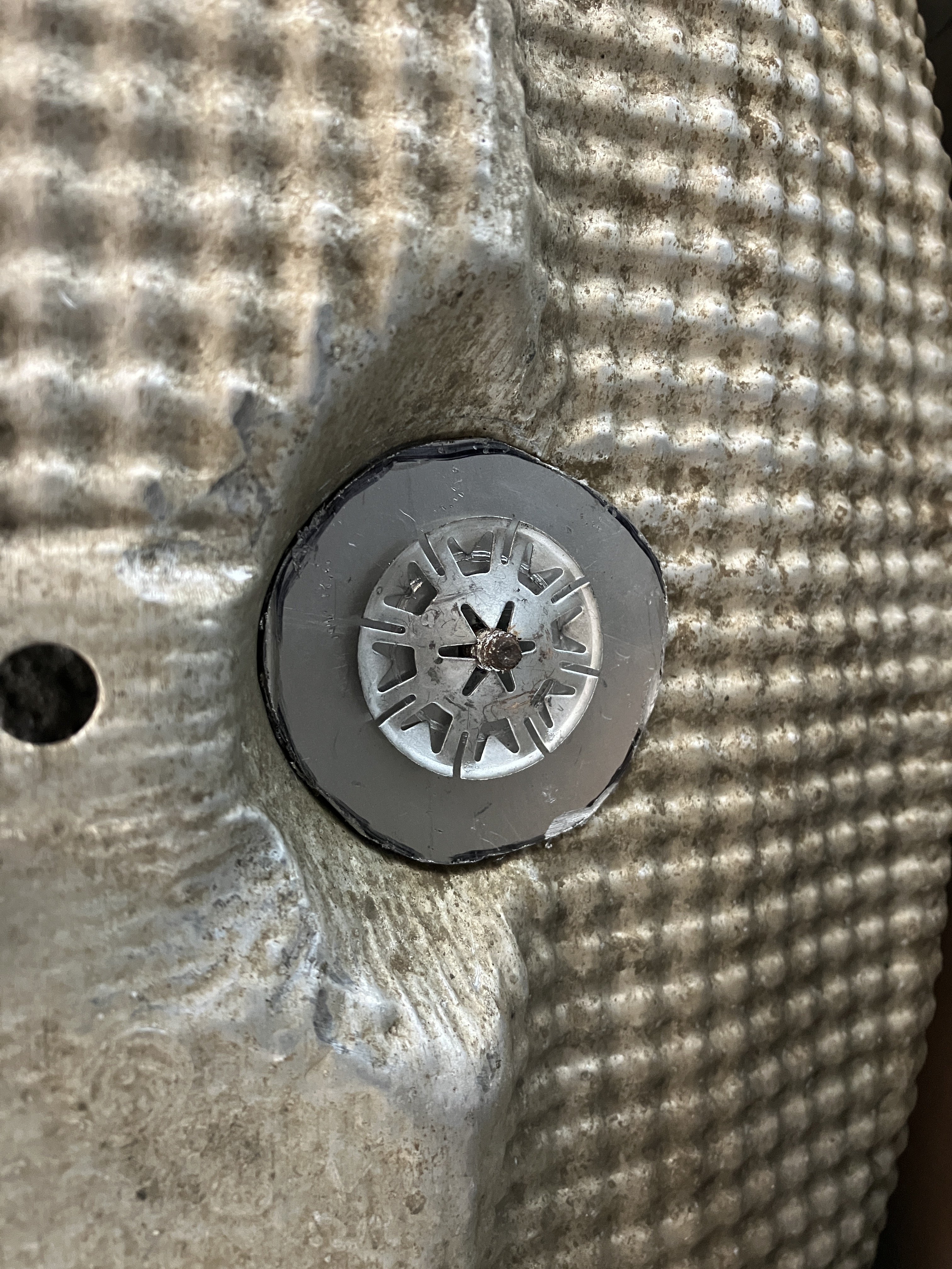

I had another look at the heat shield today - the rear end rattle had persisted. The aluminium sheet around the middle of the three fasteners had worn away a bit so I made up a large aluminium washer (about 2”) like this:

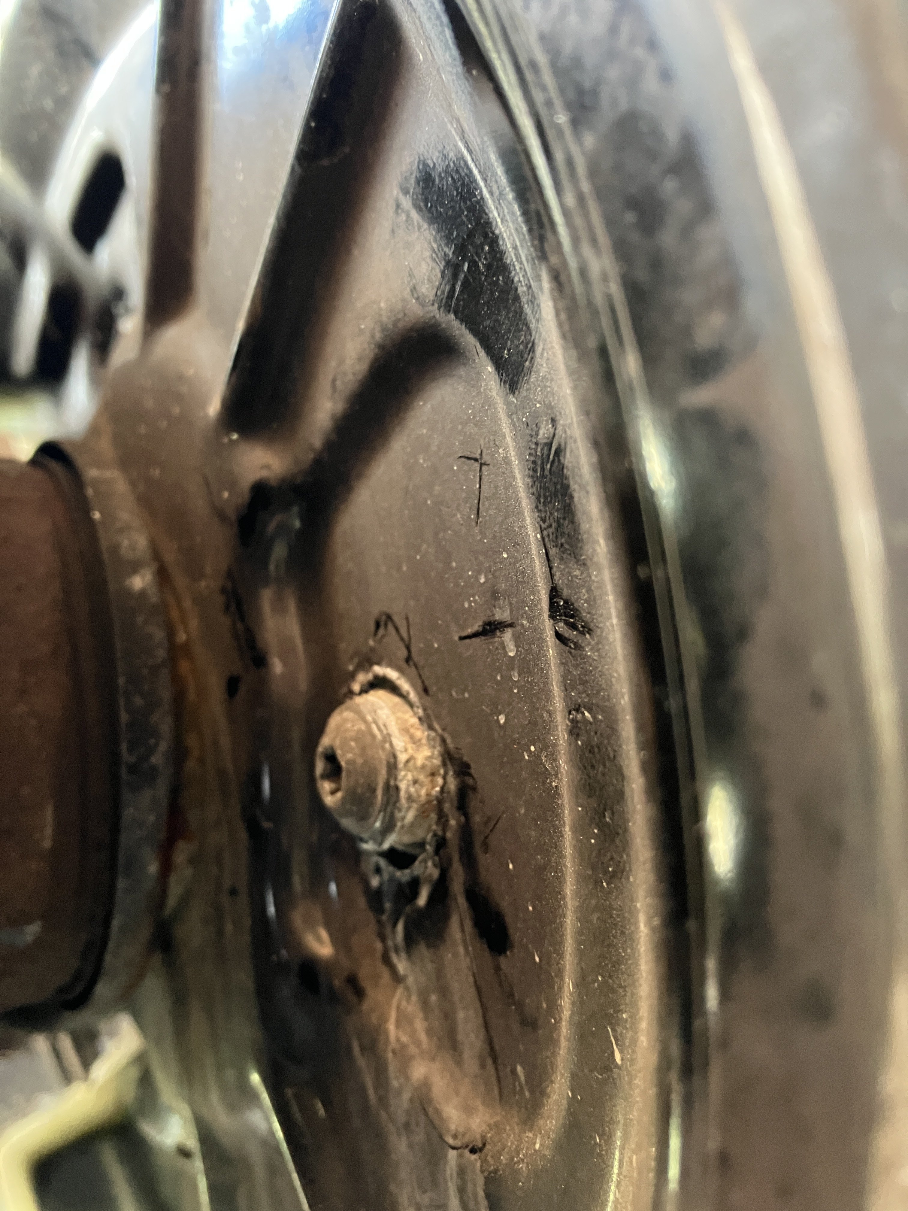

… which I thought a neat solution, but still the rattle persisted. I jacked up the car and checked the (nearly new) springs, which were fine, then accidentally came across the culprit: the cover for the NSR disc was not attached:
the metal surrounding the three securing screws had all worn away, allowing the cover to flop around. I’ll start a new thread to work out how I’ll fix it 🙂
